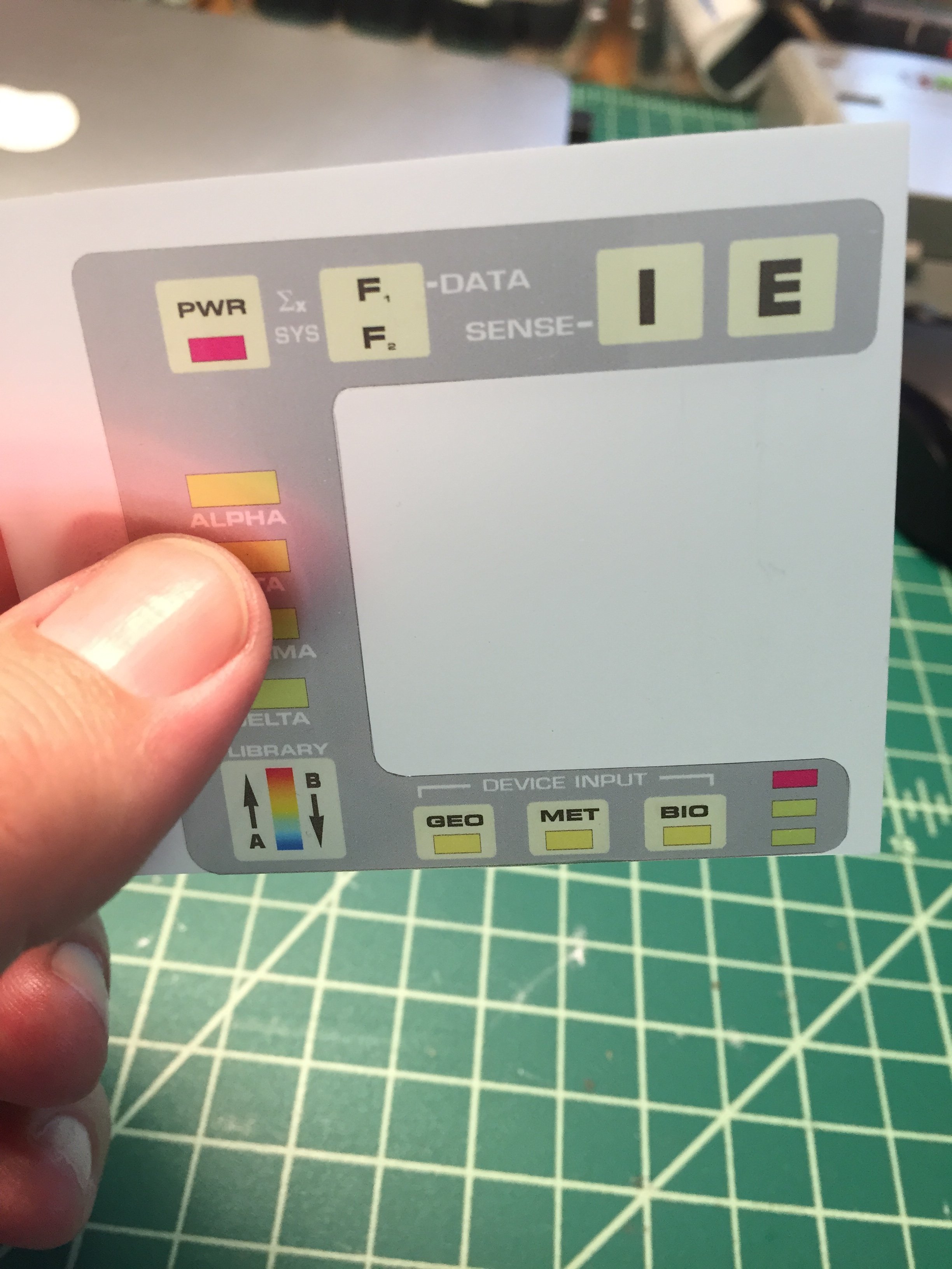

My question for those who have built a Tricorder is the: How do you attach the transparencies to the body? I also want/need to layer a frosted paper under the transparency.

When I did my standard tricorder I brushed on a thin layer of Micro Krystal Kleer. It's basically Elmer's white glue packaged for model builders. For the frosted section check at an arts/crafts store for tracing paper. A store like Wal-Mart should have tracing paper as well.

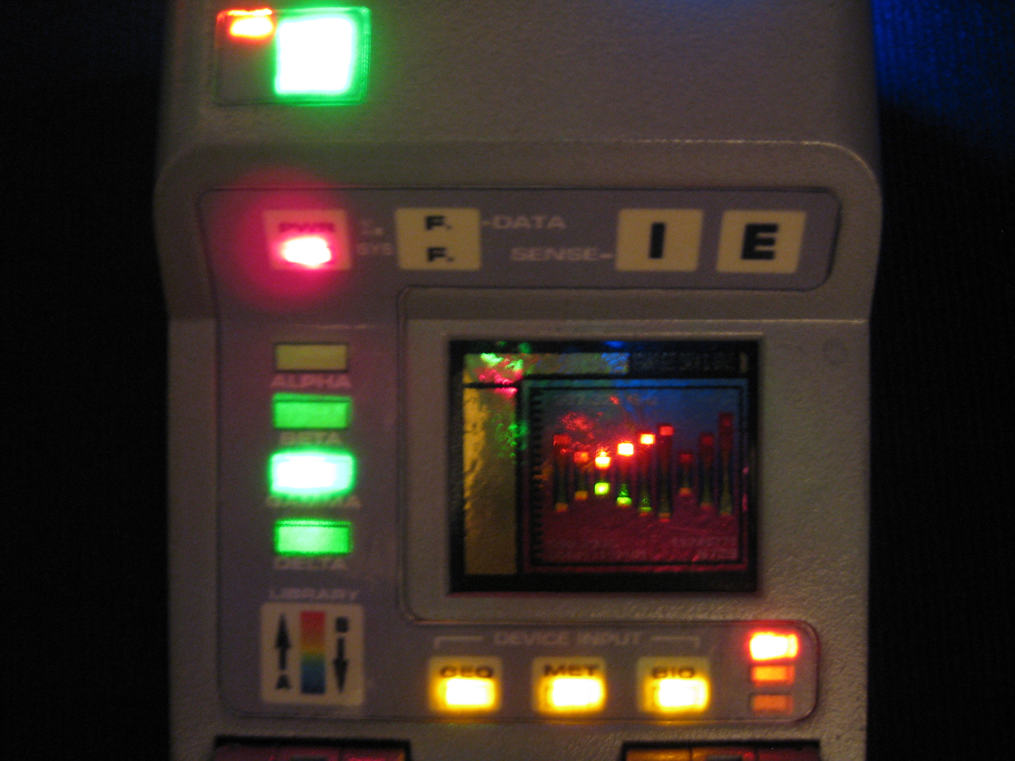

Thanks for the suggestion. I have the frosted paper. Its behind the graphics in the third shot. Did the MKK leave any bubbles between the layers? Did you brush it on the body as well or just the transparency?

Just on the body. I had a few bubbles, nothing noticeable. Just brush it on as smooth as possible and let it go just a bit tacky first before applying your transparency.
It's been a while since I did one, but I remember just using simple 3M Spray Adhesive. It left no bubbles at all and was easy to clean up any residue before and after it dried.

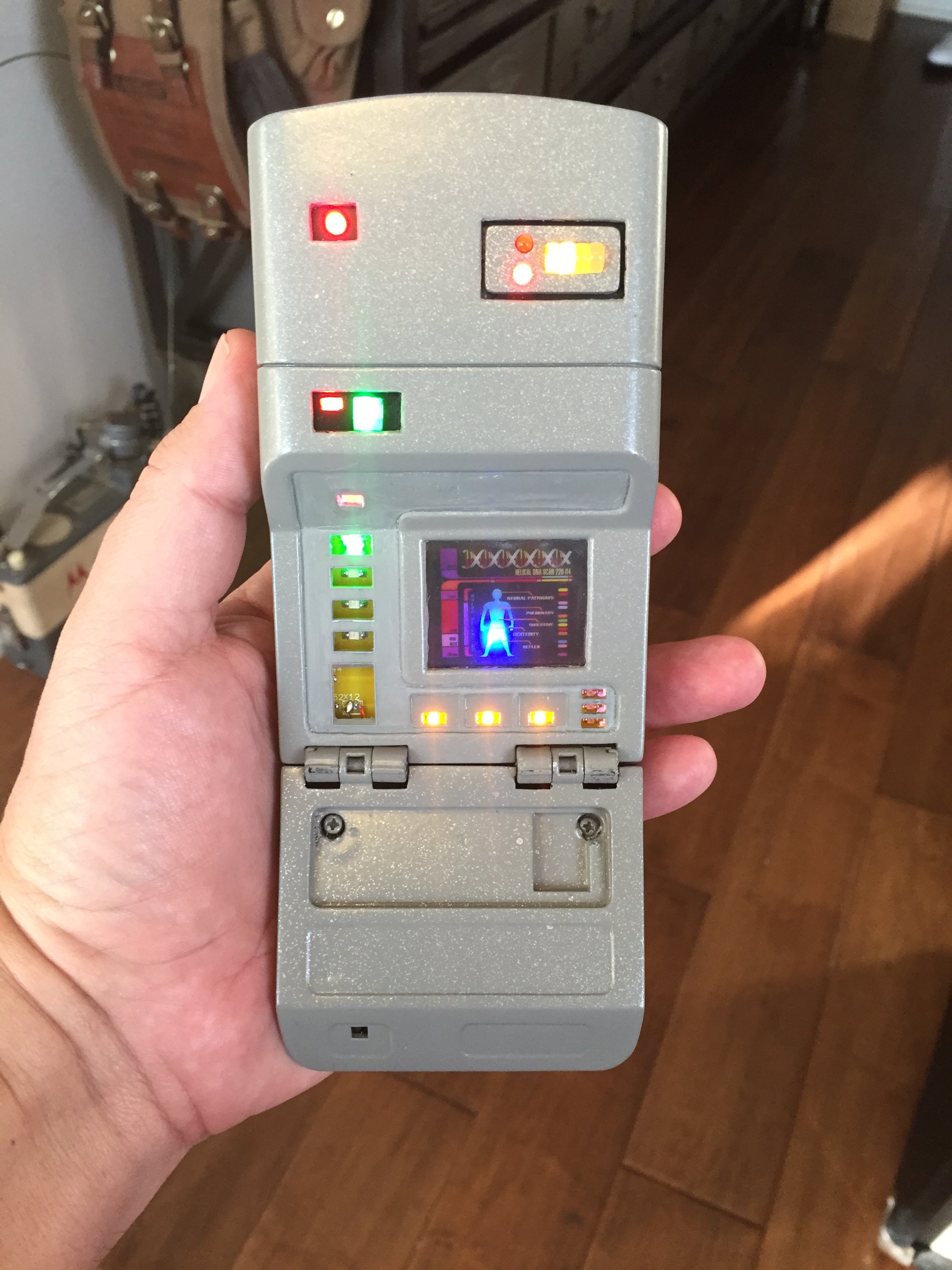

As for the main screen graphics, I actually used a piece of silver Mylar paper behind the graphic to diffuse the LEDs. It gave it a really nice shiny effect. See below. I know this is a pic of a Science MOD...I don't have pics of the Medical one I did. Sorry. Hope this helps, though.
