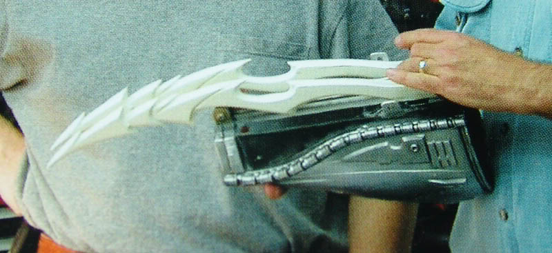

These are my Predator claws that a friend cut for me. He is lucky enough to have a laser table to cut acrylic and plastics. He cut these for me, as well as a few extra sets. If you want a set of these, get hold of me. Anyways, these are nice, huh?

Mock-up of the assembly as of tonight. Lots left to do, but it's coming along. I won't attach the blades until last thing, and I have some work to do on them for aesthetics. I want to simulate a ground edge to the blades, while they stay blunt and safe.

With the claws mounted, the assembly looks like this.
