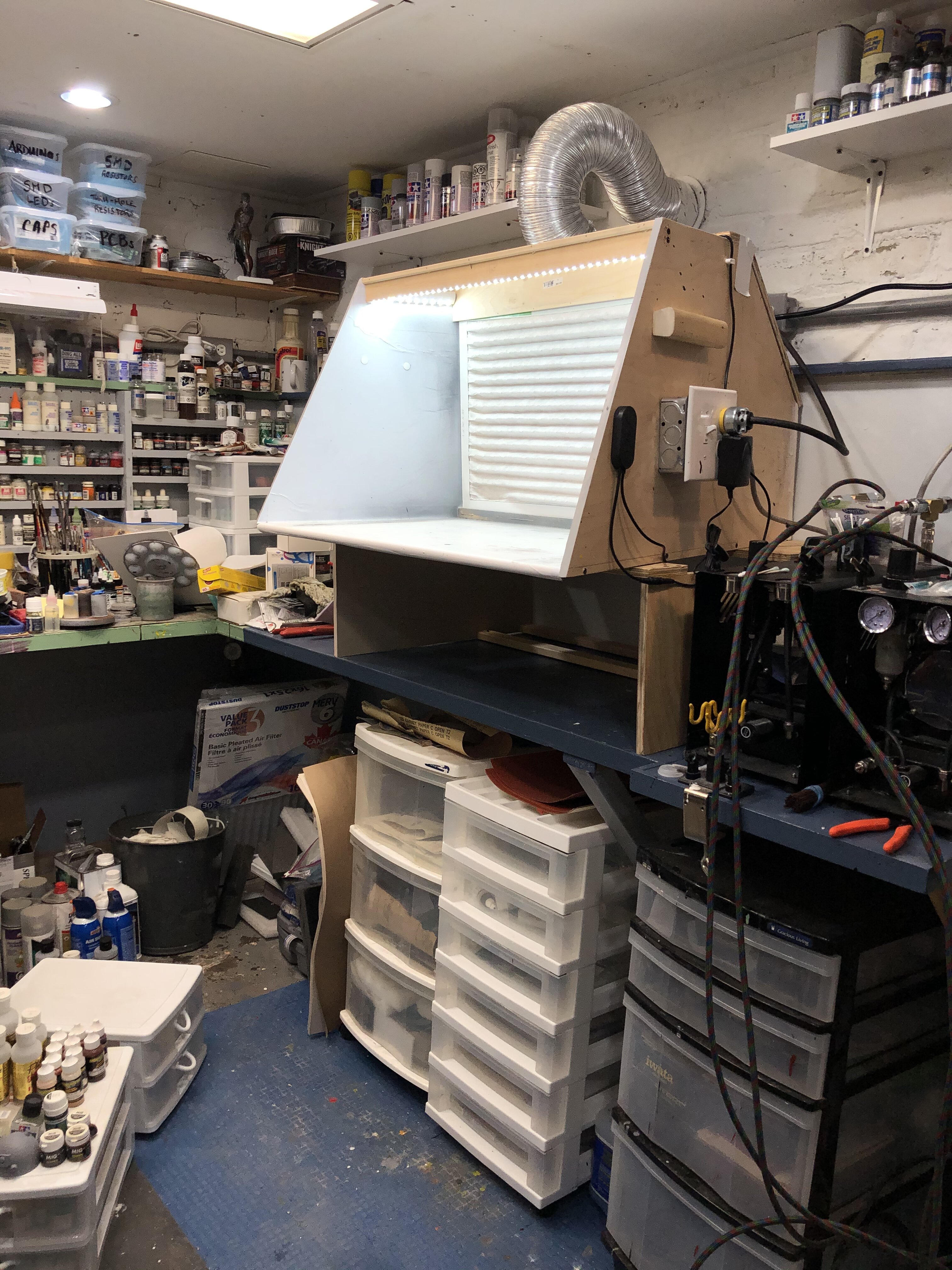

Definitely DIY. I used the design from Ventworks (DIY Hobby Spray Booth) and modified it to be wider at the front and with a more powerful Dayton blower, but their design is excellent.
My spray booth is on the left side of my workbench. It's made from MDF and a cheap medicine cabinet from HD. I needed a box-shape for a plenum, and it was actually less expensive to buy the medicine cabinet than a piece of wood and the hardware, not to mention the time it would take me to build one. It holds a 14x25 furnace filter, and it's exhausted by a Dayton blower. I made the top so it could lift up and give me more space. Recently I replaced the 1/4" MDF top with 1/2" MDF, since I was almost constantly using it as a shelf anyway, so I made it a little stronger. I also added some cup hooks to the ceiling of the booth, so I can hang stuff to dry. The spraying surface is about 30"x 30", and I've never come close to using it all. I've got an LED light in it, and that gooseneck lamp, which gives tons of light in the booth.
I HIGHLY recommend a spray booth. Anything that smells gets done in there. Mixing resin, epoxy, RTV, cleaning my airbrush, you name it. It's definitely a lung-saver.
