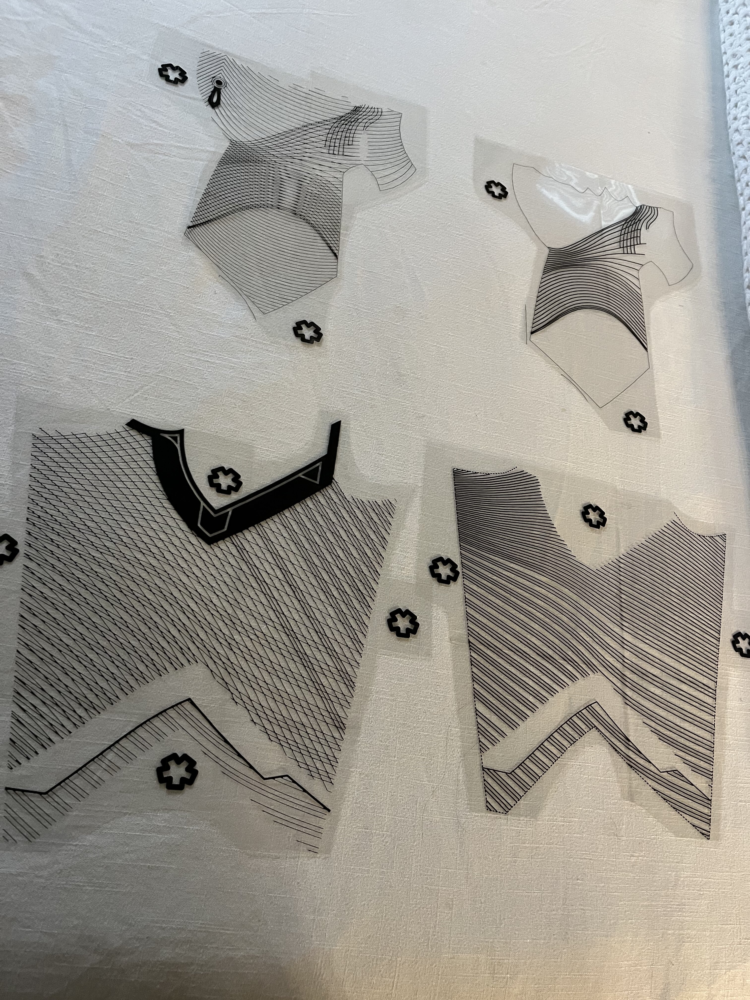

Hello everyone so I’ve been making some progress on my v2 of this suit and so far I’ve been modifying scratch threads pattern to get a more movie accurate pattern. It’s mainly the lines on the black part of the suit, the webs and the texture of the suit.
since I am screen printing it, I have to make the pattern as a vector with alignment guides (the flower shapes along the patter) since it has a raised texture, I’ll go I to more destacó in a sec, After all of that was done I had to print it on transparency sheets, and since I don’t want to spend more money than I already have I just bought some transparency sheets from Amazon and printed out the pattern and taped it together ,because getting them done at a shop can be really expensive. Now because the suit has some raised texture over the lines like in the image bellow, this one is from Aaron Alexander’s Instagram page showing a set piece from the suit showing it has a raise texture.
I had to make a duplicate of those select raise lines. And now back to those guides they serve as a guide when I am screen printing to overlay the raised lines over the flat ones here is how it looks the raised and the flat lines on the transparency sheets
my v1 of this suit does not have the raised lines and after some research I found that the suit is actually more detailed than I thought, having raised lines all over the suit not just on the arms and forearm but also on the sides back and the thighs. Currently right now I am still printing and putting everything together the next update will be the webs and the raised basketball texture on the red part of the suit.

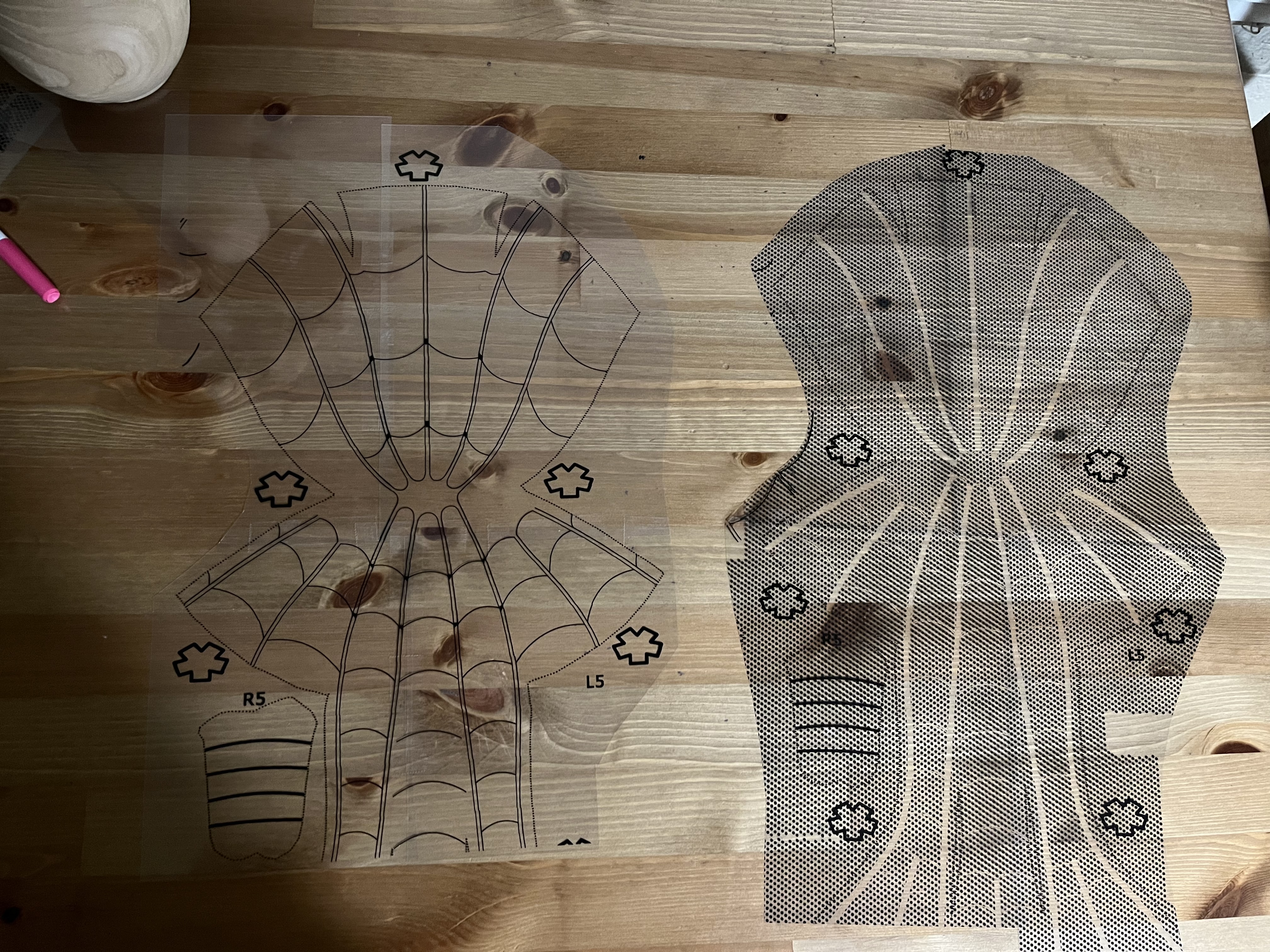

Hello again everyone! I am back with updates, I have been busy with everyday things and I was finally able to print up and assembled the webbing and texture vectors
The first image is the sheets together and the second is the sheets apart.
Also I am not ignoring the comments left on this thread I just don’t quite know how to responde to them just yet I am still new to this platform, I do not have an Instagram just yet to post content, I am still considering it. The next step now after having everything printed out is fabrics, I will be posting updates soon, thank you to everyone who is following this thread and those who have showed interest in my little project thank you all!!

jvear12190
you inspired me to do the same but I just cant find anywhere online to get screen printing patterns like this. Where do I go for them?
I actually make them myself, I purchase the pattern through scratch threads and I edit them in a photo editing program to make them as vectors fancy word to say outlines, I use affinity but photoshop works too. Then i print them with a regular printer on to transparency sheets and I assemble the sheets together using transparent scotch tape. it’s actually very simple to do it just takes a lot of time. I don’t know of any one who sells them ready to be screen printed.
