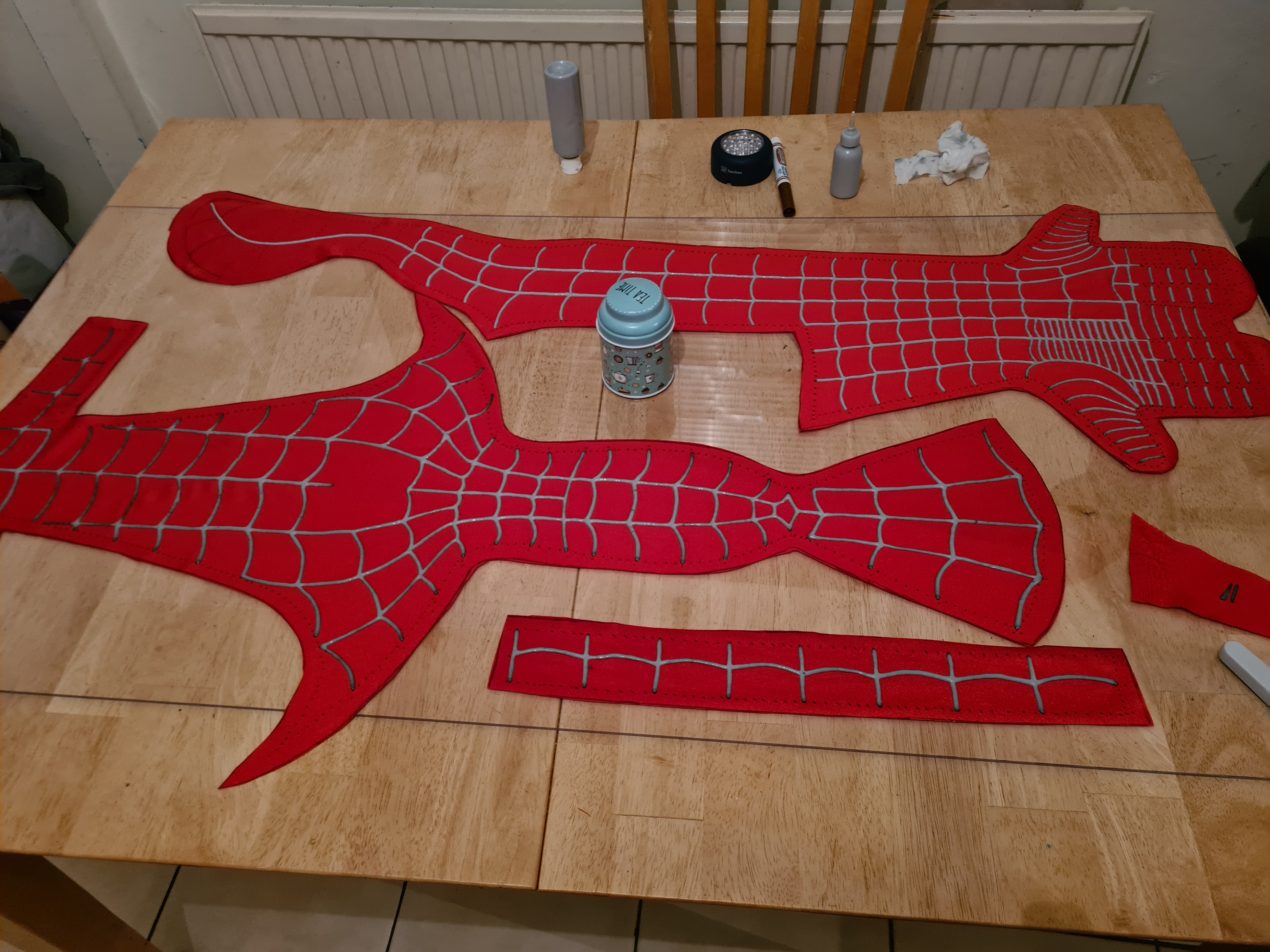

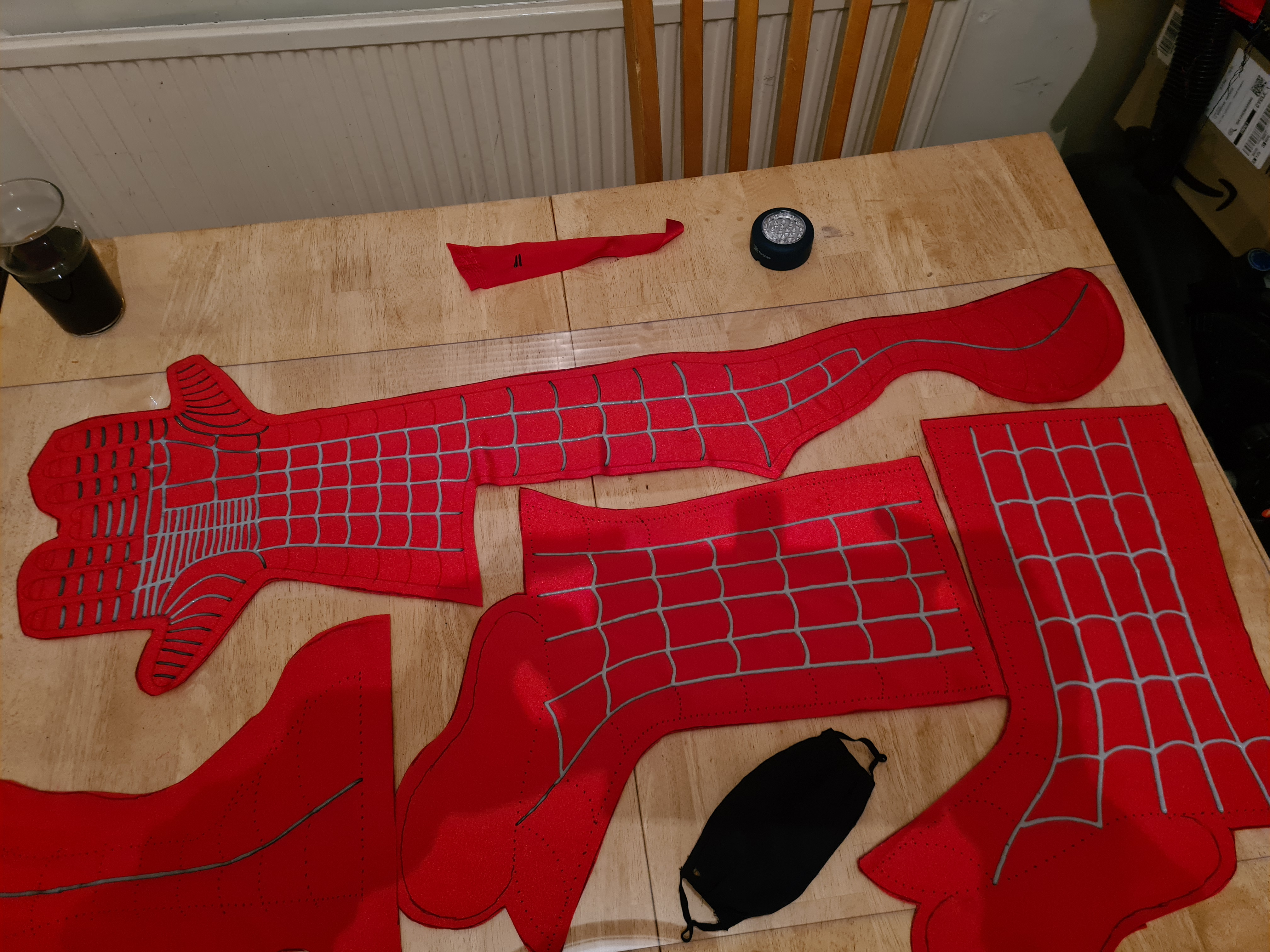

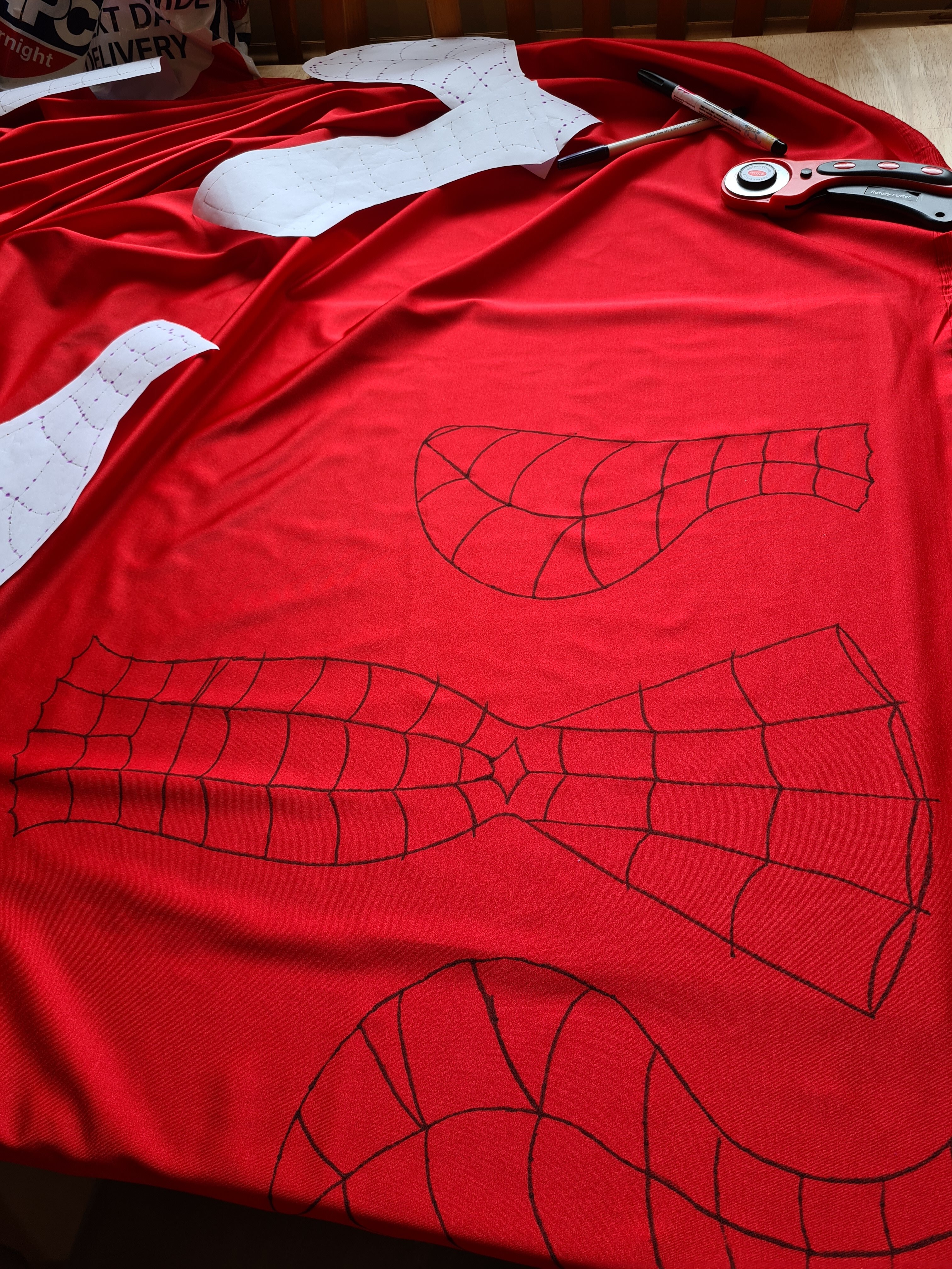

So first things first, I started by using the pattern made by scratch thread patterns, who I believe make patterns for the amazing spider-lab. Great pattern and the sewing guide is what I used to mark out onto coloured fabric, no sublimation on this suit.

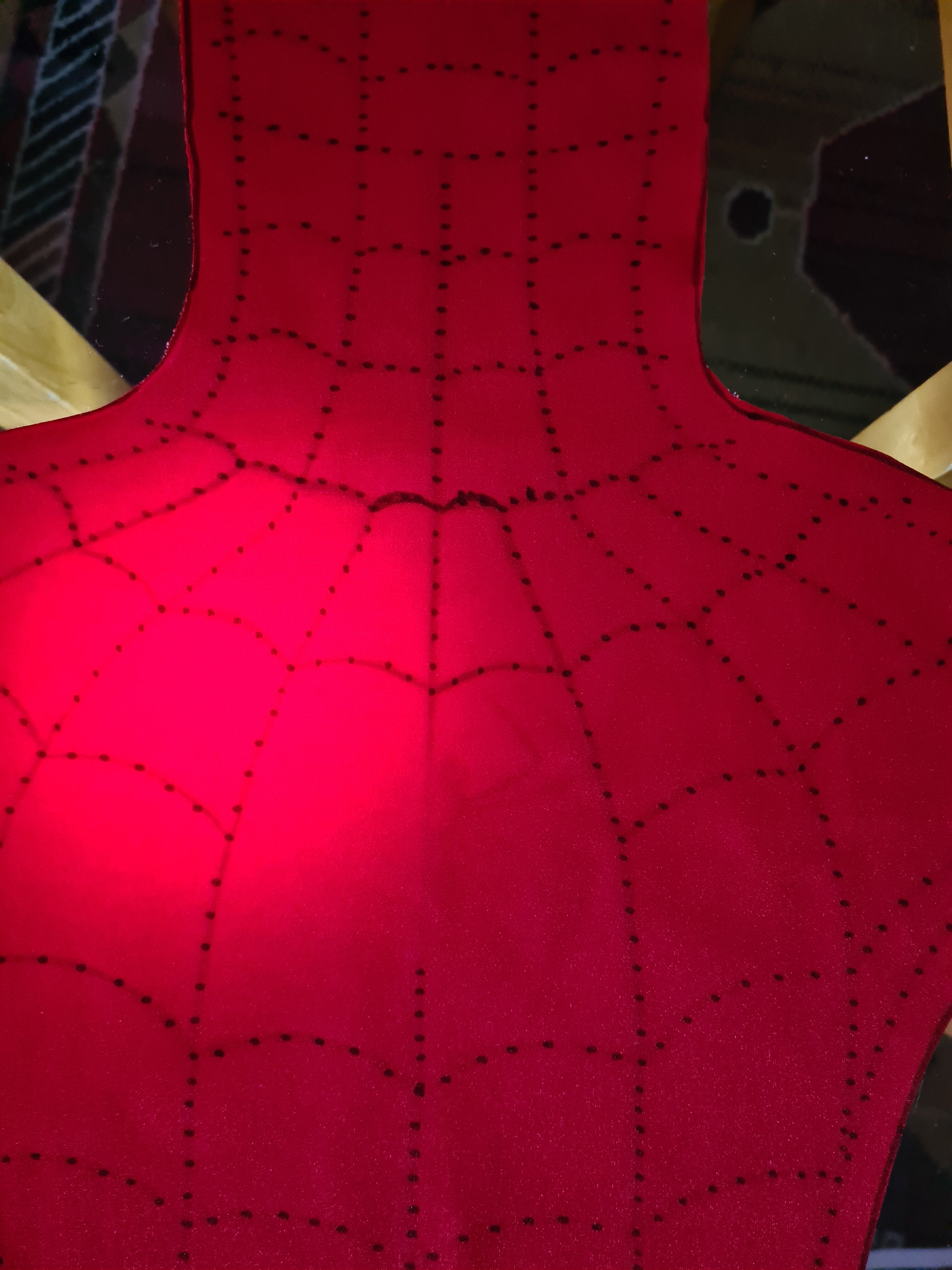

Once I'd traced it the pattern by using a torch under a sheet of acrylic with the pattern paper below the fabric it was time to start painting.
For the paint after testing with slick paint and latex I decided on the latex. It stretches and returns perfectly unlike puff paint and peels off easily with no marks left if you make a mistake, I'll try a test with a puff/latex mix in future too to see how that turns out. Also seems easier to make clean lines with the latex. I didn't paint the seams along most of the webs as I wasn't sure how accurate my sewing would be as it's my first time trying so thought if they don't match I can just paint them once sewn for perfectly aligning webs.

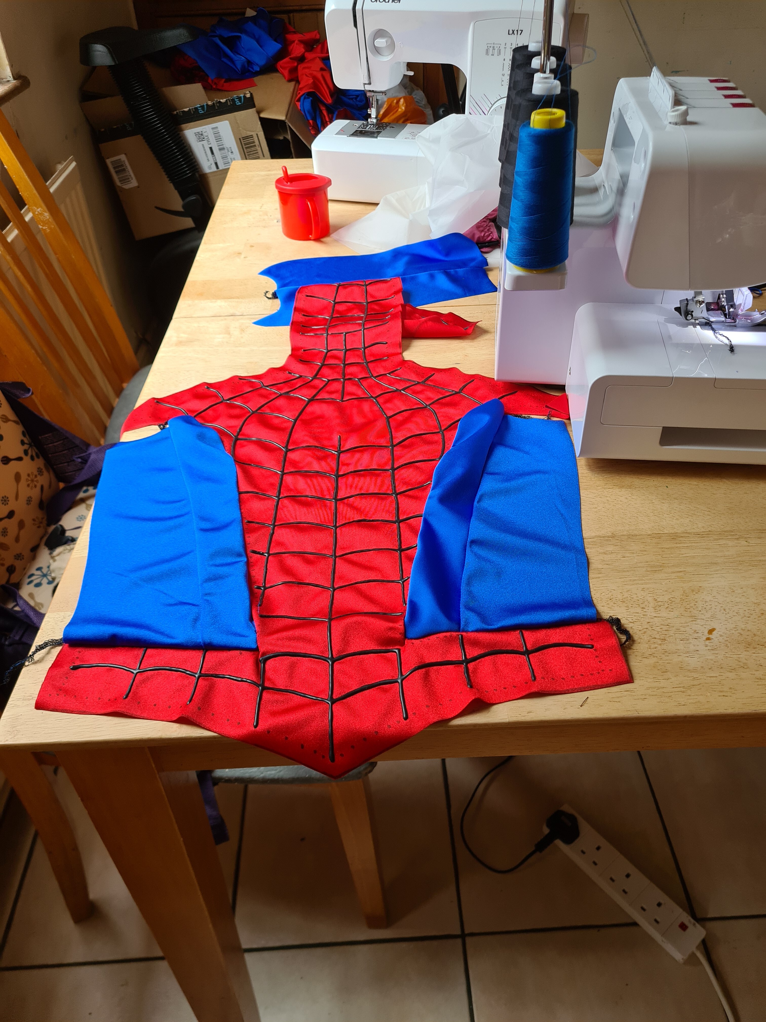

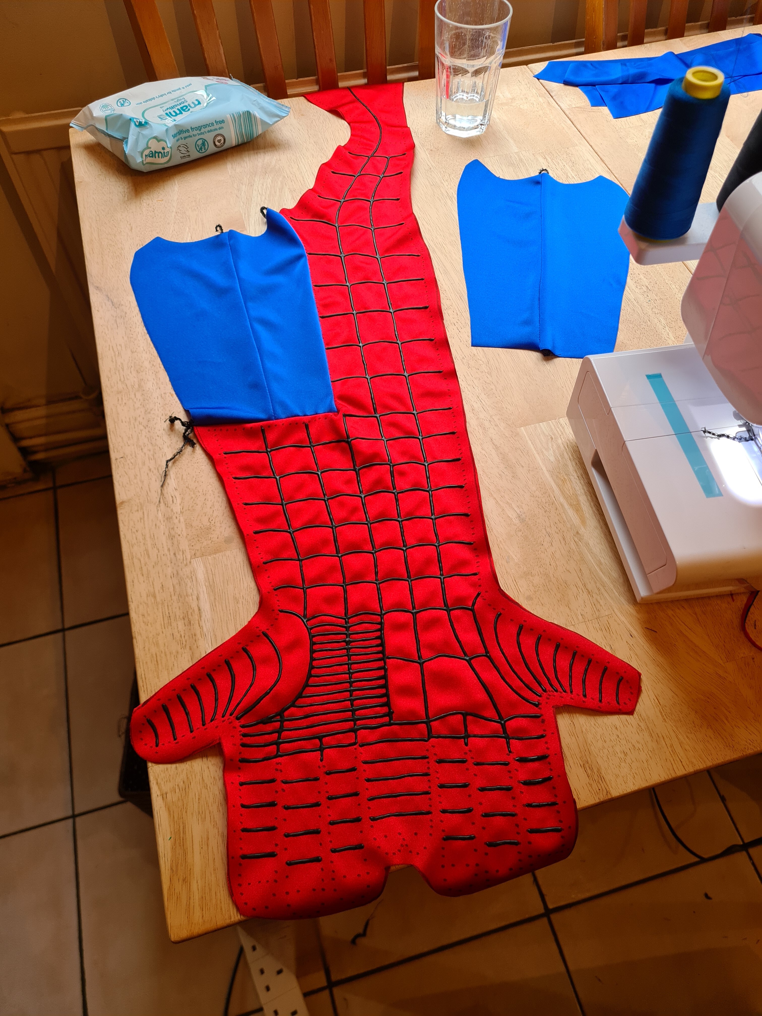

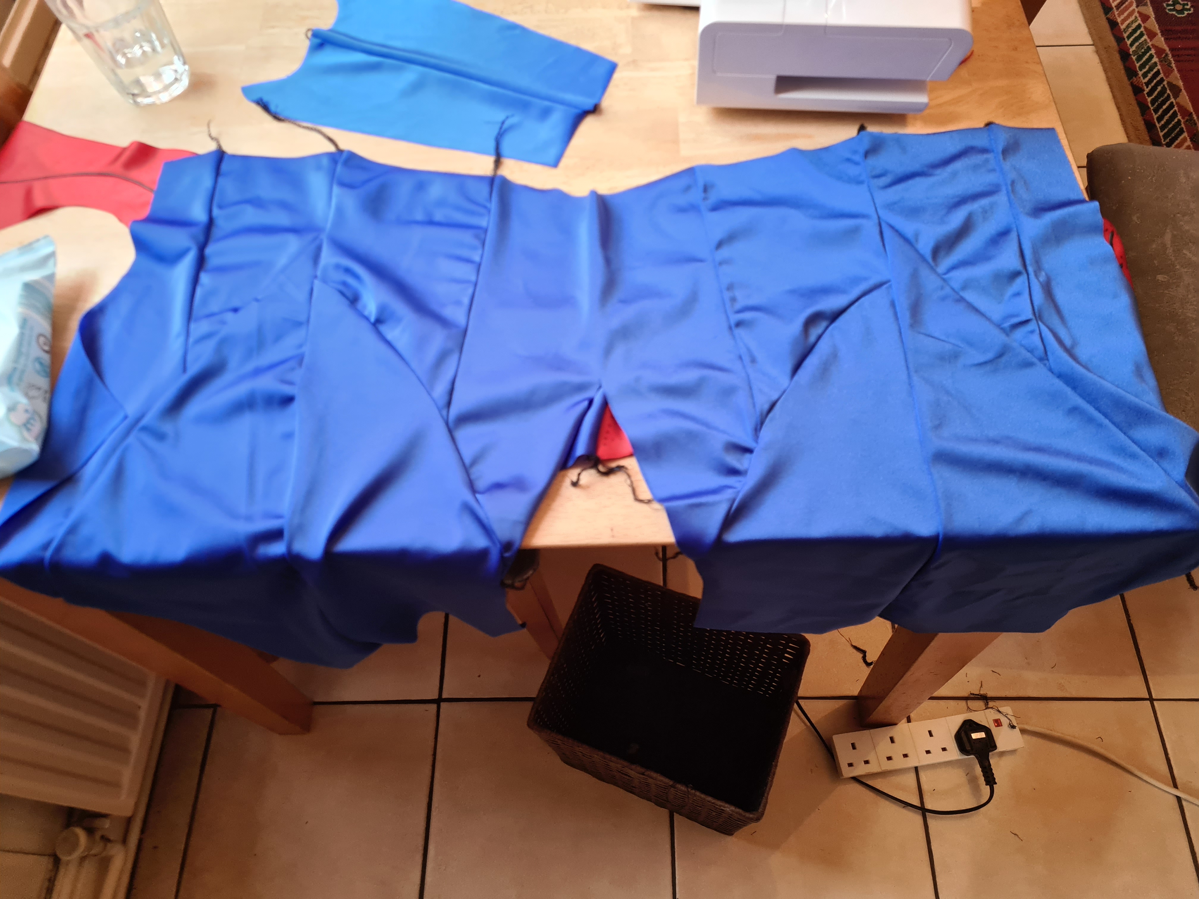

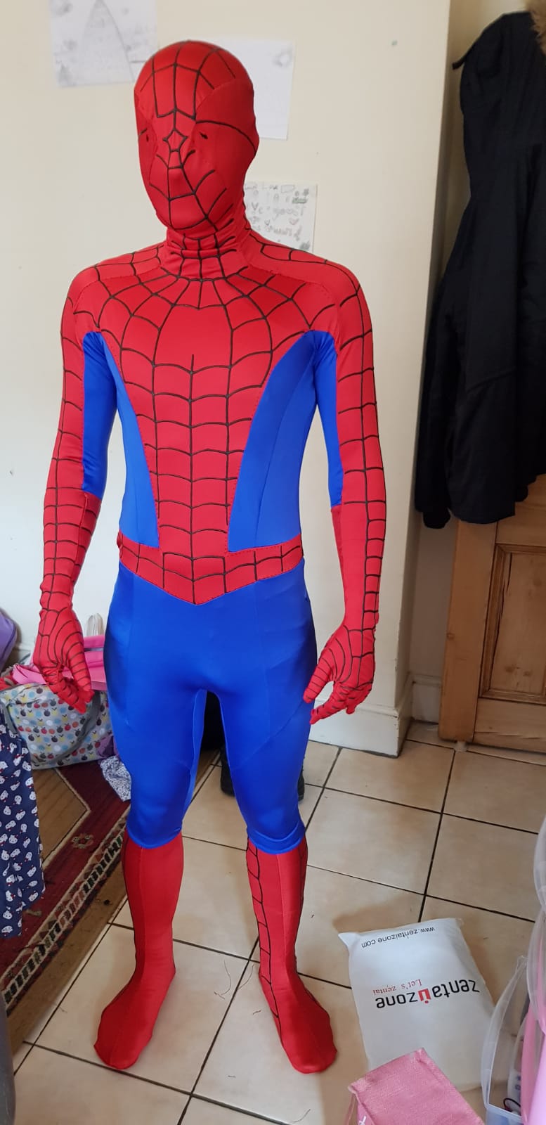

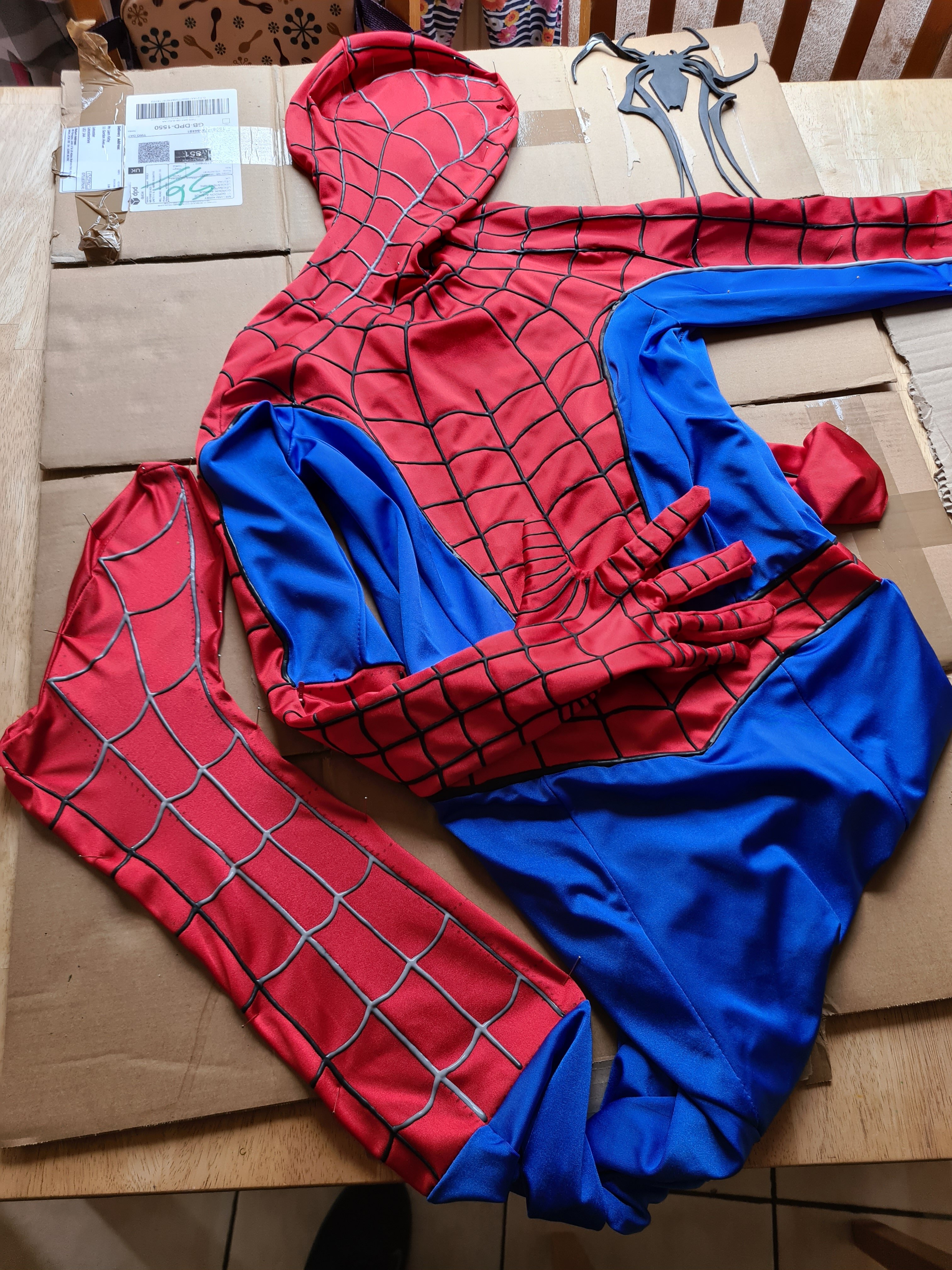

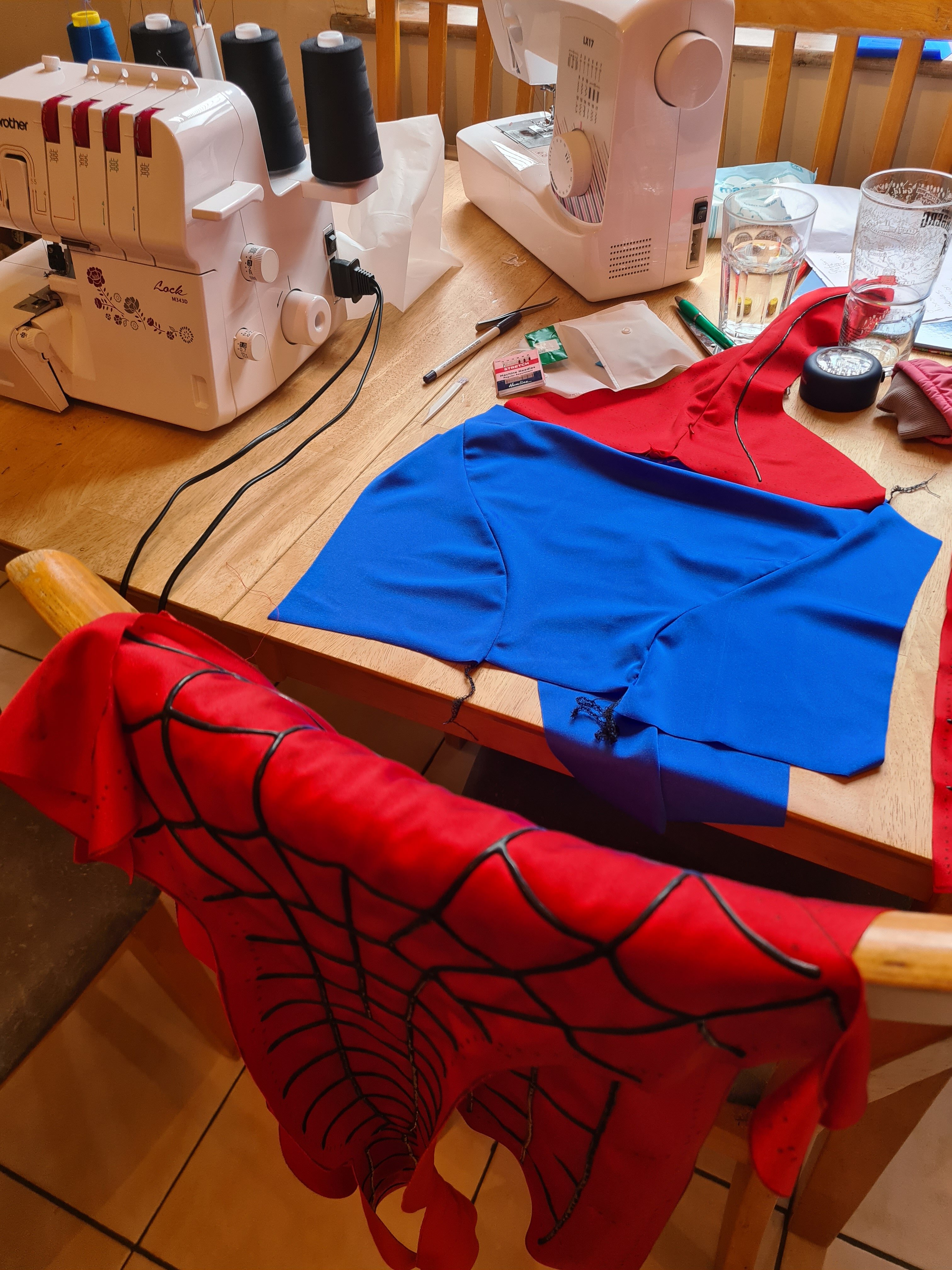

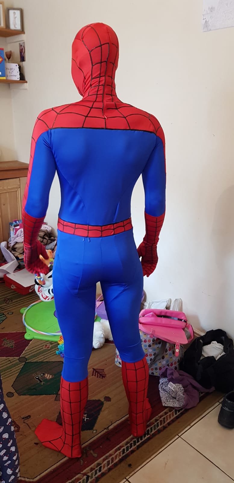

Once the painting was done it was time to start on the sewing, not an easy task with all of the different panels that make up this costumes blue sections but i IMG-20210516-WA0012.jpgthink it turned out OK.
20210512_200327.jpg20210513_184533.jpg20210514_102558.jpgIMG-20210513-WA0000.jpgIMG-20210513-WA0003.jpgIMG-20210516-WA0009.jpg

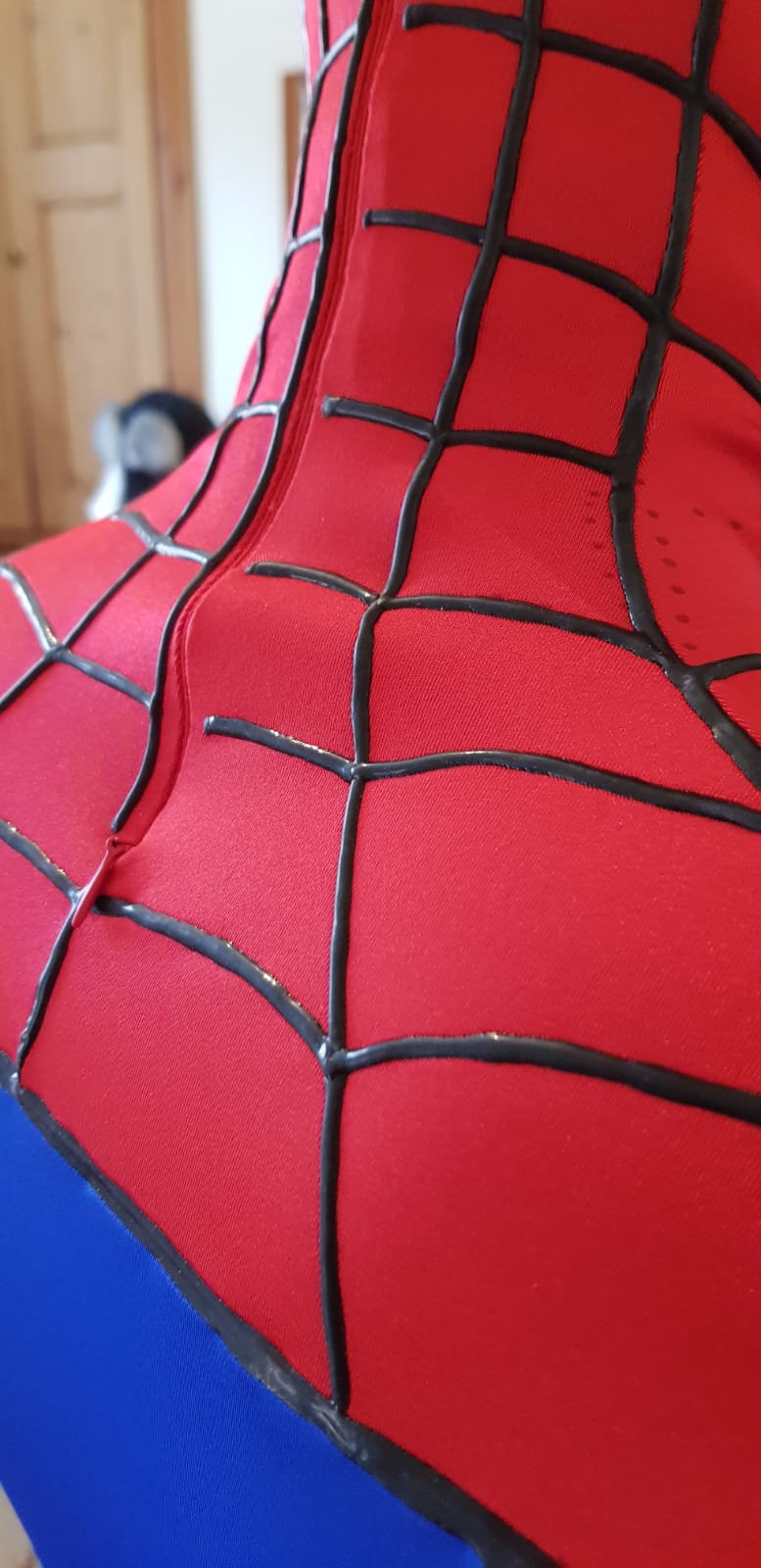

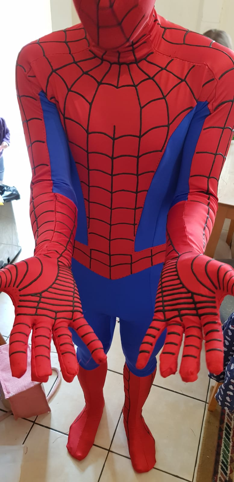

The sewing on the red was a little easier as the fabric is very thick, twice as thick as my zentaizone suits and hard to put into perspective on pictures.

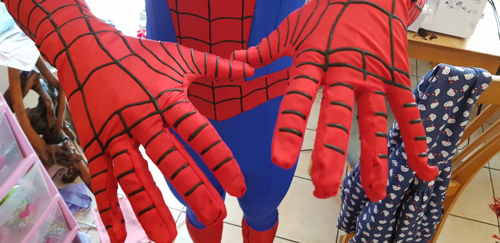

By far the hardest part was the gussets I'm the hands, found it much easier after the first to do the second on a normal sewing machine and it was much quicker and cleaner, unfortunately the fingers are a little long. Same with the mask zipper, it's a little wavy as I think there's not enough stretch so I'm thinking if I wear a faceshell it might help, still need to try it with my tjack asm2 shell to see if that helps.

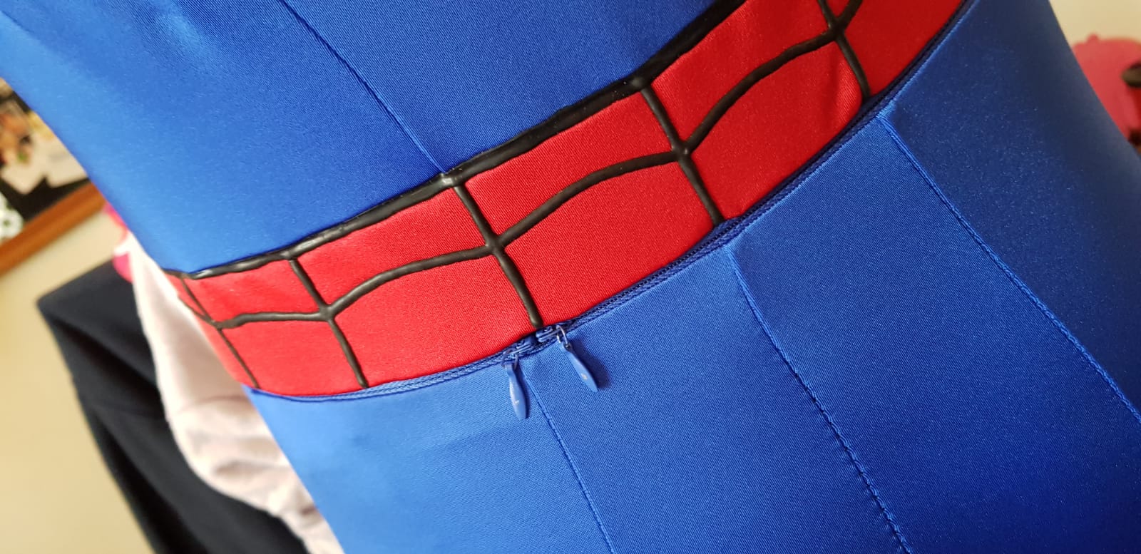

The uzip was also a pain, I future I'll do a zip up one side and around d the red to the middle of the neck or have a sepersting waist zipper like I did for my 7 piece asm2 costume that herostime made for me.

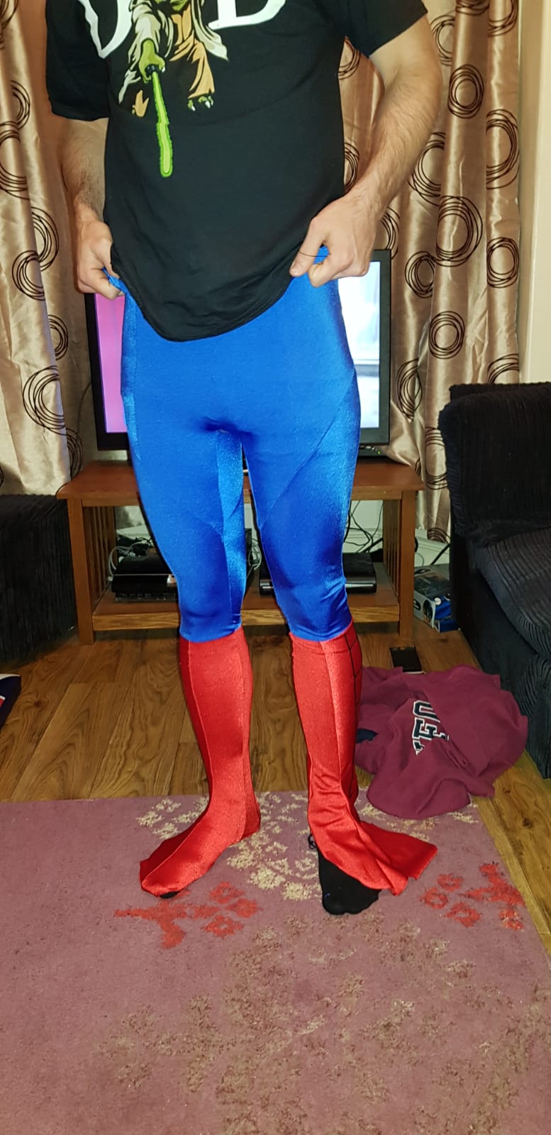

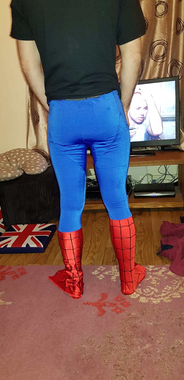

Still finishing up the last of the painting, so much harder once it's sewn. After that I'm on the process of modeling the spiders in 3d to print mold and cast in rubber. I've made an asm2 chest spider which isn't perfect but is close enough for me so am confident they should turn out well. I've ordered some scuba boots as they have the perfect shape but the site haven't sent them yes abd are dodging my calls and emails trying to get and eta on when they'll be sent.20210523_130402.jpg
