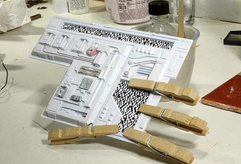

The bottom plate was cut and detailed. Mounting hole was surrounded with a hollowed out clothing button.

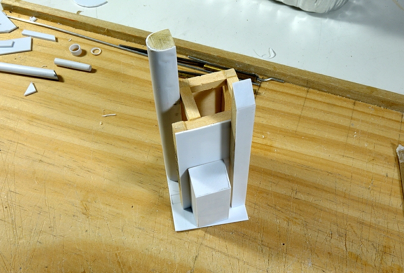

The sensor/antenna array that protrudes from the bottom was started with a hollow wooden frame to create a basic box shape.
Other geometric shapes were added, I then skinned all of that with styrene. The tall object on the left is a piece of
wood furniture molding cut down to shape.
Additional antennas were made from wood dowels, cut and shaped, sanded and coated with 3 coats of varnish.

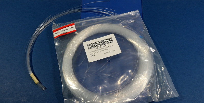

A 200 meter (656 ft.) roll of end glow .75mm fiber optic strand arrived.

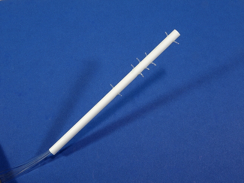

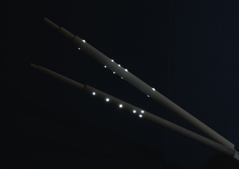

I drilled 10 holes in a styrene tube, 5 each side, then pushed the fiber thru the holes and out the bottom. I also did a
second one, a bit taller, drilling 12 holes. 6 each side, for 12 strands with a different hole pattern.
The ends will be cut flush.
Combined both poles fiber strands, a total of 22, into one bundle. I built a chip board box to contain it. Used a
2835 (3) LED group folded into a "U" shape, and anchored the strands with a drowning of PVA white
& clear glue.
LED test fire....

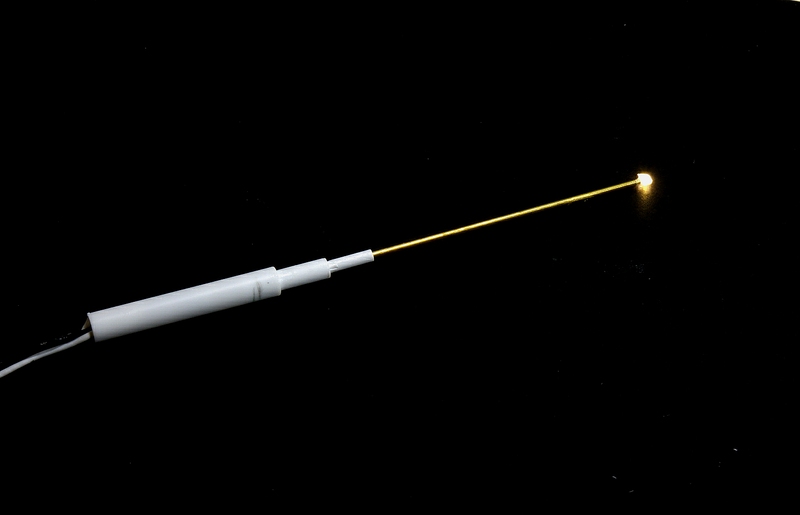

I wanted an additional stand alone unit, which was built with brass tube at the top, and telescoping styrene tubes
at the bottom. The styrene base was needed to prevent any shorts for a hidden series resistor, which feeds the
SMD 0603 LED at the top...

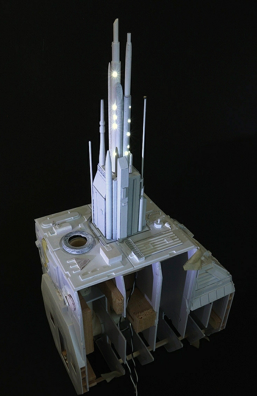

More spires added...now complete and in test fire mode.

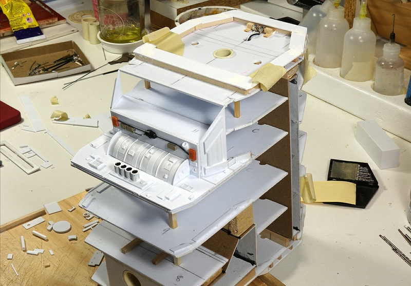

I switched back to the superstructure of the midship. I applied both sections of windows, and set those aside to dry.
This concept ship has a "familiar looking" 2 level command center at the top.
I started on the major details on the roof first.

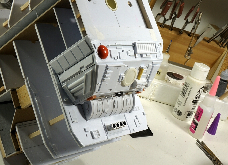

I worked on the hexagon shaped tower/tank first, with a rectangular balsa wood core, and then 3 pieces of hexagon
shaped styrene are glued to the top, bottom and middle.
Next, largest 4 sides are built out.
Next, filled in the small 8 sides.
I added 4 legs, and other "control box" detail. Nothing painted yet.
I made two additional "tank-like" devices as in the concept art. I also have begun the 4 antenna array behind these units.
Till next time... build the 2 level Command Control Center.
