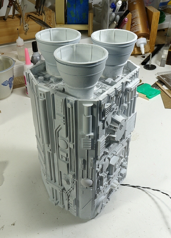

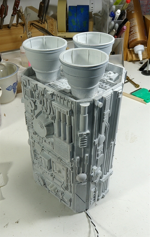

All 8 panels were glued in place onto the stern bulkheads.. the entire unit is approx. 6 5/8" (170mm) long and 4" (100mm) high and 4" (100mm) wide.
A primer coat of white was sprayed on the engines before attaching. I used .010" (.25mm) styrene sheet as a diffuser to fit against the blue LED, to cover the thrust chamber of the engines.
Engines now permanently mounted, and will allow 24 hours in this position for the adhesive to cure.

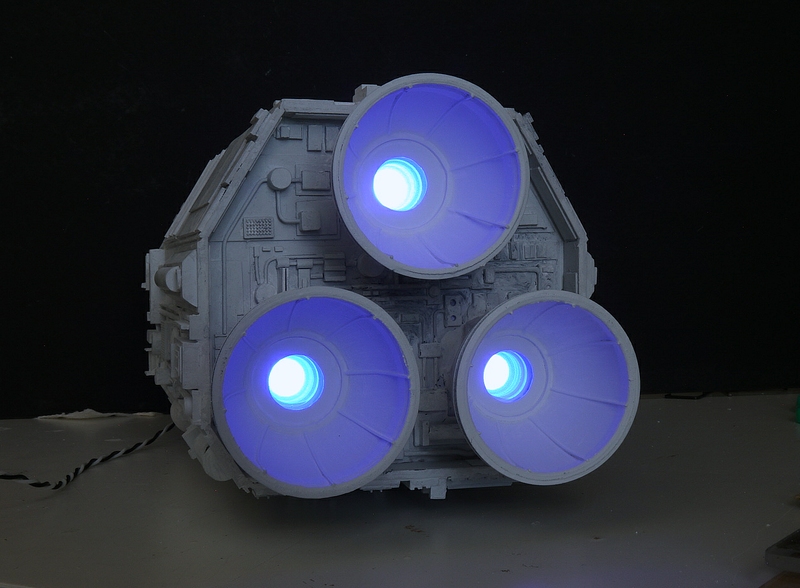

Now I could test fire the engine lighting.

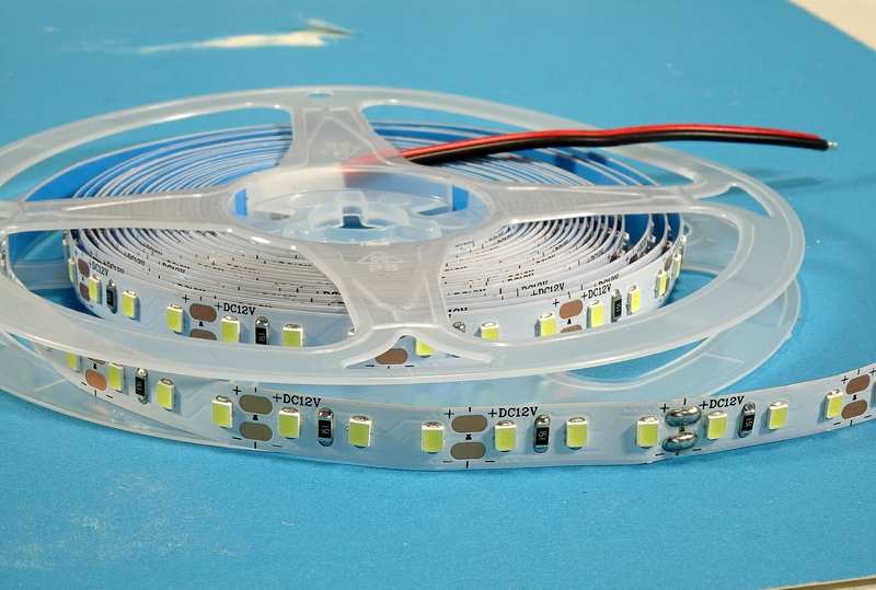

Finally the 2835 high density LED strips arrived. I can now return to working on the bow.

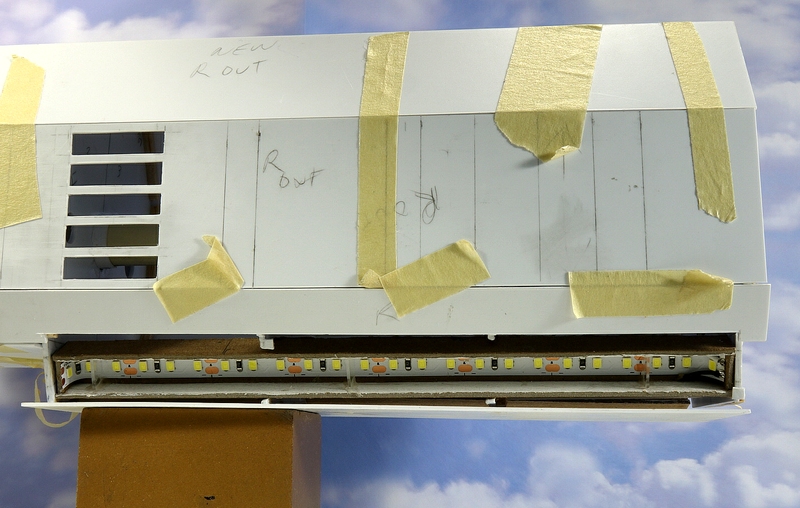

This is the area I'm preparing lighting for.......

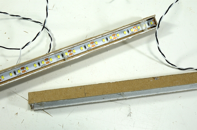

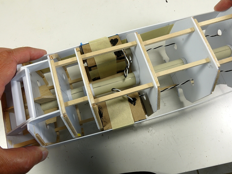

I built two "light boxes" of .06" (1.5mm) chipboard to hold the LED strips in place. Each contains 24 LEDS.
In place for a test fit. Nothing glued.

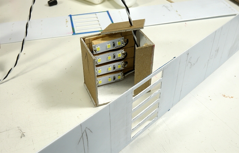

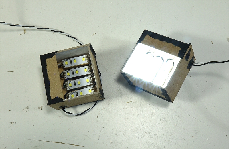

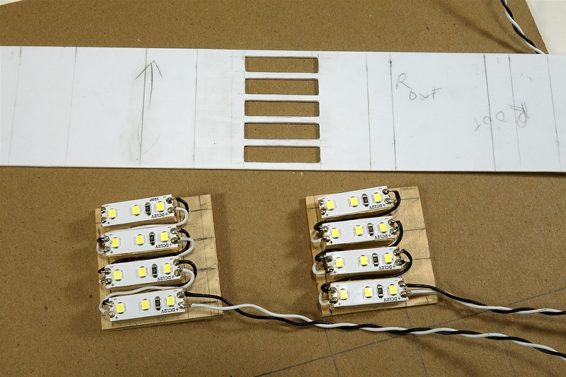

More lighting for the bow...I built two light boxes for the 5 short horizontal window groups. I cut apart the 12 volt LED tape
to make 4 LED strips ...3 LED's each. Wired in parallel. Mounted on thin plywood.
Then, .06" (1.5mm) chipboard built around.
Test fire.
I installed small shelves in the bulkhead carcass to temporarily support both light boxes, which will hold them steady
when they are finally glued in place.

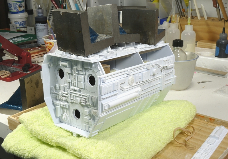

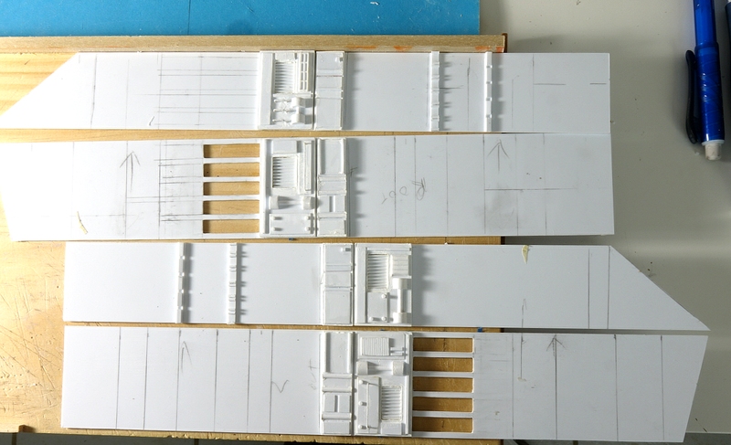

With lighting for the bow nearly complete, I could begin building and detailing the upper and middle sections...
I started on the simpler sections, using the concept art as a guide for construction of shapes, and a lot of imagination.
Everything was built twice, to mirror most of the elements for the other side.

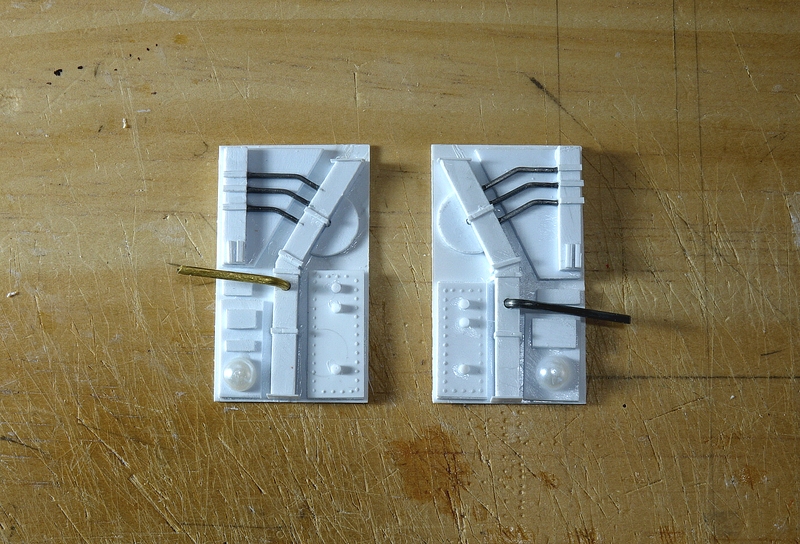

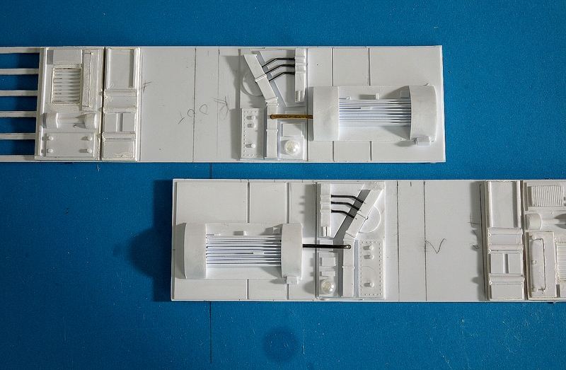

This "heat sink" thing will be at the tail end....
These units will connect to the heat sink with the loose pipe....
Units cemented in place.
