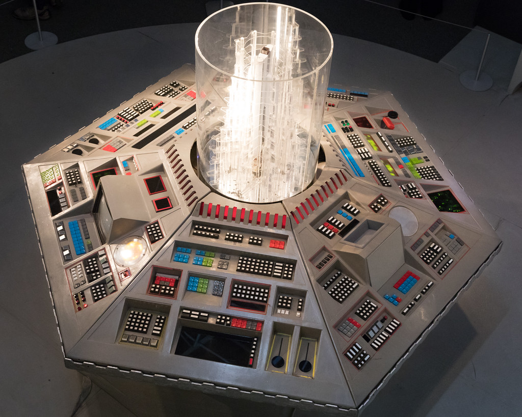

You might use the keys from old keyboards. Spray paint the keys and glue them in groups to look like switches. They actually did that on one of the control consoles in classic Doctor Who. Using different colors gives the feel of a color coding system for the controls.

Actually the bumper come in white, black and grey... common switch colors. You might not even paint them depending on what look you decide on.

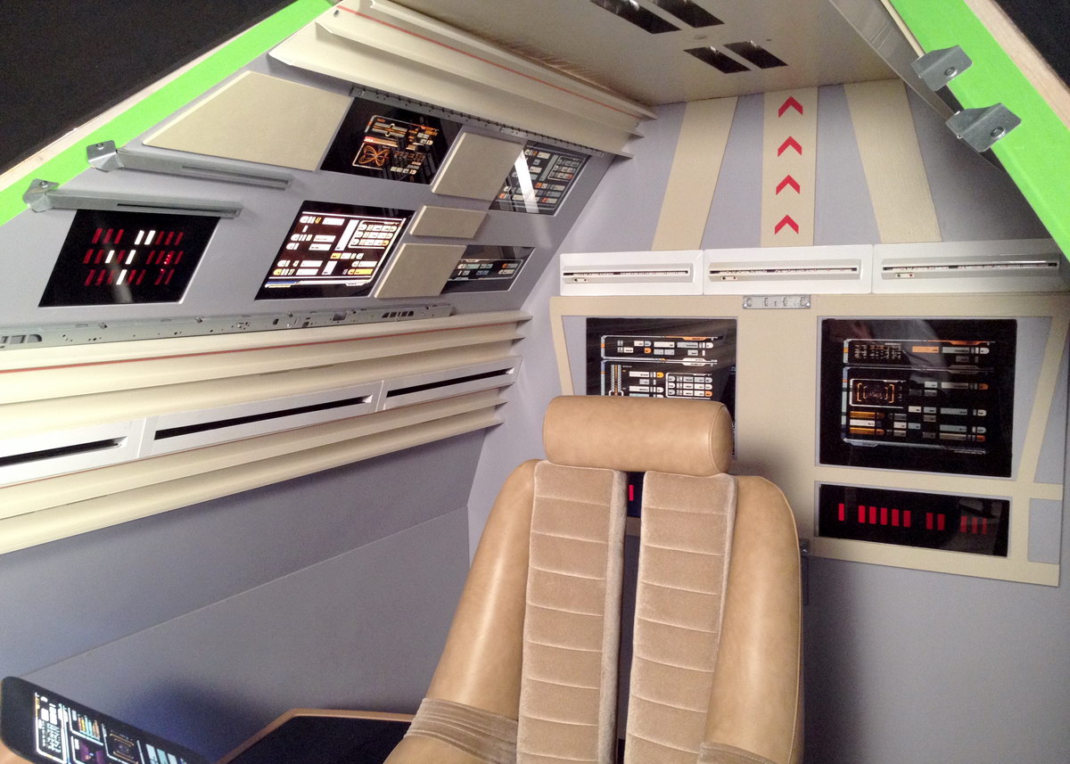

Being youre after a heavy equipment transporter train type of feel, the slick and modern sci-fi look and fancy panels isnt needed. Youll likely spend more on wood for framing than the actual interior itself. Spend it where you need it. With coming up with a design consider the materials involved. Foam core is a dollar a sheet but many times youll find better materials on the materials section of craigslist, or even for free in the free section. Think about lighting, you want it to be practical yet within the confines of the cabin. At the same time you have to consider camera placement, thats where a fly out wall or panels will come into play. Thats just a section of a set wall that can be quickly removed and replaced at will. Dont overlook the floor! The typical sci-fi or industrial look is a grated floor. Plastic shipping pallets are the go to for sections where pallet racks are used for structural or larger sections you see on space ships or such in tv/film. You can get plastic pallets off craigslist for about $5 or $10 each or even free if you go out hunting. They also double for walls and even tables. For ceiling grids look at bread tray pallets. Literally what you see bagged bread being shipped and stored on in super markets. The grid ceiling is an old sci-fi gag that gives you texture and mood in lighting. If you get some movement going on those grids will give lots of live to anything beneath. Add a little haze for atmosphere and youve got some depth. A little haze goes a long way.
Places like Apex or other industrial surplus shops are great to get inspiration but will quickly drain your budget for just a few items. Where a completed static panel off the shelf will look nice, what will it cost to get the amount needed vs a few rolls of pin stripe tape, foam core and some clear bits (packaging, clear plastic sheet, scrap plexi...) to make the same but better. If you know the basics of LED's some off the shelf fx gags are easy to do for panel illuminated buttons/screens. Meteor/twinkle/Rain Shower strip LED's have a built in pattern and can be used for panel lights with some basic trickery. Again spend it where you need it. Being a train type setting maybe consider a roof or wall mounted mesh cargo or overhead bin type section for the pilot/operator. You have limited space to make the interior personal for the character. A backpack, change of clothes, lunch box... something to give the visual the character is in it for more than a minute.
The ship interior pictured is about what $200 in materials will get you. In the case of whats shown it was all spare materials and a rush job. Took about a day total to build and paint while working on other stuff. It wasnt the design but what time and budget allowed. Just made it up based on what was on hand. It had blinky lights and illuminated panels. The meteor LED's mentioned prior gave life to static printed out control panel graphics.
In the other photos you can see what grates will do for lighting along with a little haze. The wider picture shows worn white metal panels used as a wall and vents. Those are simply ceiling light fixtures sourced for free from an office building that was updating the lights. A lot of sci-fi wall or panel parts are just something everyday turned backwards in many tv shows and films. Its just not the way youre used to seeing them.
