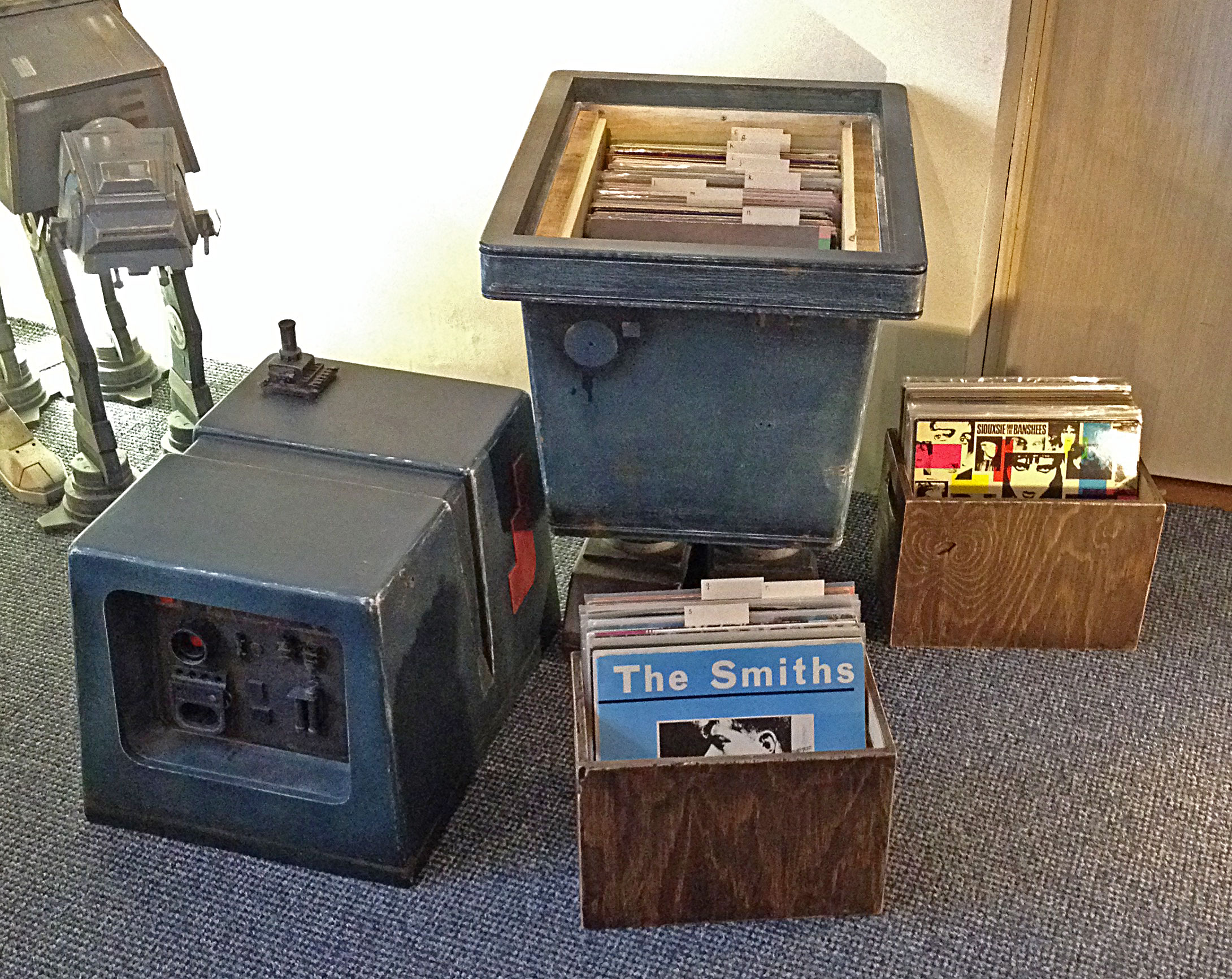

Edit 2018..Sadly my image hosting has gone under so for now there are only a few of the original pics of mine on the thread and now you have to click each pic to make it lovely ad detailed :)

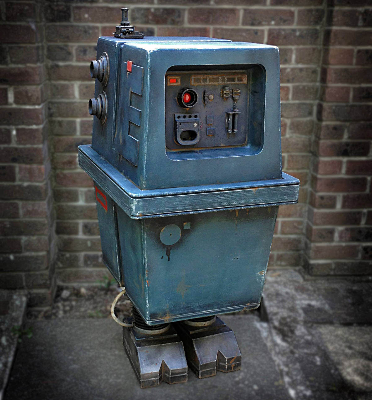

Ok now I posted this little guy on my thread "Spacebobs Droids" and he has recieved more love than Barry Manilow.
This thread will cover how to build one and then hopefully provide research and info on updating the insanely simple plans to make the difinitive screen accurate Gonk :)

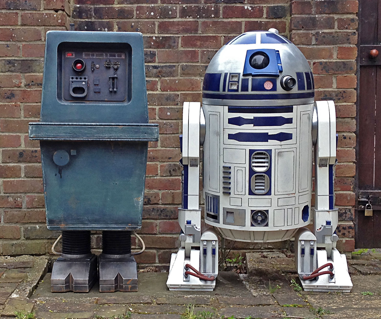

I gave up tying to find out how tall this prop should be so in the end I just made mine slightly shorter than my Artoo.

Bob, thanks so much for making a thread. Your GONK is by far the best I've seen. I love your design and its simplicity! I've got to make one of these for sure!
Very well done. I like the extra use you put him to also. I like the idea of a small bar inside perhaps with an ice chest in the bottom half.

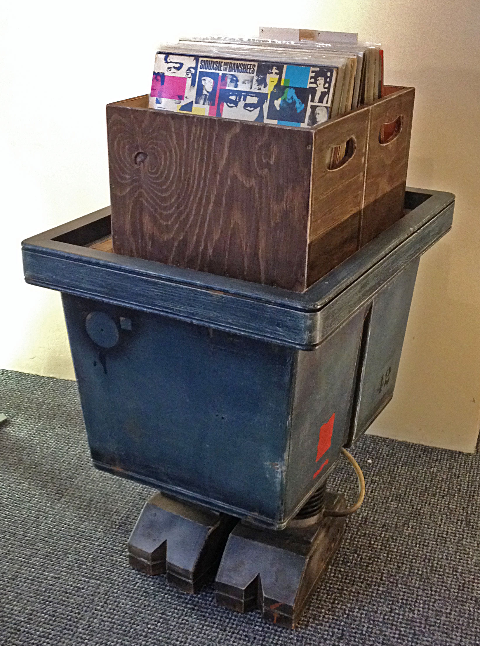

I have been watching @Torron build his and think this will be my next project. Trying to decide if I want him to serve a purpose still. If I do, what purpose should he serve?
Your's is a record holder. I saw ne that was a charging station for Game controllers and another that was just had surge strips mounted into him. That way he was an actual power droid.

Thanks for the nice comments peoples, can't post any more pics at the moment but I think he's good for any kind of storage or modding.

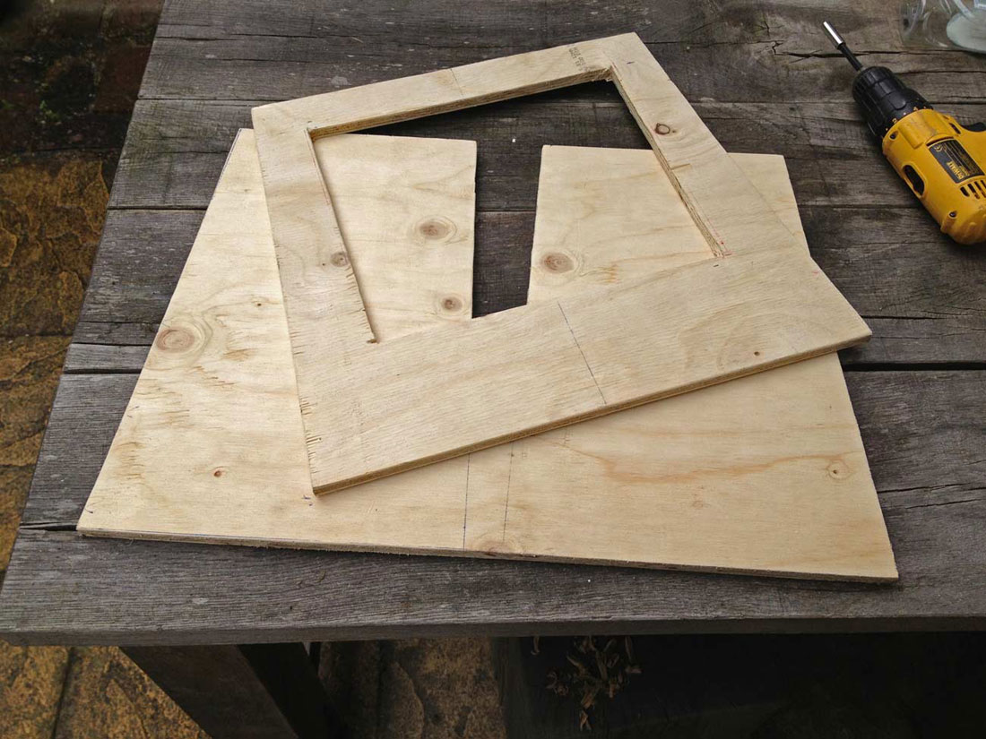

Well yes you could.... the problem is always getting the rounded outer edges. You would need to make the corners thicker from the inside so that after routing the outside edge it doesnt fall apart.

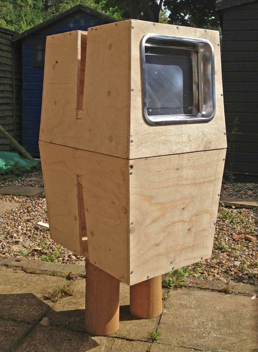

Here are a few more pics
1/2 inch 12mm cheap "shuttering ply" is all that is needed if you are weathering heavily.
As you can see the construction is insanely simple, it just glues and screws together, when the glue has set the screws can come out and their holes filled ready for routeing.
The midrail is simply glued and screwed to the sides of the bottom half and this makes a seat for the top half which just sits in.
I think that the base/bottom piece of ply is actually either much thicker maybe 3/4 inch 19mm ply or two 1/2 inch ones glued together.
Anyway it needs to be thicker :)
