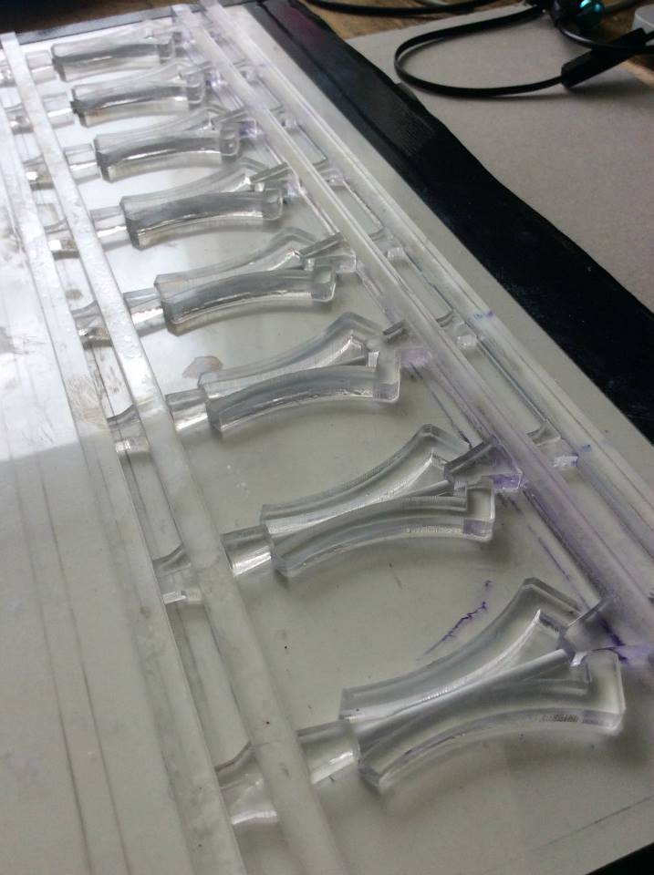

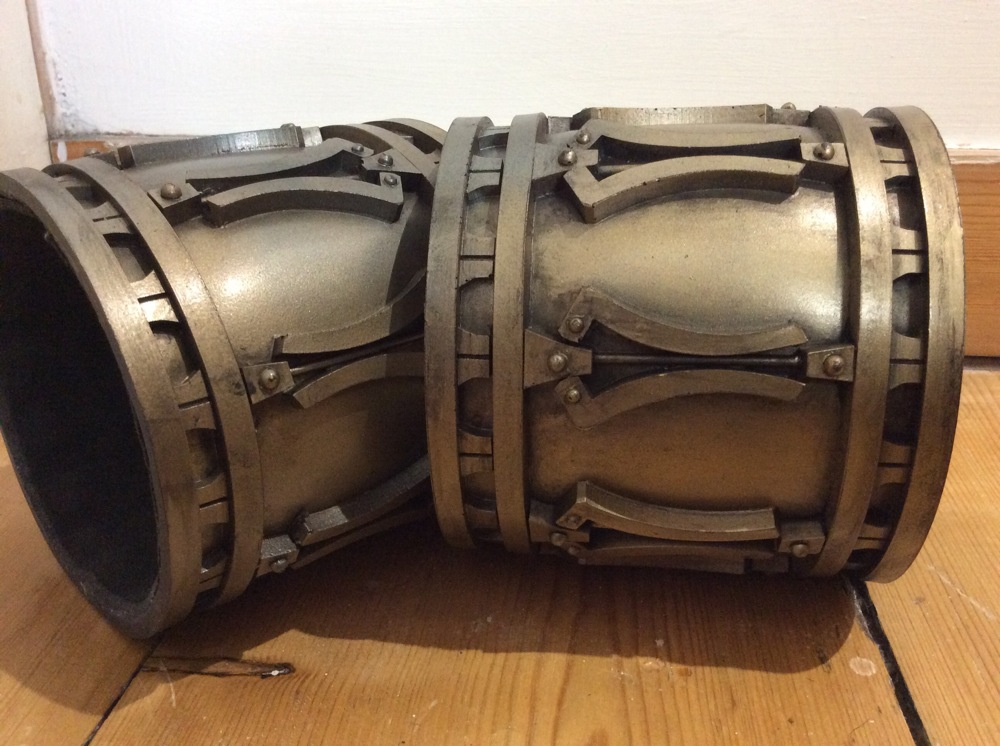

The arms were made flat out of 3 mil translucent acrylic. I designed each part separately on photoshop by mesuring them on the action figure I had and resizing them so they'd fit me ok.
I had them Laser cut and glued them into place to have the final pattern.
Box mould and cast in Urethane resin, bended into shape while they were still curing.

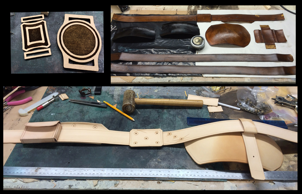

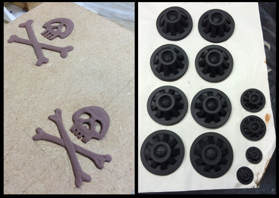

THE BELTS COGS AND TRIM
DAMN YOU ACCURACY! We just had to make the trims...after looking for months to get them as close as possible with store found items, we decided against the idea.
Same process as the arms, just a LOT MORE FAFF, as each pieces were glued separately to create a good length for the mould.
The cogs were 3D printed on different sizes so they would fit the armour and both our ankles.

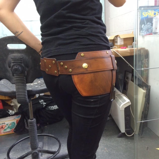

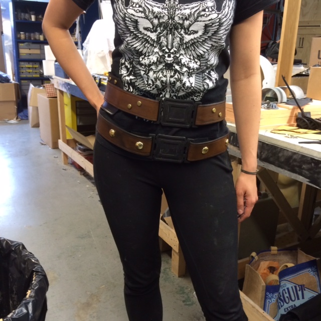

the belt buckles I cut out of MDF in order to save money which ended up being a real pain in the ass to clean after. it served the purpose as we were running out of time at that point, but jeez! a little more money would have allowed acrylic and a much better cast! you live and learn I guess >_<
Belts are made out of veg tan 3 mil, tooled, glued and riveted into place. I used the antique dye, as I love the shades so much, and it gives you a real multidimensional feel.
