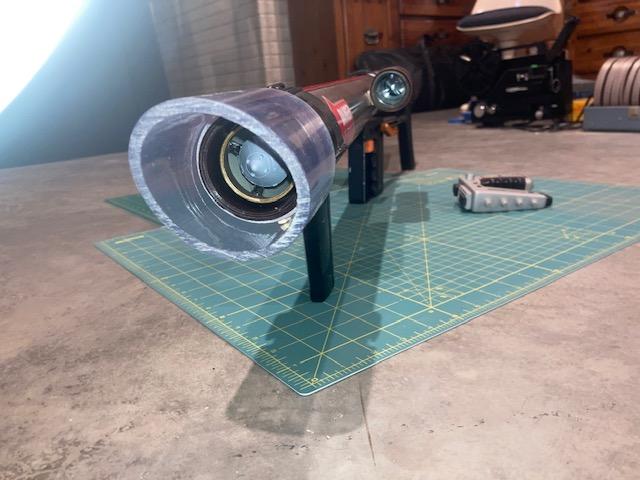

Did a build of a modified version of a Space 1999 laser rifle. Someone did a perfect representation of it on yourprops.com. I had the best of intentions at the start but it quickly descended into shabby workmanship. Feel free to let it inspire you for your own ideas. Overall length is 43 inches from tip to tip, using a piece of 2 inch ID, pvc pipe schedule 40. Parts off a Airfix Saturn V model kit, scale 1/144. A Kaiser 6005 camera shoulder mount for the lower grip, and some camera shutter releases for the two remaining grips. The button assembly on top came from a Nintendo Super Scope rifle. Ordered the monocular scope and decals off of Ebay. Colors used were Metallic Chrome high gloss spray paint by Duplicolor. The rest were Testors Model Master spray cans, Euro Gray, Go Mango Orange, semi-gloss black and flat red. The stun gun model was from Wilco about 19 years ago when that particular kit version could be found at Monsters in Motion.
Looks pretty good. You might want to sand down the acrylic tube at the end and flame treat it to remove the saw marks.
