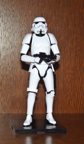

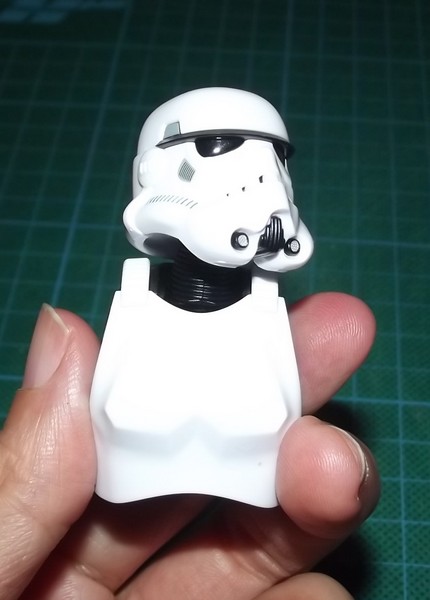

I am currently building the Bandai Stormtrooper and have found a very simple solution to the short neck problem.

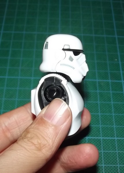

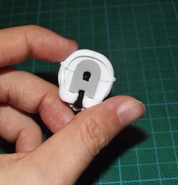

Instead of cutting the neck joint and prolonging it by adding some of the unused polycap parts I chose to insert a piece of foam into the head:
Neck before...

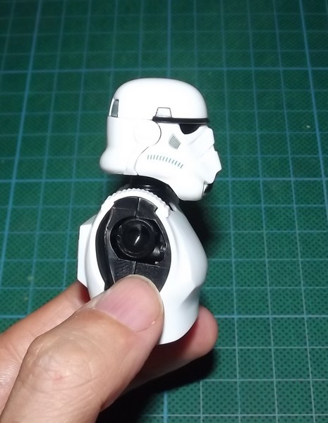

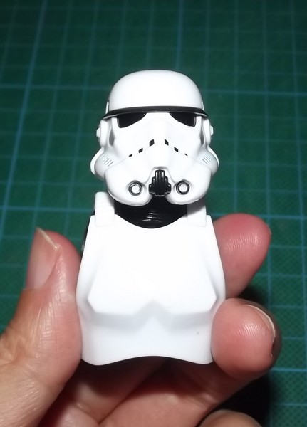

... and after the insertion.
As you can see, the head is still fully articulated and held in place firmly by the foam piece. The thickness of the foam piece determines how far the head is pushed up.

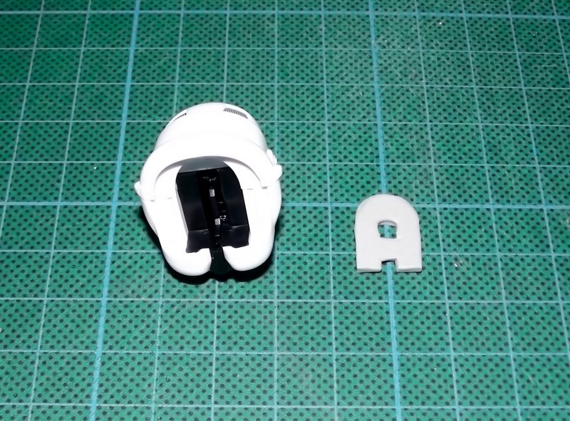

The best thing is, this procedure can be applied to models which have already been built. I'll add a template which you can print to make your own neck extension piece shortly. :)

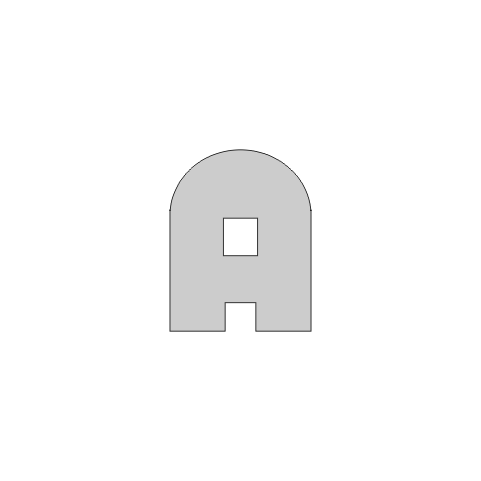

OK folks, here comes the template - as promised ;) :
Print the pattern at 300 dpi and you will be fine. The piece has to be a tad larger than the recess of the head to make sure that it does not fall out of the head. In addition, the hole in the center must be big enough to hold on the joint firmly (don't cut it too big). Have fun and enjoy! :)

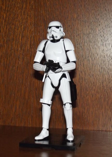

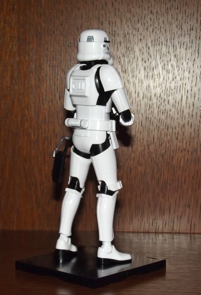

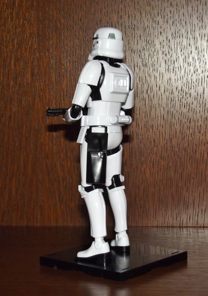

2 mm foam will suffice. As I said, the thicker the foam, the higher the neck. Here are some pics of my finished build (with neck extension :D ):
What's best about this way is, you don't damage anything and you are able to display the model as originally intended if you take out the foam piece again. :)
That guy in the front does look a little short for a Stormtrooper. Maybe he's undercover!!
