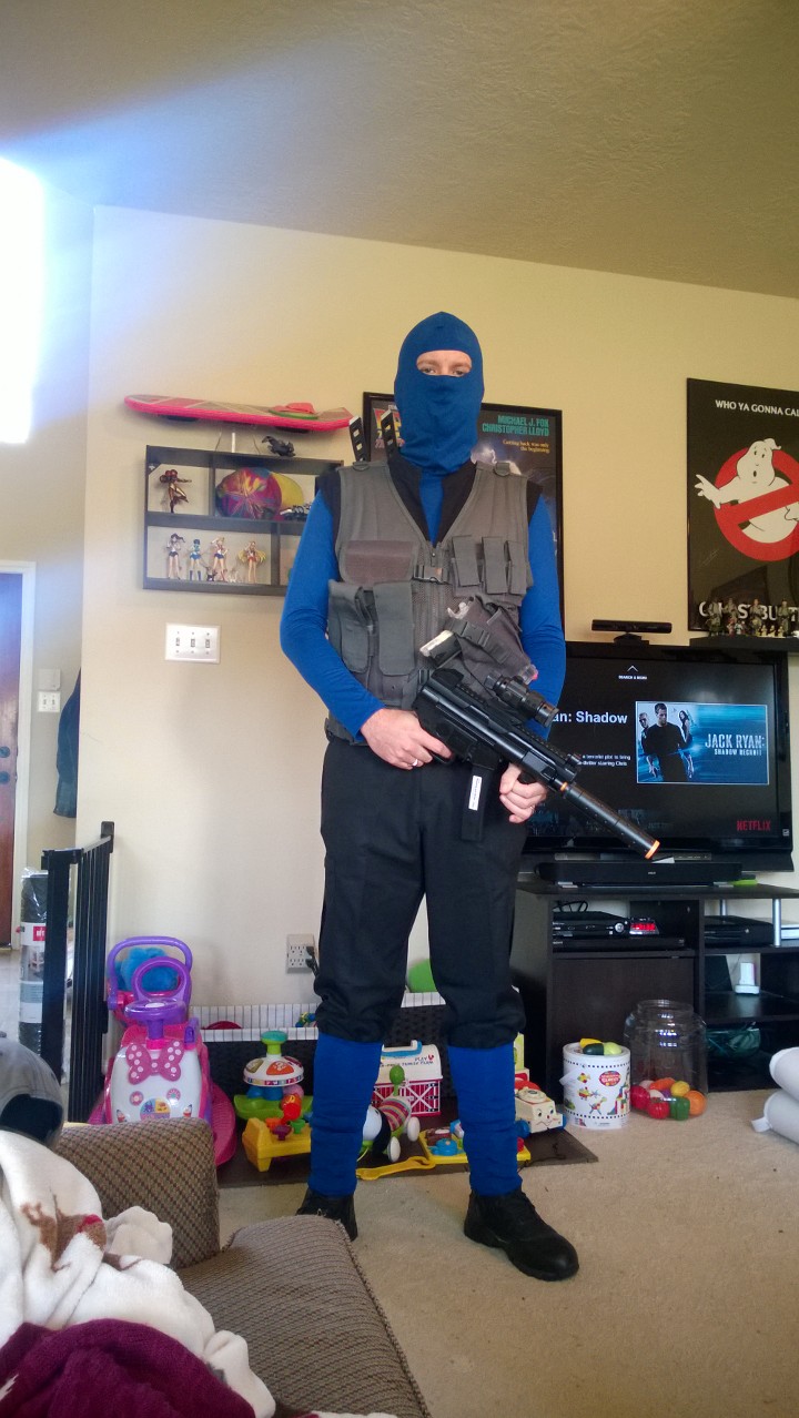

Then I started work on the Balaklava to go under my helmet. I bought a second of the same blue compression fabric shirts to make the balaklava,
then I grabbed an old broken airsoft gun and tried on everything I had at the time. The results were less than pleasing, I looked like a scrawny counter terrorist from counterstrike source.
It gets better, trust me.

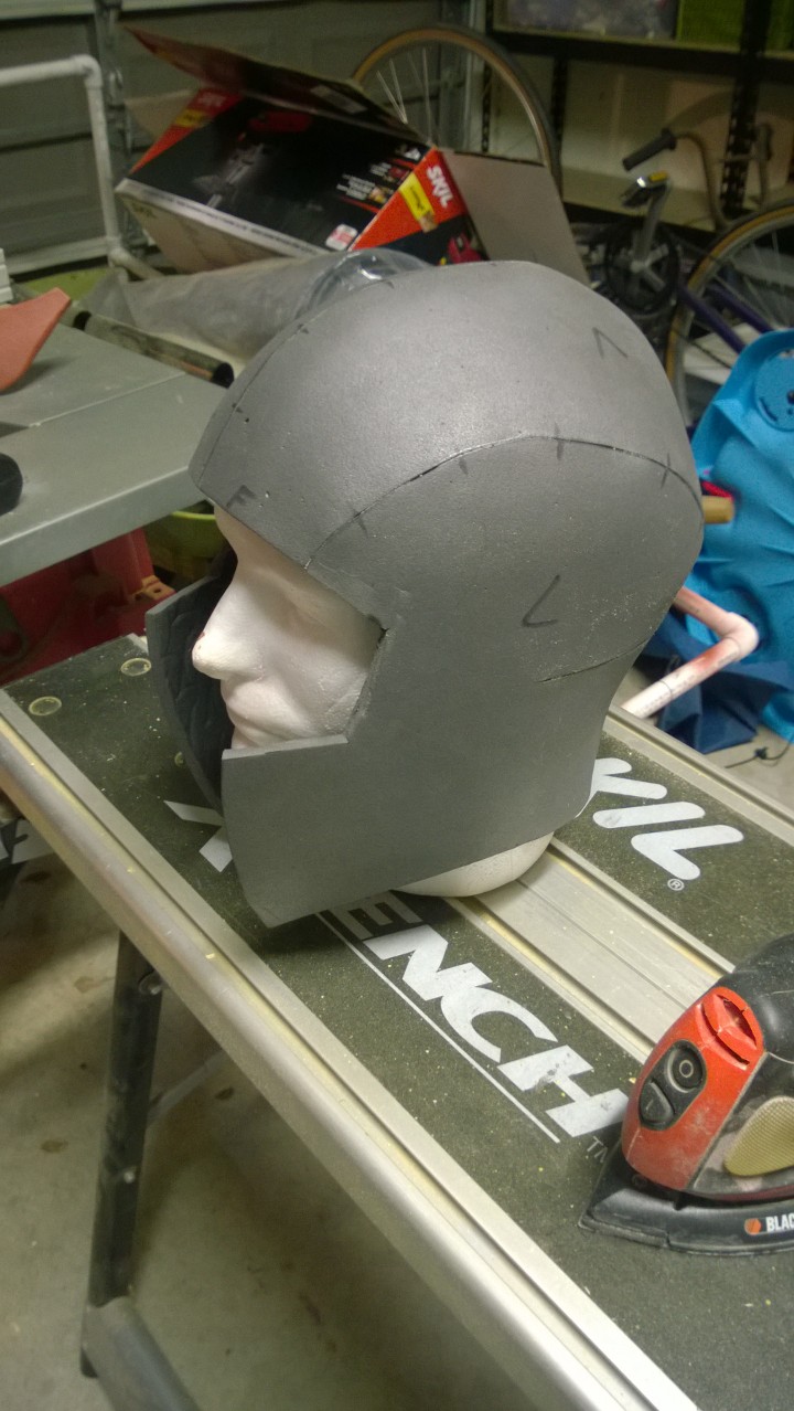

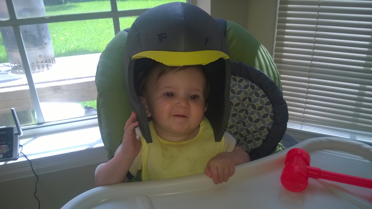

My first attempt at the helmet, goggles and mask. I used the method shown by evil ted smith on making the helmet, it worked quite well but the EVA foam floormats I used were just to thick, I was also not satisfied with the airsoft mask and goggles. My baby daughter loved it though.

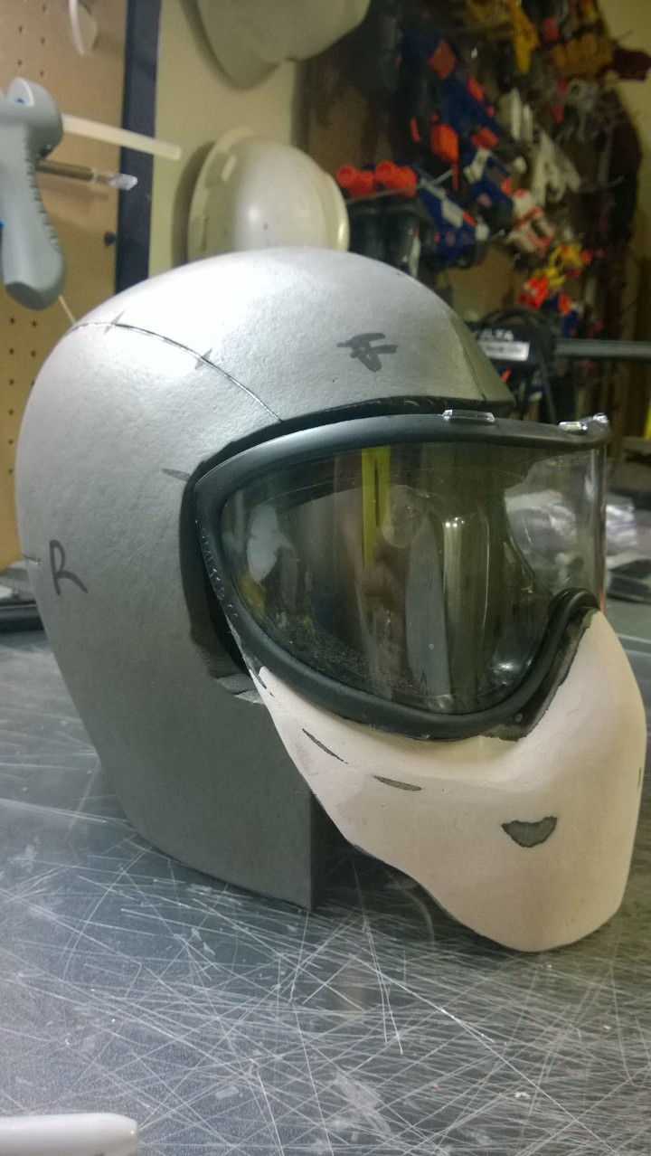

I used thinner foam for the helmet, Bought new goggles, and sculpted the mask from foam floormats.
I also purchased two of the toy snake-eyes swords from GI Joe Retalliation.
Helmet Redux with Swords.jpgHelmet Redux (2).jpgHelmet Redux (3).jpgHelmet Redux (4).jpg
After a few coats of PVA glue and Plastidip on the helmet, and Smooth-On's Epsilon on the mask I finised with paint.

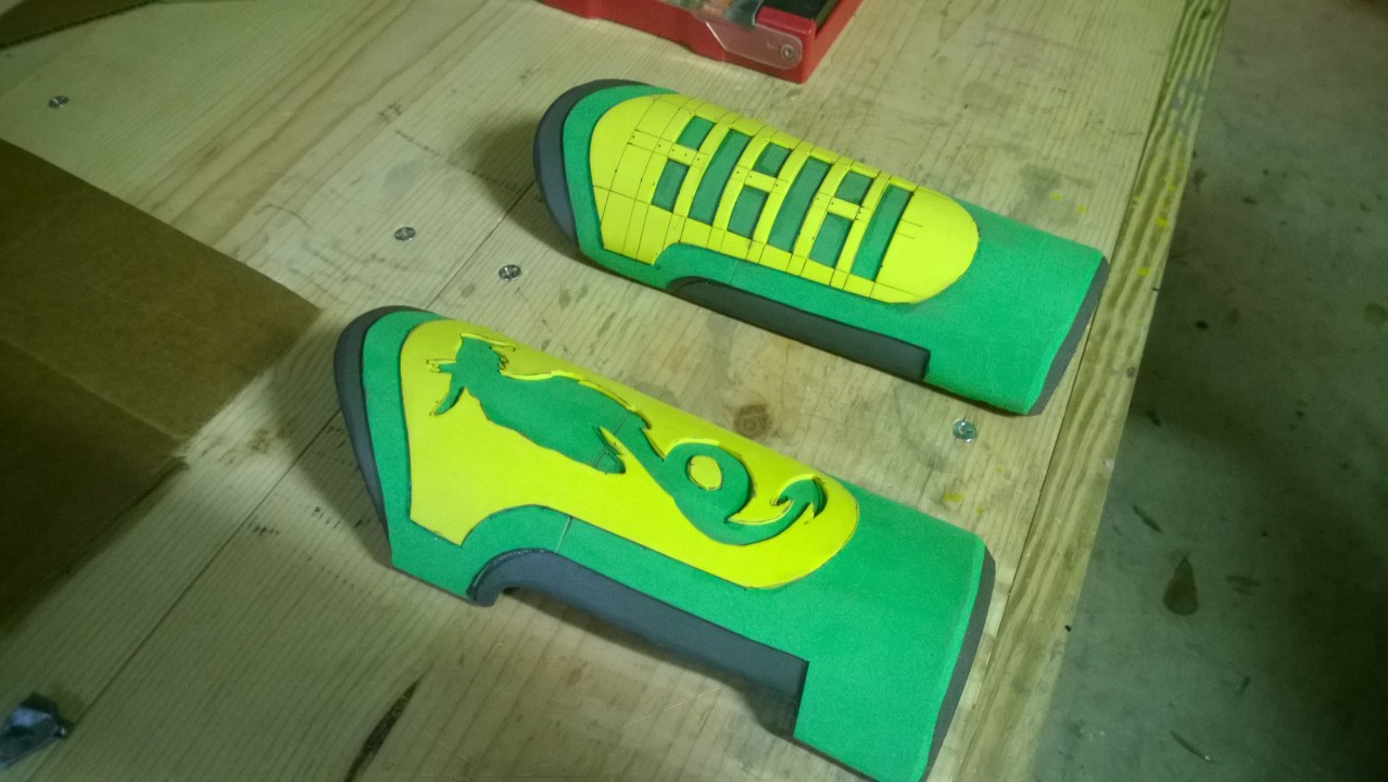

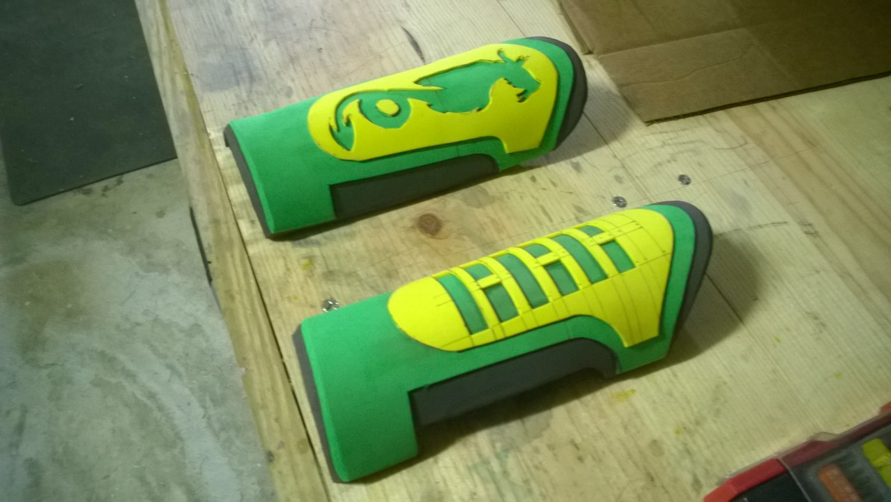

using the armor on the snake-eyes costume from GI Joe Retaliation as a reference, I began sculpting a chest piece, shoulder pads and biceps. and re-designed the forearms as well. I don't have any pictures of the bracers before the redesign.
I put the Arasikage logo on the bracer intended for the right arm, and my older daughter designed me a dragon to put on the left. added Plastidip to these then sculpted the rest.
Shoulders, Biceps, and Bracers

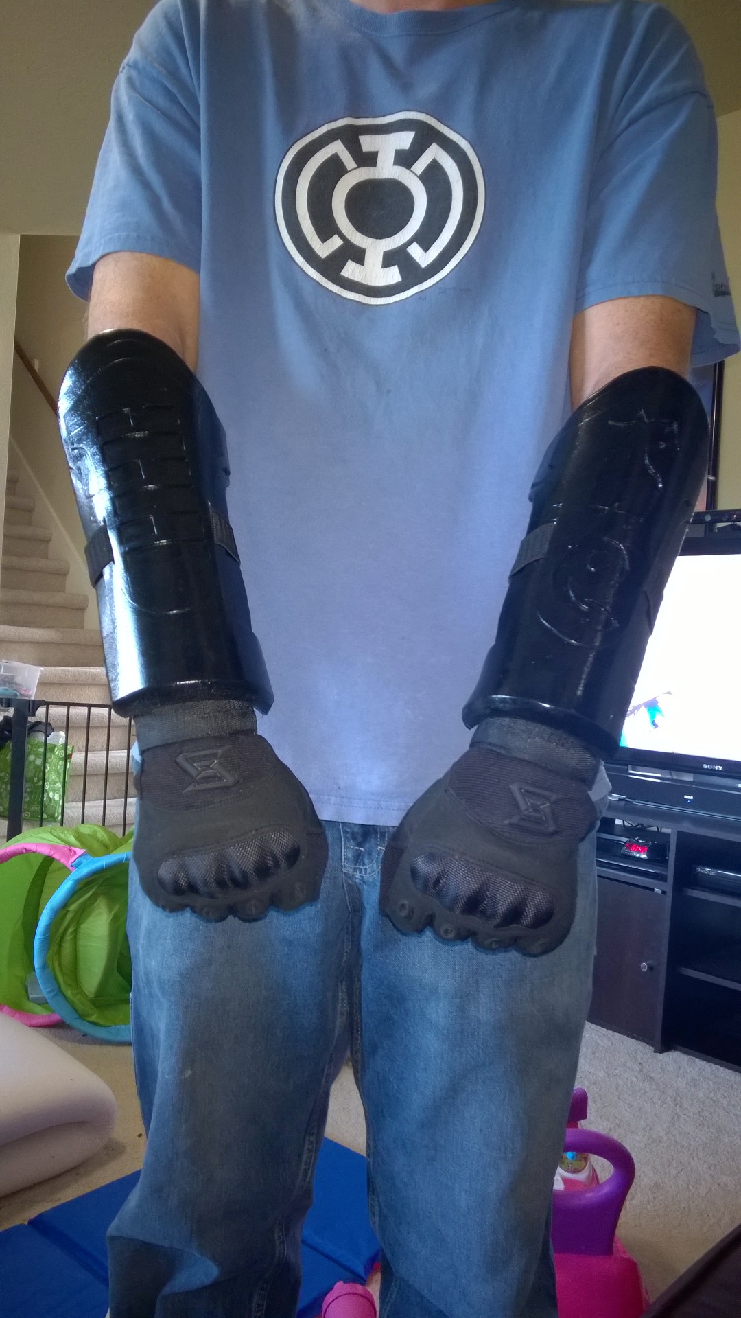

Also I painted the bracers and tried them with the gloves.

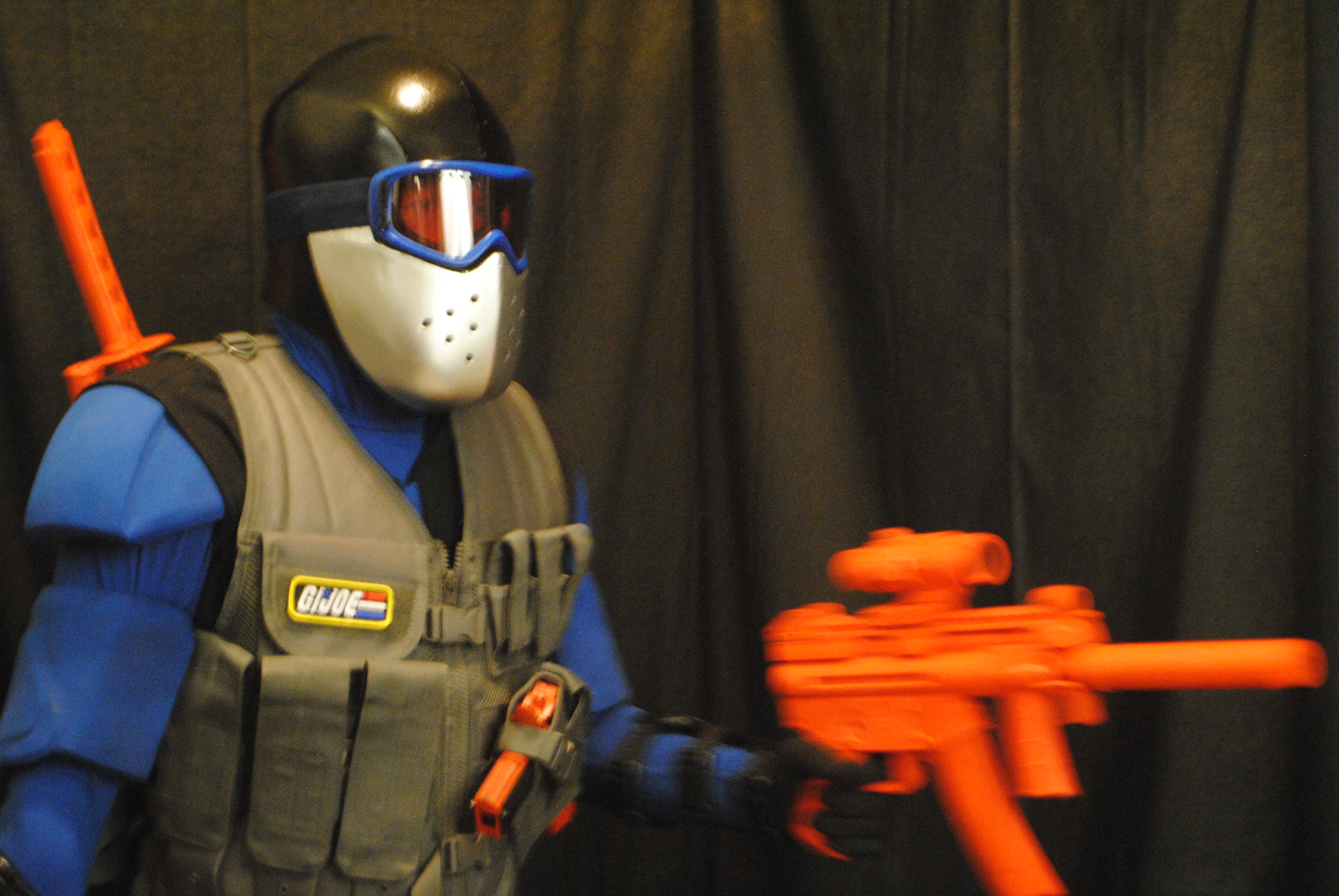

I deeply apologize for the amount of time since my last update, but here is the finished costume.
as well as my friend in his Storm Shadow costume.
For my fist costume build that I wore myself, I'd say it was a success. It handled the convention like a champ, and wasn't as hot as I figured it would be.
