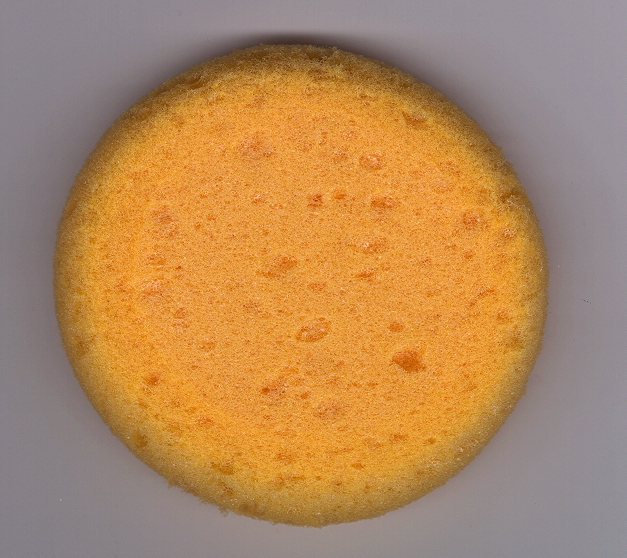

    Reticulated sponge is something like a fish tank filter sponge, you can find those at a pet store:
    And a ceramic sponge is the kind of sponge they have by the sculpting or pottery stuff in Michaels or AC Moore:
    Basically they work like finer and finer rakes for the clay.
