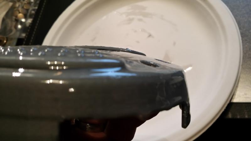

I picked up a kit of Smooth-On's XTC-3D print coating today after reading about it last week. It's a two-part epoxy that brushes on in thin layers. It's clear, but can be tinted with a variety of pigments, including cold casting powders. It self-levels, filling in striations left from 3D printing. After 2 hours (or as little as 15 minutes with heat applied) the coating cures into a glossy finish that can be sanded and painted.
I gave it a try today and I'm fairly impressed with the results! A little bit goes a long way, and it really does remove a ton of the finishing work for 3D printed pieces out of the equation. Here are a couple examples. These were printed at .3mm resolution in ABS with one layer of XTC-3D applied:
And a comparison of before and after:
All that is left for these pieces is a quick sand and I'm ready for primer. The great thing about this product is that it isn't limited to just 3D printed parts. It's applications are pretty limitless... This would be a great coating for CNCed/carved insulation foam, pepakura, Worbla, and probably even EVA foam. Definitely worth giving it a look!

I gave the parts a quick sanding and coat of primer last night. At first inspection there were only a few small areas that will need some attention, but I think we have a winner!
