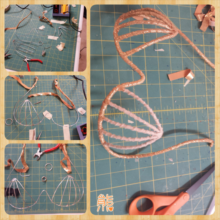

The bra should be welded but that's not something I could make happen so the joints are soldered, coated with a liberal amount of epoxy. The frame does not need to support much tissue so I'm cautiously optimistic. The frame is wrapped in felt then spandex and applique added. Feather portion of the headpiece is made the same, the crown is spandex only, no felt, to reduce bulk.

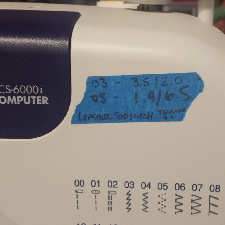

Stitch info - Stitch number 5 with these settings to stitch the elastic to the velvet and hem the waist and leg holes:
