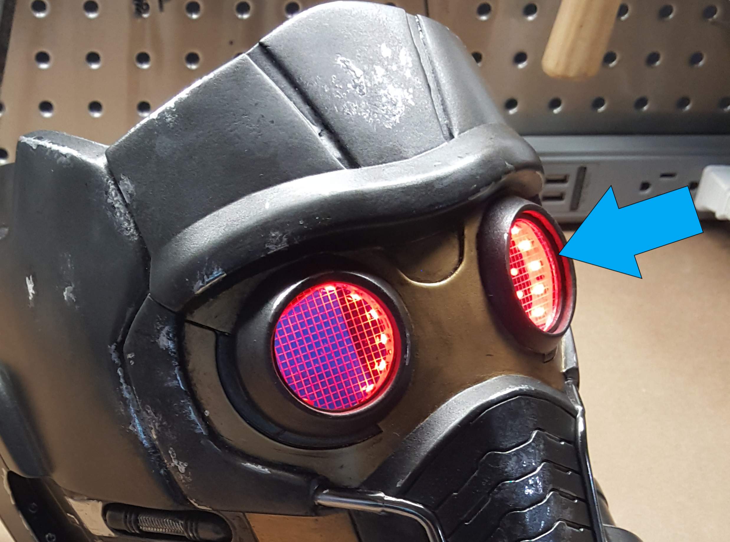

Re: STAR LORD accurate helmet GOTG Vol 2. with screen lineage Run 3 open for depos

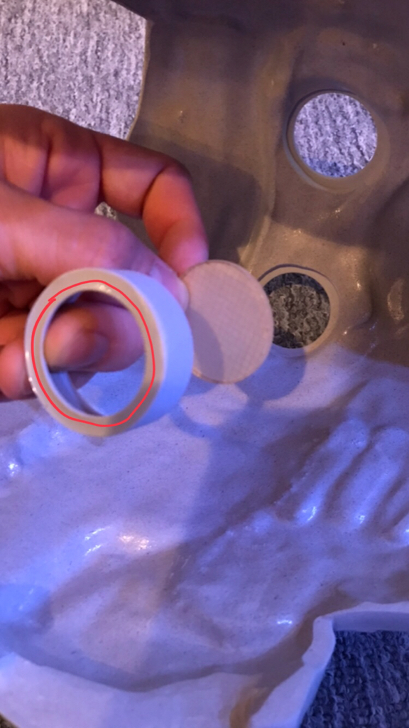

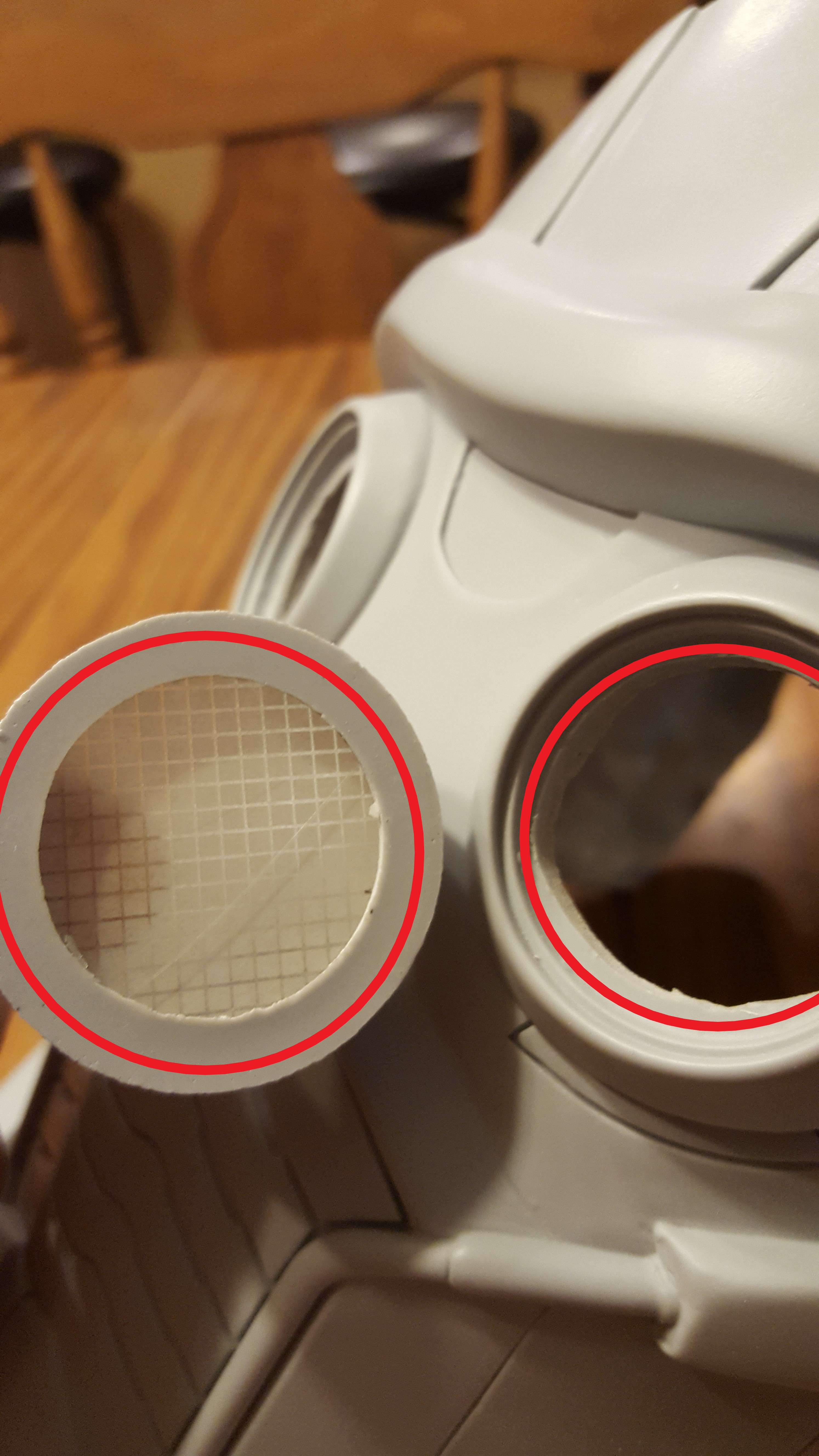

trim the areas circled in red. i trimmed away too much of the red circle on my helmet and had to do a little resculpting with bondo.....the lens housing should be butted up against the helmet eye circle. if that makes any sense
you can see how little of a lip i left on the housing in order to keep the lens from falling through....dremel bit by bit and dont take too much off at once
here is where i have my lens housing sitting (blue arrow) i dremeled out the inside of the helmet to try to make the housing sit in there securely. I hot glued it in place and it worked great

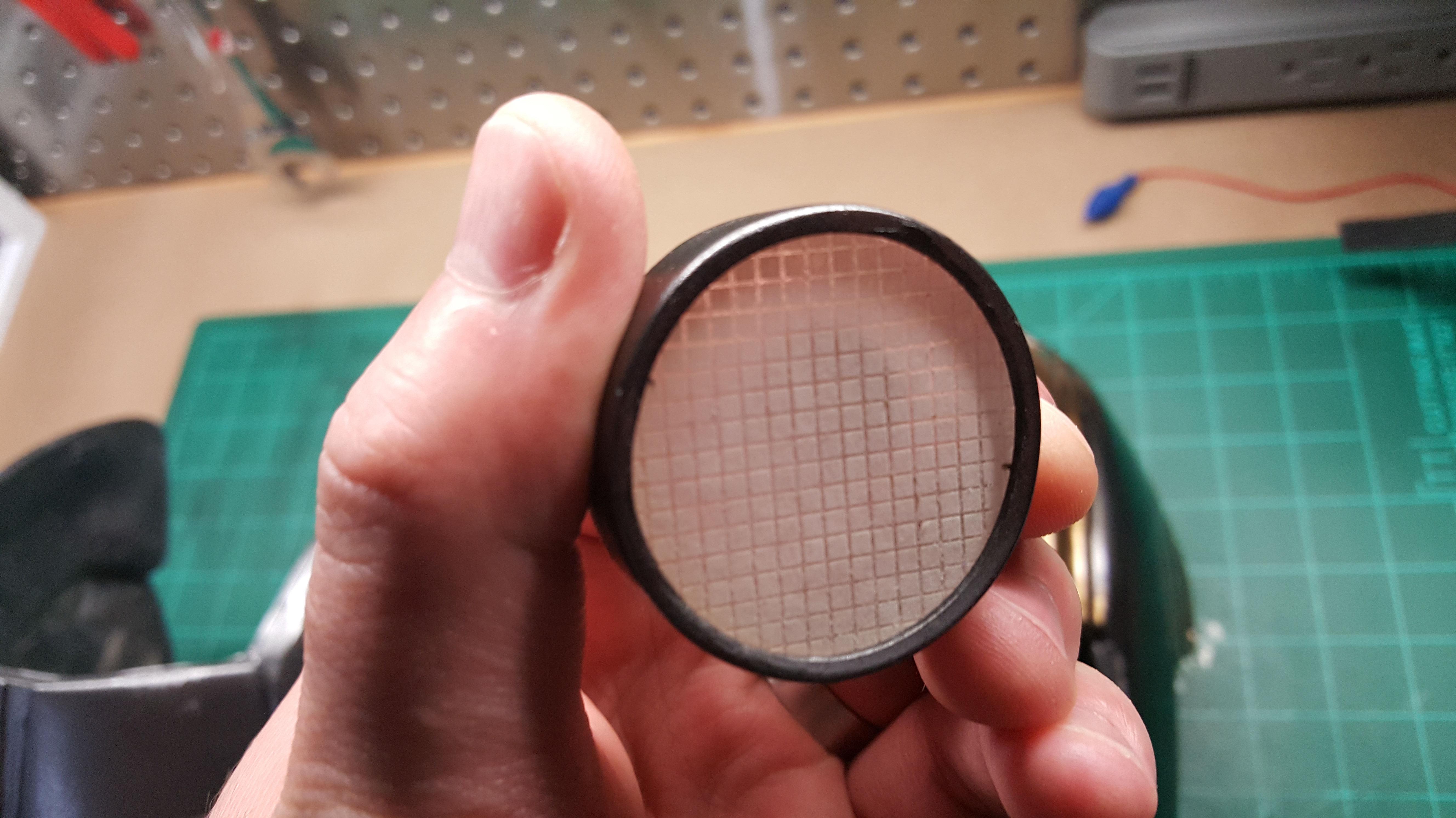

Hi everyone,
Finally I was able to start workong on my helmet.
First of all I have to say that the quality is pretty amazing :).
But I have a few questions:
1. Can I peel the white squares off my lenses or do I have to do anything with the lenses before peeling off?
2. I have seen a few recommendations about cutting the lenses section in the helmet. But what is the best? Do I have to cut the whole hole on the helmet (with the first lip), replace that lip with the lenses socket and cut down the lip of the lenses socket until it looks good?
Or do I have to cut the hole in the helmet to the first lip, cut the whole lip from the socket and put the lenses + socket behind the lip from the helmet?
I hope, I can get sone help :)
Thank you
Re: STAR LORD accurate helmet GOTG Vol 2. with screen lineage open run limited num
Hmmmm, do NOT peel the white off the lenses - that is what diffuses the light so they actually light up. Its foggy to look through, but the visibility is actually better than most helmets.
I'm pretty sure you're supposed to peel that off. It's just a layer of film that the acrylic comes with for protection. The etched lines diffuse the light and the blue lens cancels out the red led
Sent from my SAMSUNG-SM-G920A using Tapatalk
You would not be able to see the LEDs on this screen used helmet if there were a film over the lens
My bad - I should look at the thread title first:) I was thinking these were risu's lenses (his have opaque squares). Yes, rocketeer's lenses have opaque grid-lines with clear squares, which is screen accruate. So, YES, peel off the tape:)
Okay that is awesome :) thanks for the help. I will peel them off after I installed them.
But could you also help me with question number two? I don't want to cut too much for the lenses

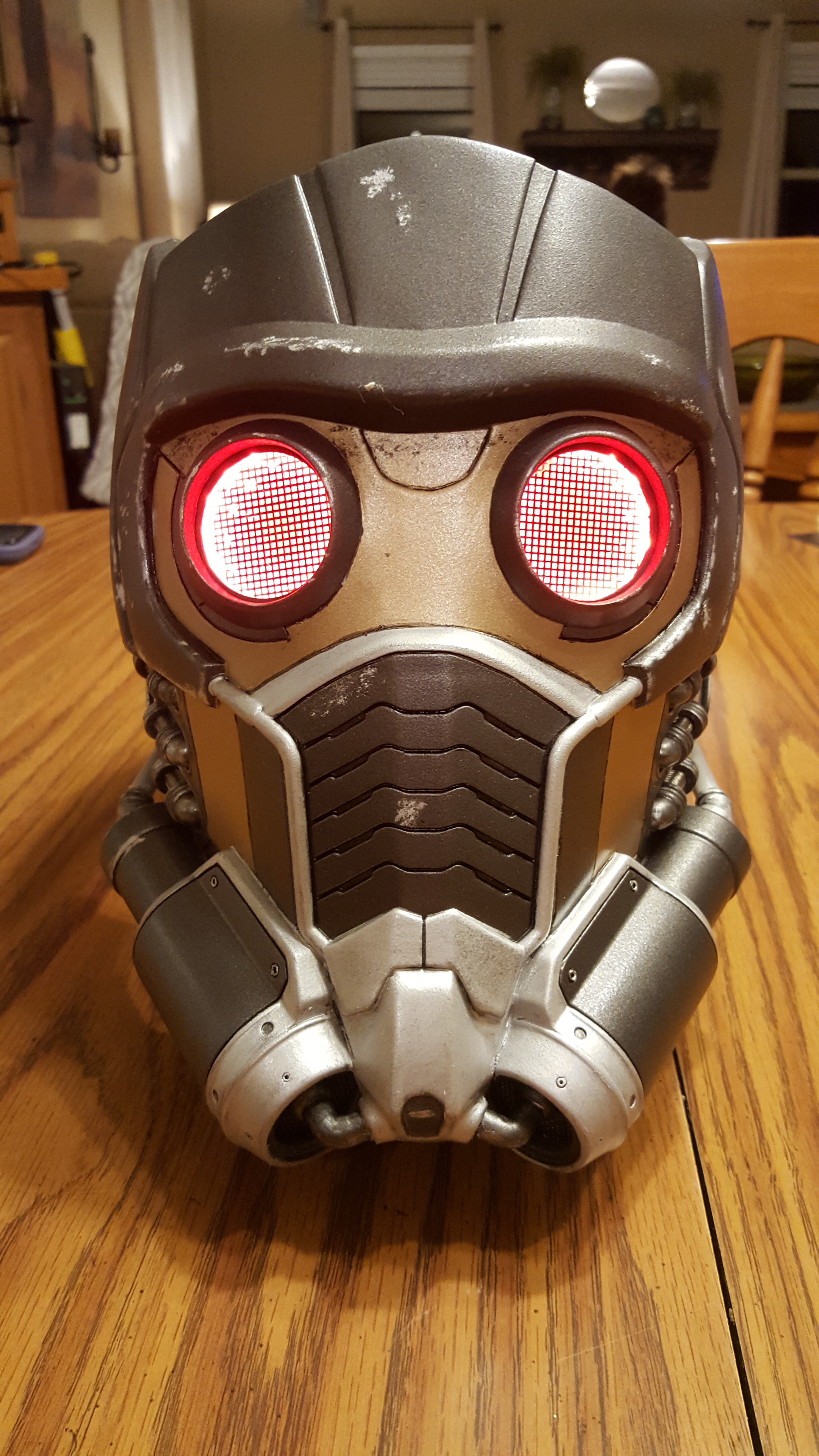

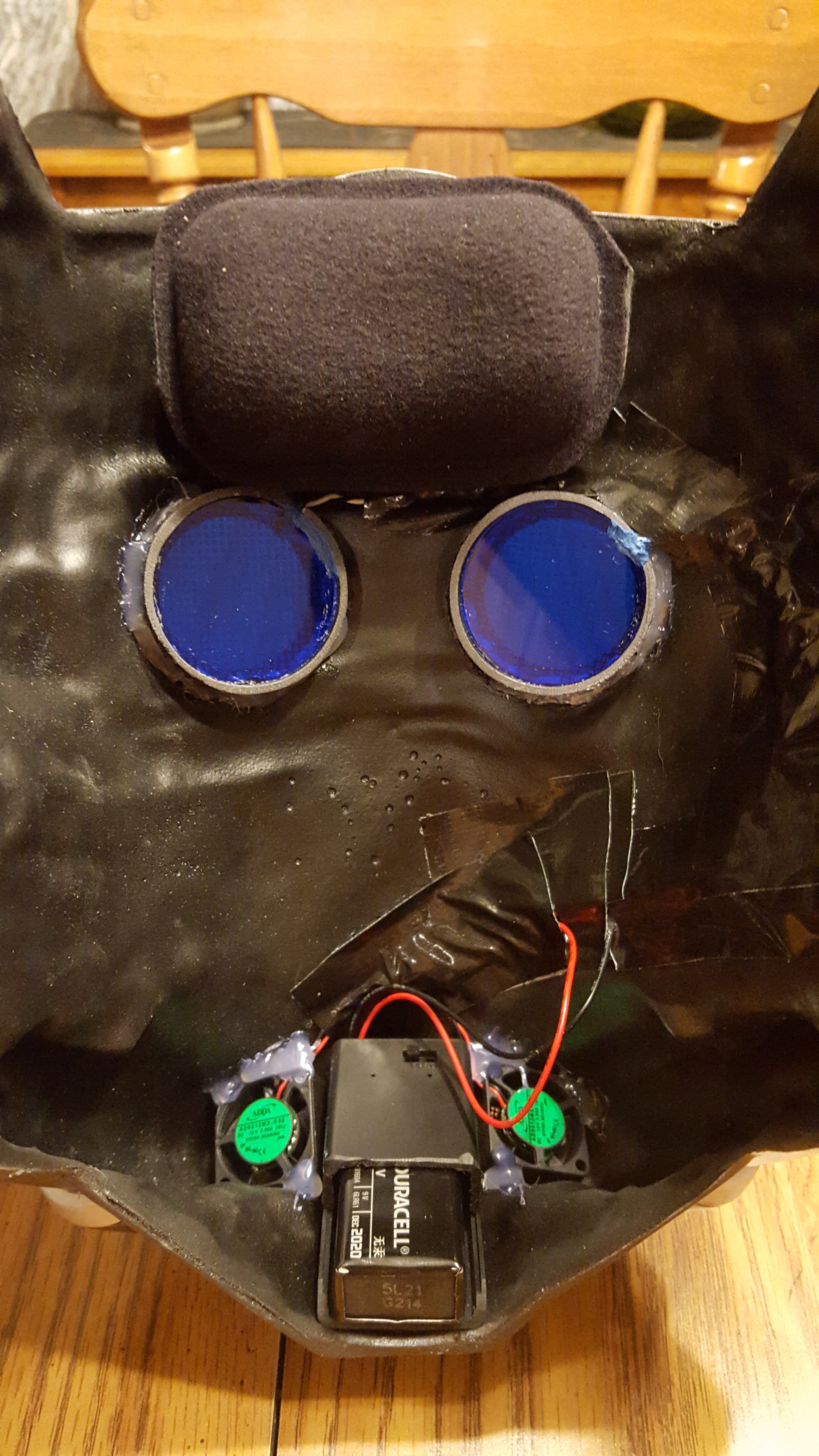

I finished my helmet just in time for the Cincinnati Comic Expo this weekend and it was a hit! Even Pom called me "Star Lord"!!!!
I ended up using Risu's 40mm lens kit so that the LED's would sit back from the lip a bit further. I spray painted the inside with a black rubber coating. I added a couple of small 12V fans and the red LED on the side of the helmet too....all powered off a 9V battery. The battery lasted about 6 hours, so always bring a spare!
20170920_201935.jpg20170920_202050.jpg20170920_201948.jpg20170923_103935 (2).jpg
Super happy with the helmet!

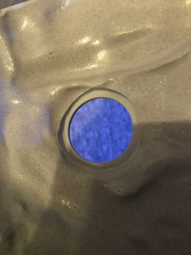

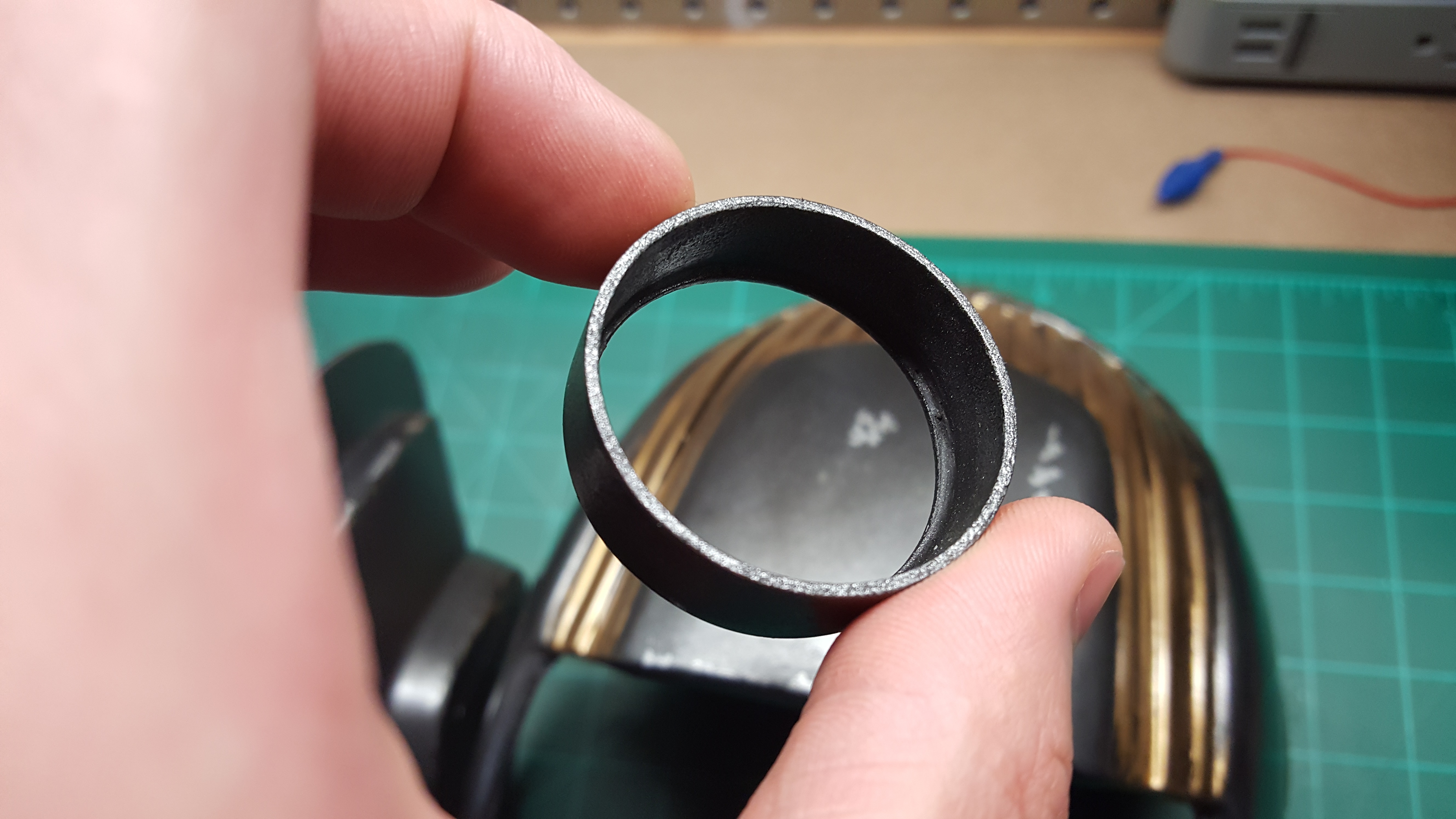

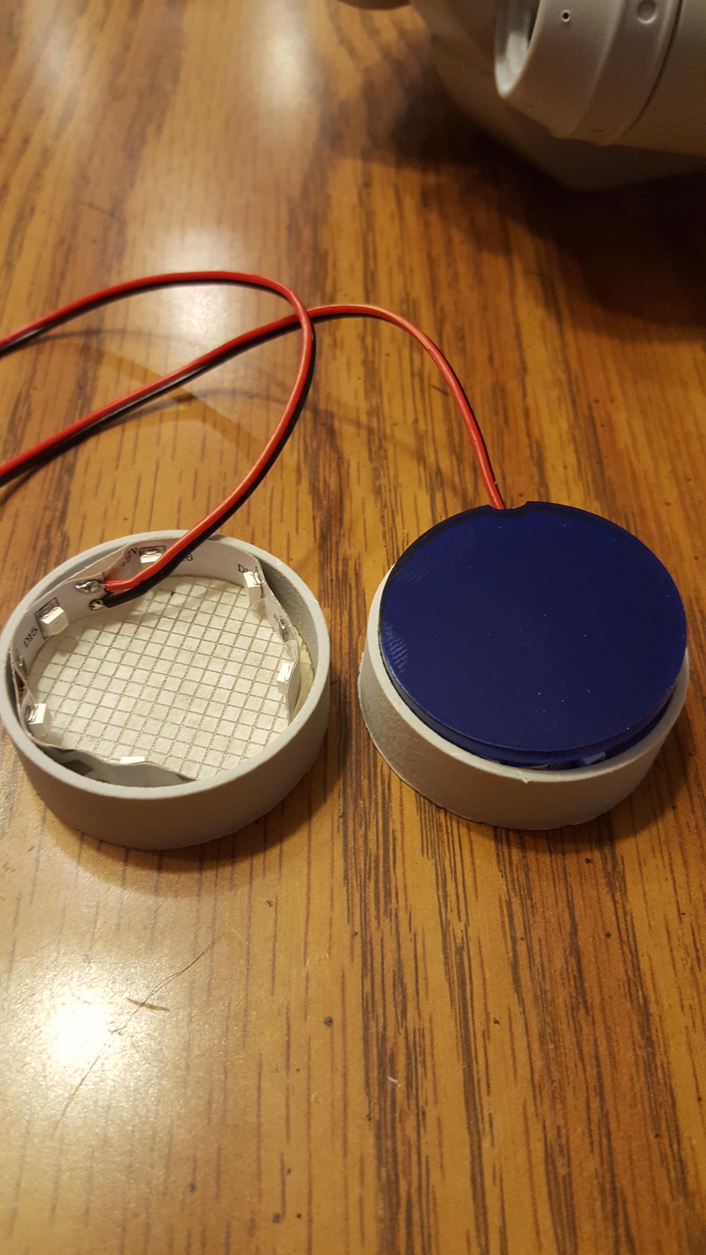

Thanks for your input. I hadn‘t so much time to continue with my helmet, but I started with the lenses. I think I found a good way to cut thole (in my mind for me).
My plan is to trim from the inside to the first lip and to make a plain circle in the inside of the helmet.
I won‘t use the lenses sockets as they supposed to be. I will cut them on the inside that they are almost tubes. Then I will glue them on place and put the lenses inside. After that the lenses should be really close to the outside but also with the lip.
I hope everything will work :D but in my mind it feels right :D :D

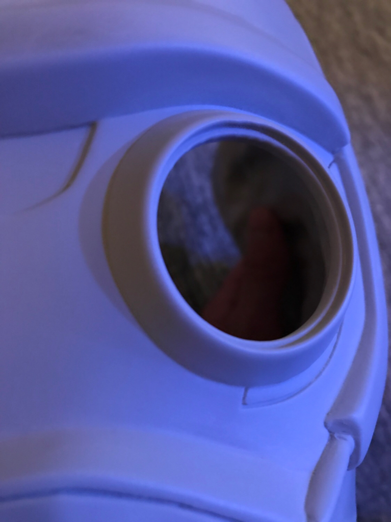

I don't know if it was intended to be done like this, but for the eye sockets, I dremeled down (very very carefully) the lip inside of the eye sockets on the helmet, dremeled the inside eye areas flat like in some of the photos above, then carefully sanded the lip on the lighting kit lens tubes, leaving a tiny little lip. They sit in there very nicely now, and the lip I left on the lighting kit lens tube now has replaced the lip that I drememled out of the helmet. The lenses now sit back 1/8th of an inch or so for the correct look. I just glued the lens tubes into the helmet a few minutes ago. My airbrush arrives tomorrow so I will continue to finish the helmet up and then I'll post some pics for reference.
