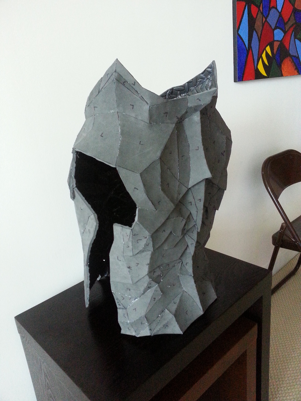

I wanted to dive into the world of foam building by making a set of unique armor, after a long time deciding I finally settled on the Daedric armor from Skyrim. Problem is there is not too many builds I could find of this armor, and especially not in foam.
I started with the pep files I found online in this thread: http://www.405th.com/showthread.php/36462-Skyrim-Pepakura-Files/ which I then modified to make them more foam-friendly.
The armor is made completely out of EVA foam and hot glue. Detailed with craft foam, acrylic paint, hot glue, and varnish. More details can be found in the thread.
View attachment 213706 View attachment 214976 View attachment 228396
View attachment 229595 View attachment 229598 View attachment 229597 View attachment 230479 View attachment 235098

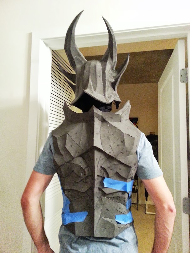

Took some time to build a duct tape dummy to use for fitting the armor. Now I know that I need to add about an inch of foam on each side under the arms.
Currently working on building the helmet, should be completed in the next few days.

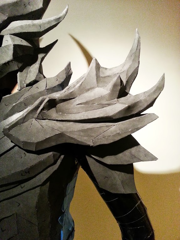

Finished one of the shoulders last night, definitely the hardest part of the armor I think. Not looking forward to doing the second one, but at least they are asymmetric so they don't have to be exact.
Now I need to figure out the best way of attaching these to the breastplate on the front and back.

Did some fitment tests to make sure i can turn my head without hitting the spikes on the chest :) . It fits pretty well!
Also finished the other shoulder :D
