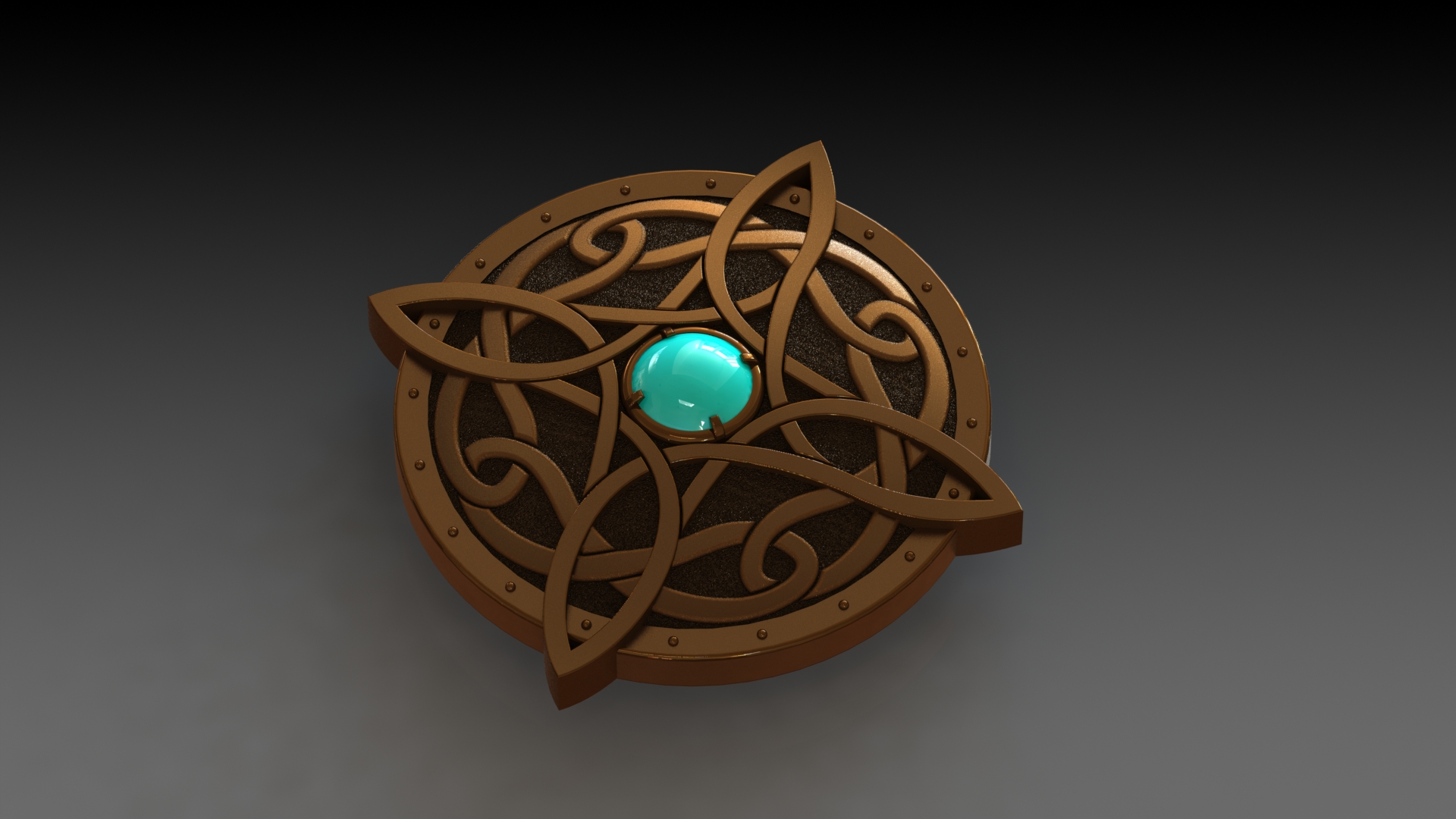

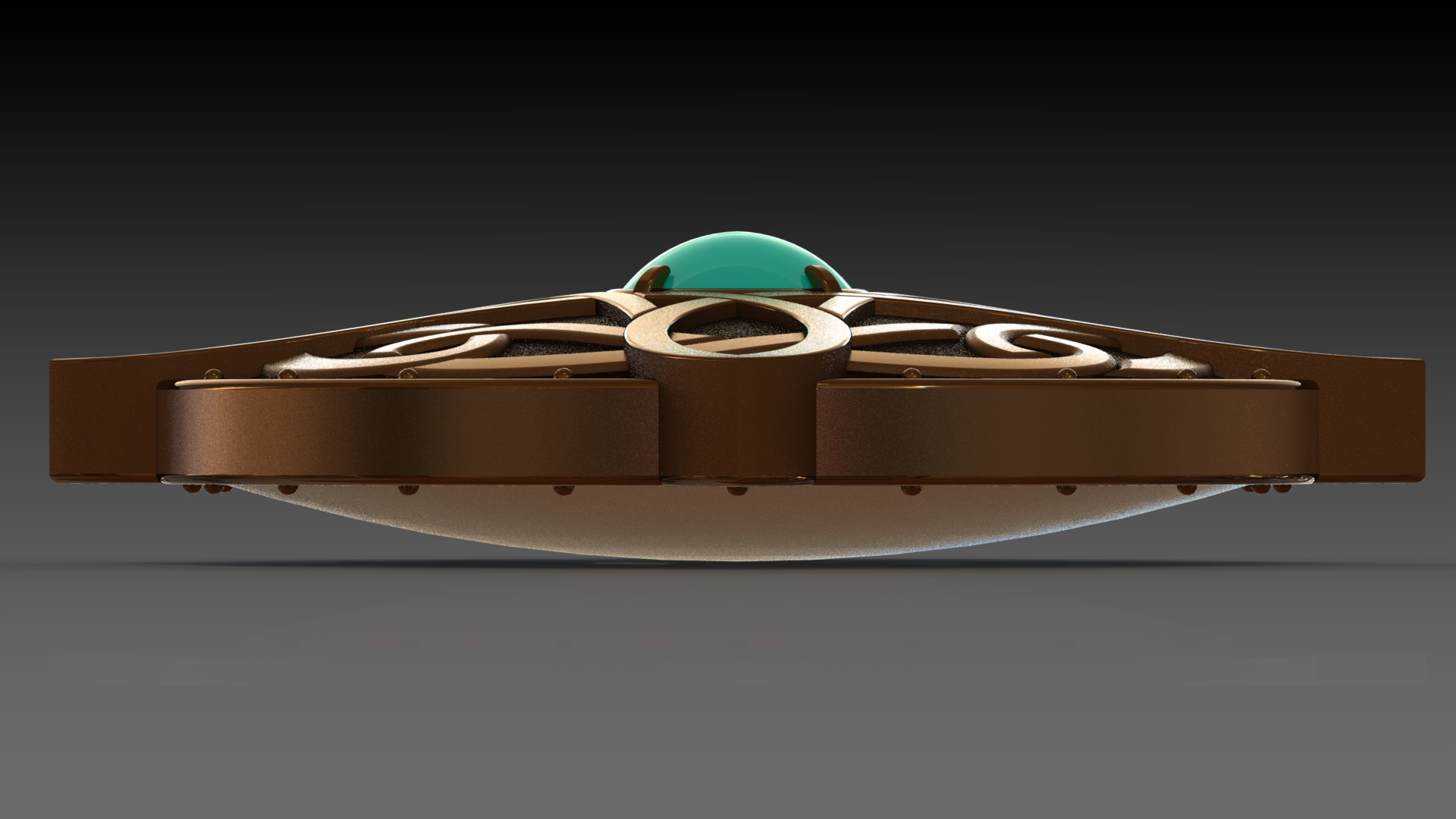

So with the perfect source material, I started modeling the main amulet. After some fiddling around, I ended up with this (conveniently colored to estimate the look of the final piece):
The final piece will be cold-cast bronze, strategically textured and polished to add a lot of depth to the piece.

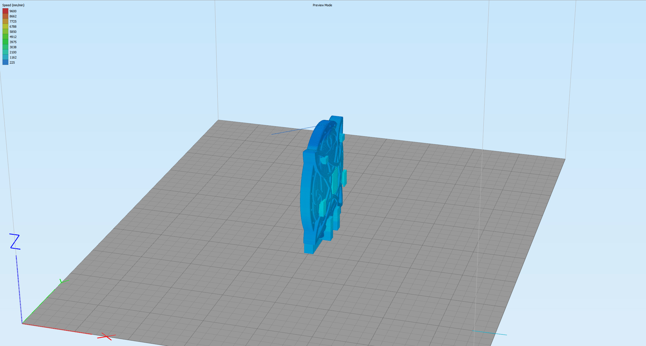

Now, when modeling for a 3D print, the tricky part is figuring out the best way to orient the pieces to maximize detail. In this case, I printed the amulet vertically at .1mm resolution, which took about 8 hours, but preserved every bit of surface detail:
The final amulet is about 3.5 inches in diameter, as it's pretty hefty in-game. It fits perfectly in my hand.
Of course, it still needs a lot of cleaning up and polishing before it's ready for molding and casting, so I'll be cleaning it up over the next few days.

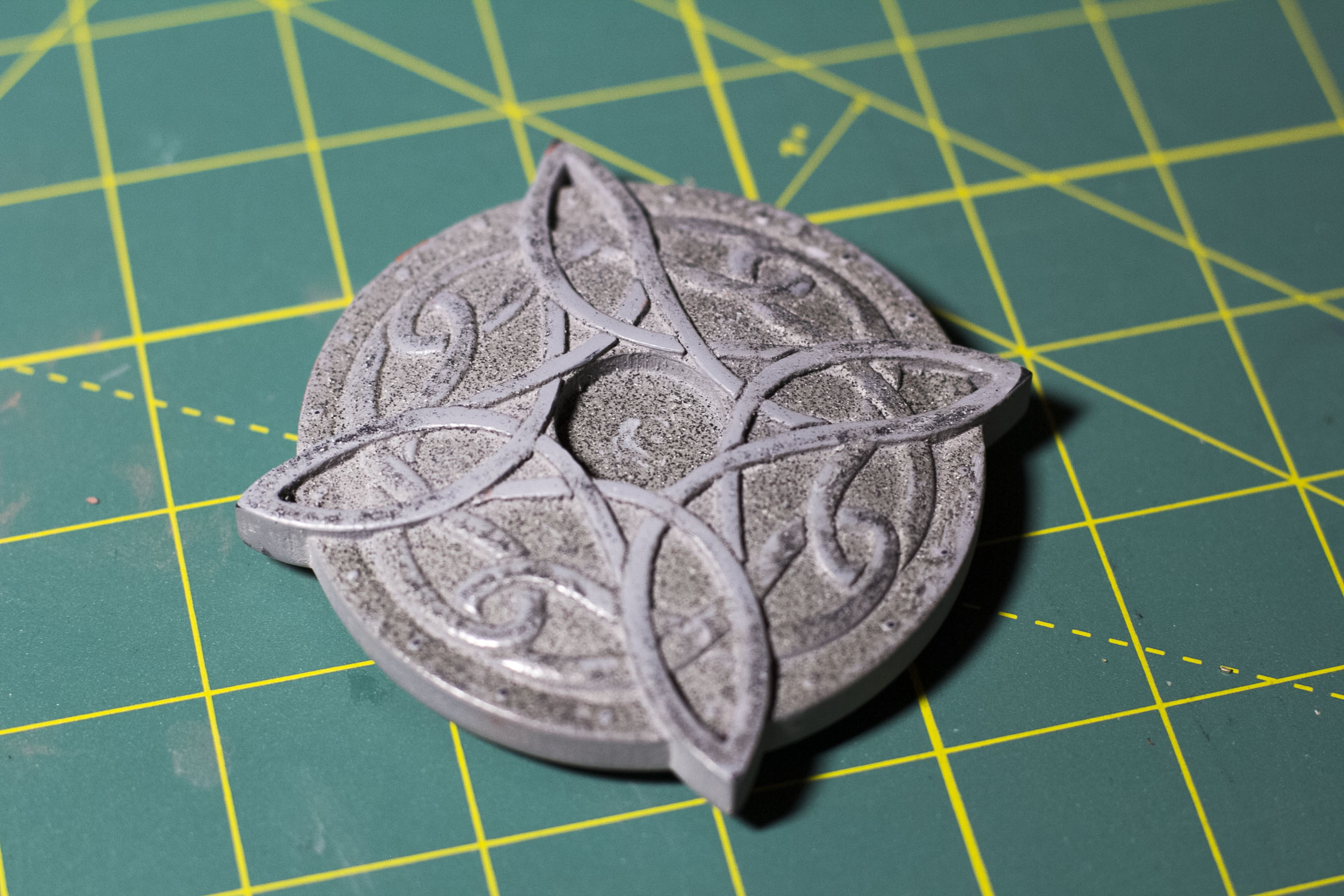

I spent a day going over the amulet with needle files and various grits of sandpaper (down to 400), then put on a few coats of filler primer and shined it up by wet-sanding down to 1000 grit. This left it extremely shiny. Too shiny for my taste, so I hit it with some Rustoleum multicolored texturizer:
As you can see, this gave the entire piece a gross sand-cast look, but since all I cared about was the texture, it worked fine. I just had to go back over it and sand down all the high edges back to a smooth, weathered finish (and propmaking is 90% sanding anyway).
A coat of flat black lets you see the texture as it's going to look in the final product, and I couldn't be happier with the results.
Perfect sand-cast/polished bronze texture!

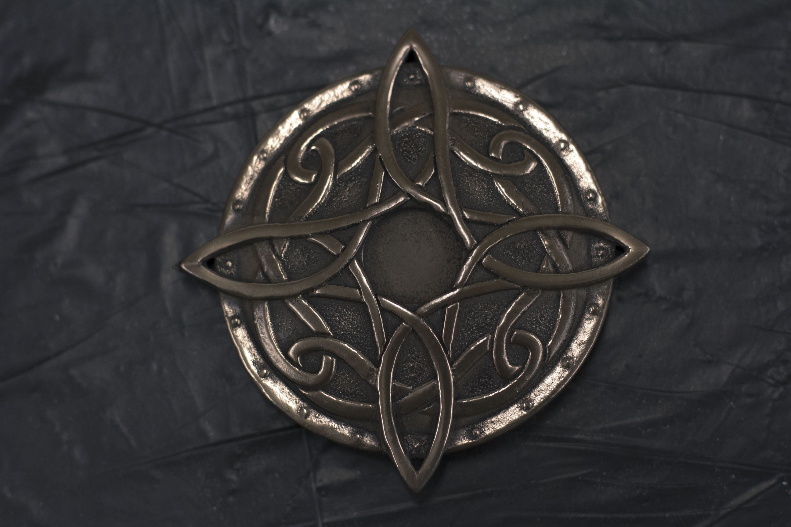

I've molded the master and cold-cast the main body of the amulet in bronze, which comes out looking like chocolate, but polishes to a brilliant finish:
The gem and setting are both cast as a solid piece of tinted smooth-cast 325, so they come out translucent. I hand-painted liquid gold leafing onto the setting to define it.
