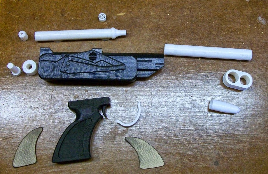

The 3D printed parts are:
  1. main block
  2. handle and trigger assembly (printed all as one piece so it's counted as one part)
  3. trigger guard
  4. rear recharger cylinder
  5. rear recharger plug
  6. main scope body
  7. scope eye piece
  8. crosshairs inside scope
  9. barrel
  10. barrel attachement
  11. clip to hold barrel to barrel attachment
The 11 piece 3D printed kit look like this:
The trigger is printed in place, on a hinge, inside the handle.
It's one print, reducing the skill required to assemble it.
It gets its springback action from the included elastic band which you tie in place.

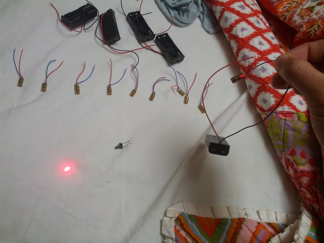

The main section of the blaster includes a internal 3d printed chamber for housing the battery pack, as well as a tube connecting to the barrel where you can wire up a real laser to shoot out of the barrel. The electronics kit includes a real laser pointer diode, a two-AAA battery harness, a switch, a strand of wire, and a 3d printed mount for the switch. When assembled, the blaster will function as a laser pointer when the trigger is pressed. The laser beam will travel down and out of the barrel. Four solder connections are required, and you still have to make the pew-pew noises yourself. I'll consider offering these pre-soldered, but you really should learn how to do it at your local hackerspace.

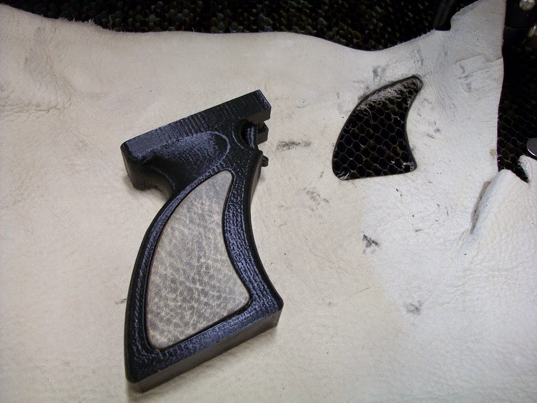

The leather grips are to be laser-cut from genuine dewback hide, just like Kanan's. If I run into a dewback shortage, I'll use full-grain aniline sheepskin, as pictured.I carefully used superglue to attach them to the finished blaster.
If you don't elect for the leather grips, you'll receive 3d printed faux-leather attached to the handle (shown below in black) which you can paint a separate color.
