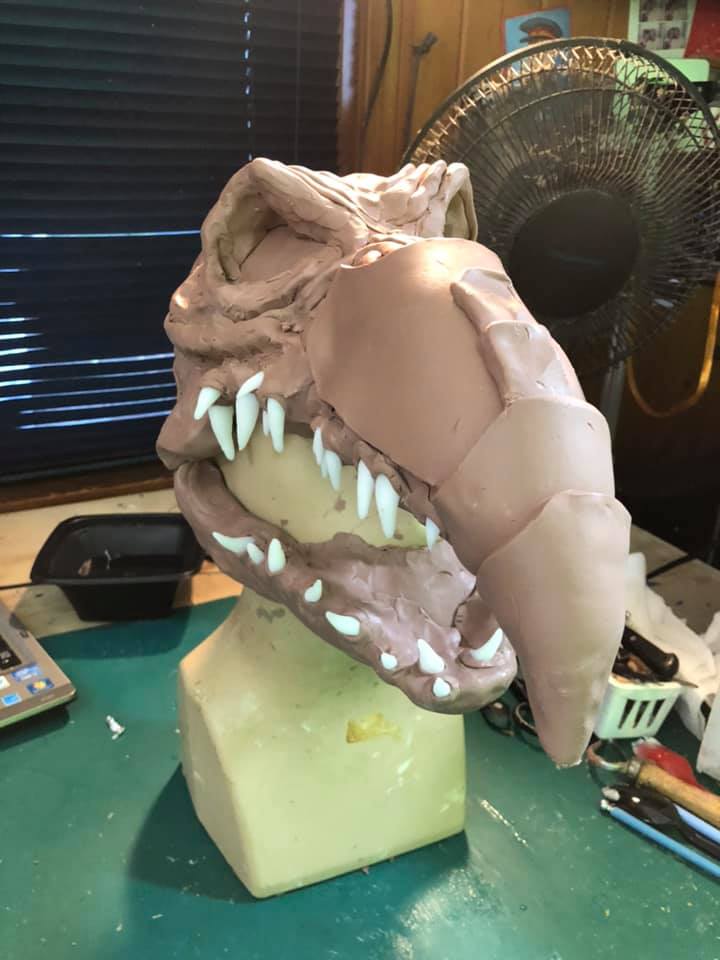

Blocking out on the head form:
Little more refinement, probably around 12 hours in it at this point.

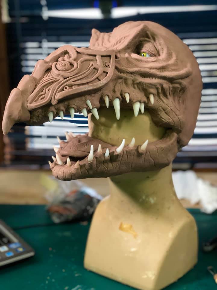

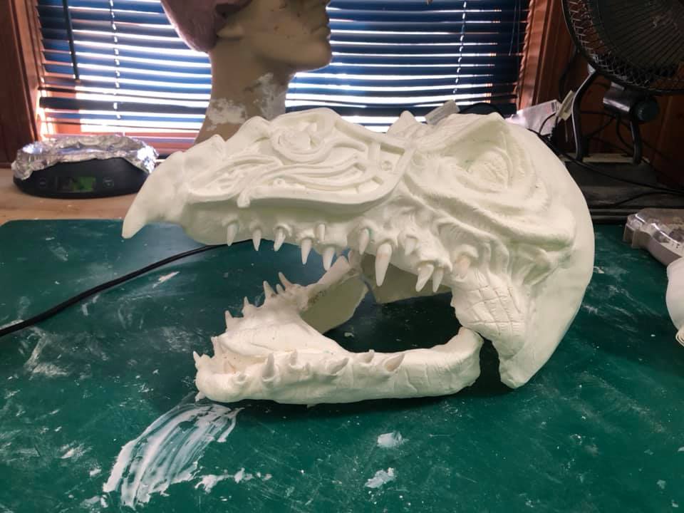

Final detail pass on the sculpt, probably took around 20 hours to finish up the sculpt

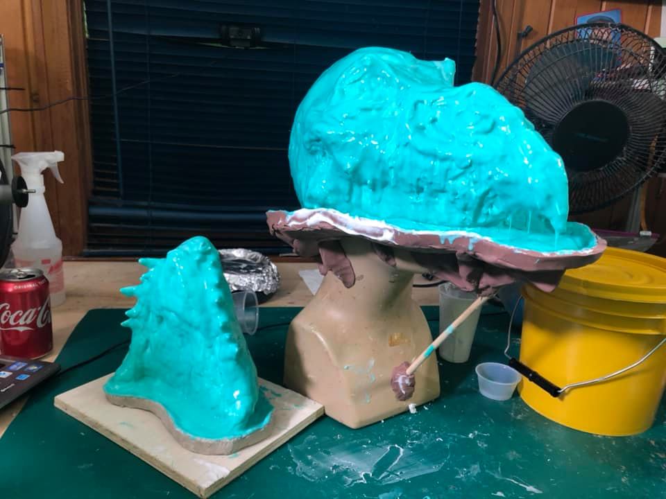

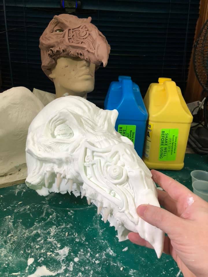

On to molding and casting! I had some moldmax stroke laying around so I just used that.
I cast it in Smooth-Cast 300 as I had some from another project.
after a little clean up

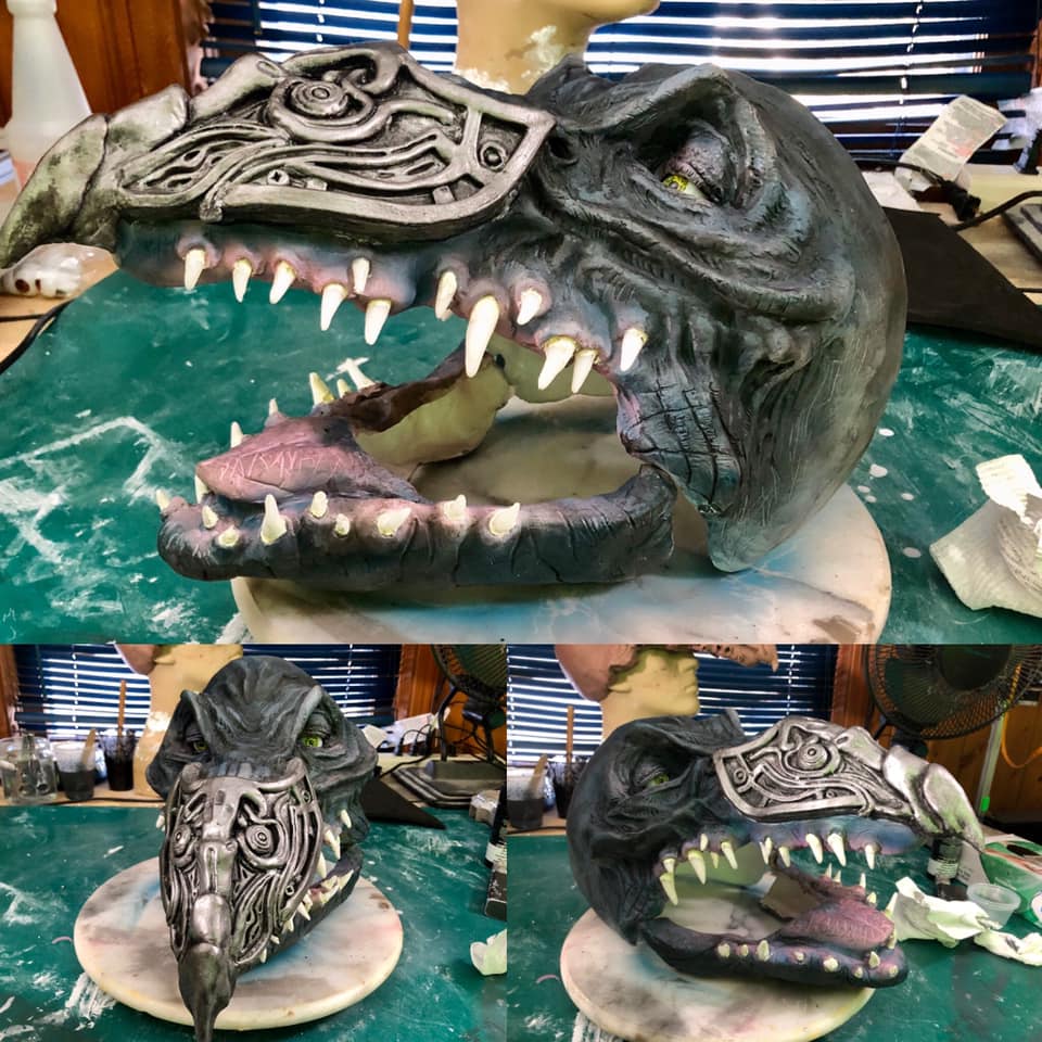

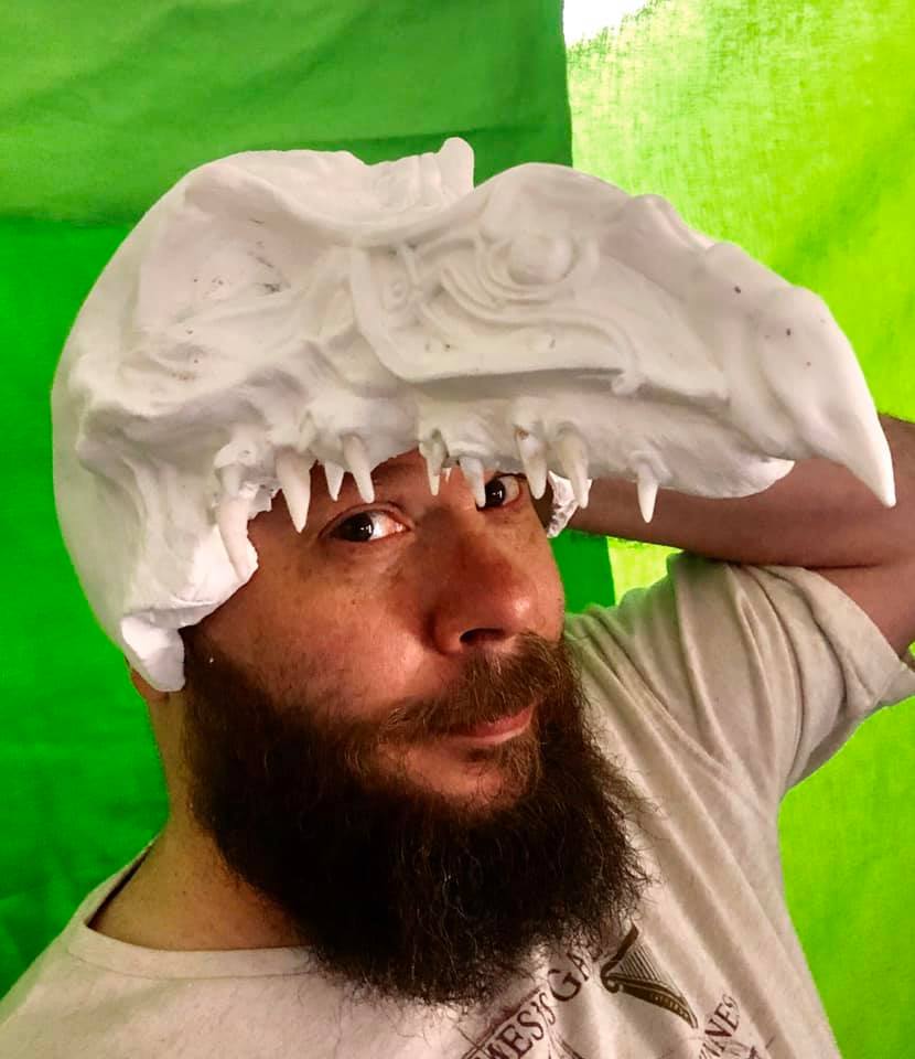

does it fit? yep!

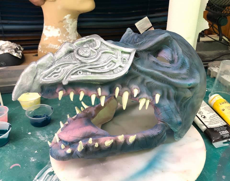

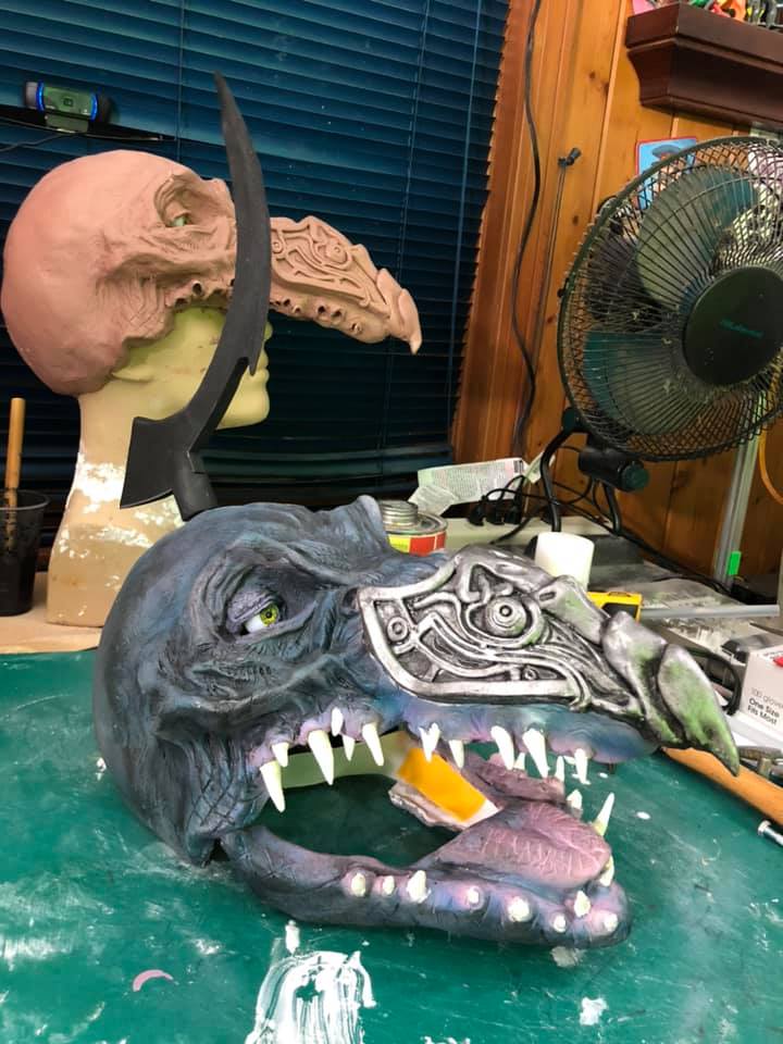

On to paint!
Fitting test!
Looks awesome! Tell me about the teeth. Did you make them? Are they just pushed in?
They are Friendly plastic. I molded it with them in then removed them from the sculpt and put them back in the silicone mold before I slush cast it. It was a experiment, seems to have worked out.

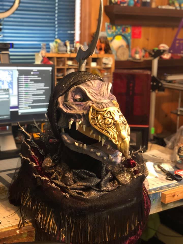

Just realized I never posted the final of this build! Well couple years late, but here ya go.
