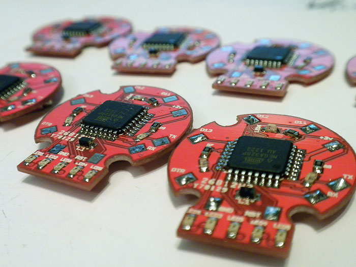

I thought I had found/installed them before.. (shows up in my printer options) however I never used it as a direct print option. (I use some other software that takes my GERBER files and send them directly to my CAMEO so I can make solder masks/stencils for assembling PCB's)
My primary use is solder stencils too - what do you use to cut gerbers directly? I've just been exporting the paste layer to DXF..

I too went the .DXF route initially. But could never get really square/symmetrical cuts..
I made some posts on it on a few sites..
but here is an old one as well:
basically someone at dangerous prototypes postsed a little app (and an additional gui/front end for it) to lets you sedn GERBER files directly to the cutter itself.. (no software in between)
I have I dont think you'll bve doing any 0402 stuff... but I have done SMD chips and and down to 0603 components without issue
Not sure what circuit/board design software you use (I use EAGLE).. but I suggest you do some pad swelling (shrinking) before sending.. it makes it easier to avoid any solder bridges on tight components..
After I get all the paste applied and components set... I use my $17 toaster oven from Wal-mart to re-flow (bake) them.. They ruen out great.. top notch!
