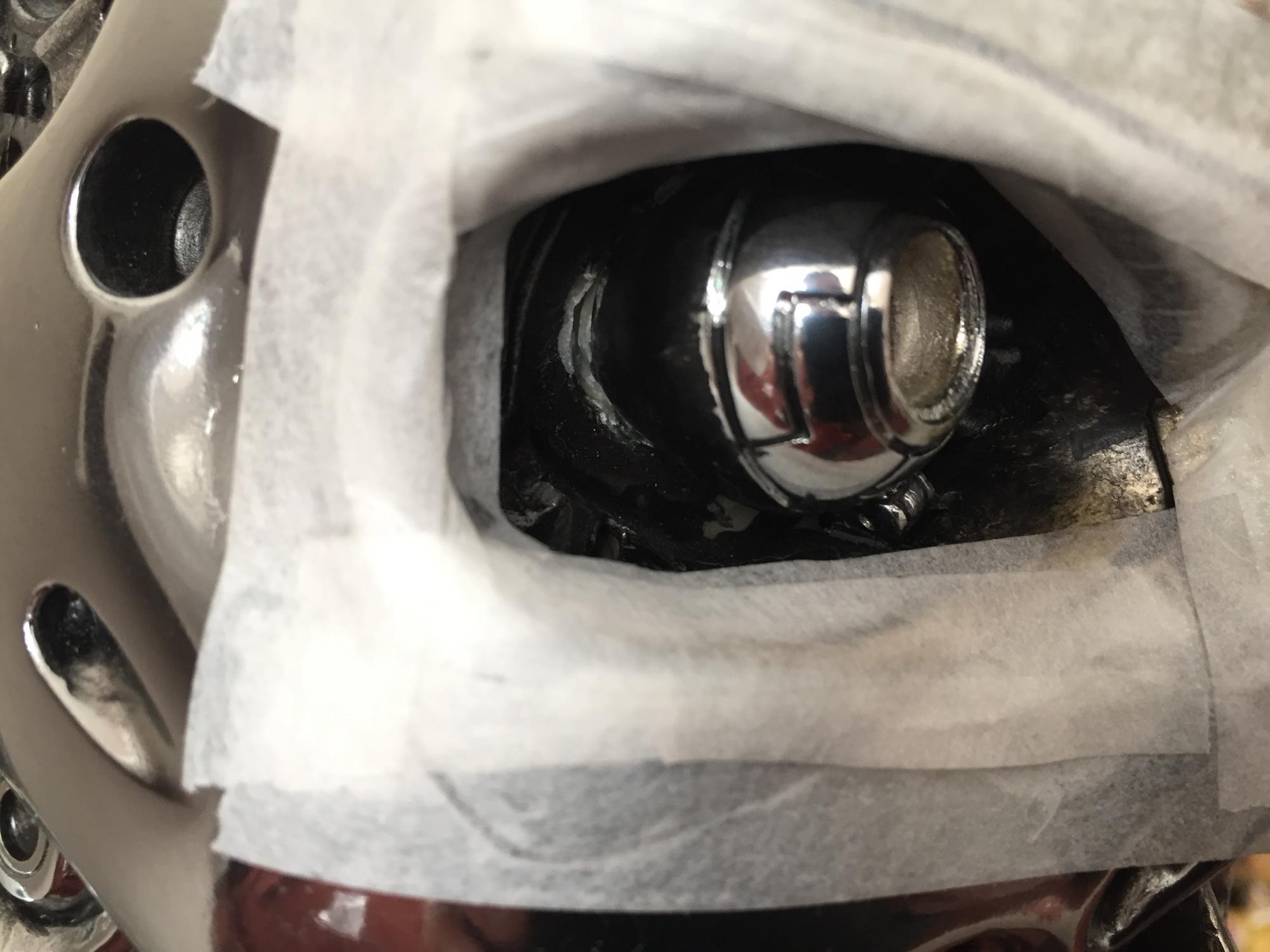

Next I got a large flat screwdriver, covered it with duct tape, put some masking tape over the eye socket for protection and carefully managed to free the wonky eyeball from its socket. I also took out the 4 parts in order to put them back in the correct position (one of them got broken, hopefully it can be fixed with glue).
I am still in the process of getting the wonky eye in the same position as the other one by removing material behind it so it can be put further backwards.
I didn't manage to get the eyeball fully out as the LED is stuck in the eyeball and I don't want to cut off the wiring as yet. I first want to try fixing it without risking the wires disappearing into the skull...(the horror!)

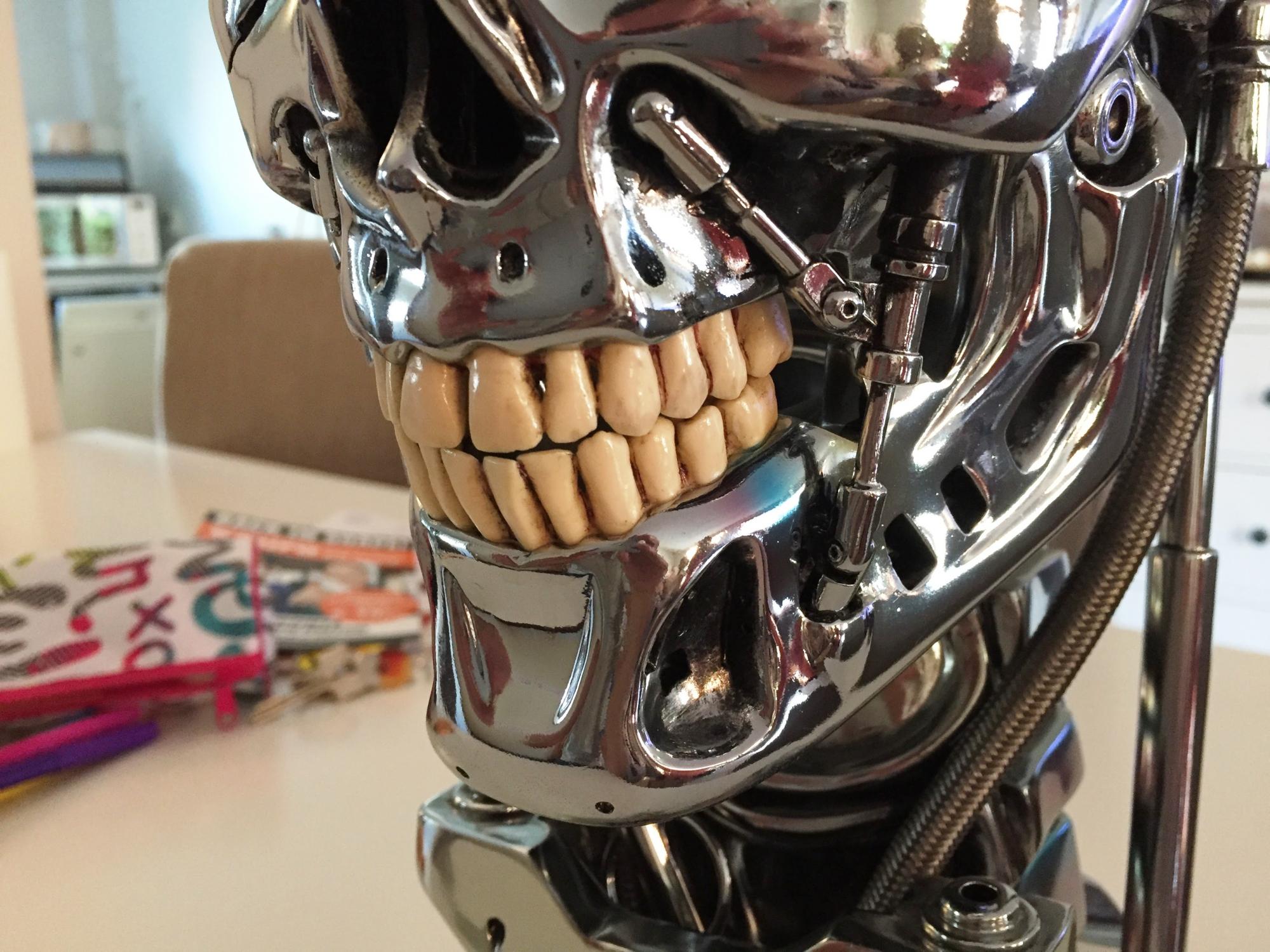

In the mean time I've coated the teeth with some varnish to give them a more realistic look. I've also darkened the gaps so they look like separate teeth in stead of one piece of plastic...this still needs some work though.

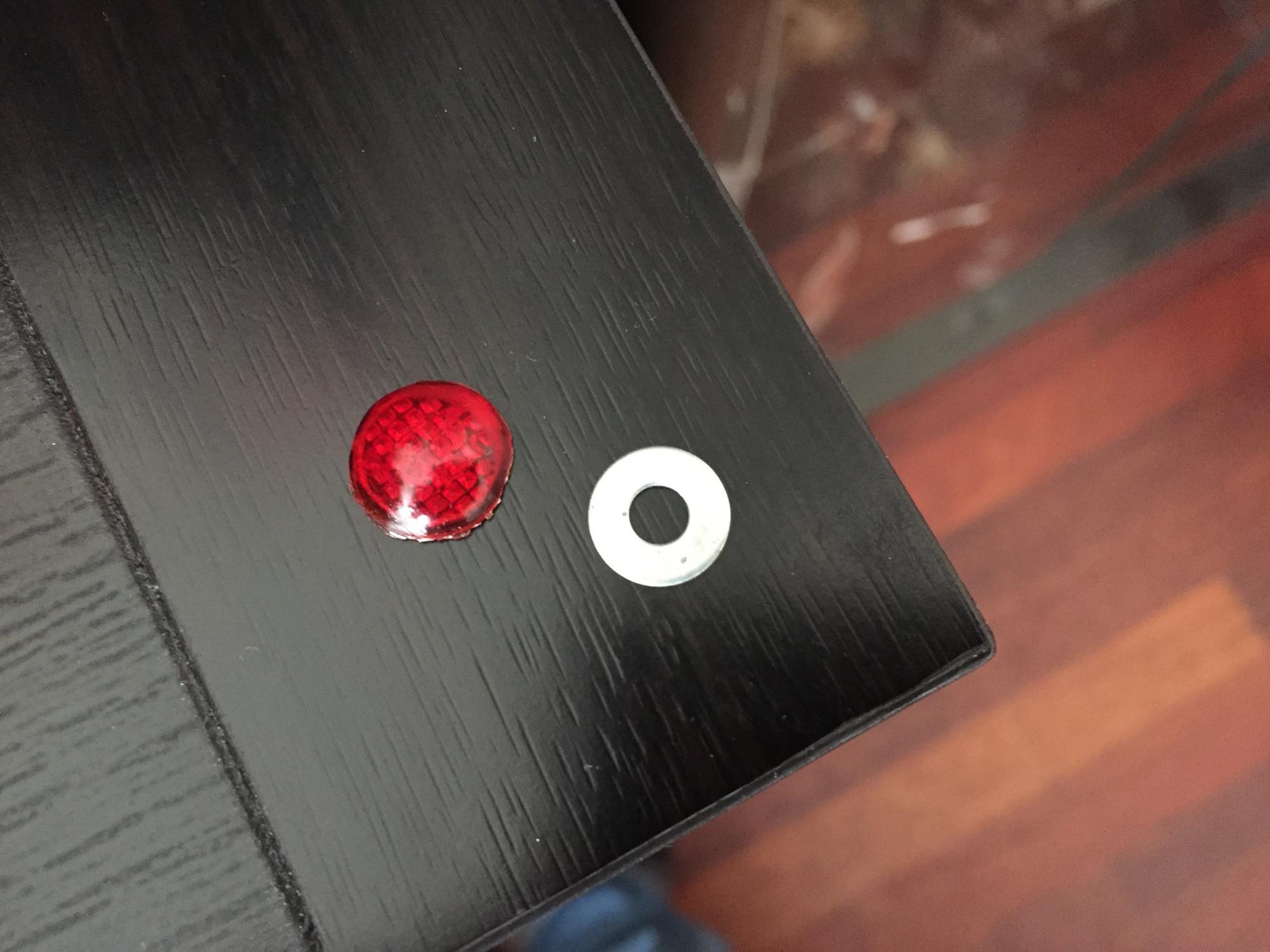

I've just took some test shots of the eye with the original red lens with a washer behind it to mimic the iris (I am still awaiting the clear lenses to arrive).
The original lens and a similar sized washer:
Left: without the washer; Right: with the washer

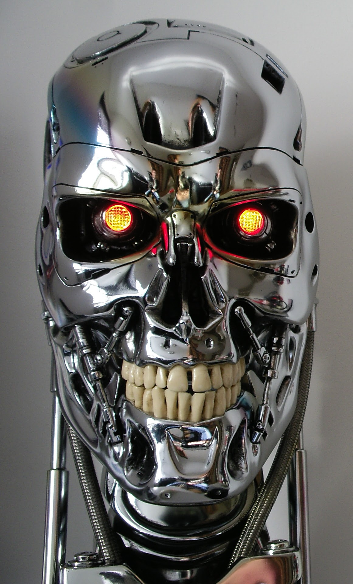

I am still experimenting with the red lenses. I've managed to get the look of both eyes exactly the same. I've used some grey "blue-tag" to fill up the area around the LED's. I've used regular glue to give the lenses a hazy look and I've put the washers behind them.
I can even use all 3 batteries because the light has been dimmed quite a lot now
