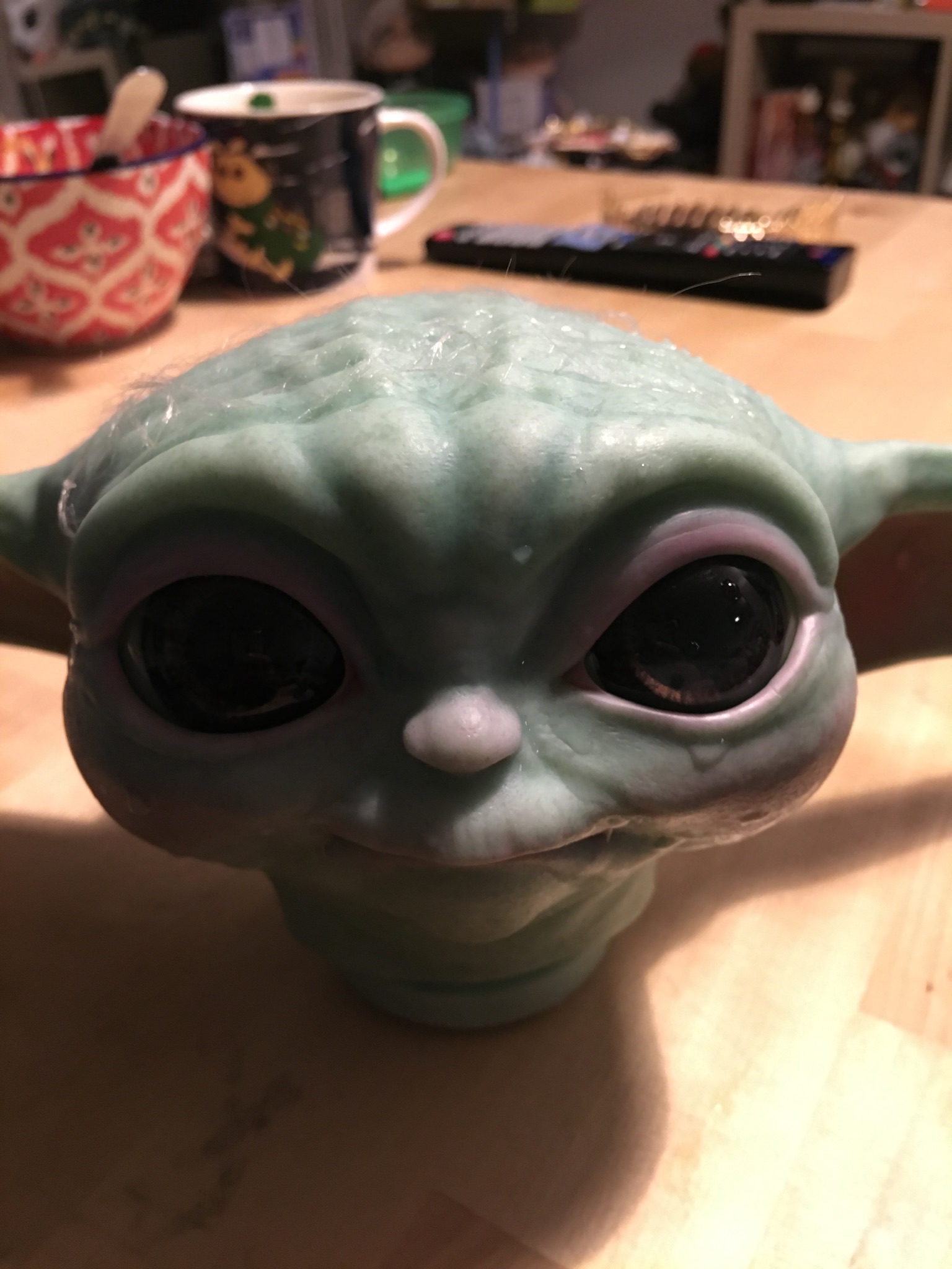

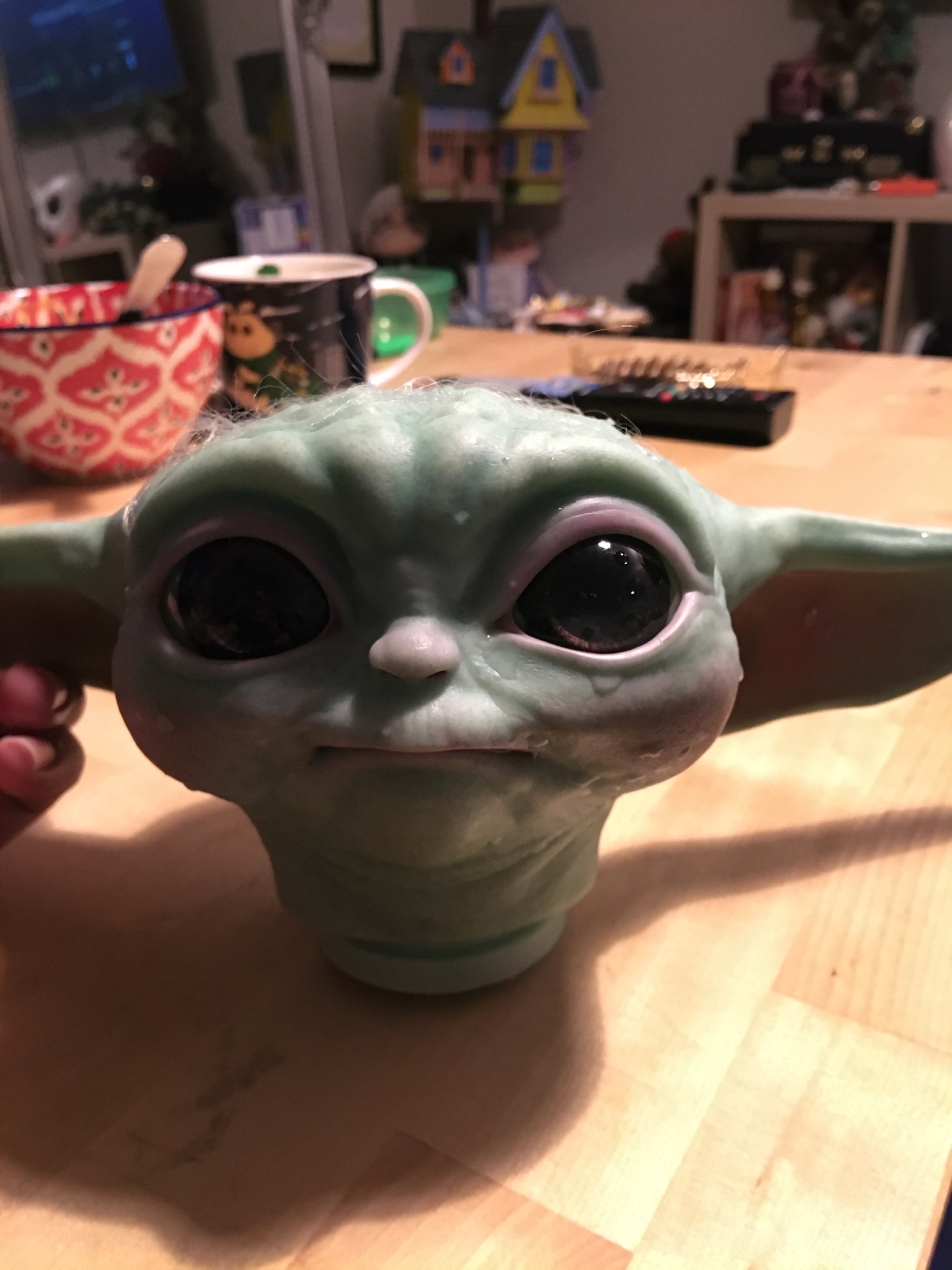

Grogu’s head. He’s been thumped on the head. Well not really, but when they were making these Grogu statues they didn’t use enough expanding foam and his head looks squished. I’ve noticed it on a few others that have posted their pics up. Once you see it you won’t unsee it and it really starts to bug you. I repaired mine about a year ago and you wouldn’t think it had the wonky head at all. You’ll notice the wonky part of his head in the top pics and the corrected head later.

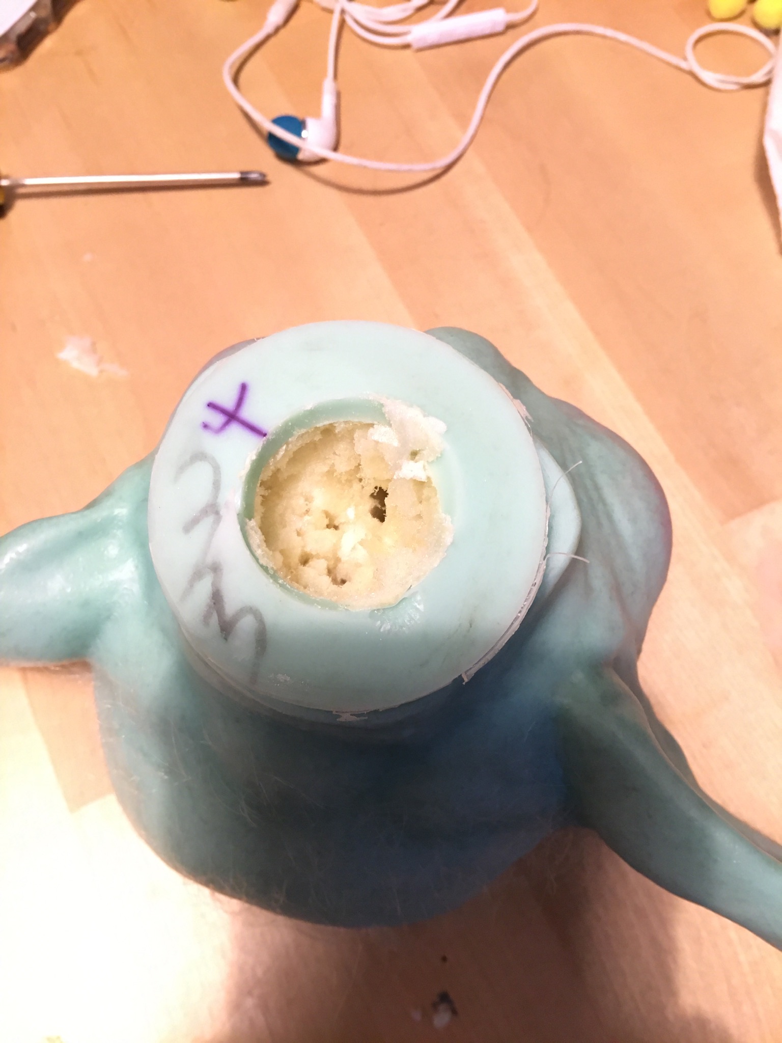

Next, you’ll have to start by digging most of the expanding foam out through the bottom of the neck. I used a small sharp knife and was carefully poking into, then a twisting out the foam. Be careful! You don’t want to poke through his head through to the other side. I removed enough of the foam that let me gain access to the wonky part of his head. You may choose to remove all of the expanding foam though.

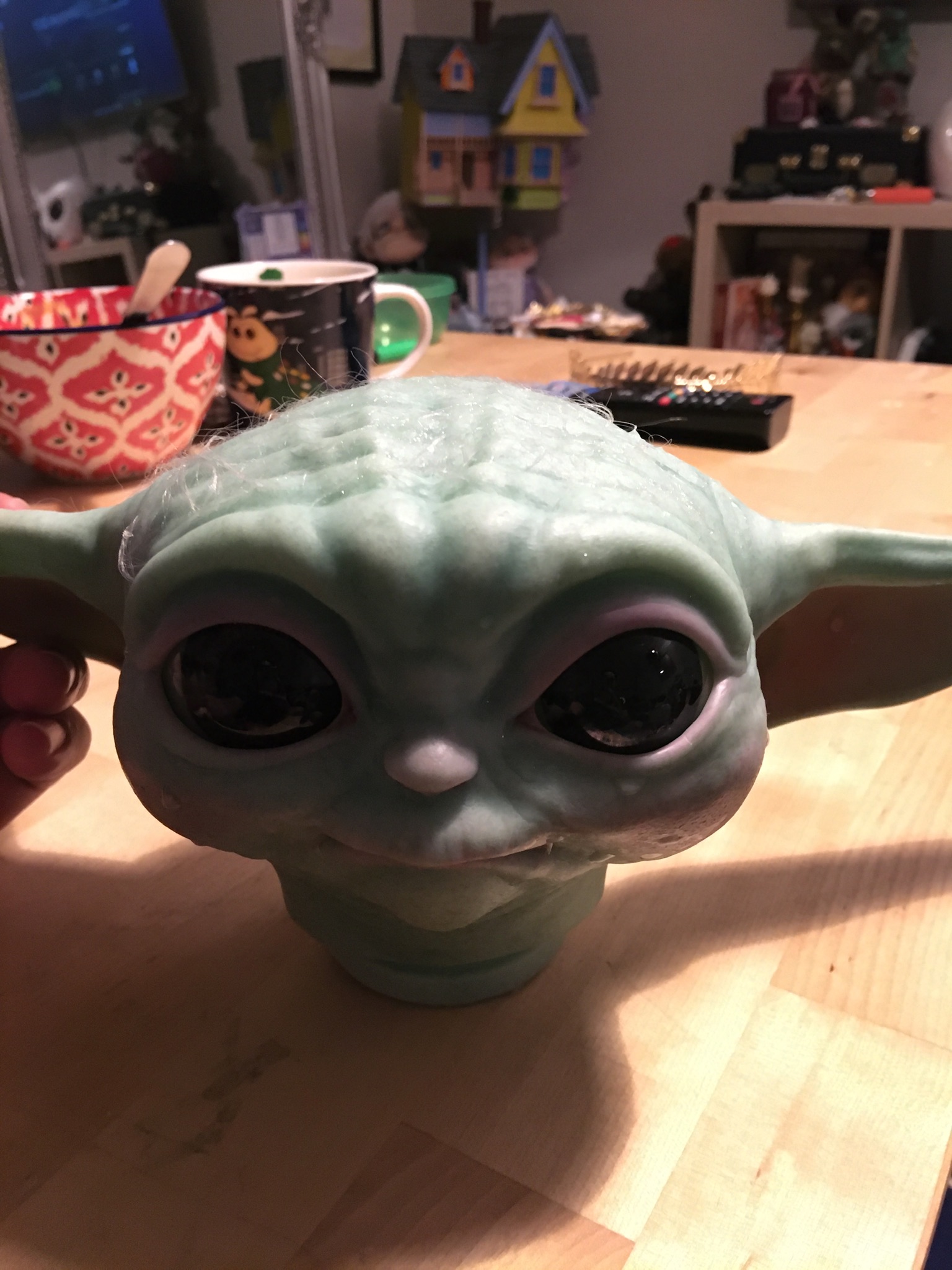

Remove the hot water and immediately fill the head with cold water. This will immediately make the plastic head keep to the corrected shape that you re-formed it to. You may need to do it a few times to get the shape you want or are happy with.

I’m happy that I fixed it, and the result speaks for itself. It was an easy fix and didn’t cost me anything other than an existing can of old foam.
