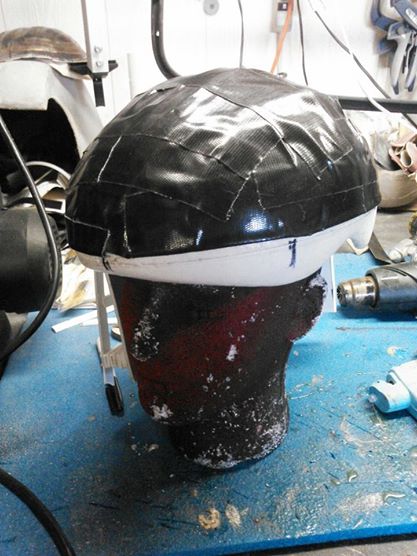

Once I had the plastic the way I wanted it, I wrapped it all in duct tape. This gave me a rough shape to the helmet.

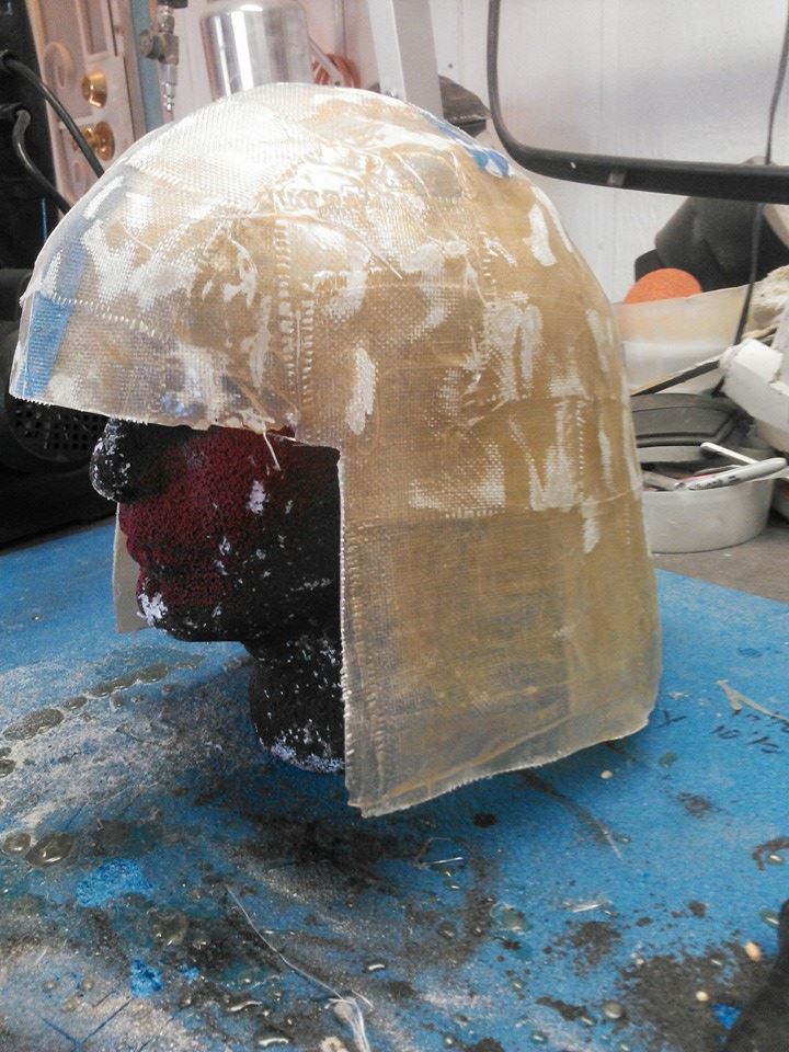

Then when that processes was complete I then wrapped it all in fiberglass and pulled it from the bike helmet. When doing this processes
its better its better to make one side then separate it from the mold then make the other side.Once that is done take the two hales and
make them one...I made it all as one part and tried pulling it apart...it didn't work...and I destroyed the original mold. But the good news is,
I got the part I needed!

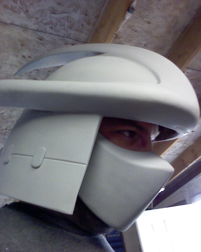

Once I was able to get a shape I liked, I did more bondo work to smooth it out before sanding and priming. Here's everything together all primed up.
10442336_10204705548412879_5389435435681957962_n.jpg10922762_10204705550532932_1196238367069324981_n.jpg10931404_10204705549772913_4924550379165068810_n.jpg10931425_10204705548892891_6967015714316144467_n.jpg
And how it looks on a real face (couldn't help it, had to put it on)
