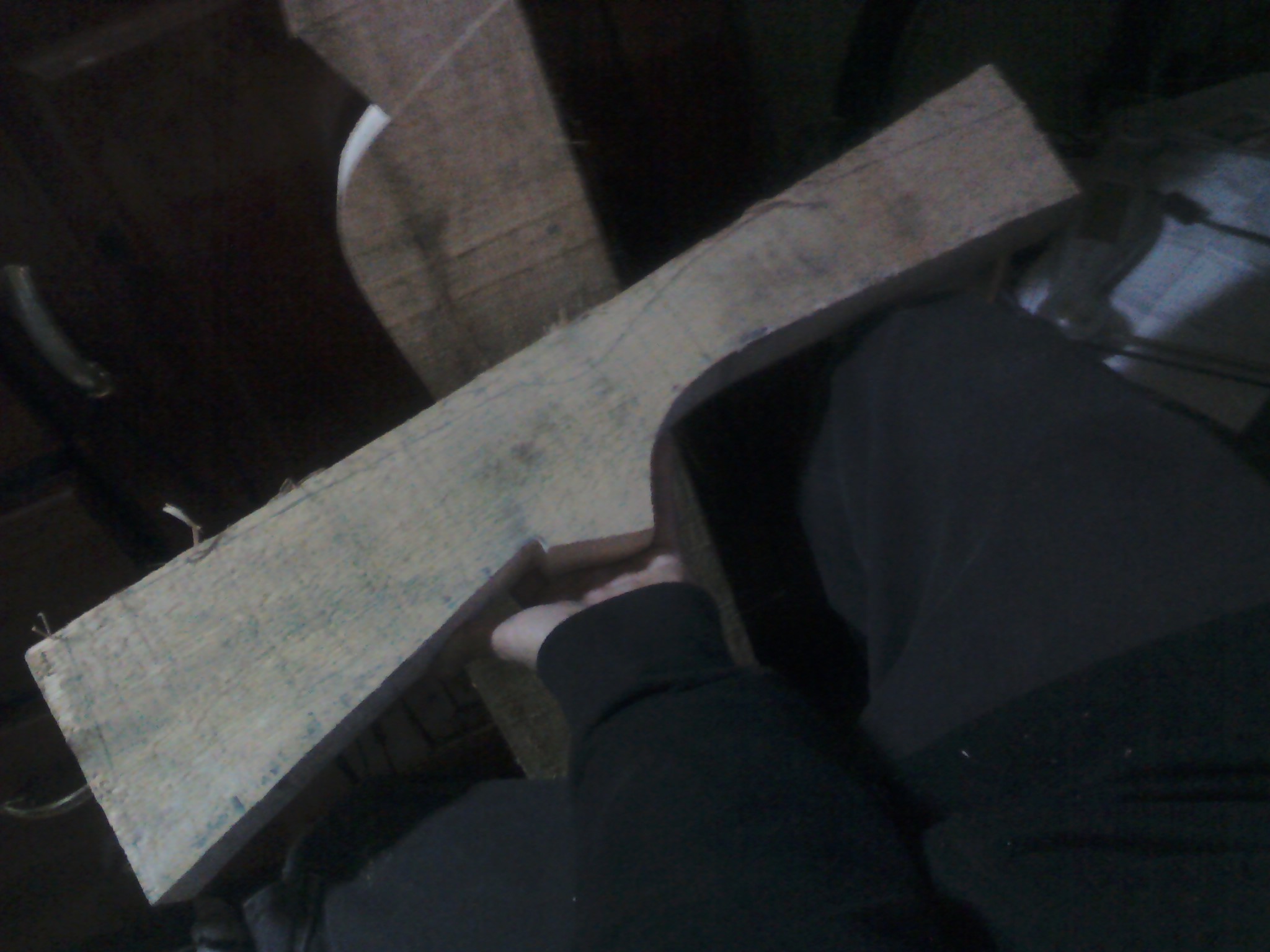

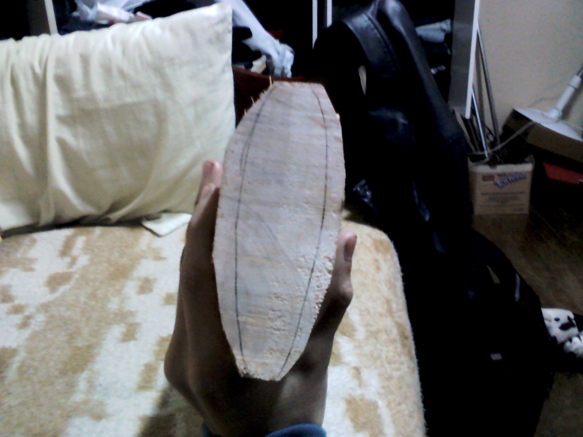

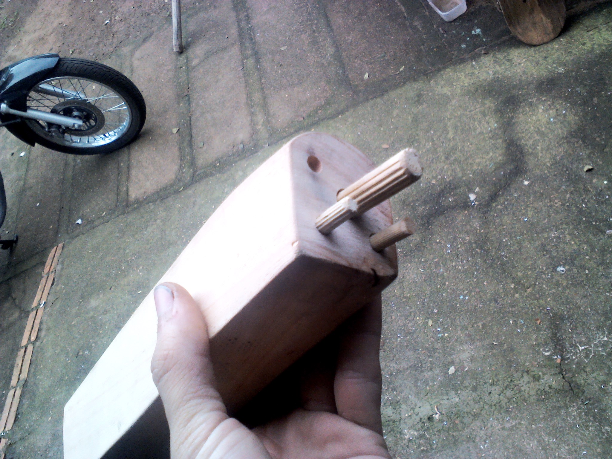

here is the wood plank that I've have used

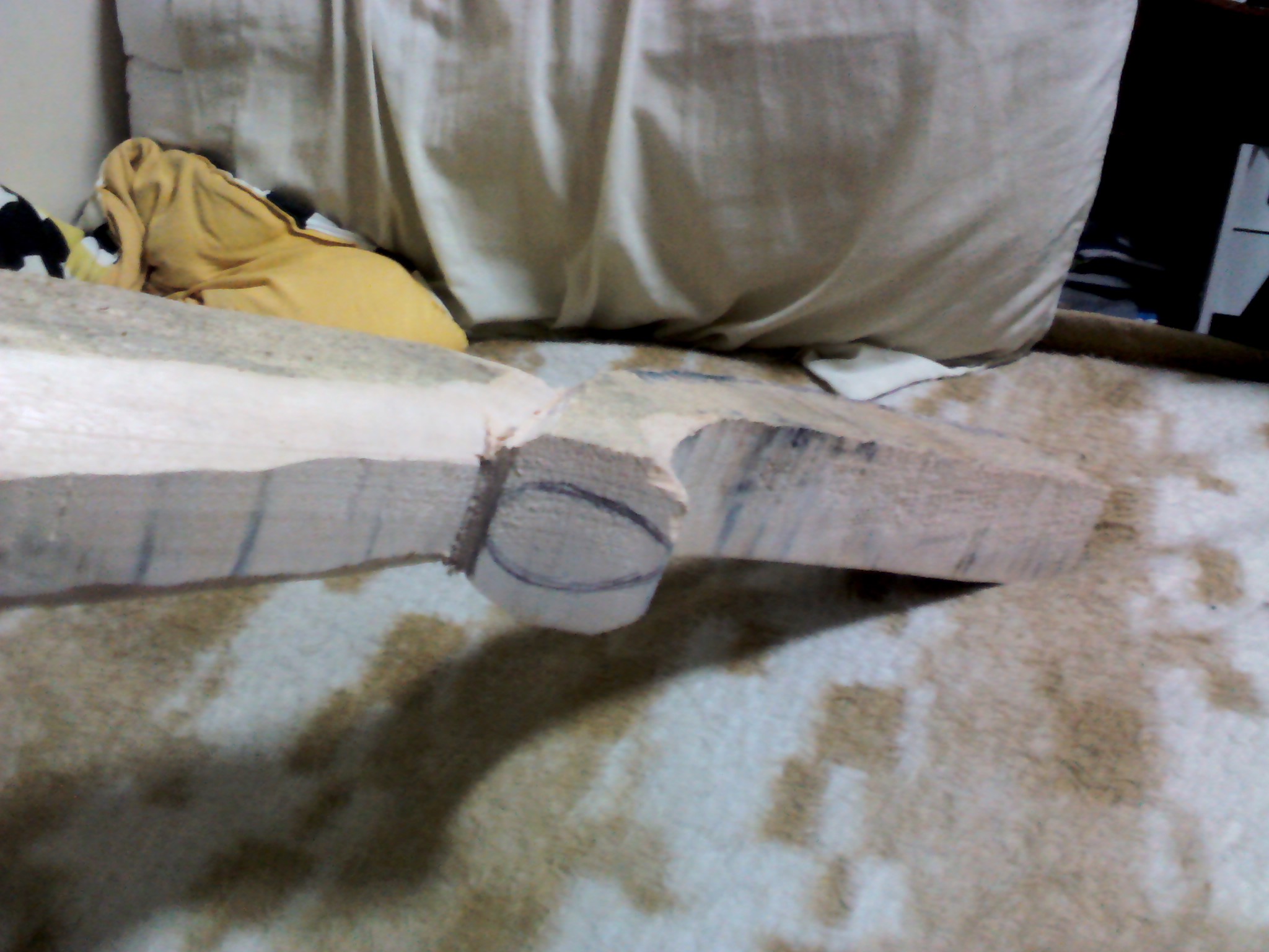

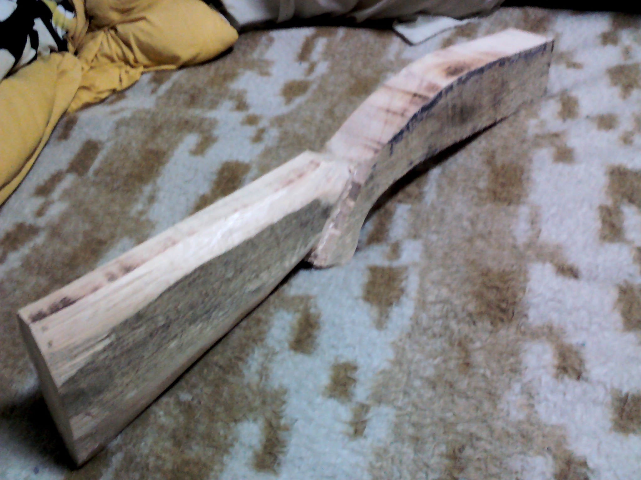

first, I have draw the silhouette of the gun in the wood, and then I sawed

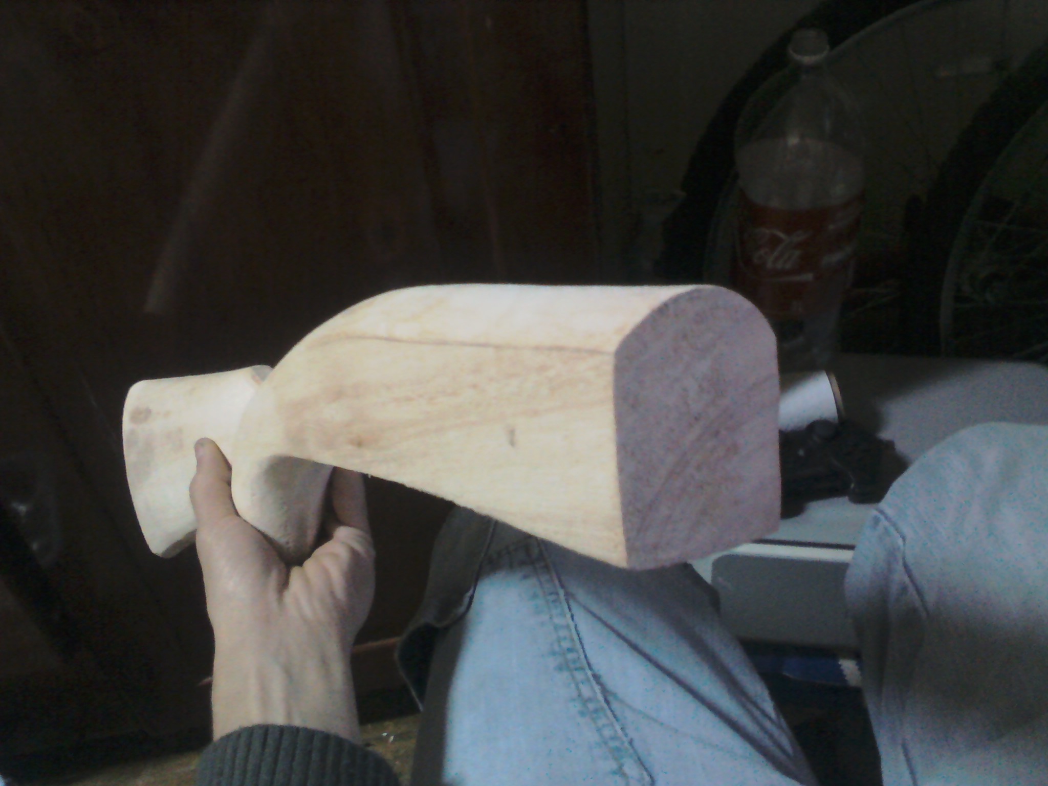

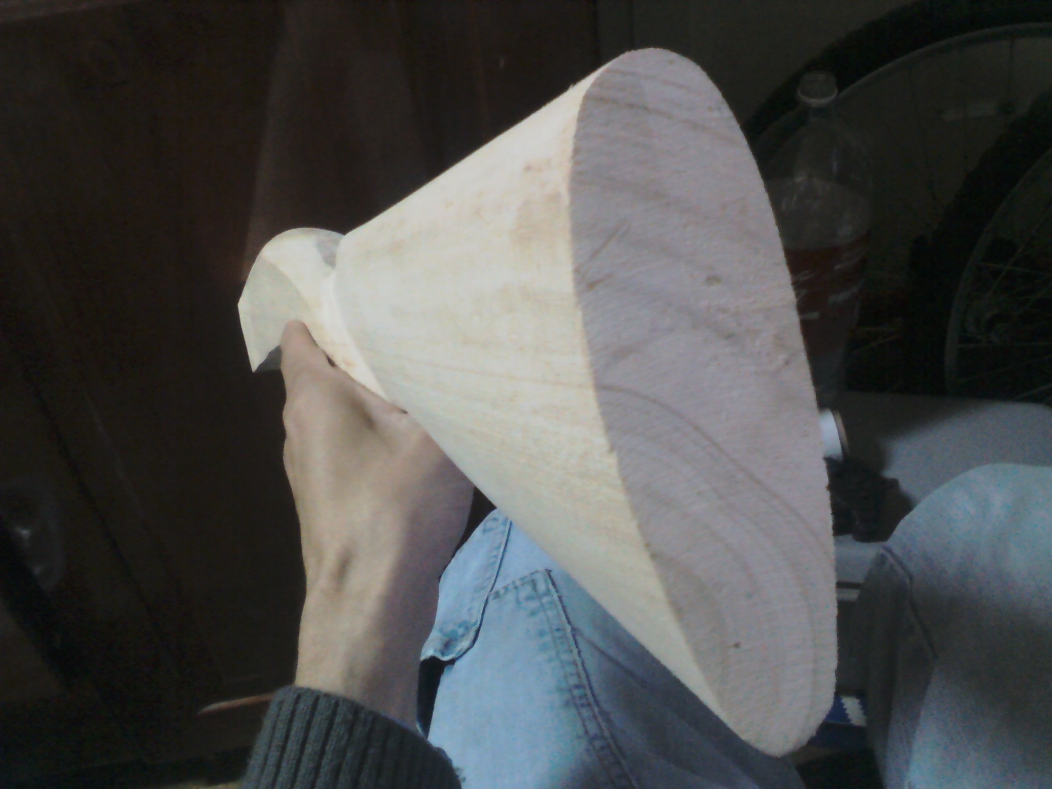

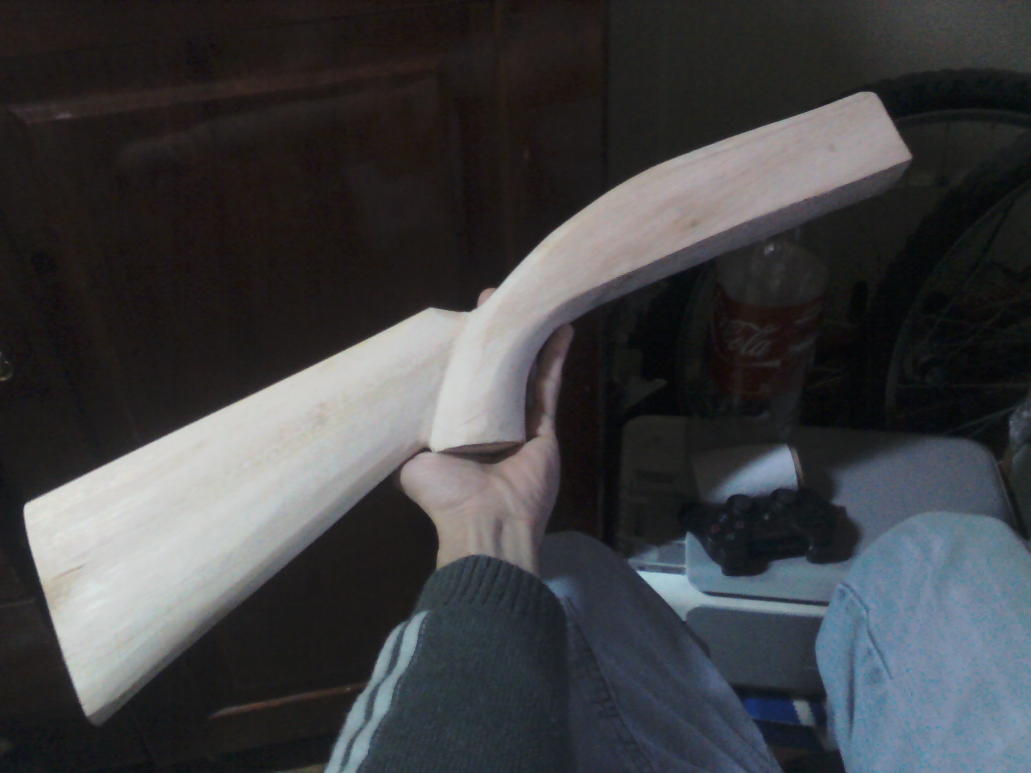

after, I've Sculpted the wood to aproximate the forms of the pictures that used as reference

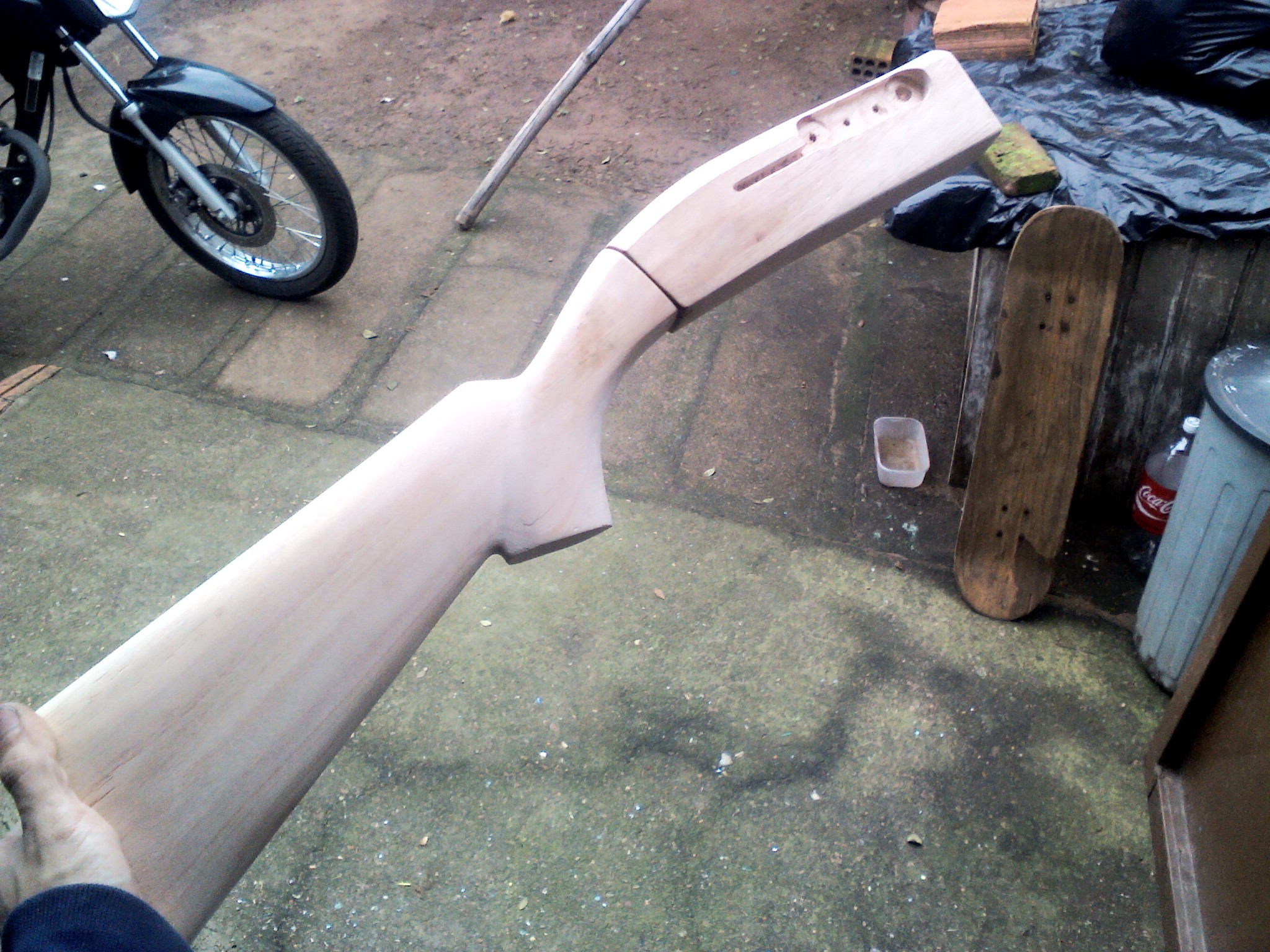

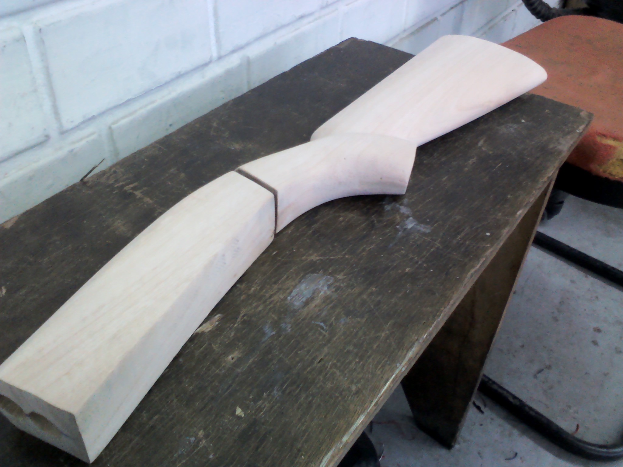

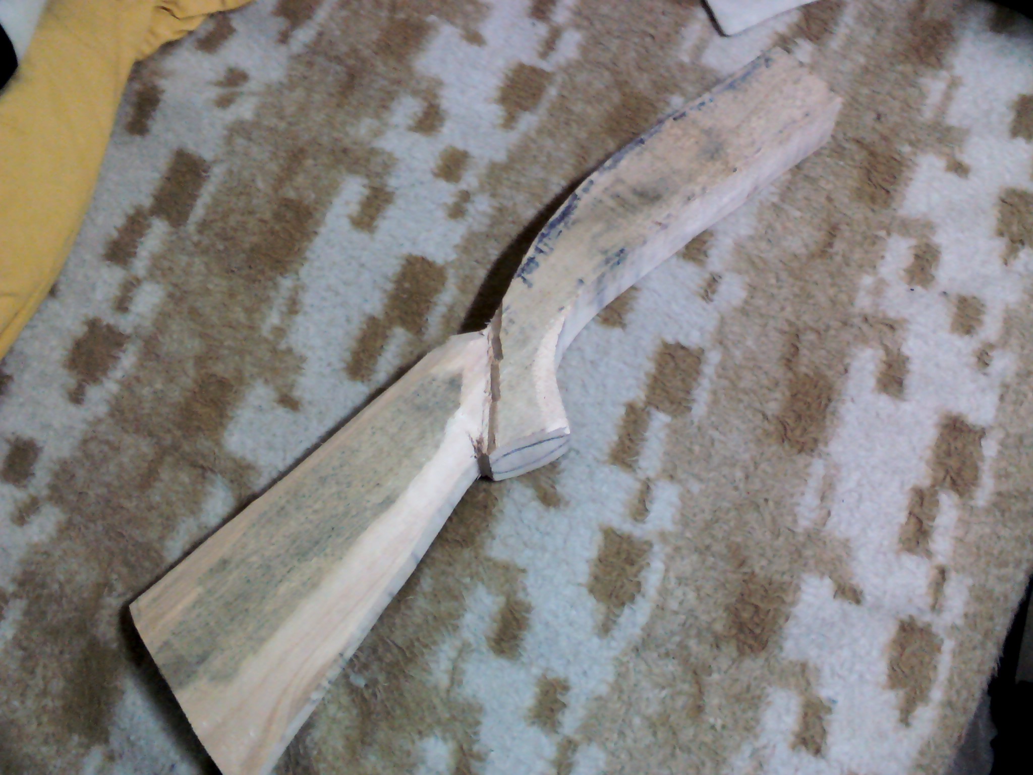

after sanding process got like this

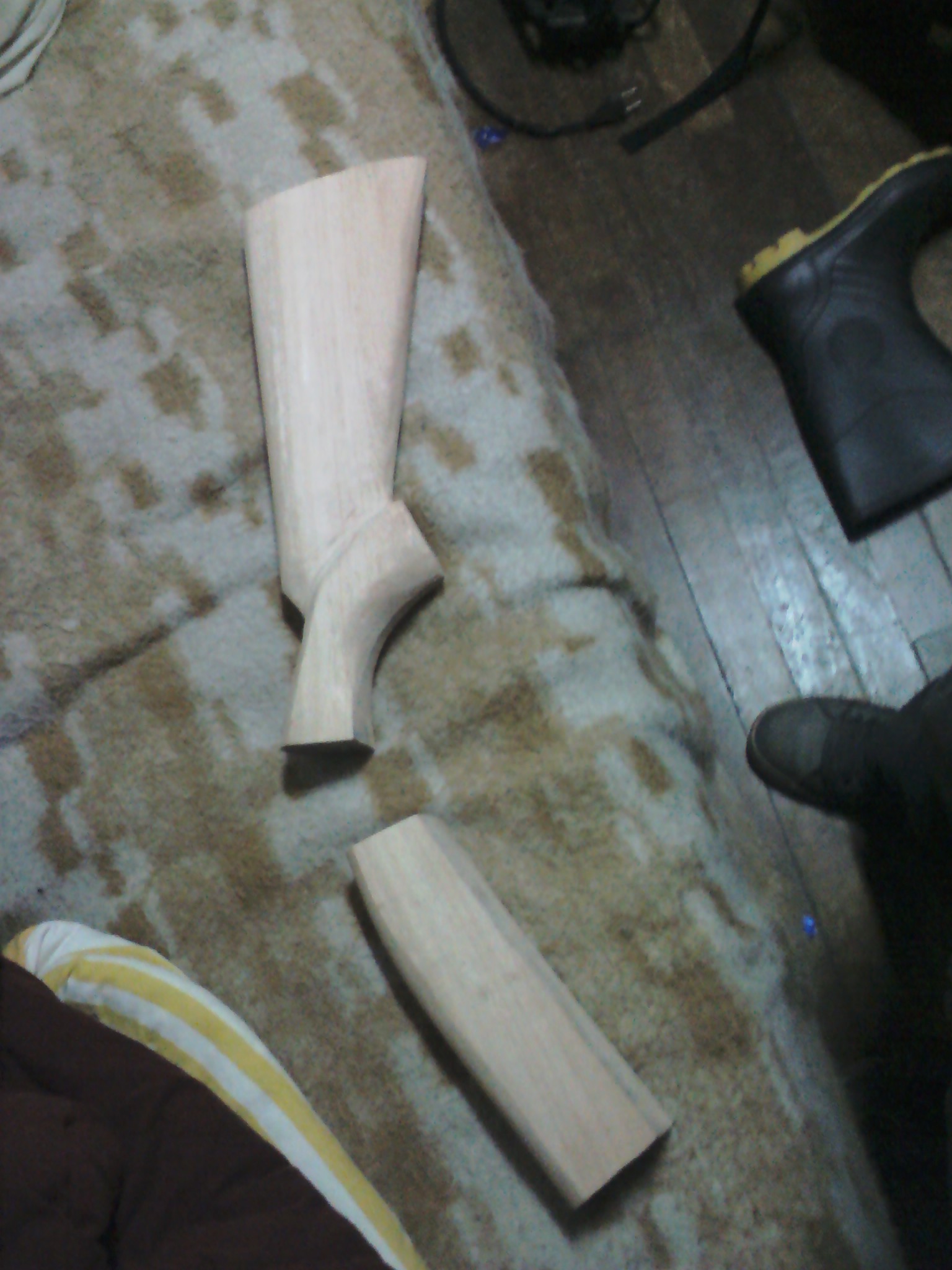

then I split in two parts, because the paint process of them are diferent

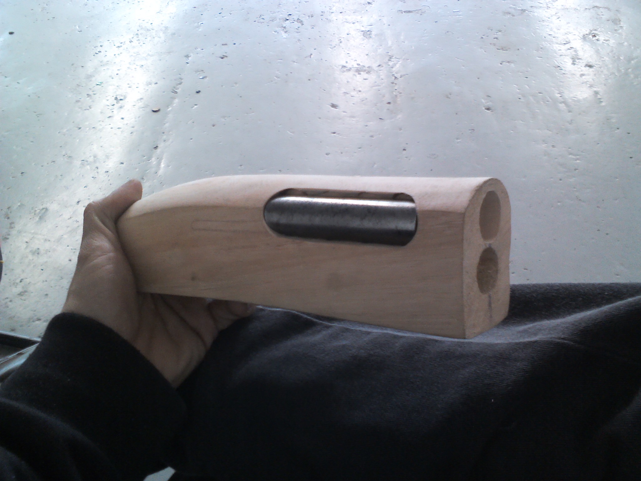

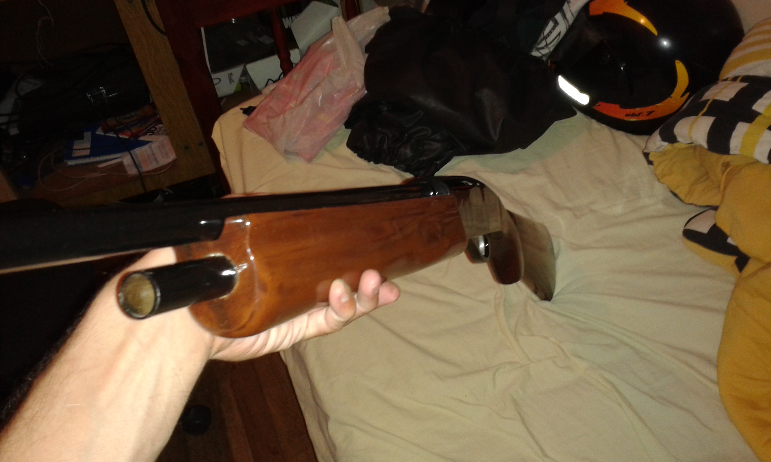

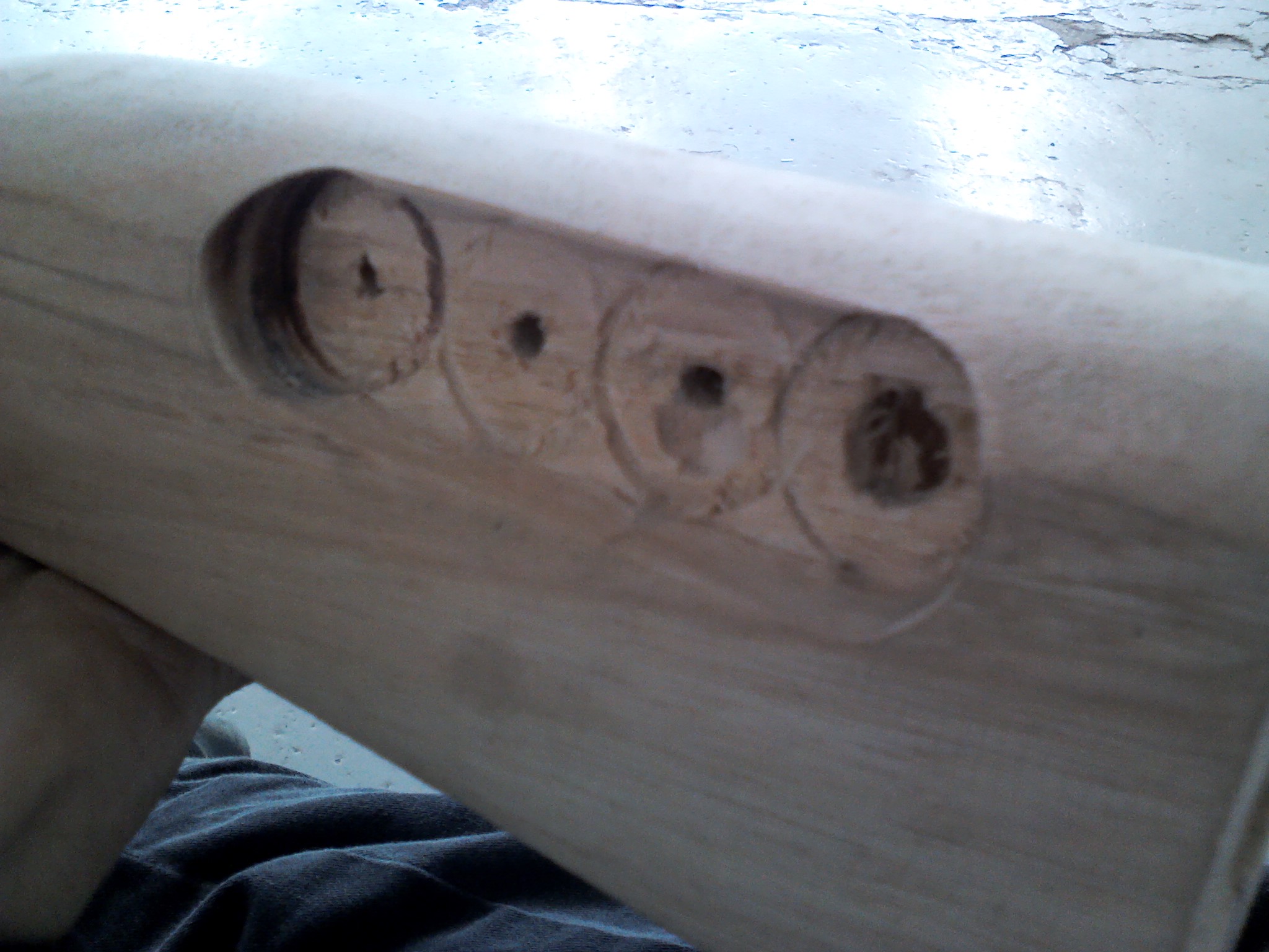

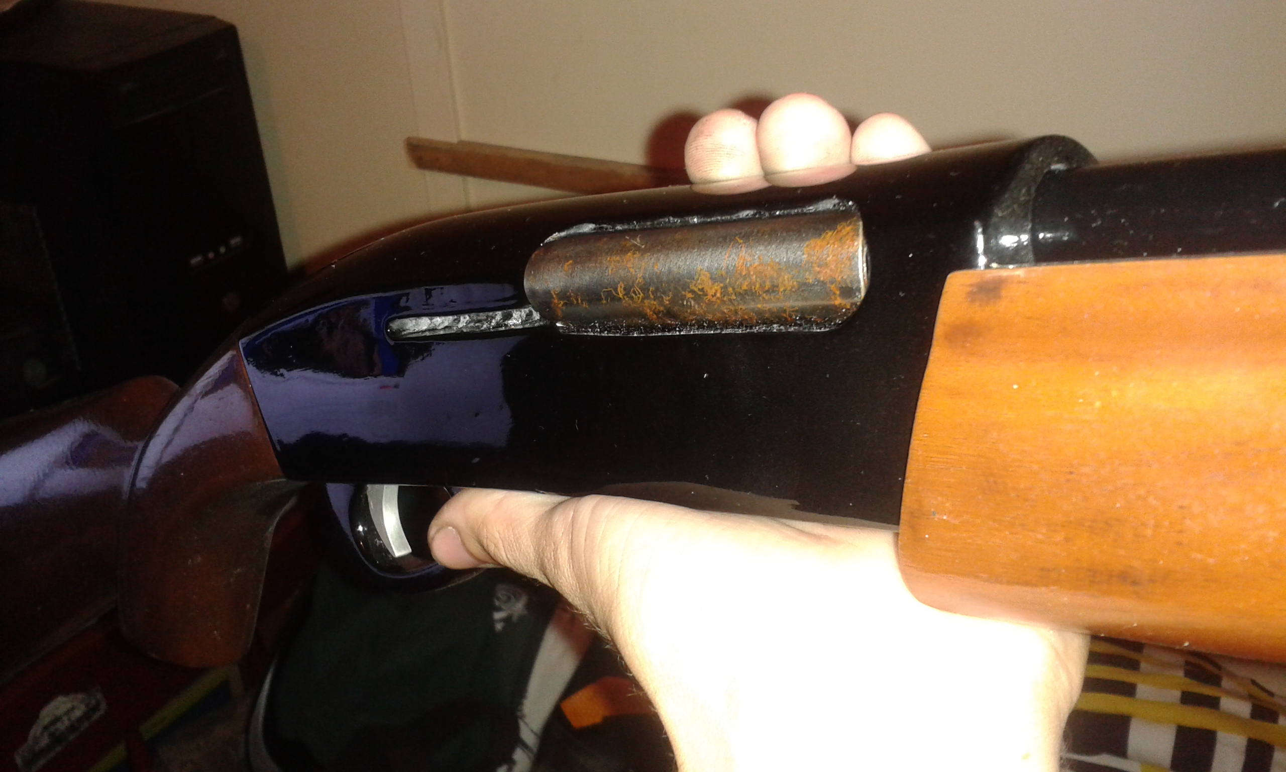

chamber window detail

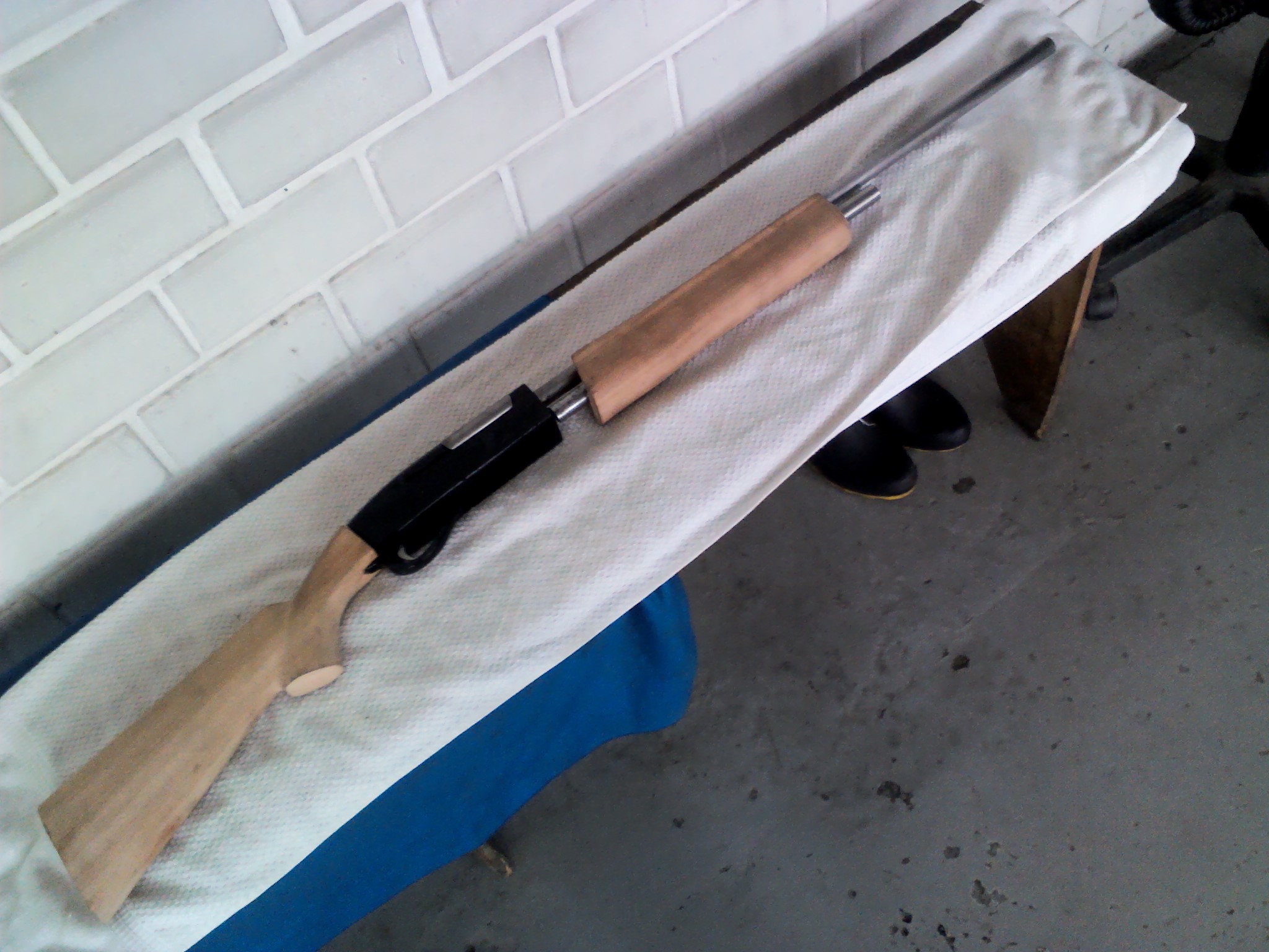

the chamber already painted

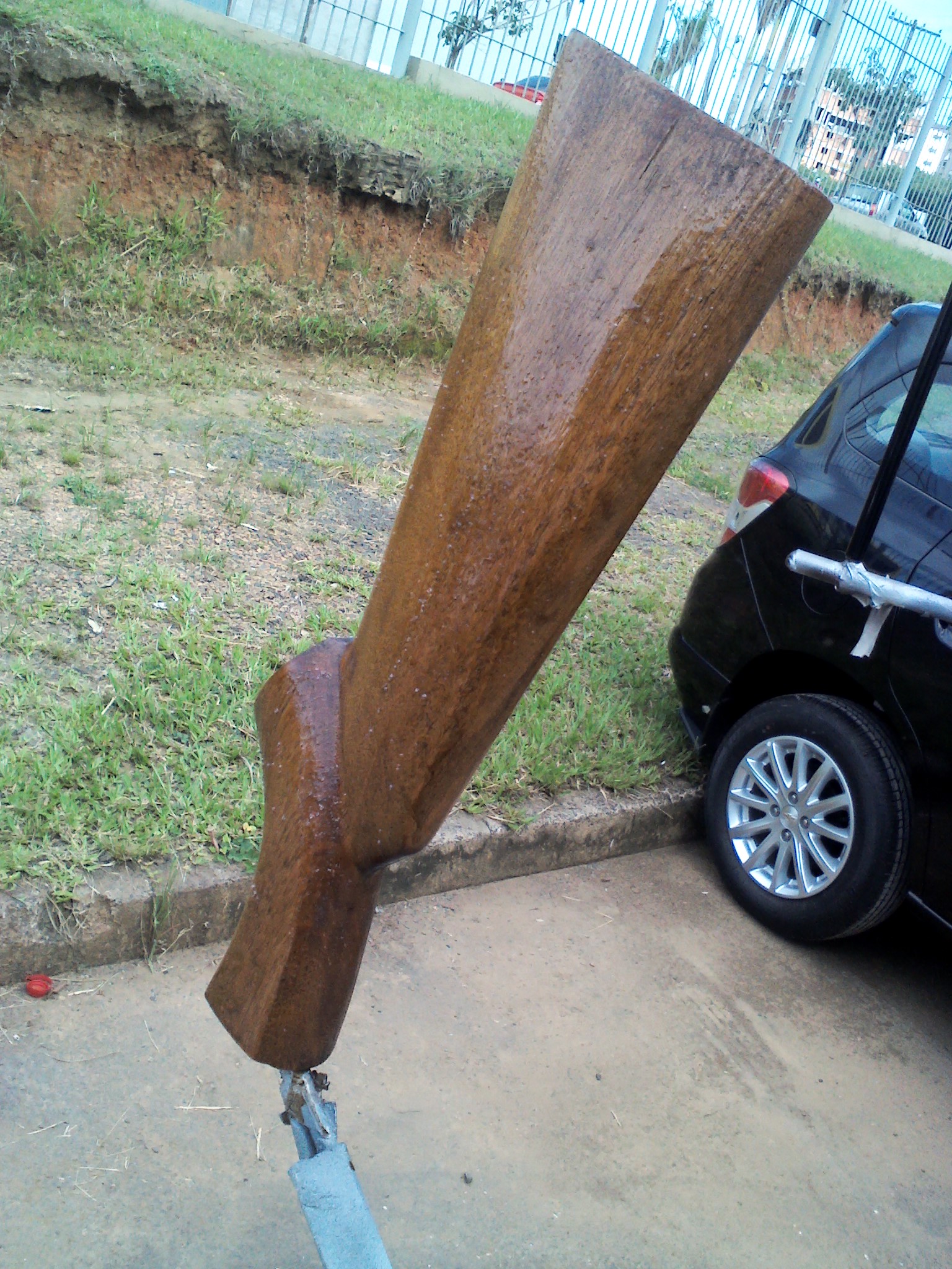

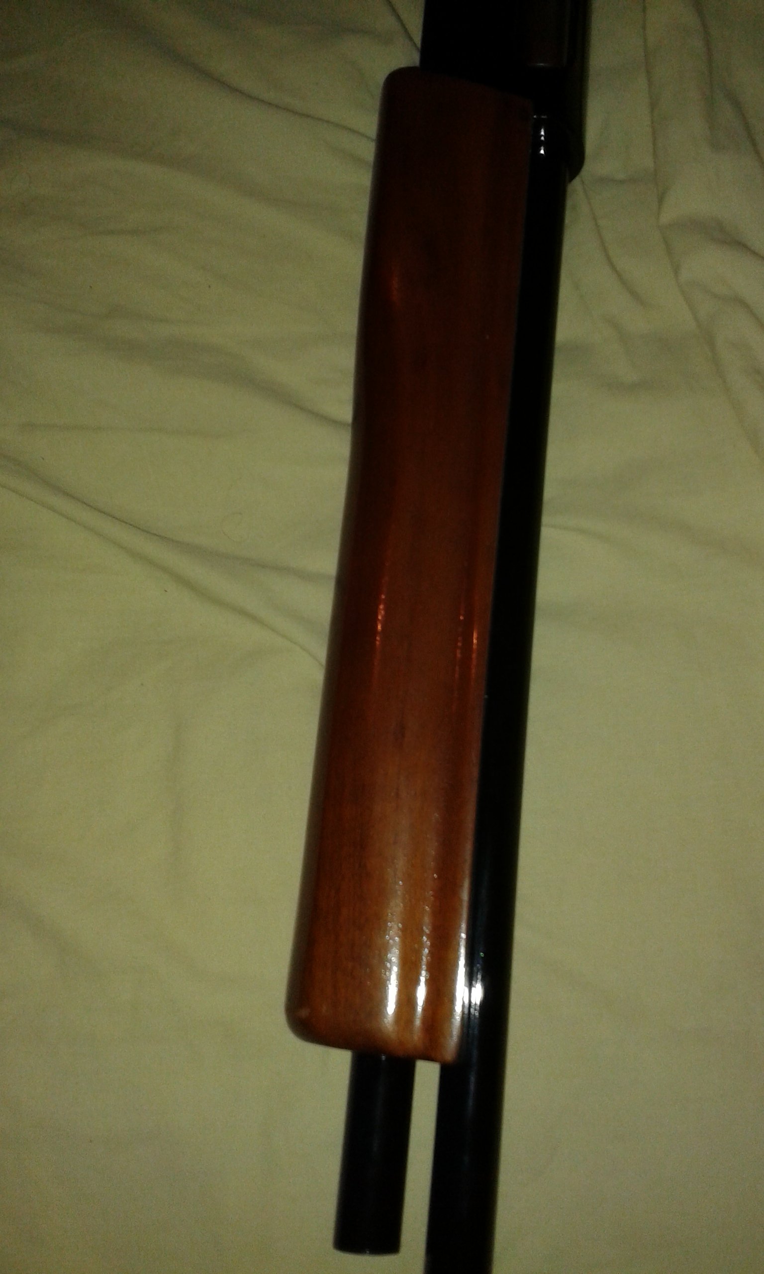

the stock and forearm

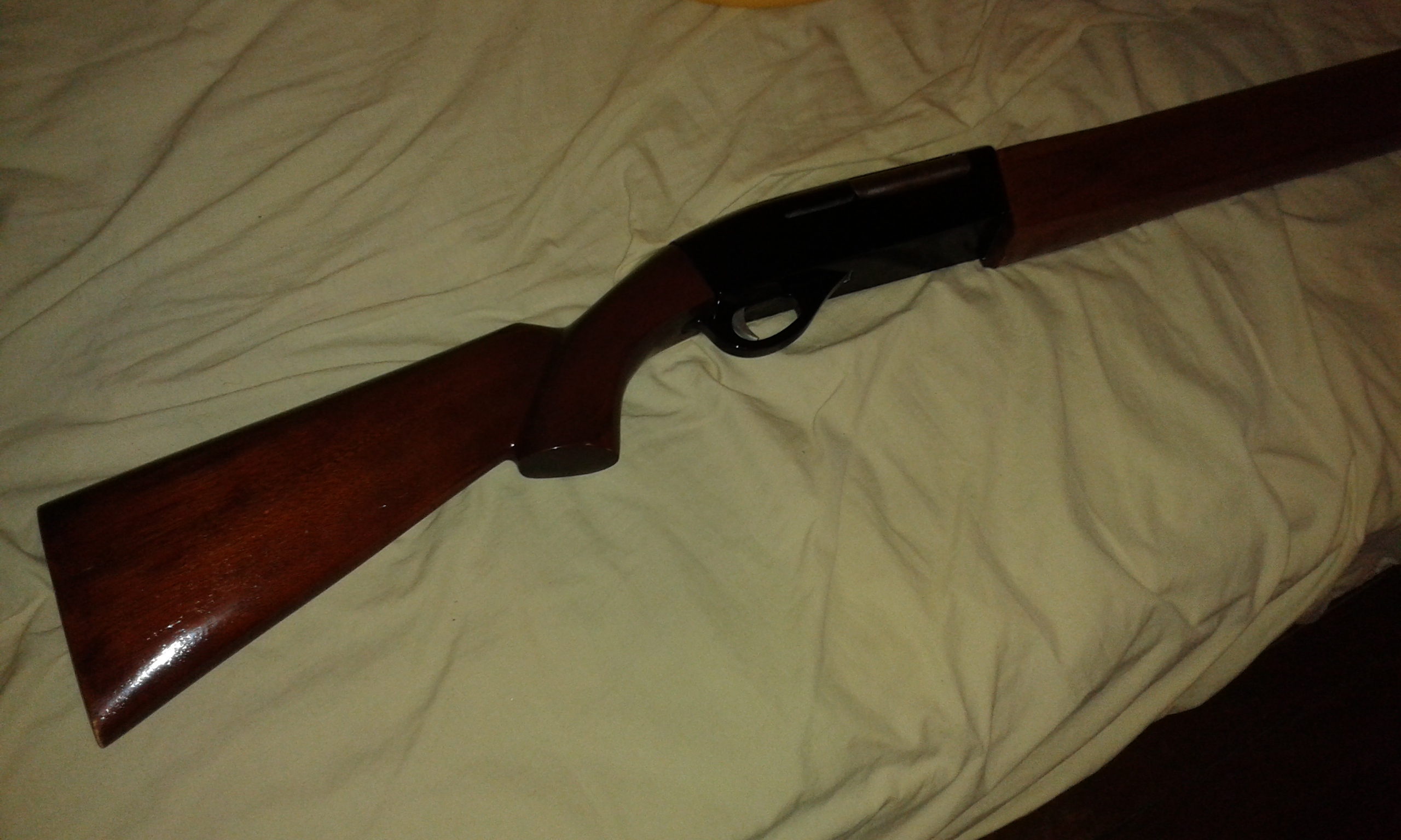

final stage
any questions?

Looks good. I especially like the rust detail around the chamber, I mean, aside from that beautiful stock. What was your process for painting the barrel and assembly? Looks extra shiny...
-K
I like it. I think you did an amazing job on this.:thumbsup
And welcome to the RPF.
thank you guys
the painting of the chamber I used primer polyurethane in the first layer, and then, polyester paint (automotive) by spray gun
the barrels were painted with a common aerosol spray matte black and covered with incolor varnish
OBS: everything was well sanded with sandpaper grits 180, 220, 400, 500
