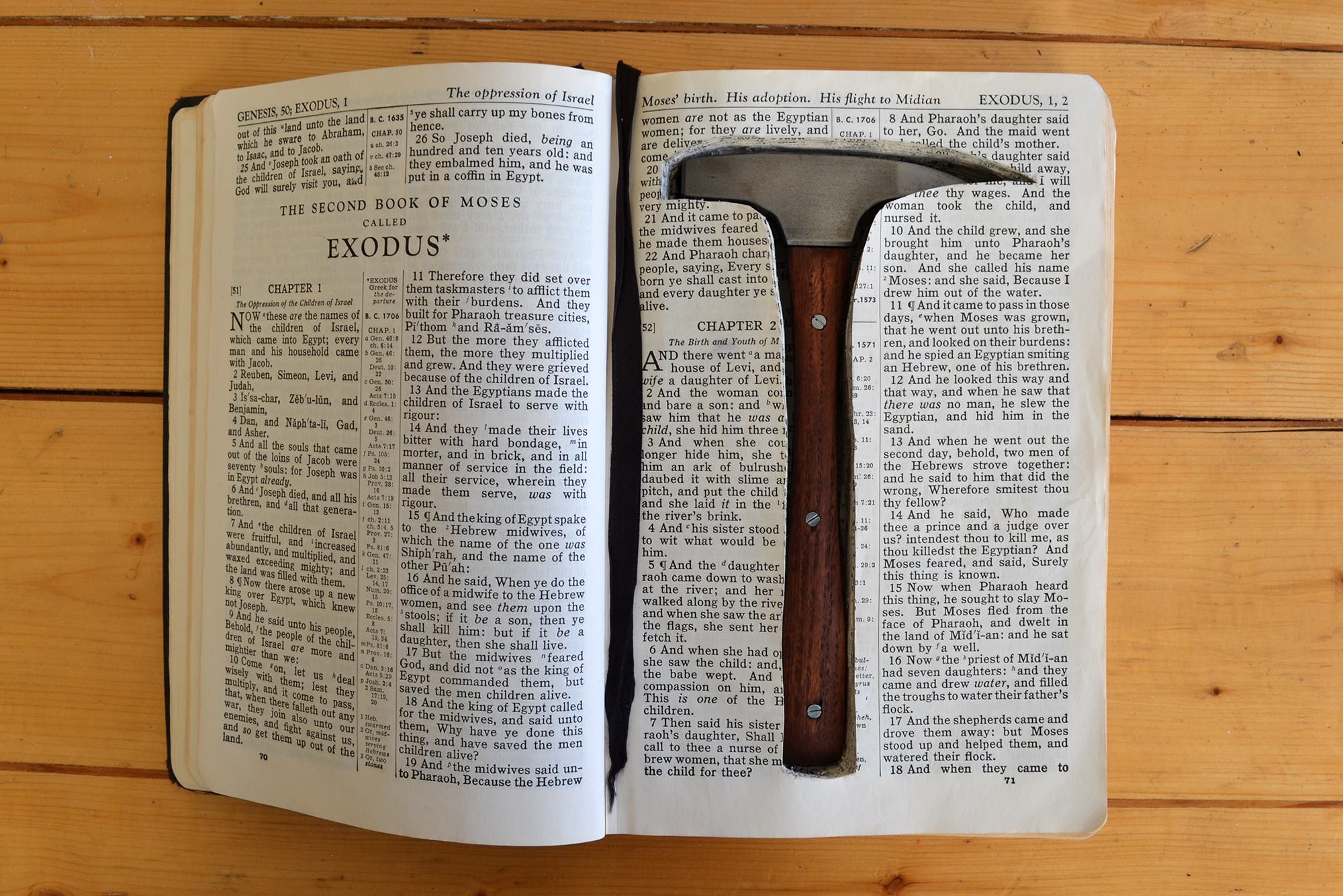

One thing I really wanted to get right is the shape and size of the cutout. I found this website where the screen-used Bible is being repaired.
The Restoration of The Shaw Shank Redemption Bible - Todd Gunter Art Restoration
It has a great head-on photo of the open Bible (see below). This gave me an extremely clear view of the cutout on the Exodus page. Using tracing paper over my Exodus page, I drew the shape of the cutout by matching where the cut on the screen-used Bible intersects with each letters in the copy below. This gave me an EXACT size and shape that correlates to the screen-used prop.
I used this shape to make a cutting template from 2mm HDPE sheet. To cut the pages, I placed a second piece of HDPE under 8-10 pages, and the template on top. Then I cut through only the 8-10 pages without damaging other pages. It took about an hour to work my way down to Page 763 – The exact page the screen used Bible stops at (I was able to identify the page from the pics on the restoration website as well)

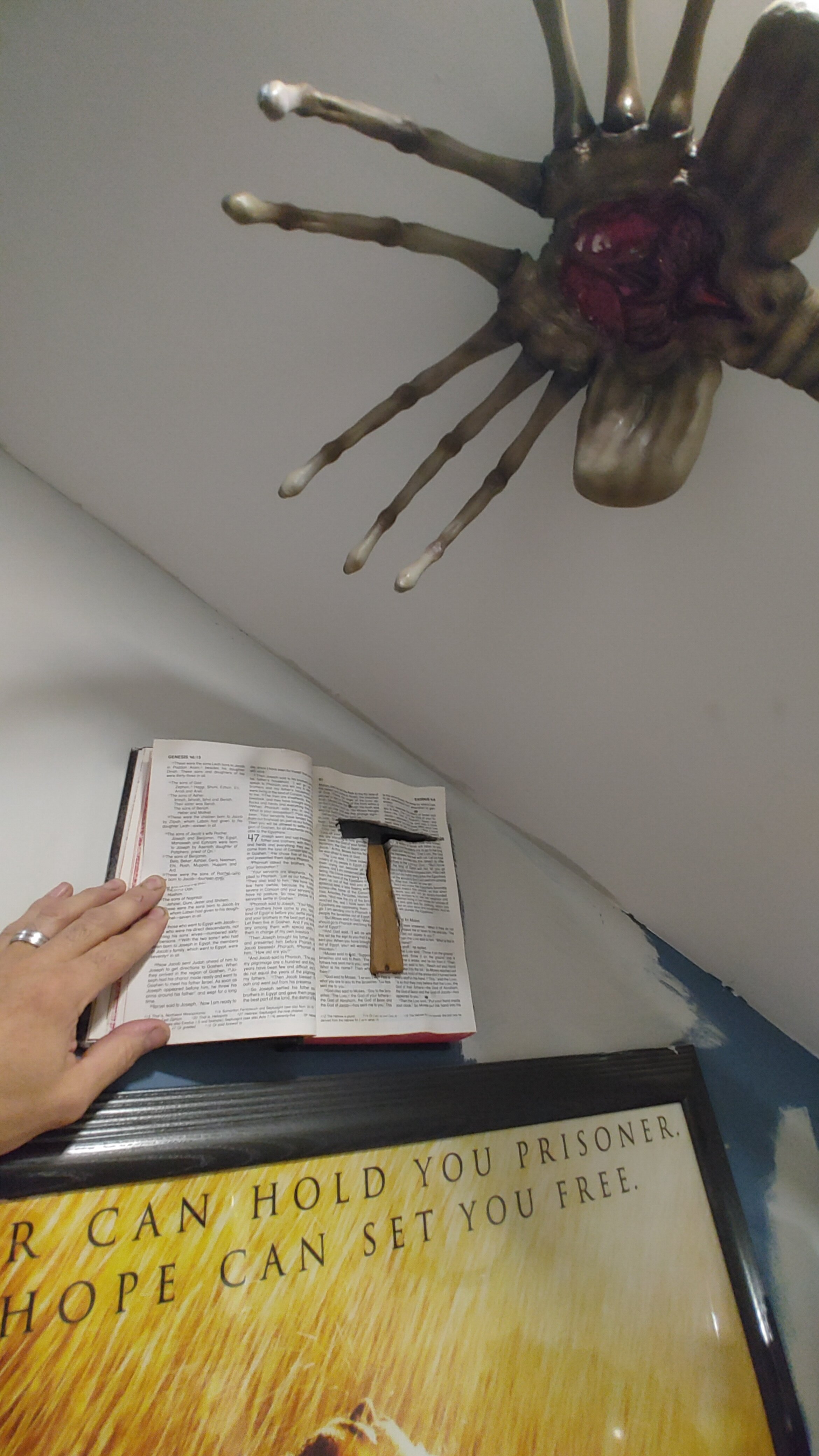

I plan on replicating the note from Andy to the Warden on the opening page. And, I plan to make a rock hammer to fit. Probably cold cast resin. Stay tuned.

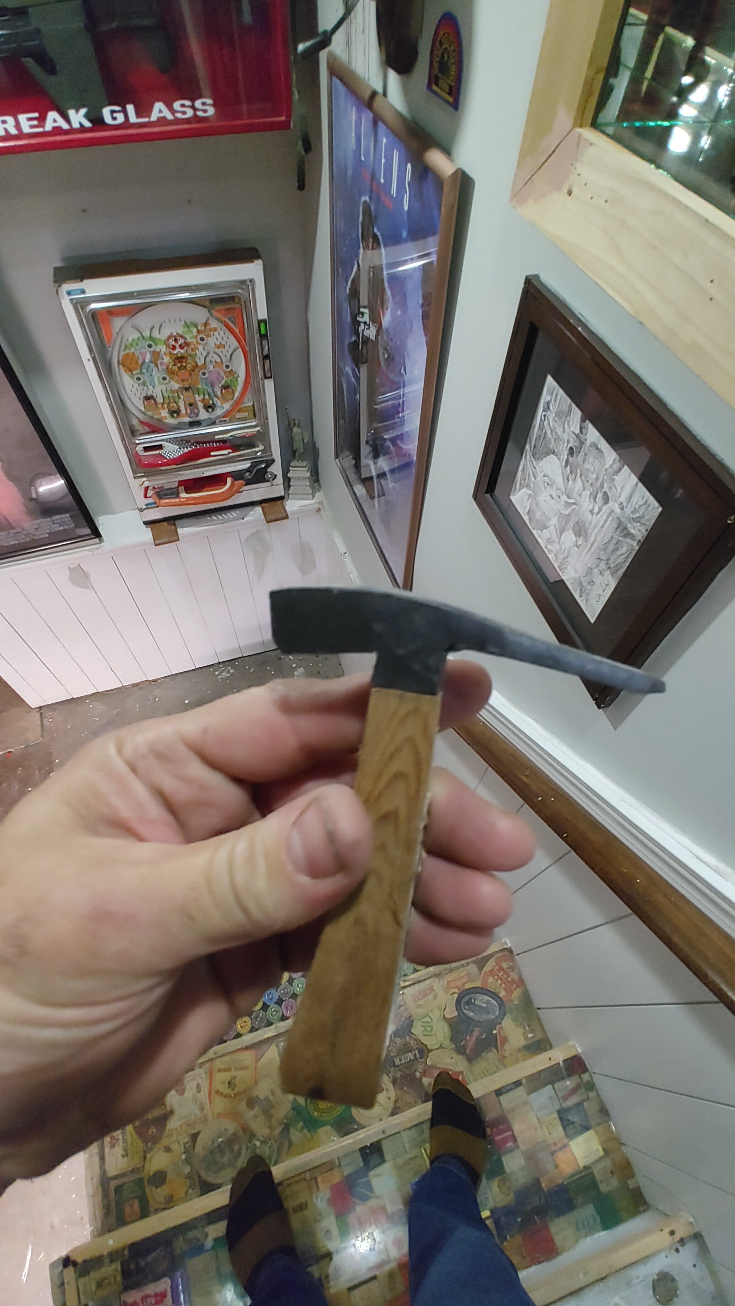

Digging in on the hammer today. ... After seeing there's at least two different "screen-used" hammers I remembered I need one to fit the cutout in my Bible :) ... Interesting that we never saw one in place. I'm going for form over function for mine. Styrene "metal" part and wood grips.
