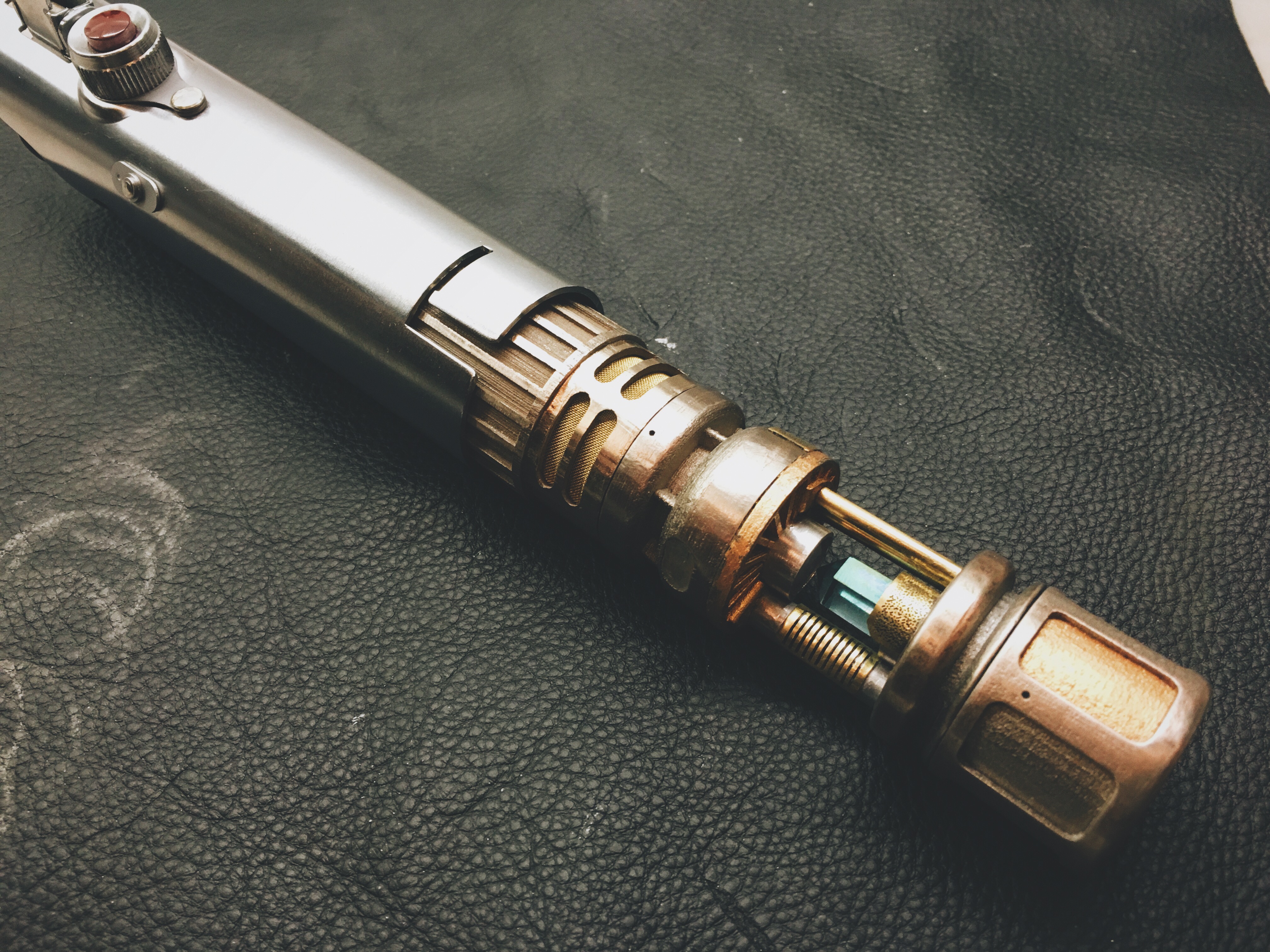

I just used shape ways to print parts of my lightsaber chasis. It is so hard that I destroyed 2 cobalt bits trying to drill 1mm holes in it and there's still no hole. So yes it's extremely durable. They do the print then it goes through a tempering process.
Make sure to have any details you want in the 3D files before you get it printed. It's very tough to cut it afterwards. Possible but a pain in the ass.
As for the surface texture there was a bit of the layers texture that you get with 3D printing. It's not as smooth as some of their examples, those things were polished which they don't explain. The coloring like the gold is just a coating and I actually sanded through it on one of my early parts. Here's a picture of what my parts look like after I took a dremel to kill some of the texture. You can see where I sanded it to a smooth. The deeper bits that I couldn't get my dremel into have the texture.
