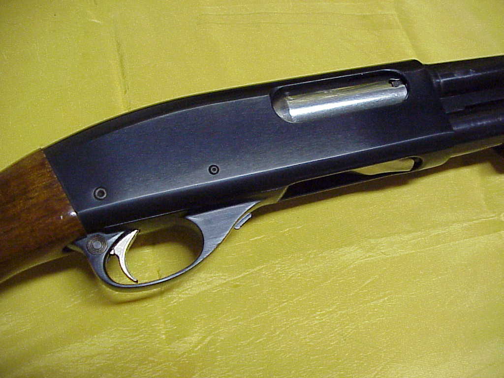

The first pic can probably be done with a gunmetal base followed by a black wash and some steel wool to get the grain effect.
The second pic looks much easier since it's the "gun blue". Metallic base followed by thin coats of a blackish-blue until you get the blue you want.
Thats how I would do it if I didn't use metal to begin with.
