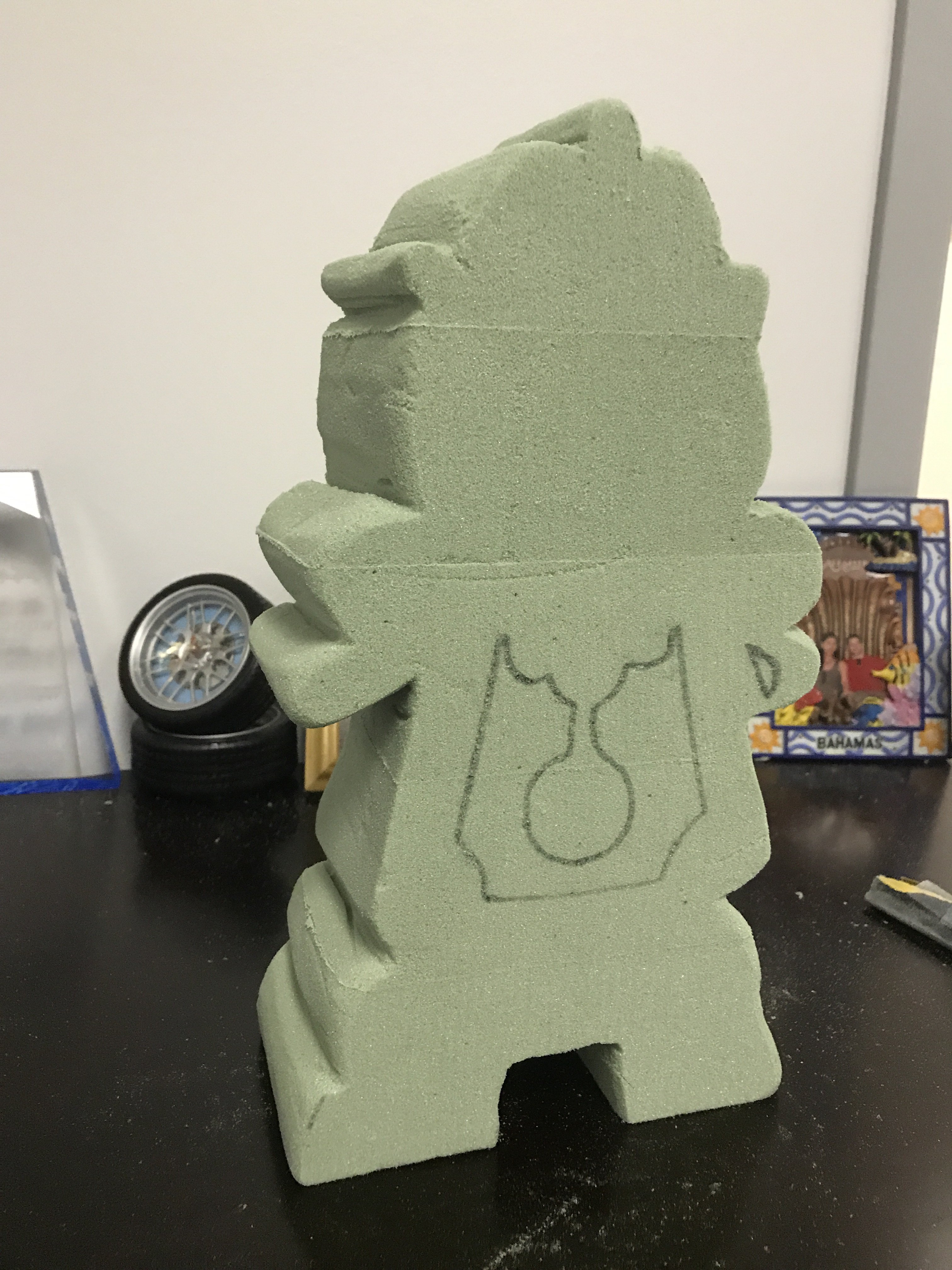

I carved something out of this stuff and want to be able to paint it to look like a wood texture. What is the right stuff to seal it with? Not sure what kind of foam it actually is other than "floral foam". I would like it to be hard and solid.
Thanks in advance and sorry if I should have started a new topic but it seemed like it make sense to ask here.

Epoxy can apparently be applied directly to polystyrene foam (closed cell).
Spyhunter2k
Old school guys designing kit car bodies used to seal plaster with latex house paint, and Bondo'ed over that. Could be used in a pinch over foam as well. My go to is epoxy resin.
GaryArm
Member
An Old School way I have used in the past is to brush a sealing layer of wood working “PVA”. This has zero reaction on the Styrofoam, this has worked on many of the job I have done in the past. Polyester Fiberglass can be layed over it with no problem. Although as Spyhunter2k has stated, epoxy resin can be applied directly to Styrofoam, and has no reaction to the foam.
