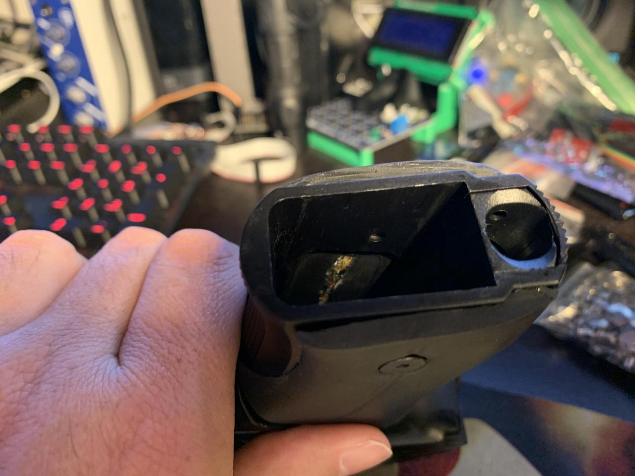

I would love to see pics of your Lawgiver. I have had mine since the original run and while it is still a very nice piece, the rubber grips on mine have shrunk over time. Curious if others have had this issue.

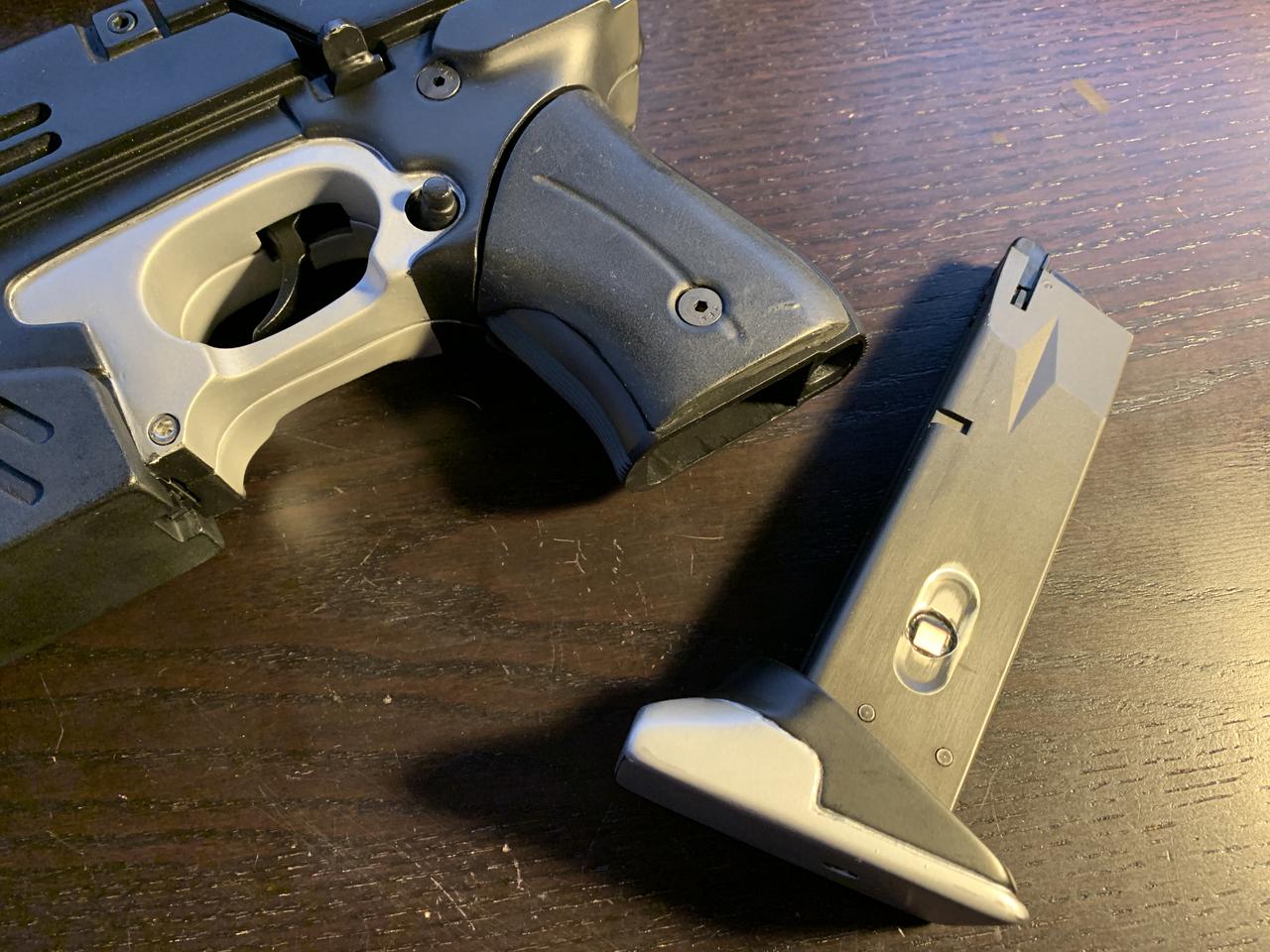

The grip has shrunk on mine too. I know someone who can cast the grips that would likely fit on this gun (need to test first to be sure), but what is tough is that with the hall effect sensor and mode switch glued into the grip (which is itself glued to the gun) it will be hard to replace without having to do a bunch of surgery. Not impossible, but probably not worth it yet.
My biggest question is around the airsoft functionality. I don't know a darned thing about airsoft so if I wanted to see the blowback stuff in action, what do I need?
Cheers!

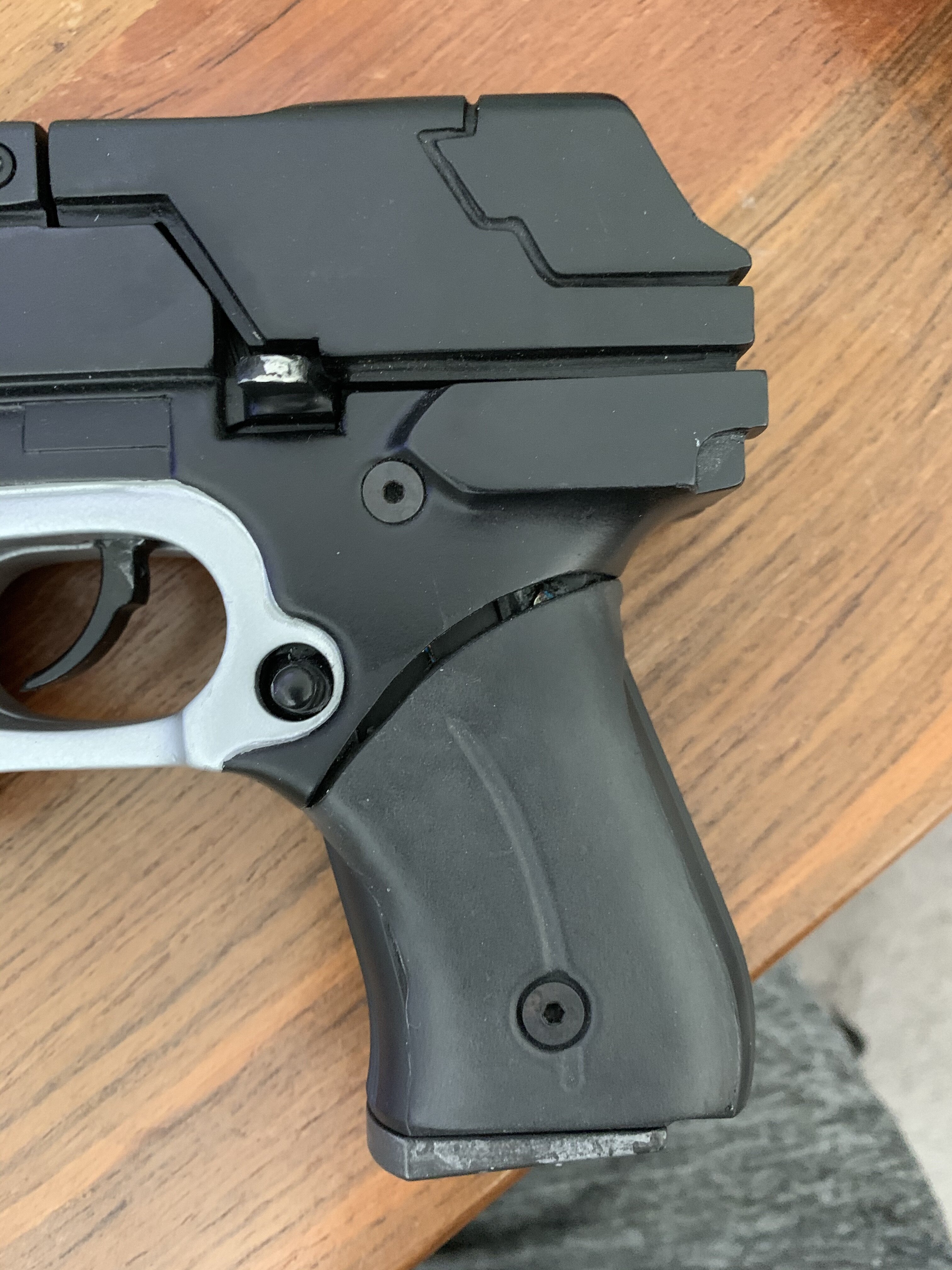

I have a SD Lawgiver that I bought fully assembled. Recently the clip insertion doesn't reset the ammo, so while the other sound and lights work, I just get "lethal rounds exhausted" when pulling the trigger. Anyone have any ideas on how to fix it? Perhaps a sensor on the clip?

The way that function works is with a hall sensor in the grip that senses the magnetic field from a small magnet in the side of the magazine. Check to make sure that magnet did not fall out. If it is still there, it could be that the hall sensor is bad, misaligned or a wire got pulled out. As for fixing it, unfortunately I can't offer any further advice because I do not know what specific components were used in the construction nor have I disassembled mine.
Also, I had difficulty getting the hall sensor to work on mine from day 1. I'm not sure if it was an alignment issue or if the sensor was too far away or if I just wasn't able to compress the grip enough for it to work.

Yes, you were right - the shrinkage of the grip had moved the sensor (which is glued into the grip) away so it wasn't making contact. I removed the grip and got it functioning again, but the wires were deeply glued into the rubber of the grip and they broke after a while. So now I'm looking at sculpting new grips and I have to resolder the sensor to the wires. However there isn't enough wire and I don't know when wire goes to which terminal (or does it matter?).
