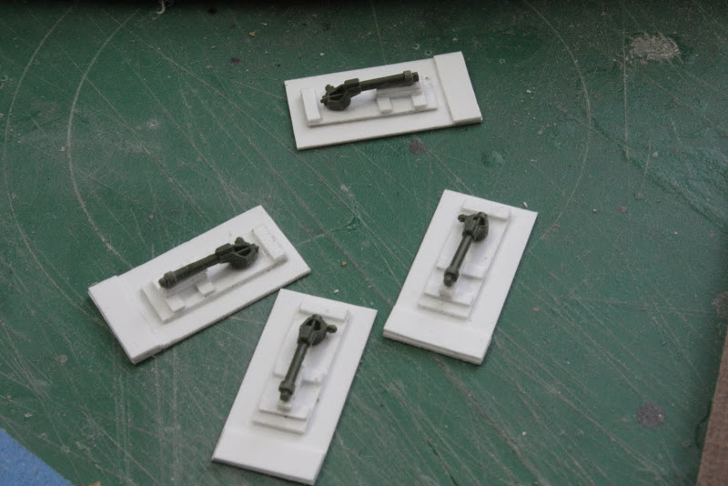

Started to add some external winglet details on the outer flaps

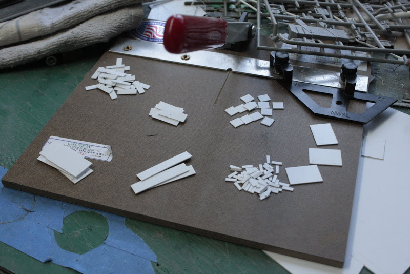

Finished the skinning on the front of the wings with 1mm styrene sheet, the rest of the wing is skinned with 1/2mm sheet.

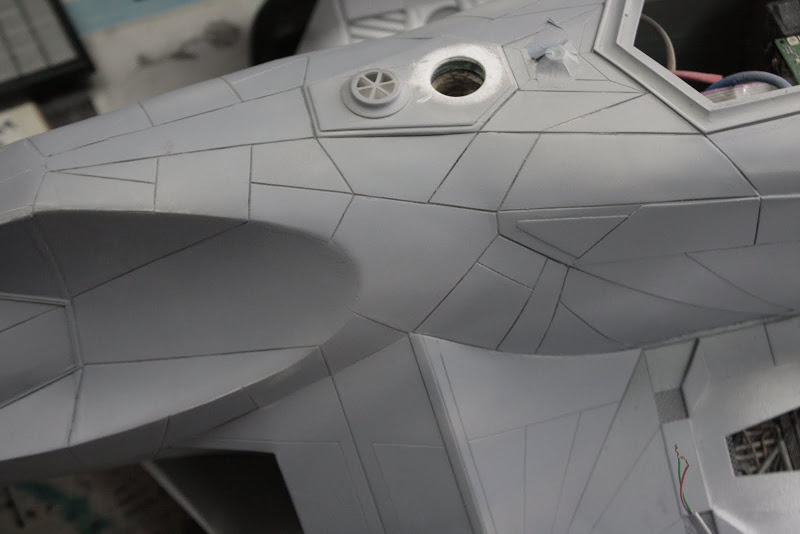

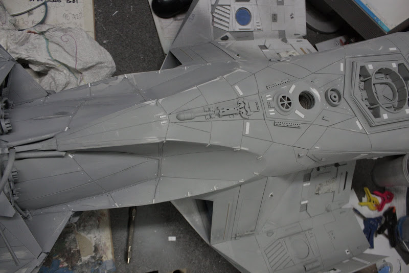

I've been slowly plodding away this week and have been figuring out how to blend the engine fairings into the wings and final small details on the underside of the wings and the body.​

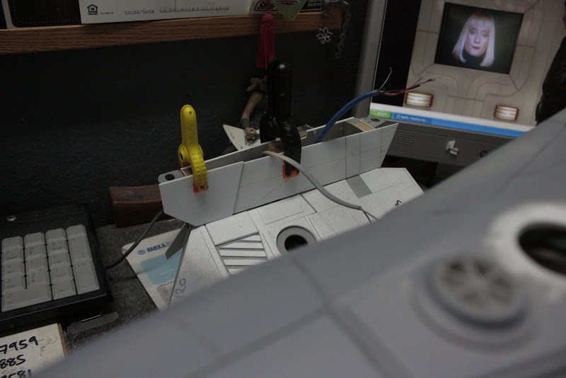

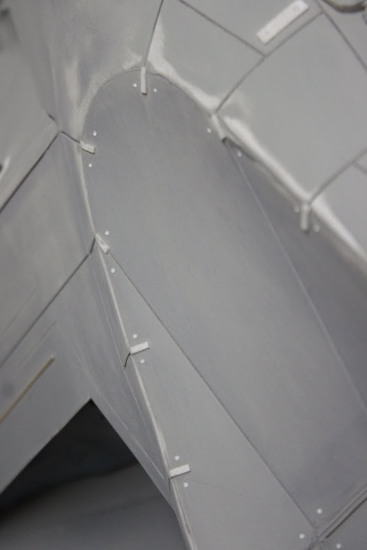

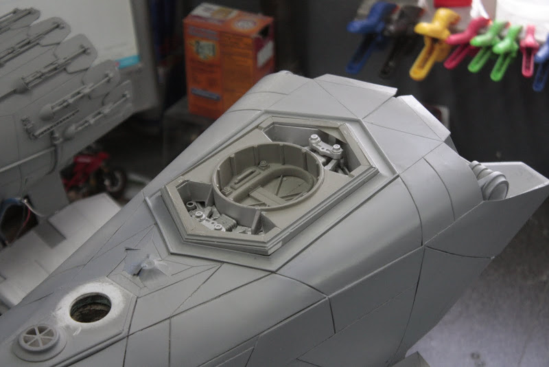

I first covered up the inner wing walls. This is just a straight 1mm styrene skin with engraved panel lines.​
Worked on the shield and cloking generators​
Quick dusting of primmmmmmmmmmmmmmer​

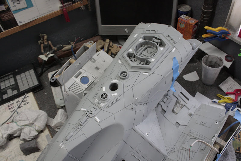

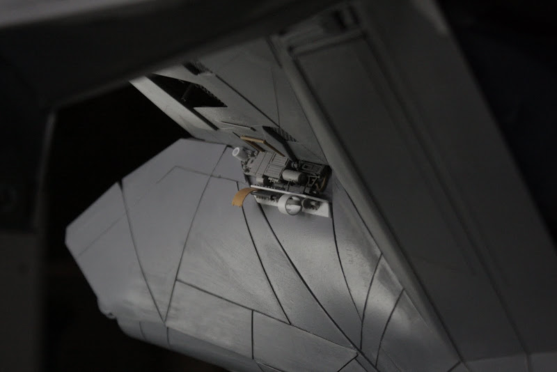

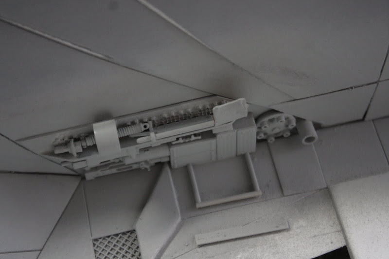

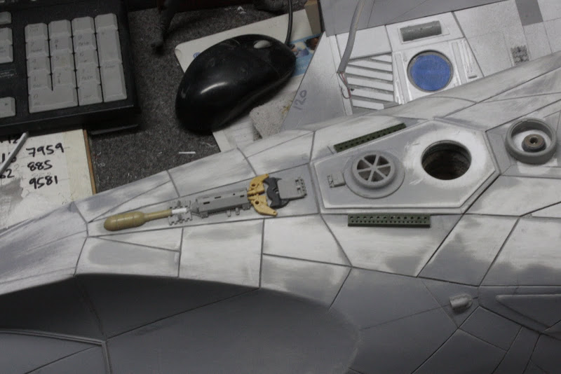

Then i just added small bits of detail on the underside.​
Here's what i started with.​
Here's the build up of detail.​

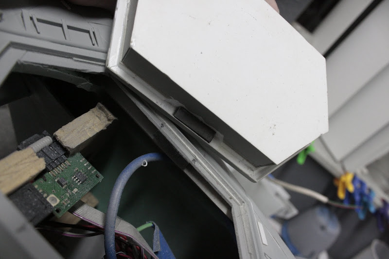

I also put some magnets on the insides of the airlock​

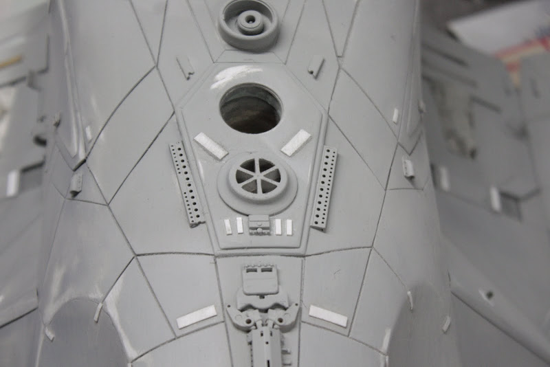

Added detail on the understide 'inverted scoops'​

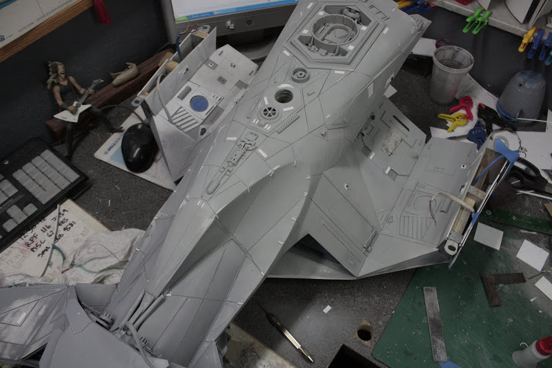

Story so far.​
Next i think i gotta start detailing the wing tops​
Take care​
