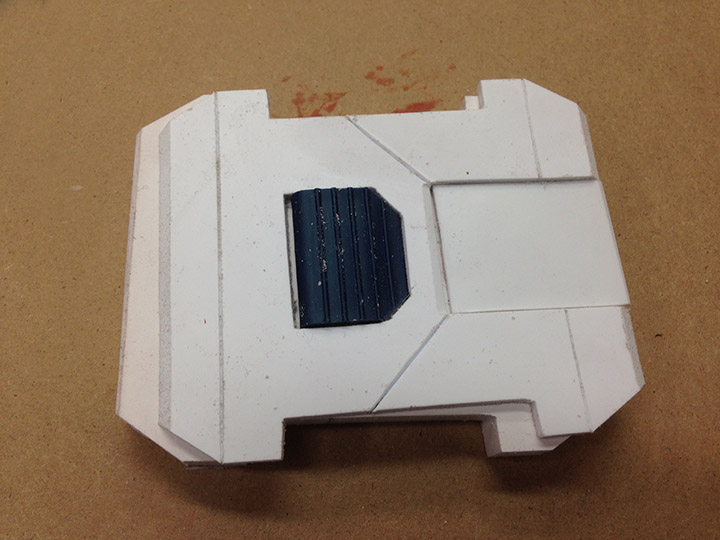

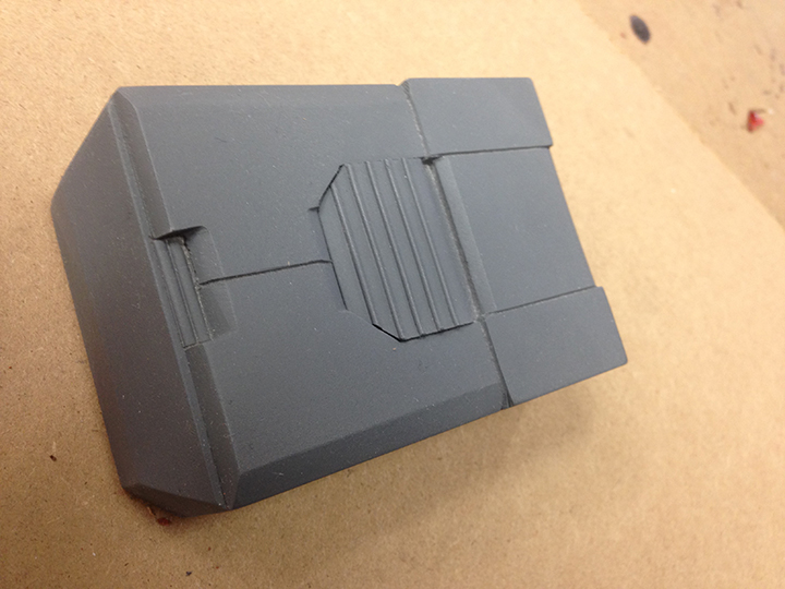

Here's the start. I built the first compartment today from styrene. The finished belt with have several of these. This one will be molded and cast to create the multiples I'll need. It will be solid resin and non-functional. For the design I really just started building and let the design emerge. I'm pretty pleased with what I arrived at.

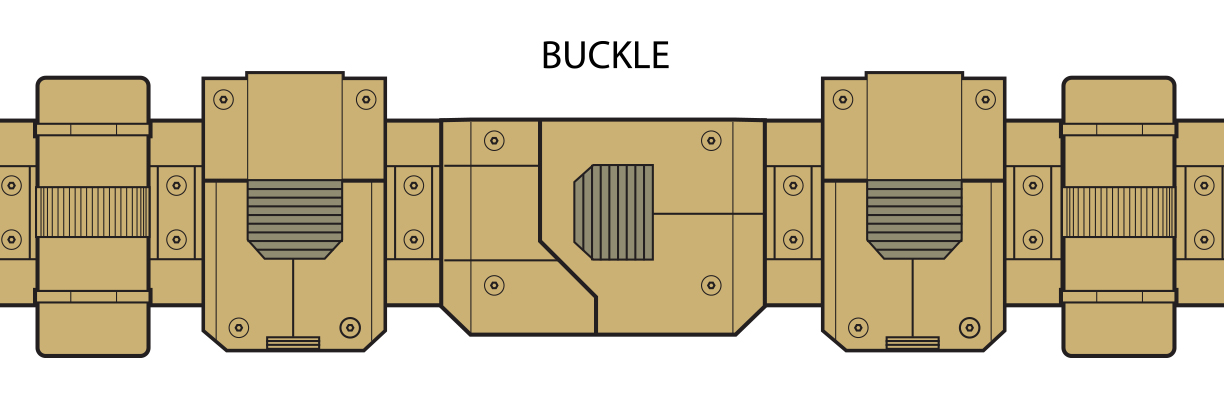

Thanks! So I drew up the design so far in Adobe Illustrator to figure out a buckle design. This is a bit inspired by the Arkham City. Might try a few more things before I build it.

I really like the buckle in the top one in post #4. I love the compartment and cylinder. I think this is going to be an awesome belt!!

Yup, pretty set on that buckle. I'll try to knock it out tomorrow. For now, let's obsess about something else. I printed out a full belt mockup to gauge how many of the compartments I'll need. I noticed that with the spacers in between each compartment, you really only get 4 compartments on the belt and really only see a coupe from a front view. If I remove the spacers and butt the compartments up next to each other you get a more FULL looking belt. Honestly, that's something that bugged me about the Dark Knight/Begins belt. There were only a few compartments on the belt. I gotta decide which way I want to go with this.

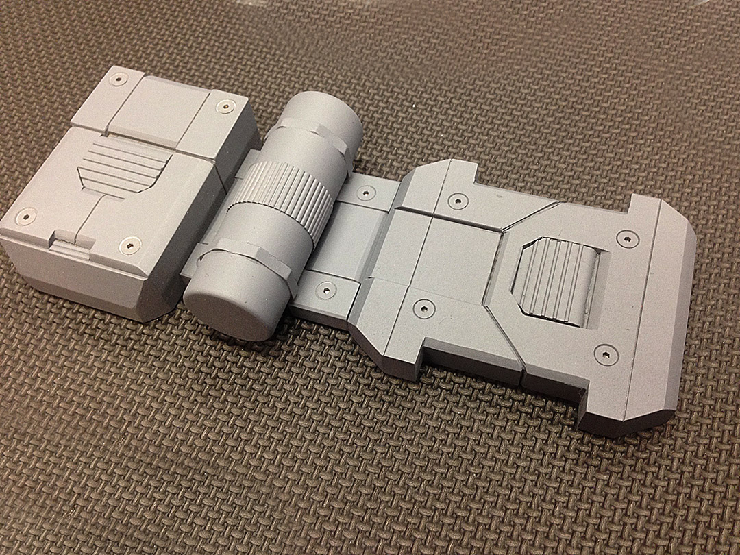

Spent today building out buckle I designed out of sheet styrene and Sintra. The scale feels about right.
I also found a solution for the "too much space in between the compartments" issue: Thinner spacers :) ... I'll still use the wider one on each side of the buckle to give it some variety.
So here's the base components that will comprise the majority of my belt. I'll be casting multiples of several of these pieces.

Molding the three main components using Smooth-on Oomoo :)

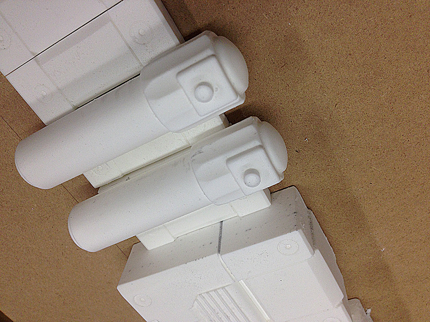

Casting Day!

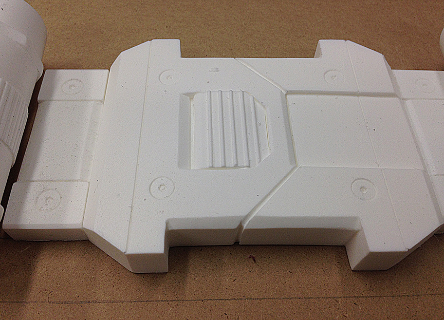

I pulled casts of all the parts necessary for my finished belt using Smoothcast 300. The molds did well.
The bright white parts don't photograph very well, but this gives an idea of the finished belt. I also created a new component, a thinner capsule. A gas canister perhaps.
More soon.

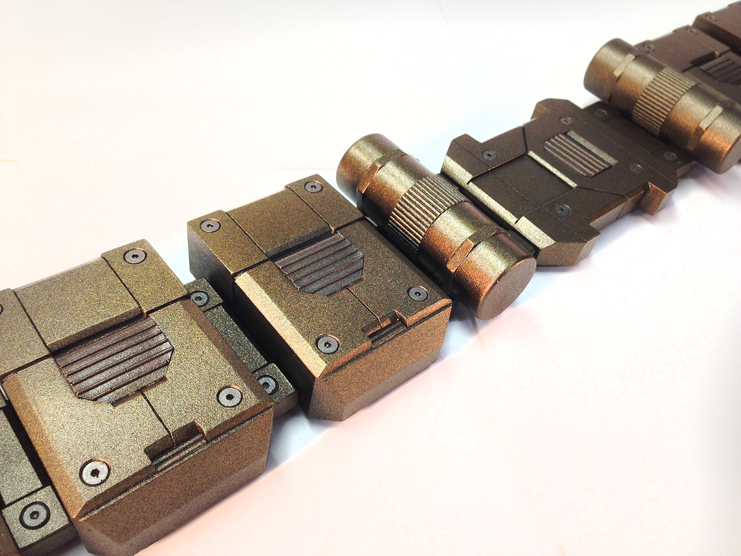

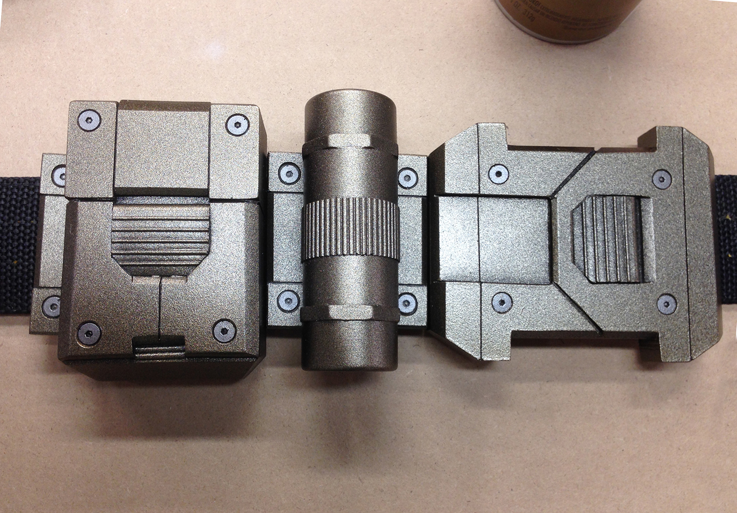

Paint test. I tried a number of gold metallics. I wanted something dark and not too glossy. And something I can apply light enough to not obscure details. The answer was this great Rustoleum Satin Metallic Classic Bronze. I also hit the screws with an aluminum silver for a little interest.
I also found a great tool belt at Menards. It's heavy duty webbing and a buckle that looks like it was designed to go with my belt. This will be the underbelt everything will attach to.

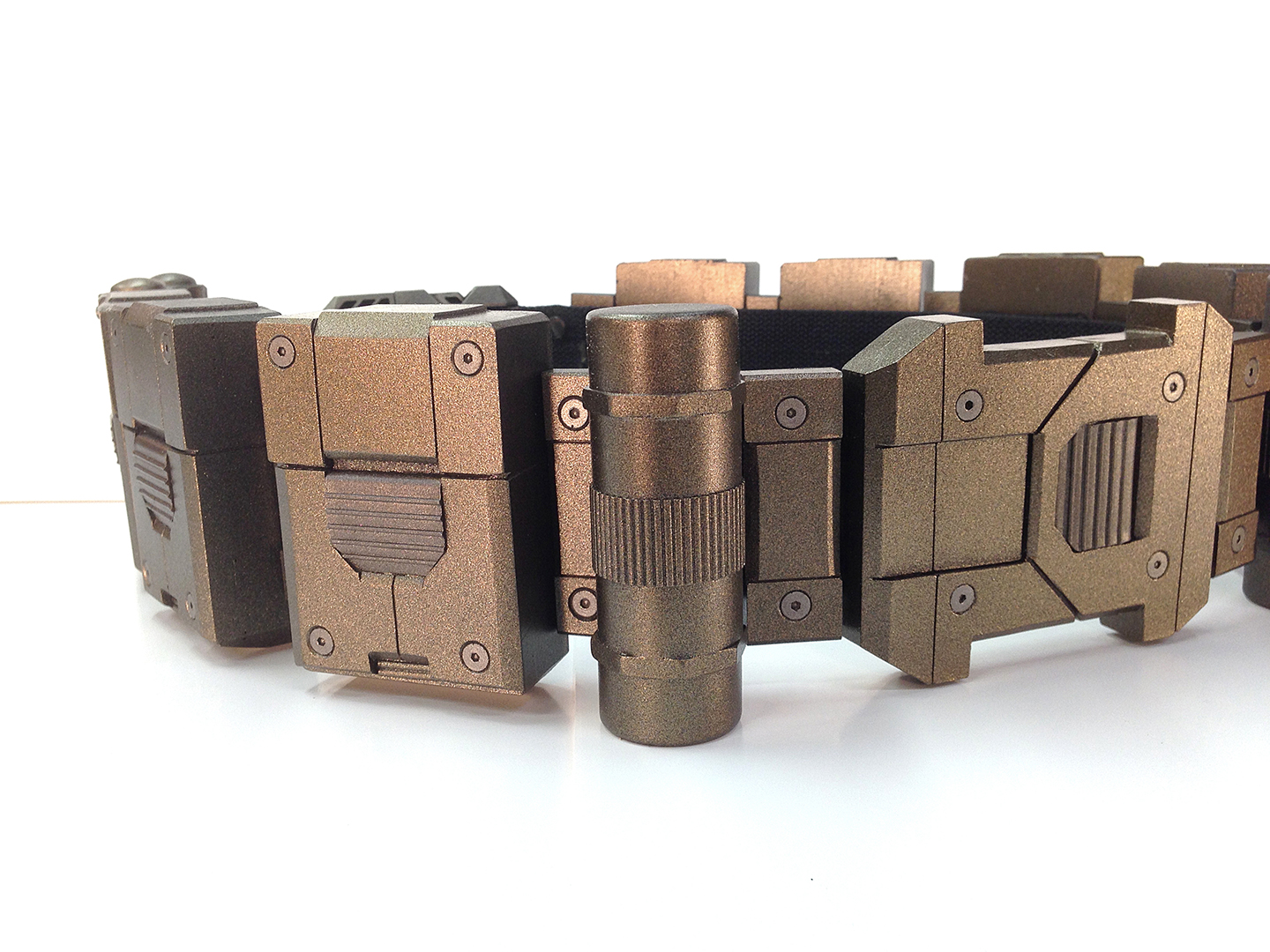

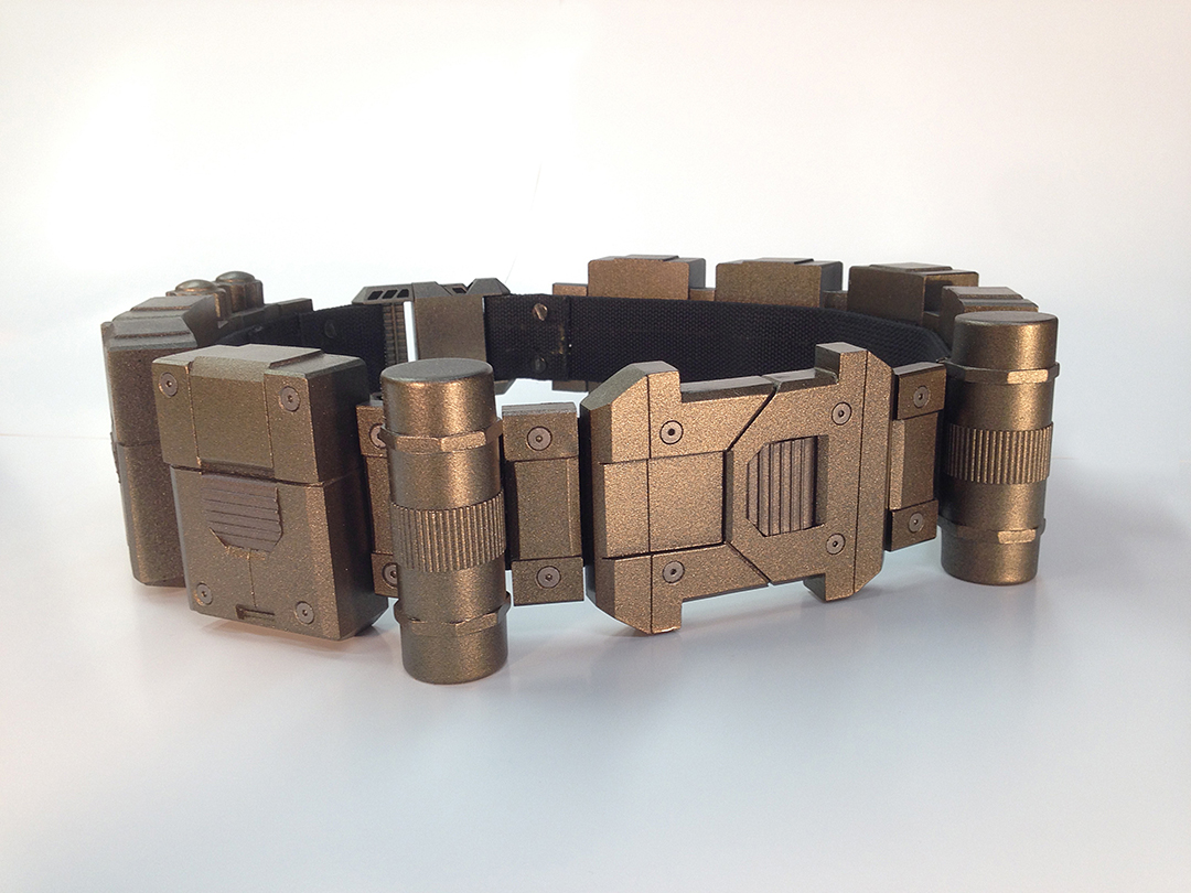

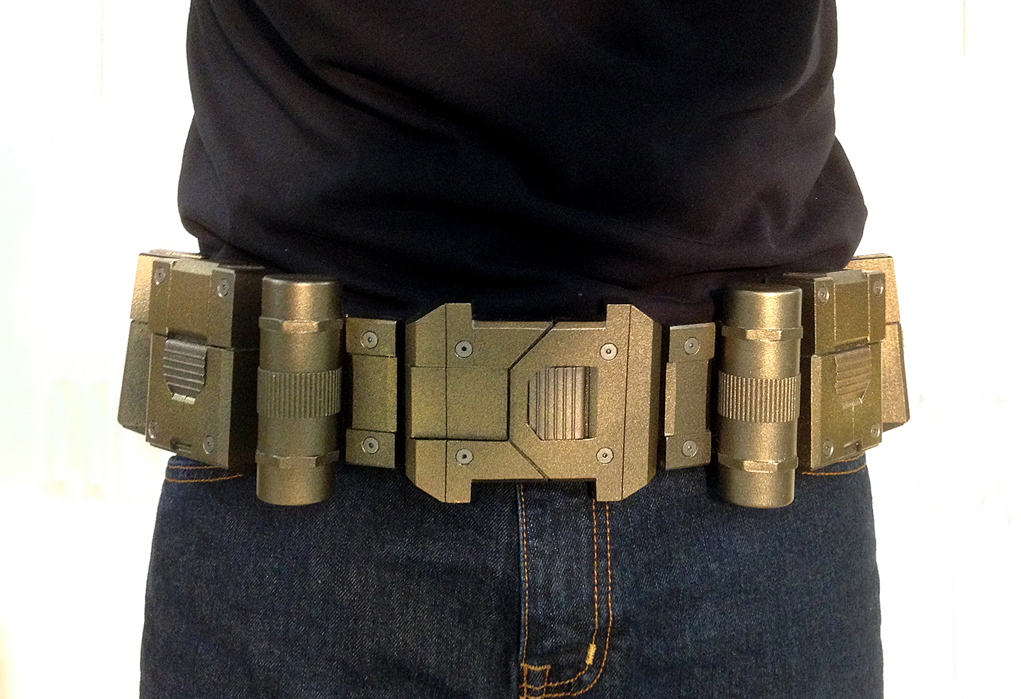

Finished! I used JB Kwik Weld to attach the belt parts to the underbelt. Everything seems to be holding strong. I may use some small screws in the back if pieces start loosening up. But she's really SOLID.
I was worried about weight. Turns out it's not that heavy. It's actually quite comfortable to wear. I forget I have it on sometimes:).
Fantasy. Fulfilled.
