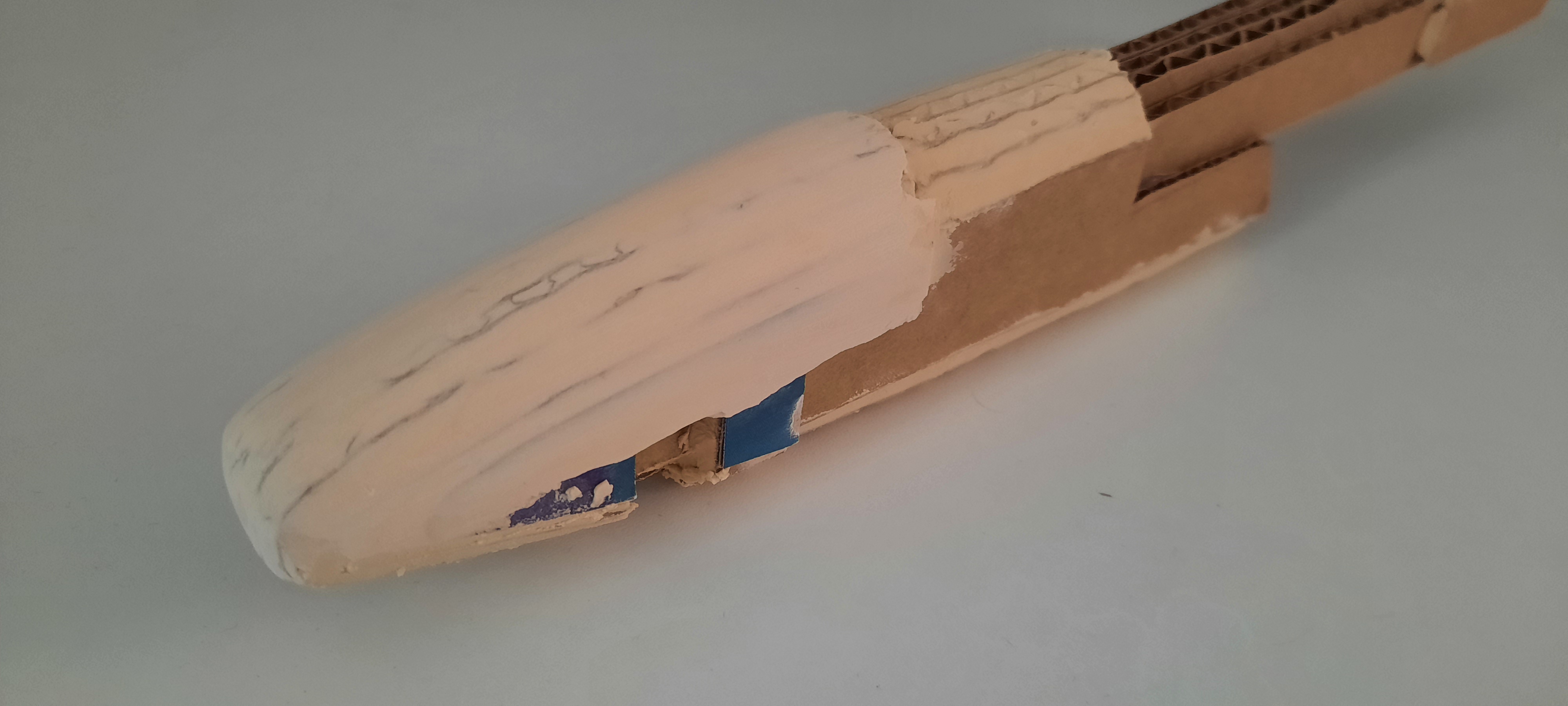

I definitely recommend Ronseal multi-purpose white wood filler. But if it did this again, I would use that for all the filling, and not hot glue to block up the corrugation in the card. It's a pain to sand which means it makes getting a smooth surface against the wood filler more tricky as it's two different materials that sand at different rates. I sanded the wood filler with a 120 grit.
The plastic filler primer is very nice - and once sanded with 800 grit leaves an almost plastic smooth finish to the surface.

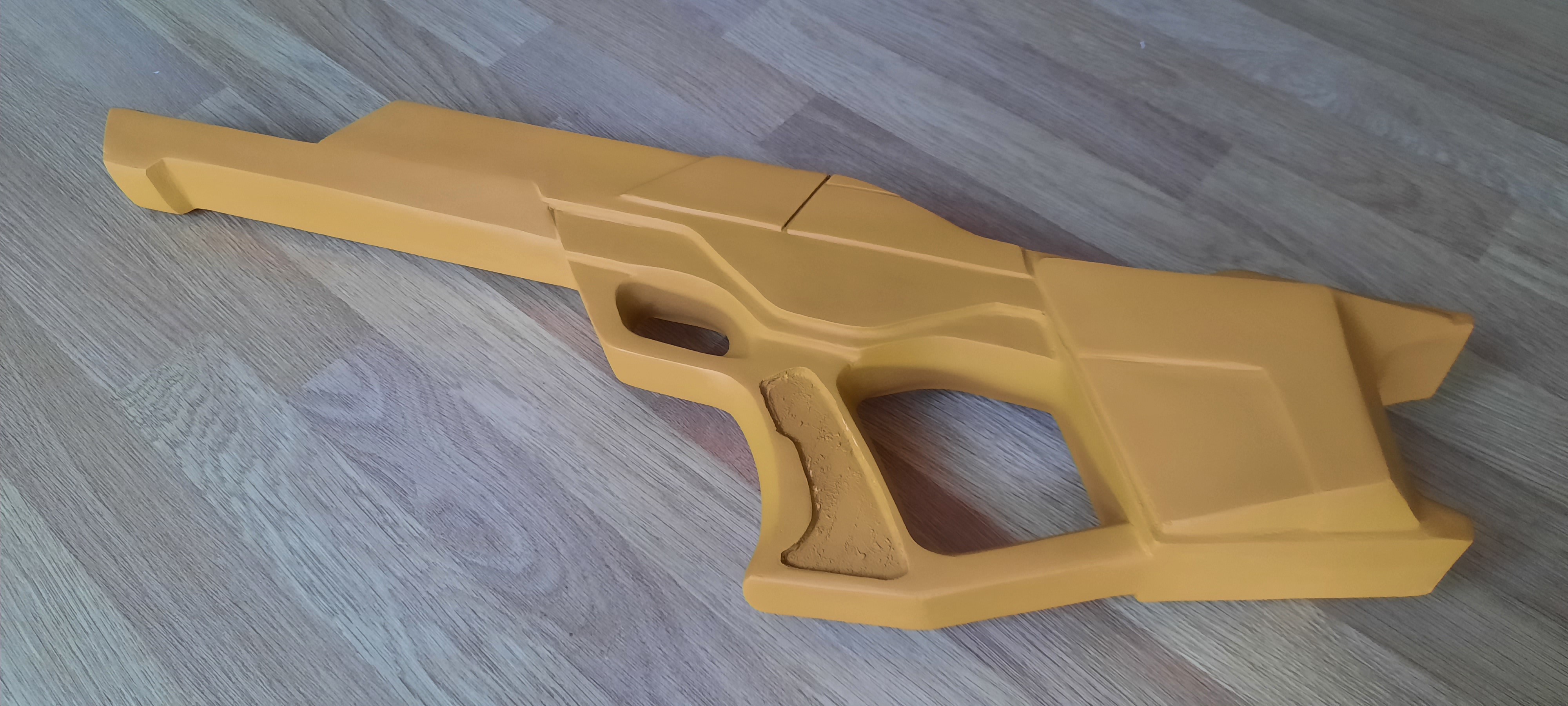

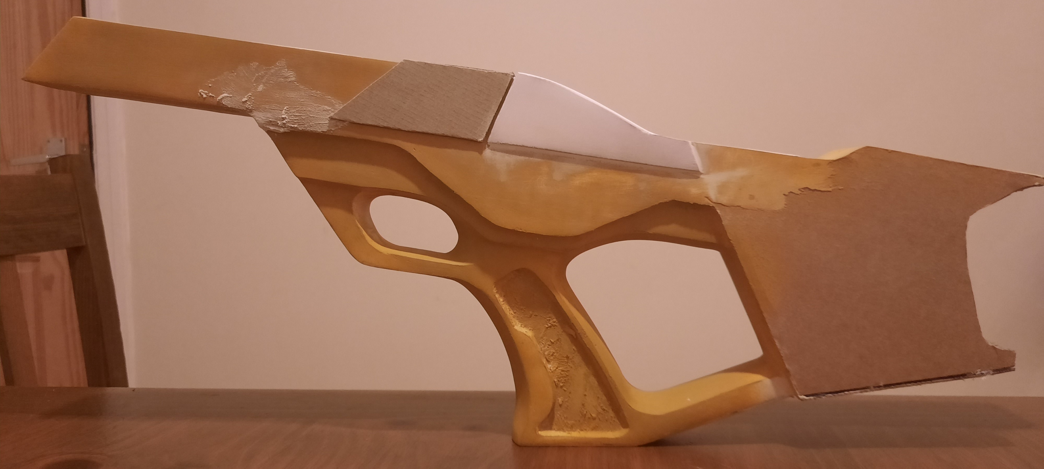

Dreamscape
Small update - I've now covered most of the surface in woodfiller, and sanded it back. I've added some detailed panels too. Really happy with the curved surfaces. Now weighs over half a kilogram.

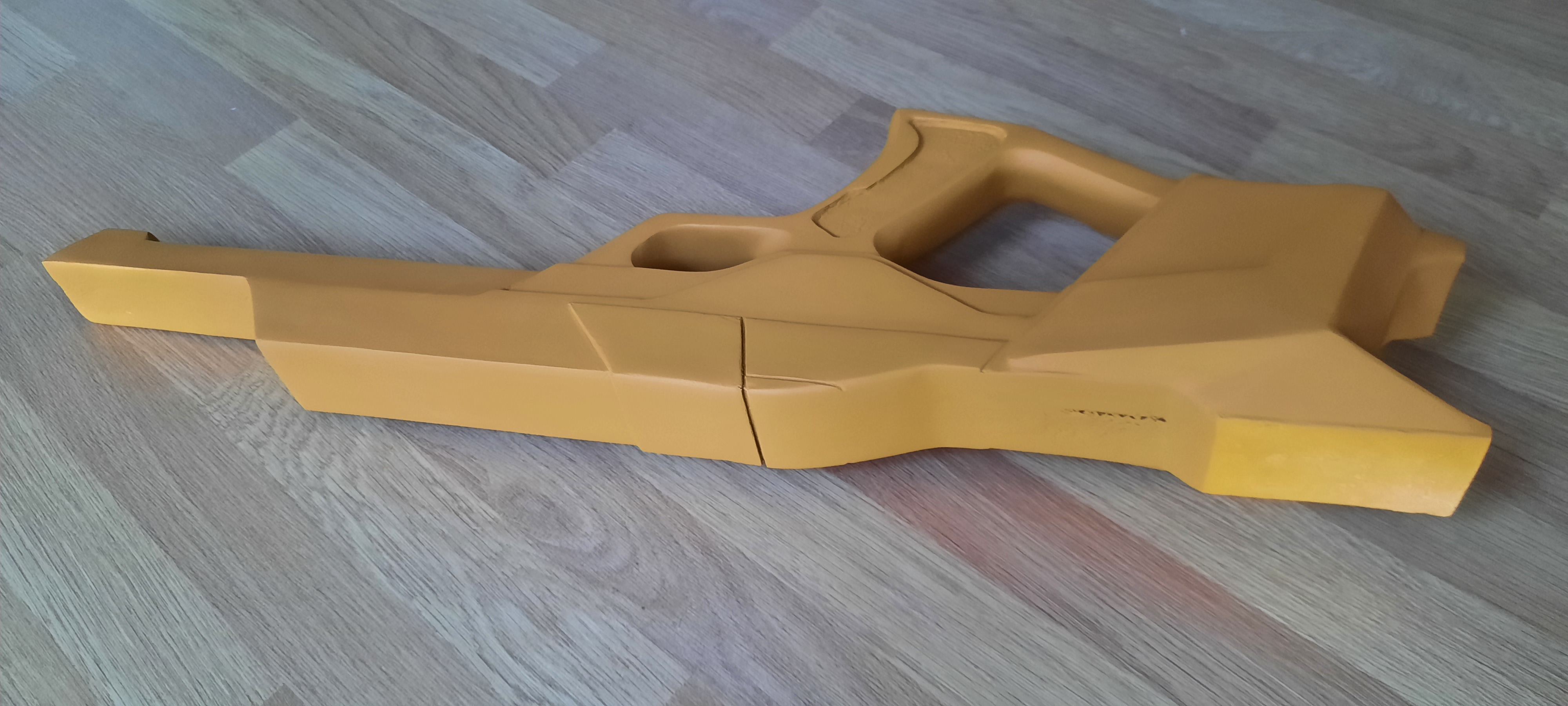

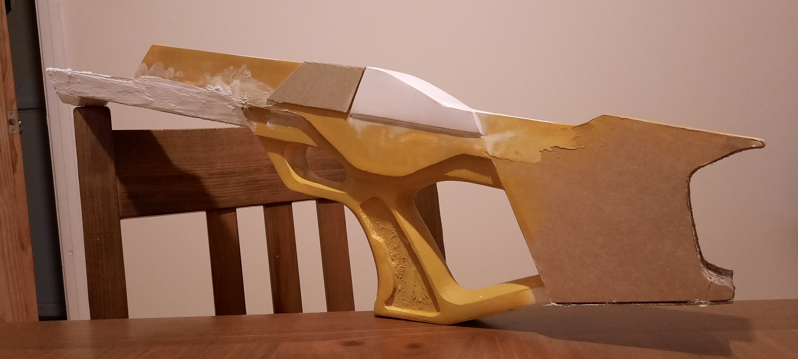

Dreamscape
Added the first extra piece to the base unit - and covered it in filler. Looks a mess but should come up nicely. I really should add the sides to the rifle's stock.
FYI - it can't balance on the handle anymore :p

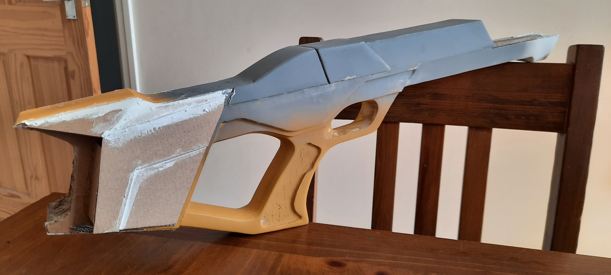

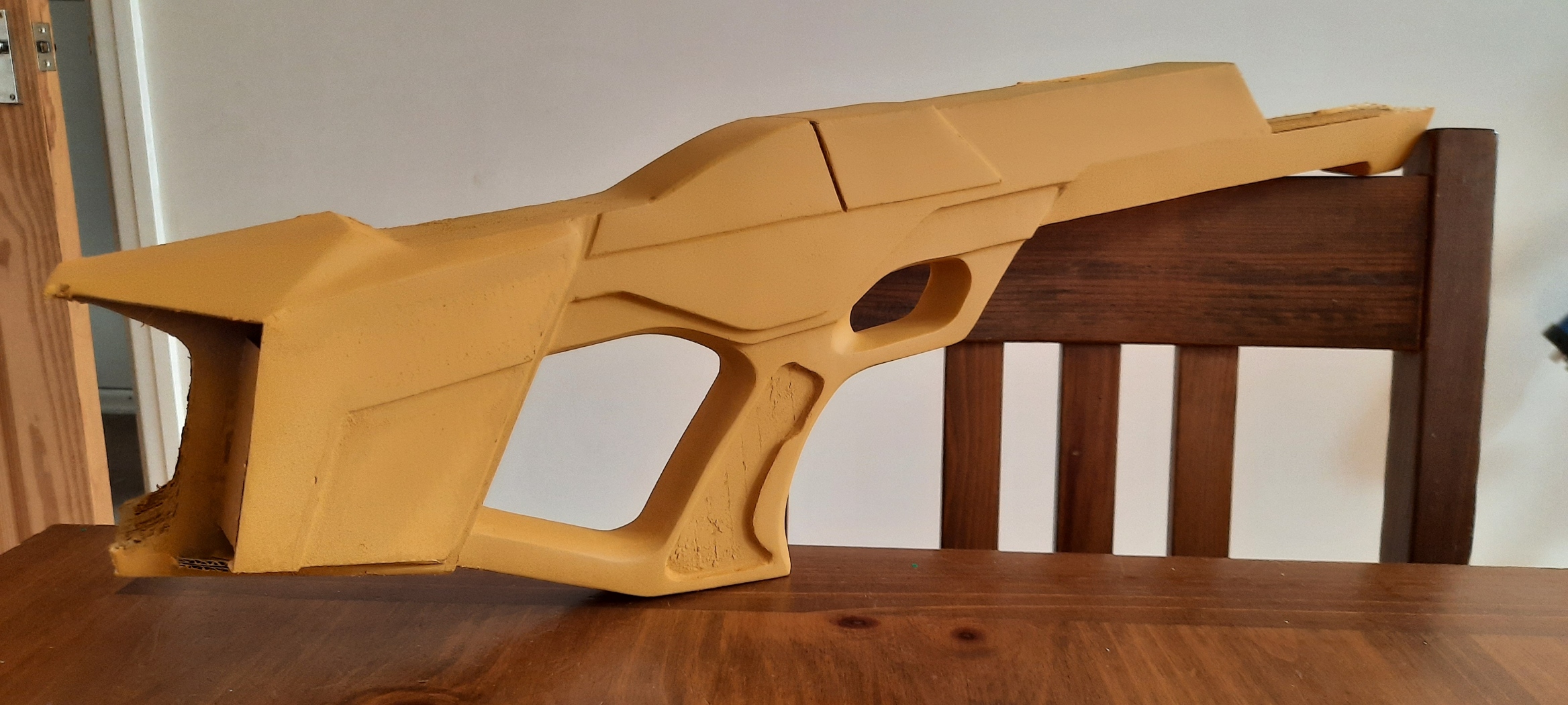

Dreamscape
Sanded the main rough bits out. Ran out of plastic filler primer so resorted to some standard grey car primer to highlight scratches and nicks. That ran out too.
Still a lot of edges need sharpened up, and lumps/bumps to be filled/sanded.
But I'm really happy with the results so far. Unsurprisingly it weighs 650g and feels like a piece of wood. Guess that's to be expected as its half solid wood filler!

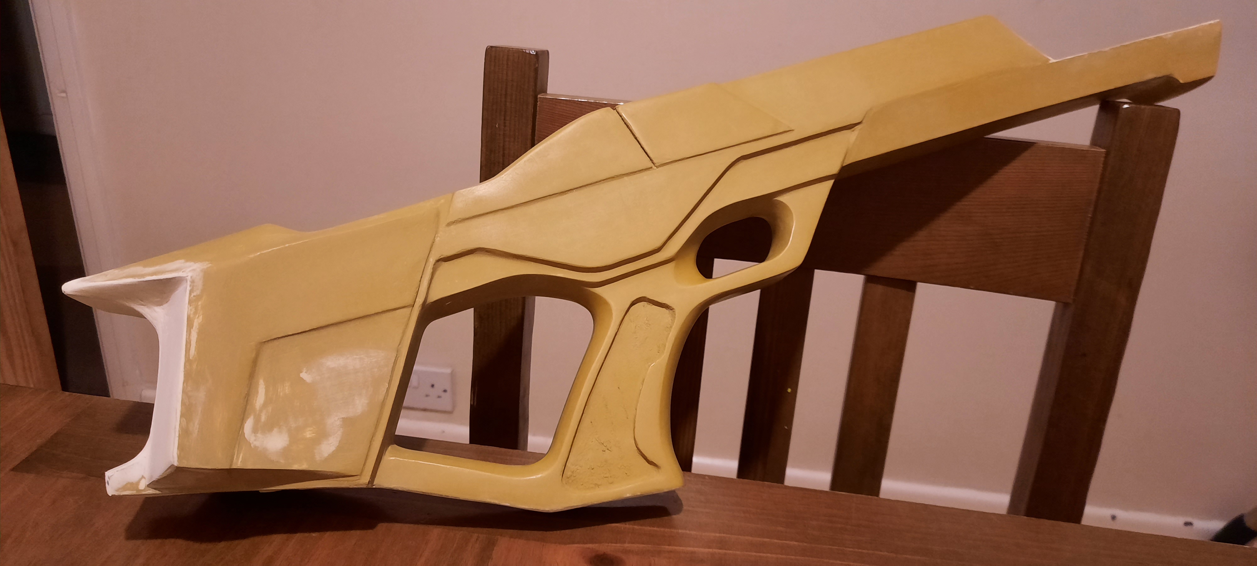

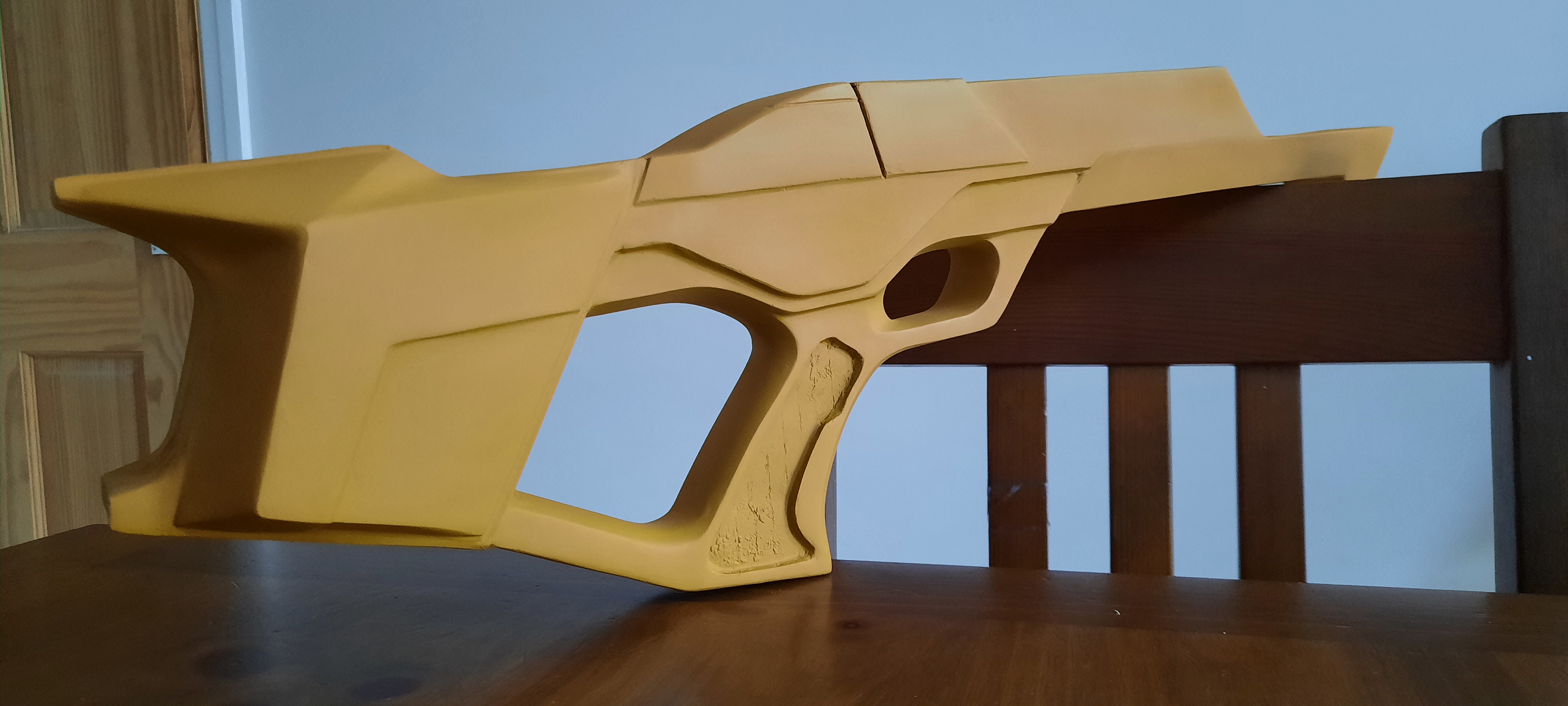

Dreamscape
Finally got the stock filled in. Got some more sanding and layers to do on it before respraying.
But some areas like the handle are now so smooth they look and shine like plastic.
I'll be starting on the barrell next. Although I may create the stock shoulder pad and chin rest (those will be covered in black foam.

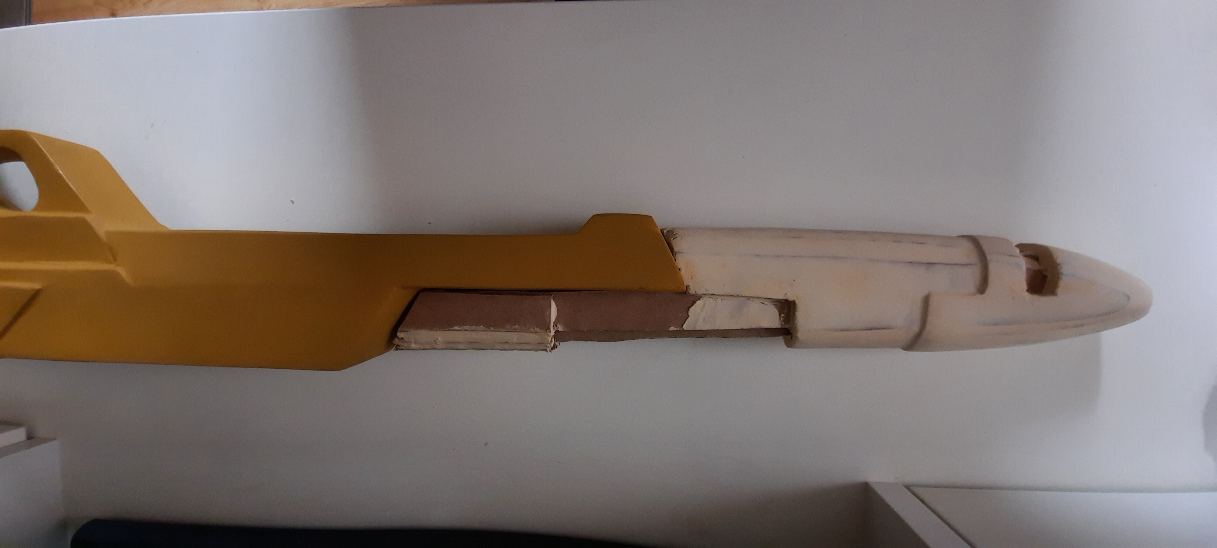

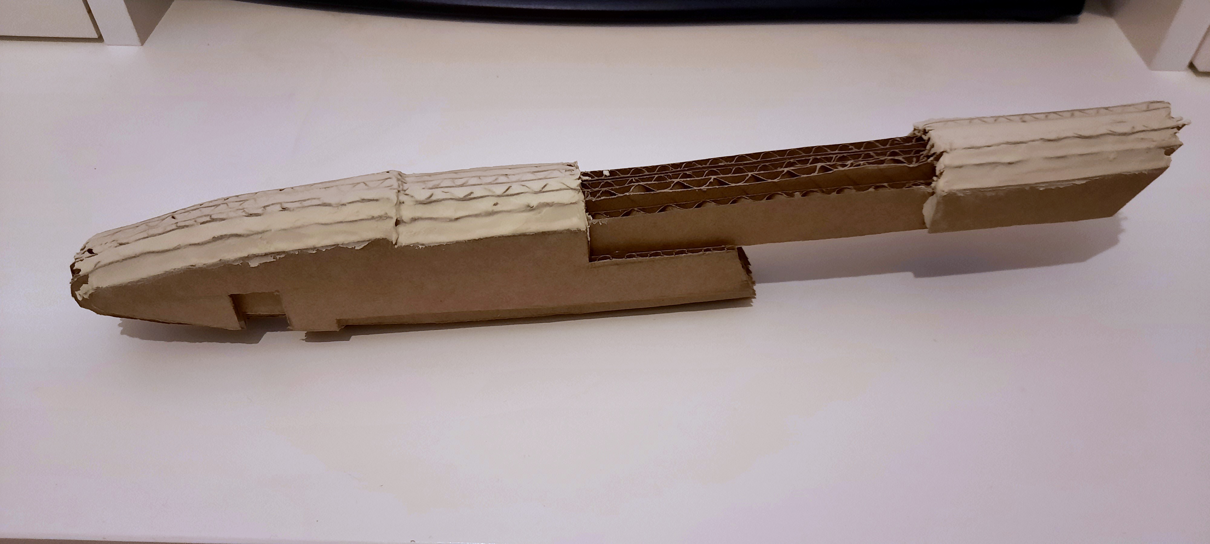

Dreamscape
Now started on the barrel. Base layers of card done, and started to build up the wood filler. Havent quite decided how I'm going to do the bumps on the top, possibly foam strips or hot glue with filler over the top.
I won't attach this to the base until I'm happy that I've got the right shape.

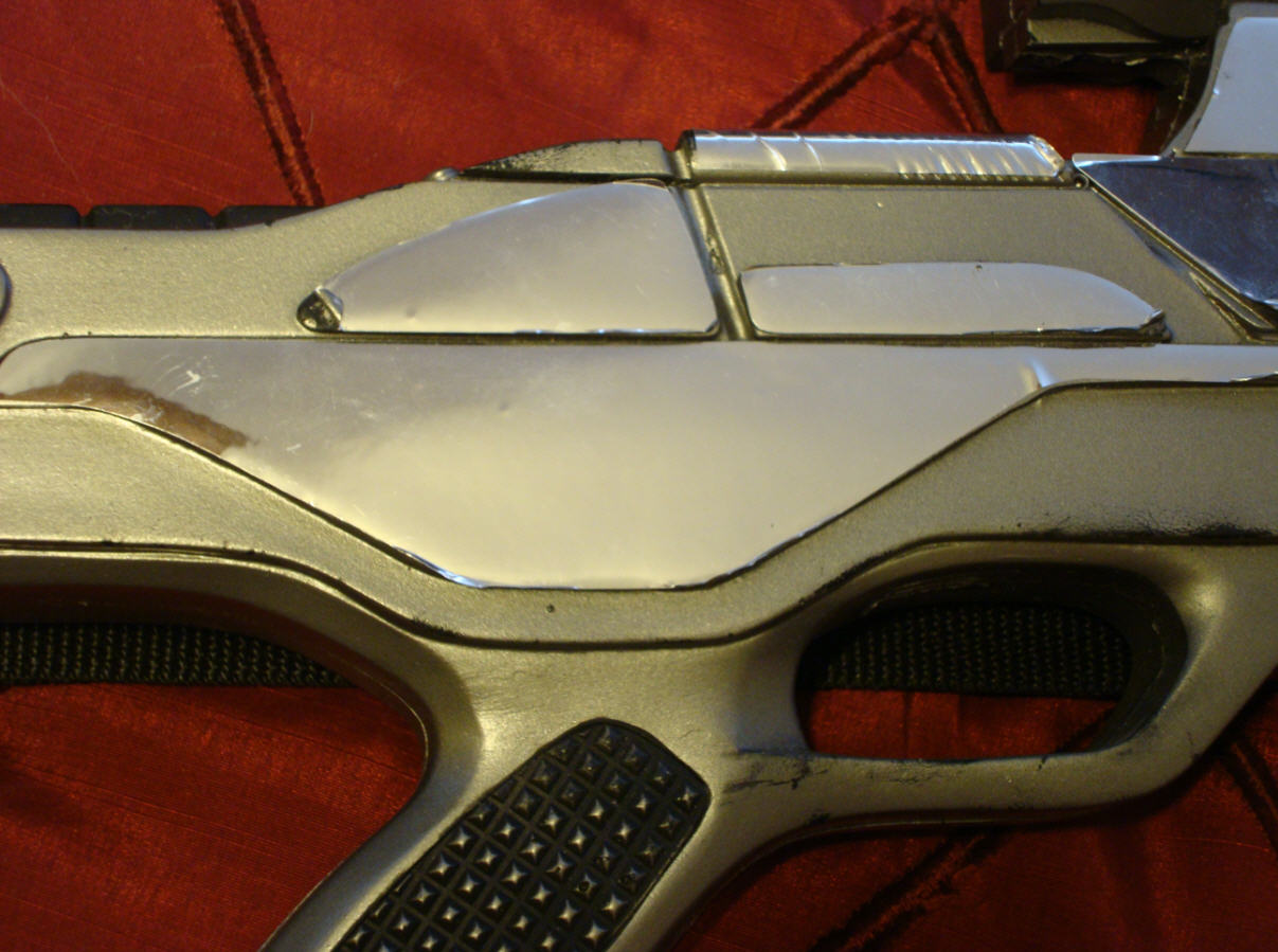

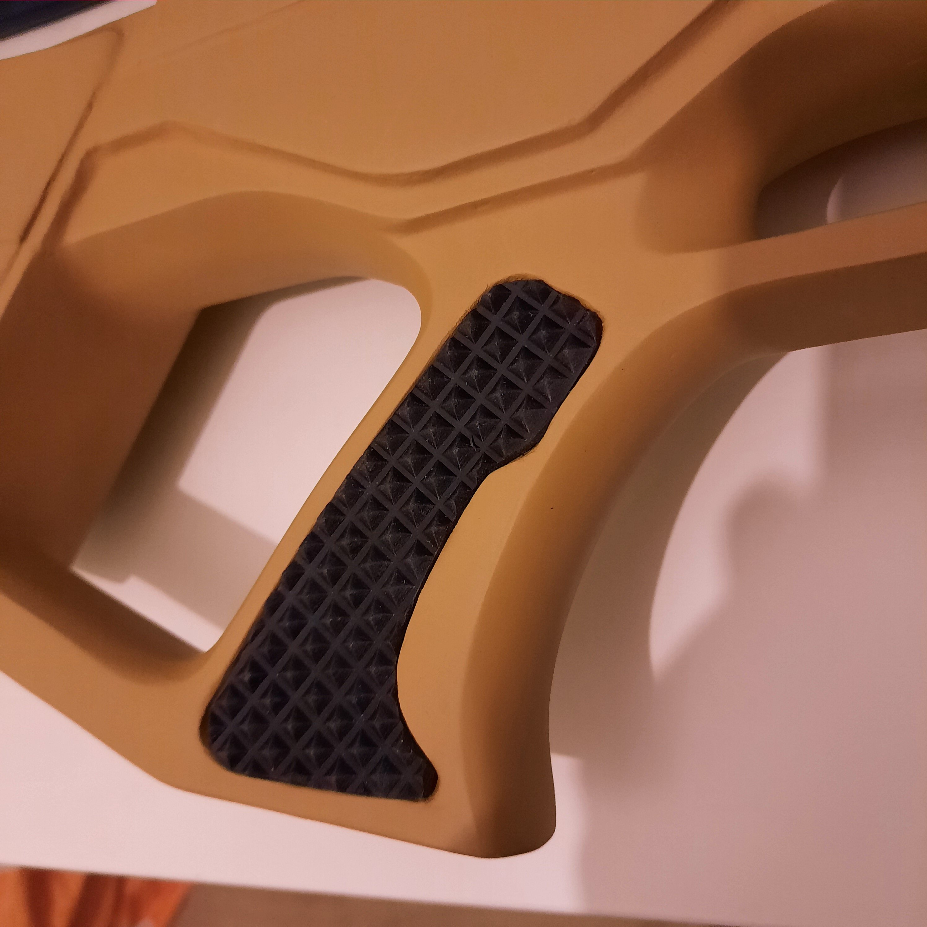

Dreamscape
While I wait for this to dry - quick question...
Can anyone help me ID the black material used for the stock and hand grips? I'm thinking it might be rubber matting of some sort:
