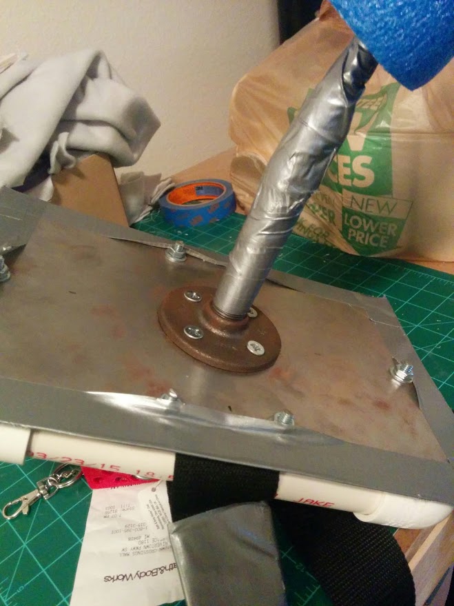

This little beauty is copper tubing you can find for plumbing, I took aluminium wire and stuffed it through until I couldn't fit any more. The typical arm recieved 3-4 lengths, quite the endeavor I assure you. This was mounted into an appropriately sized Nipple and Flange setup. To solidify it I basically just filled the pipe with JB Weld and Stuffed the pipe down in there. Once it hardened the arm wasn't going anywhere
My original Ock backpack was made by buying an Alice Pack, drilling a few holes in it and attach a piece of sheet metal. Wood may have sufficed, I just prefered metal as it was the slimmer medium and weight was about even between the two. The issue with that pack being that it was far bigger and bulkier than I cared for, and was capable of working or shaping at the time. This time around I decided to build my own pack

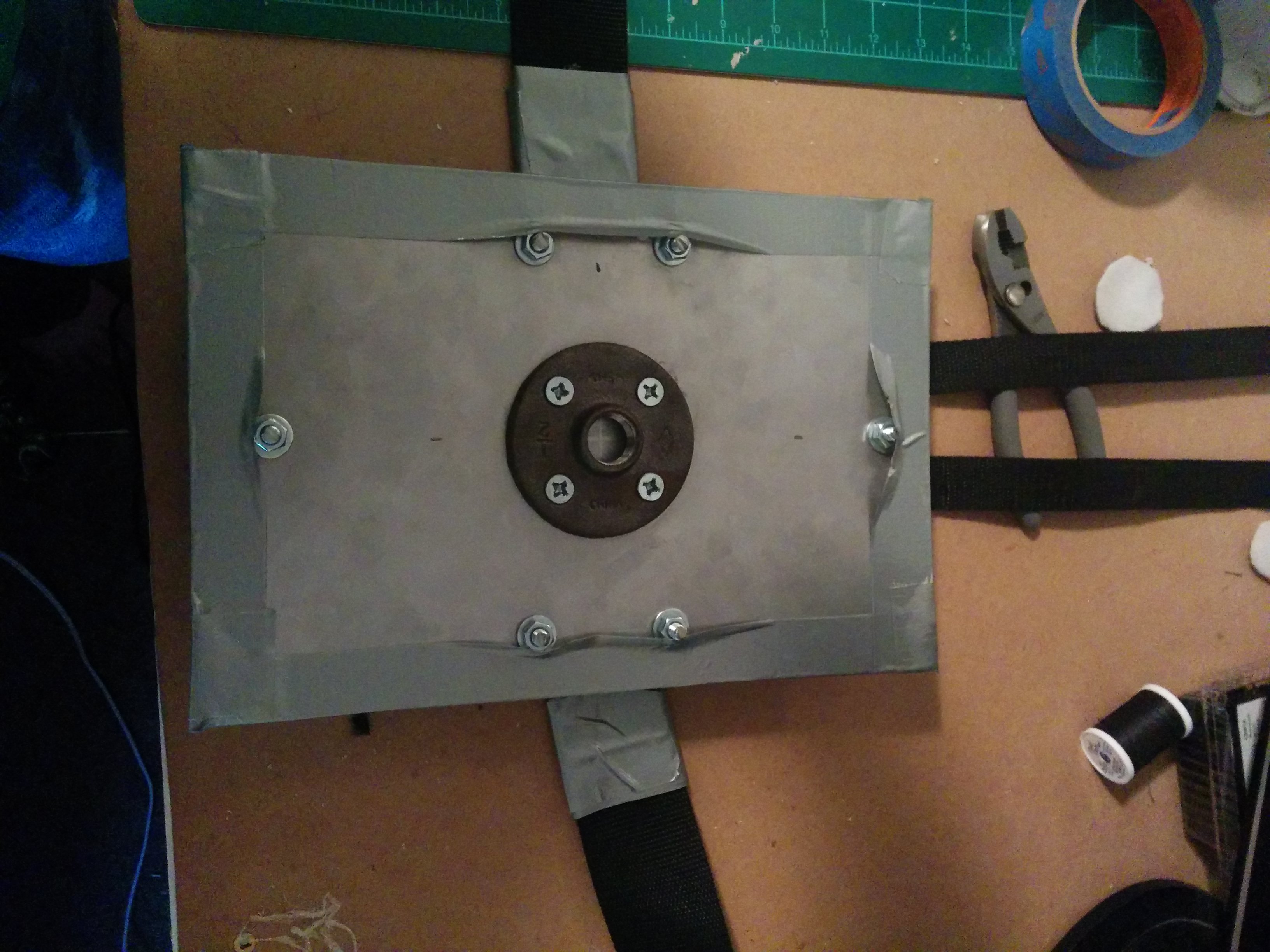

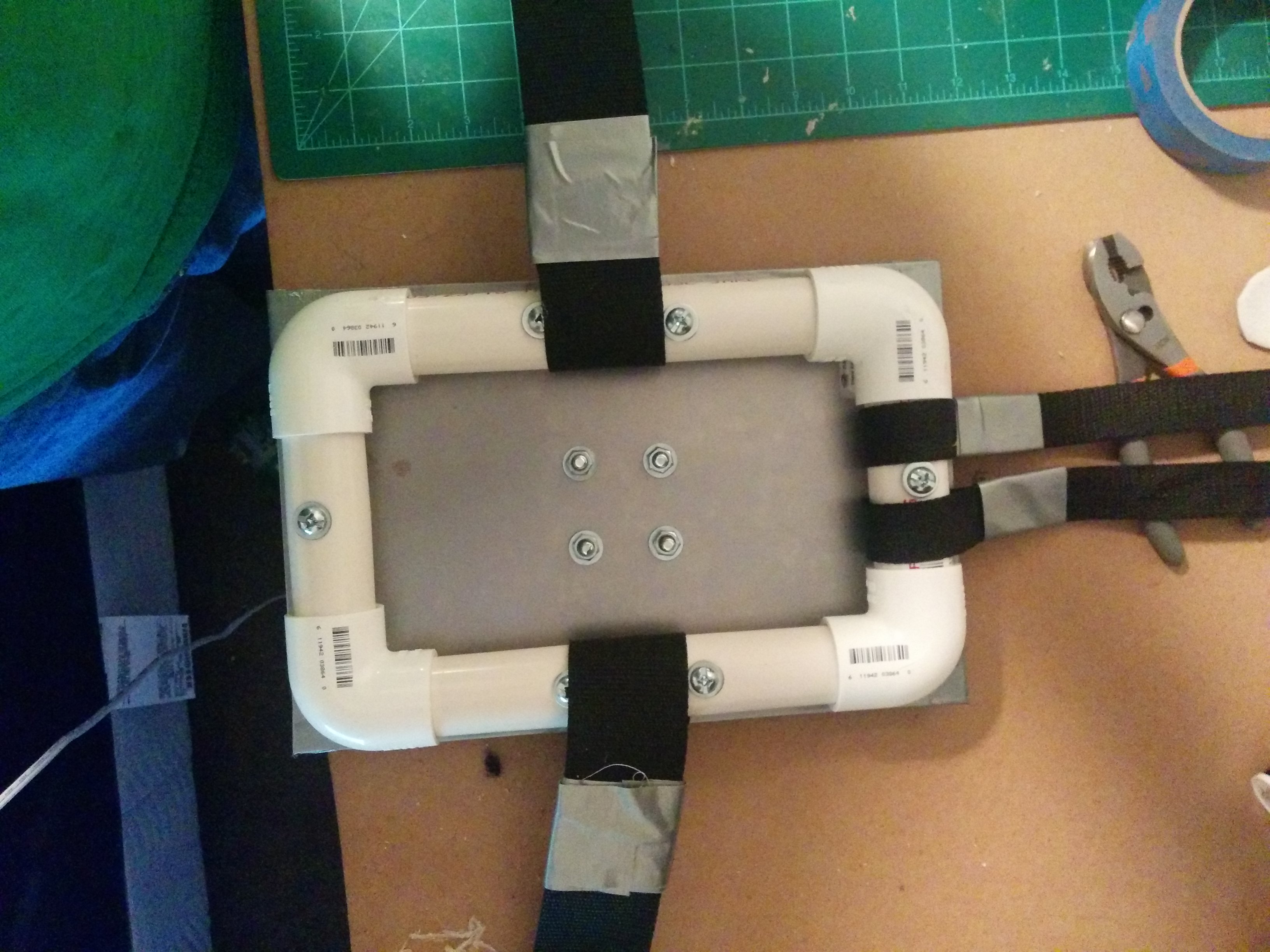

I setup a little 8"x12" pvc pipe rectangle and attached it to a similarly sized piece of sheet metal, placing the flange in the center. This makes for a moderately slim support bracket that should be able to comfortably sit on my back with the right padding and fairly easy to hide under a costume.

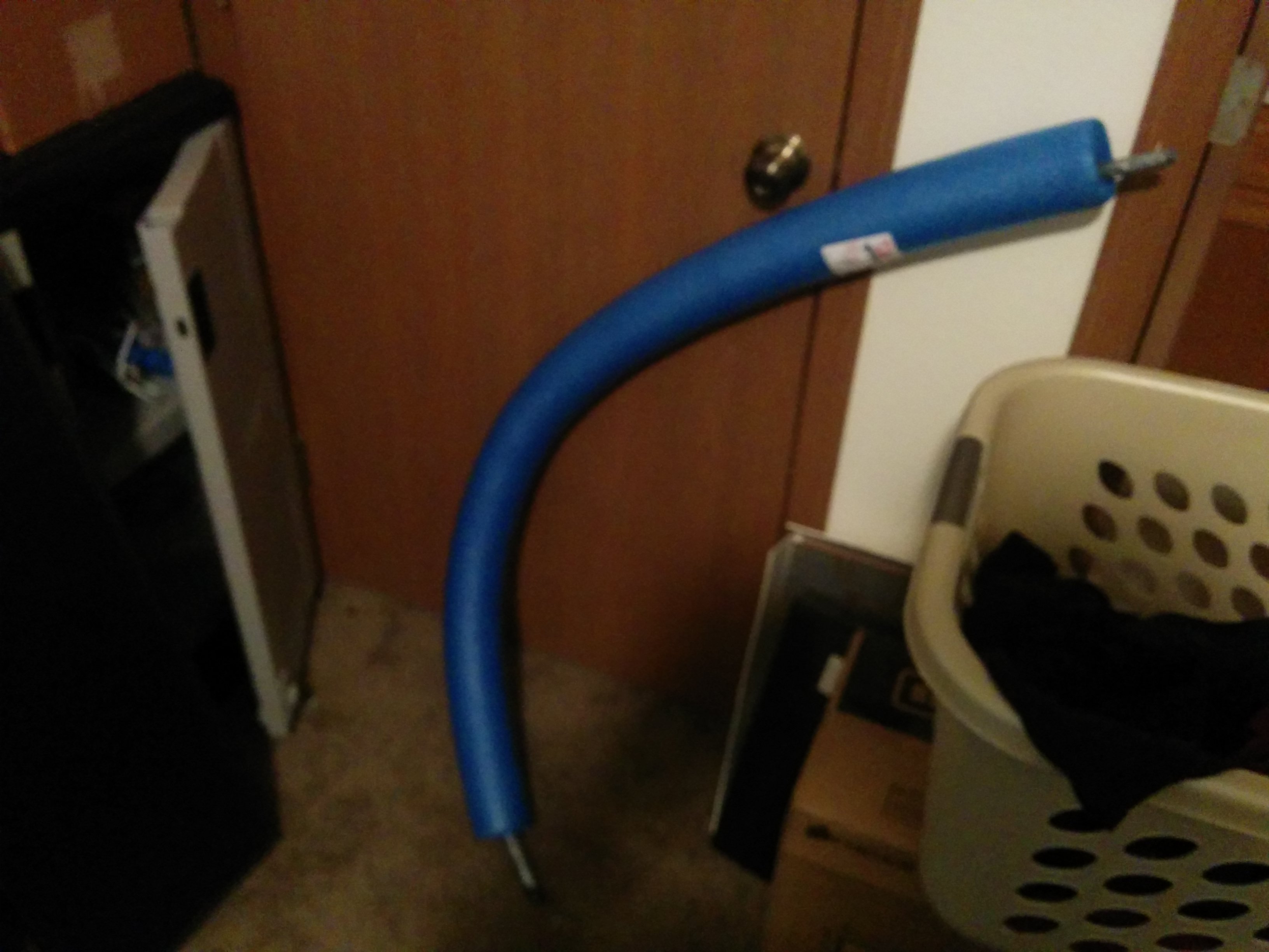

Of course as a thin copper pipe out of my back is far from intimidating I need to thicken the tail up, the solution to this one came easily in the form of a cheap swimming foam noodle from the local store. :)

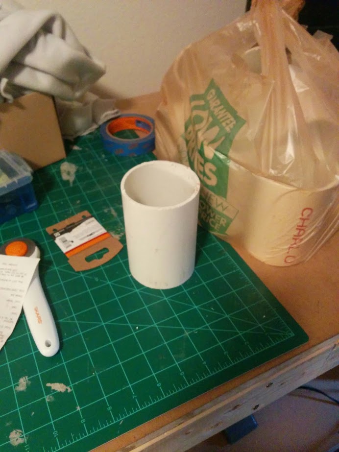

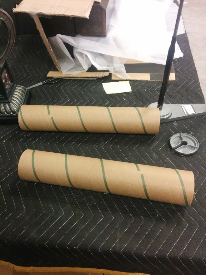

At the moment I'm working on finishing the strap setup and tinking with how I want to make the tail sections. Currently I have two thoughts on the matter, both of which just boil down to creating tubing I can slide down over the Foam piece. I'll likely either make them out of cardboard I've been collecting from work, or buying pvc tubing to cut down. Either way I intend to create 5" to 6" long tubes that will span the length of his tail. I should have it narrowed down and have construction started within the week.

I'll likely go down soon and grab a couple pvc couplers or lengths, depending on the inner diameter. I think the tail may be able to handle it, the thing can support a surprising amount of heft. If not I'll probably go the cardboard route, I'd rather not work with foam. I've been collecting a couple of shrink wrap cardboard rolls from work, if the pvc ends up to much this will be my next approach. They'll just take a little reworking to look good, I'd rather be lazy and just paint pvc

First off, I'm happy to say the piping and armature I set up should have plenty of strength for holding the pvc pieces in place. They'll need some trimming and a paint job, but they should work out just fine for how I'm imagining this. The foam noodle will need a little trimming for them to actually slide in, but that's nothing terrible. Just a little busy work. After I do that I'm going to sew a quick black sheath to slide over it and hide the hideous blue foam and create a neutral black backdrop for the (soon to be) Green armor ribs to sit on. As of right now I'm not sure how I want to affix them in place, my first thought is to drill a hole and thread a bolt through the middle. This could add a more mechanical feel and create a little more depth.
The issue I've found myself running into however is weak point where the tail connects to the board. Since I left it as loose threading in order to be detatchable, the extra weight on the tail leaves it able to tip over and unscrew. As such I'm aiming to re-address this portion of the base build.

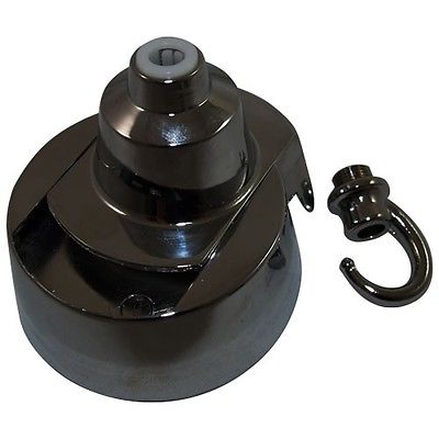

My first thought for that goes back to an old cosplay tutorial (Here) I watched, in which a Doctor Octopus Cosplayer used Chandelier Roses in order to make for quick detatching of her arms. By having it separate at a different point she was able to permanently affix the inner support threading. You can see what I mean at about 8:30 into her video.
Thus far I've only been able to locate Chandelier Roses from the UK, so unless I'm just not using my terminology correctly for shopping in the states, acquiring one may take a little bit. Plus the joy of making sure to match up my threading and pip sizing. I think it will be well worth it.

I've considered something similar myself, and while functionally it should work, i also have to consider how easy it will be to take on and off for traveling. That's why the chandelier rose is so appealing, it provides a simplistic method of removal and attachment with a look that i can work right into the costume.

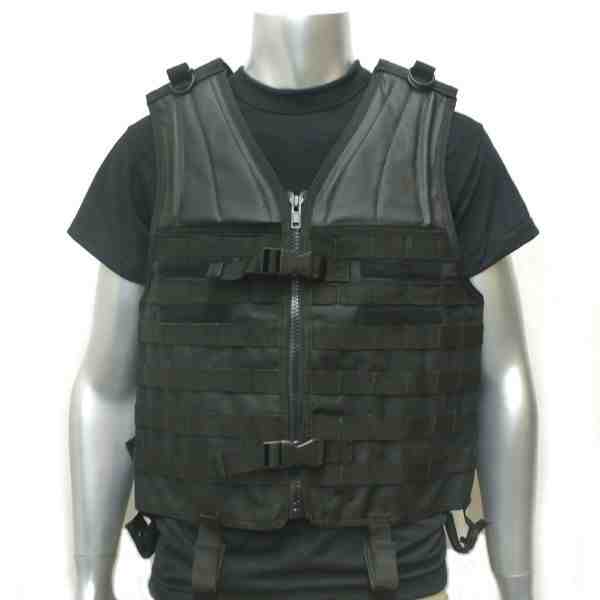

So I've made some changes as i wasn't thrilled with how backpack was coming together. The strapping just wasn't doing the job and i knew the weight was only going to get worse. The base and pack itself could hold it, but it wasn't securing to me in a way i was happy with. No big, I'm only out $10 worth of straps and I'm sure i can repurpose them later.
I debated going with an altered backpack like in the doc video i linked, but in the end decided on going with a bit more full vest.
So the new plan
I've picked up a molle vest, one that will sit rather flush to me. This comes with an area in the back that i can slide either a piece of wood or metal into.
The benefit to this direction is using a securing system that
1. Has a look i can with directly into the costume
2. Created a large base for me to secure armor playing to
3. Let's the weight of the tail distribute fully across my torso.
I'll be ordering the chandelier rose in the beginning of July, at which point i can start working on putting everything together. In the meantime i can focus getting the tail fitted and painted :)
