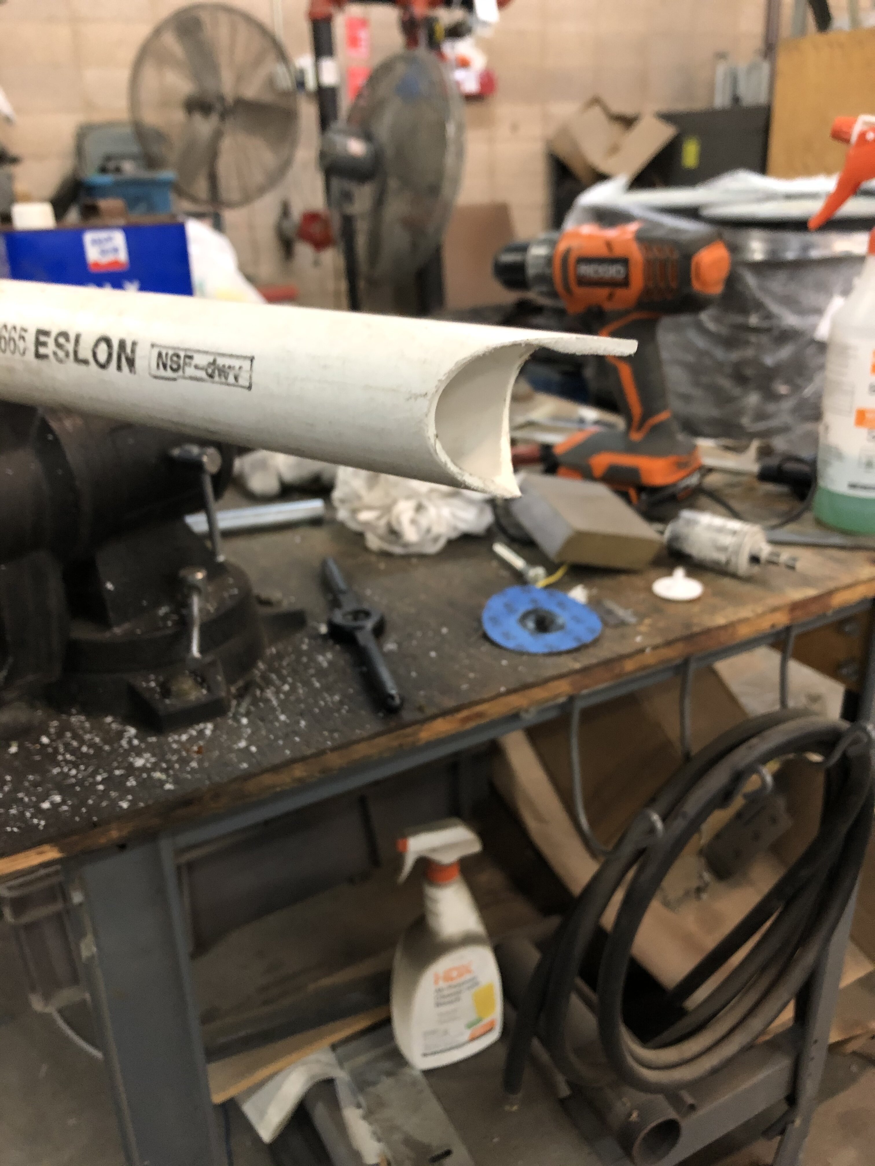

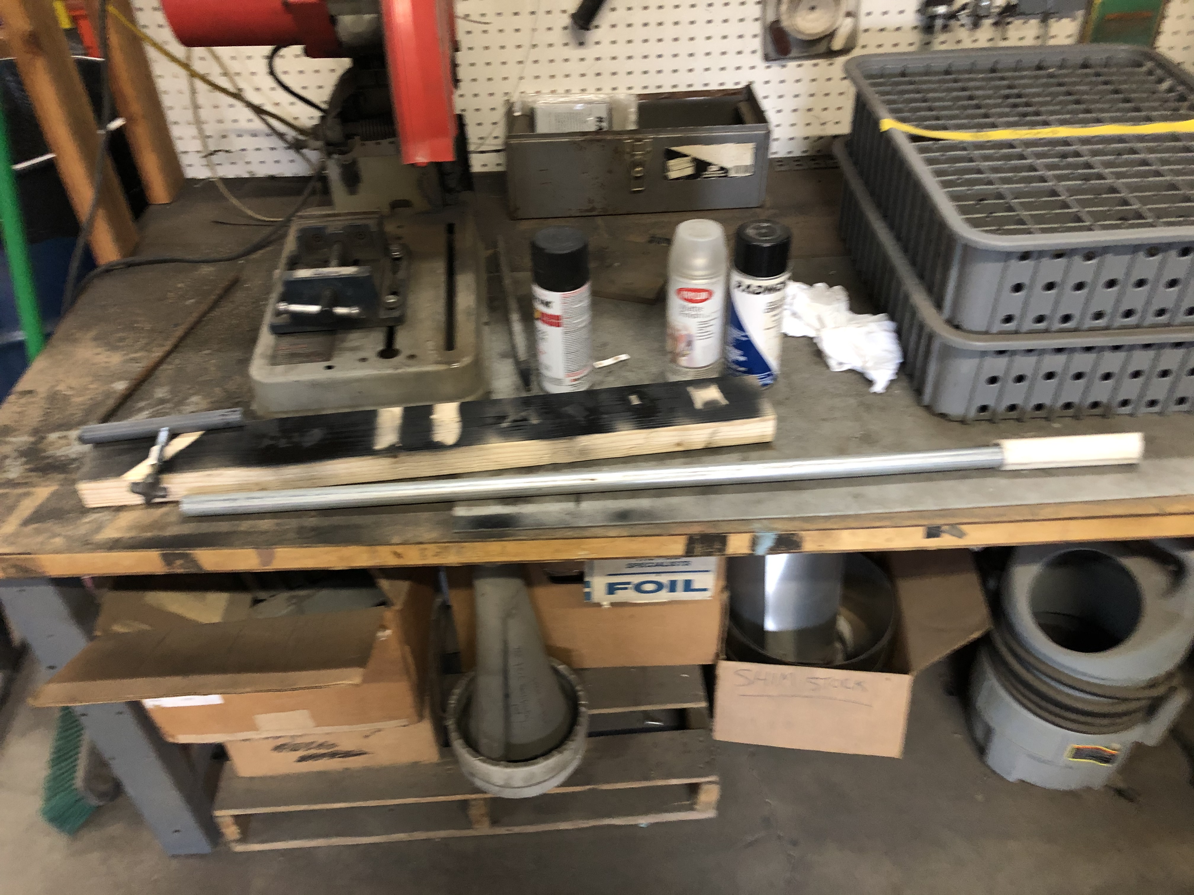

The M40 up through the current -5 variant is a bolt action single shot based on the Remington 700 action. So I decided this would have a bolt too. I turned down a length of schedule 80 PVC (1/2”) to fit inside a length of 3/4” conduit pipe. The regular thin-wall stuff. This is also the barrel. Then I cross-drilled that PVC roughly in the middle for the bolt handle, tapped at 3/8-16, which matches the thread of the four-prong handle I found for the bolt.
I will mill an “L” groove for the bolt to cycle. I may add a spring or something to provide some feedback. Since the chamber needed to be mede a bit fatter, I added a length of copper pipe around the barrel after squaring up the ends on the lathe. Currently some tape around the barrel is keeping it centered. JB Weld will be brought to bear unless I change the design.

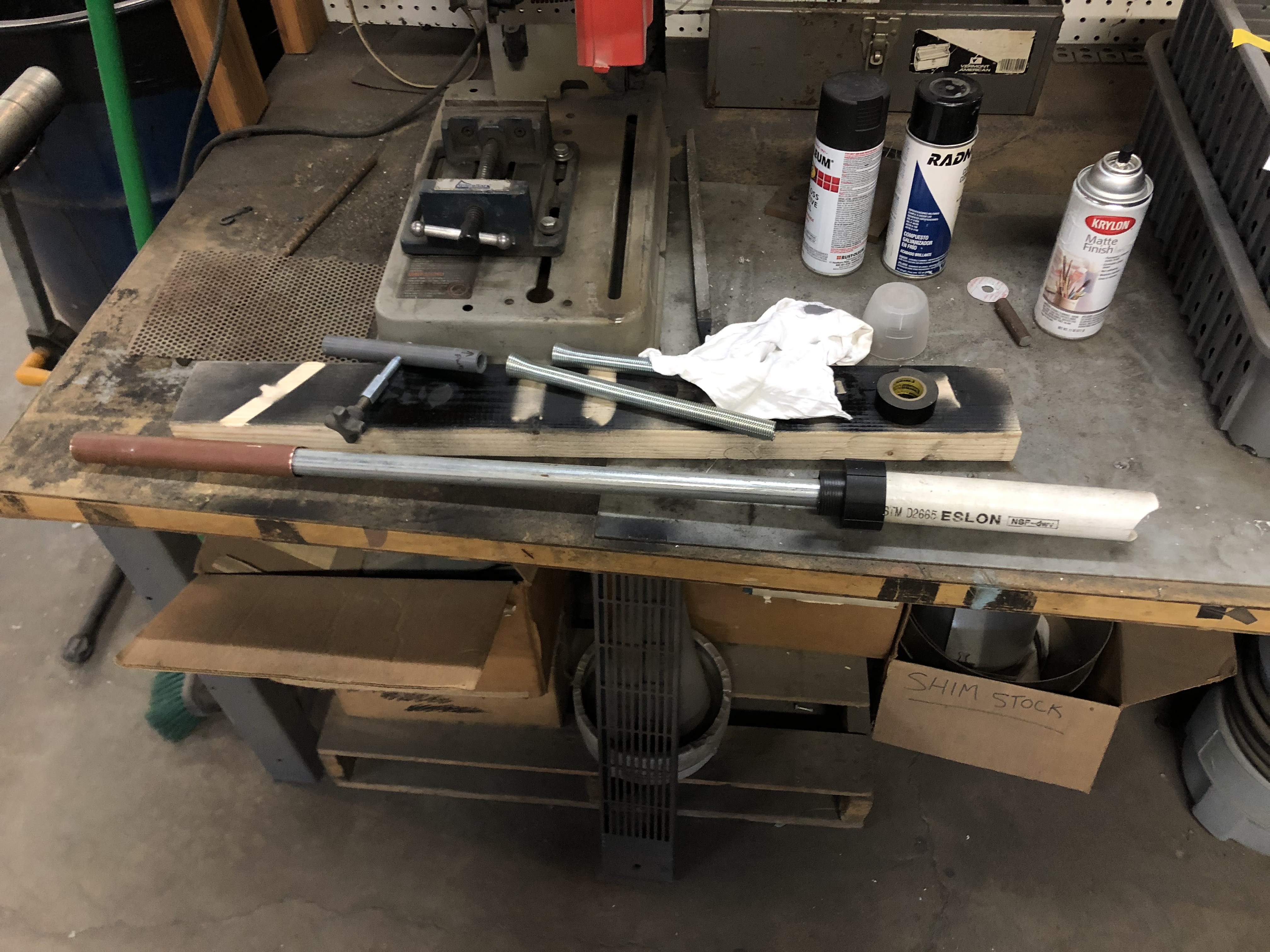

First mock-up:

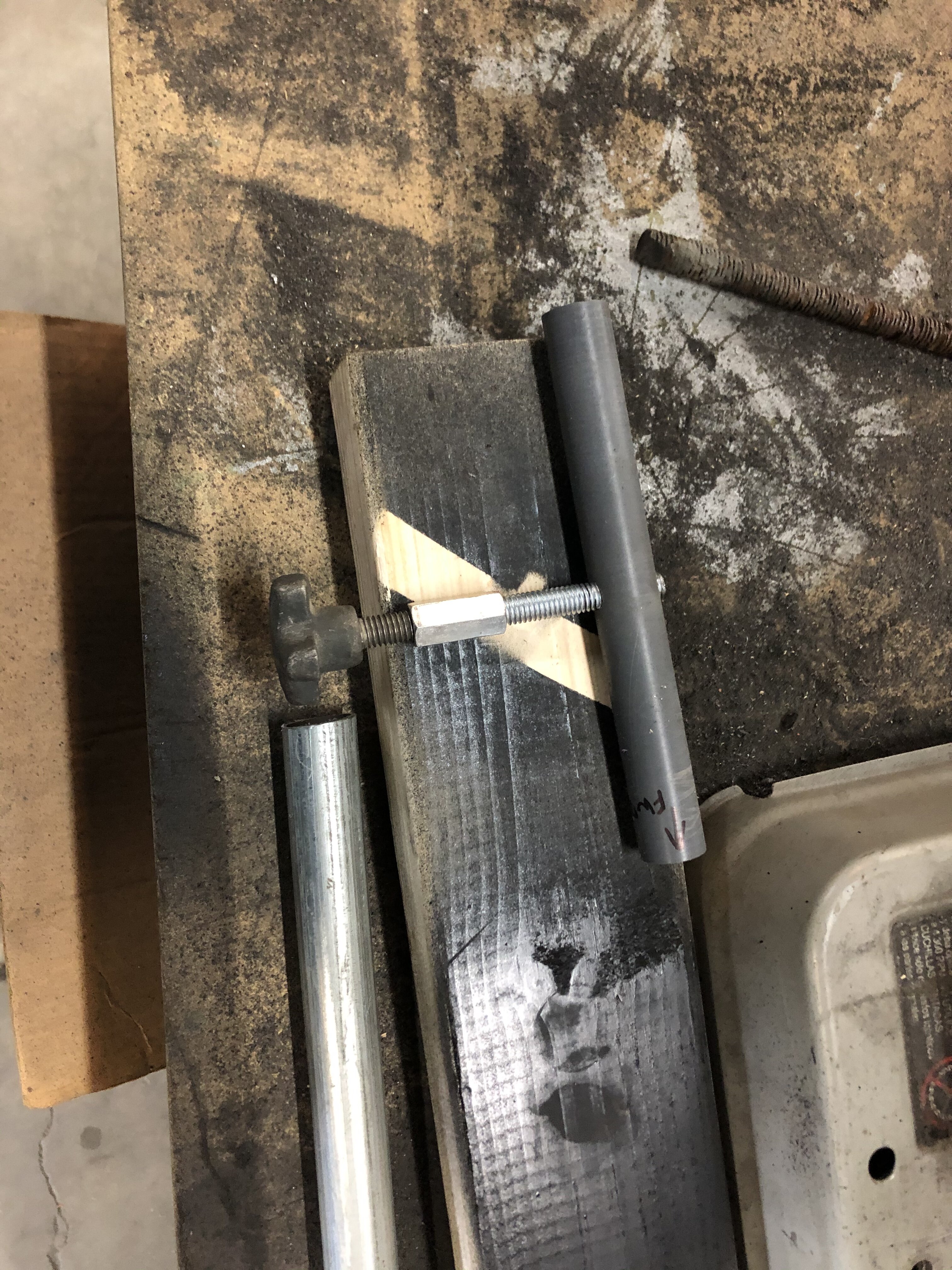

“bolt” with handle, way too long obviously, but it fits and turns freely.
Here is the copper “receiver” in place with the assembled gen-2 I-CCA
