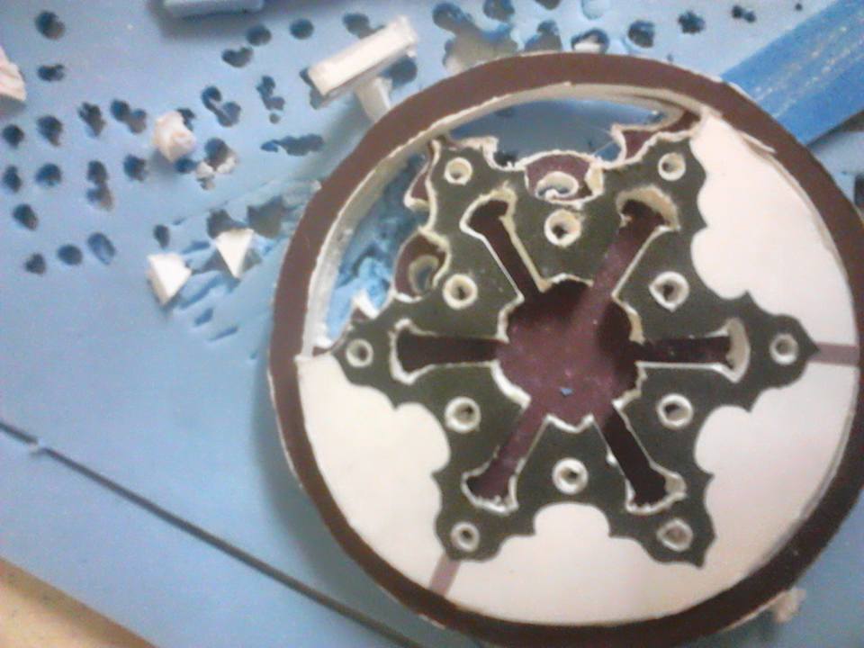

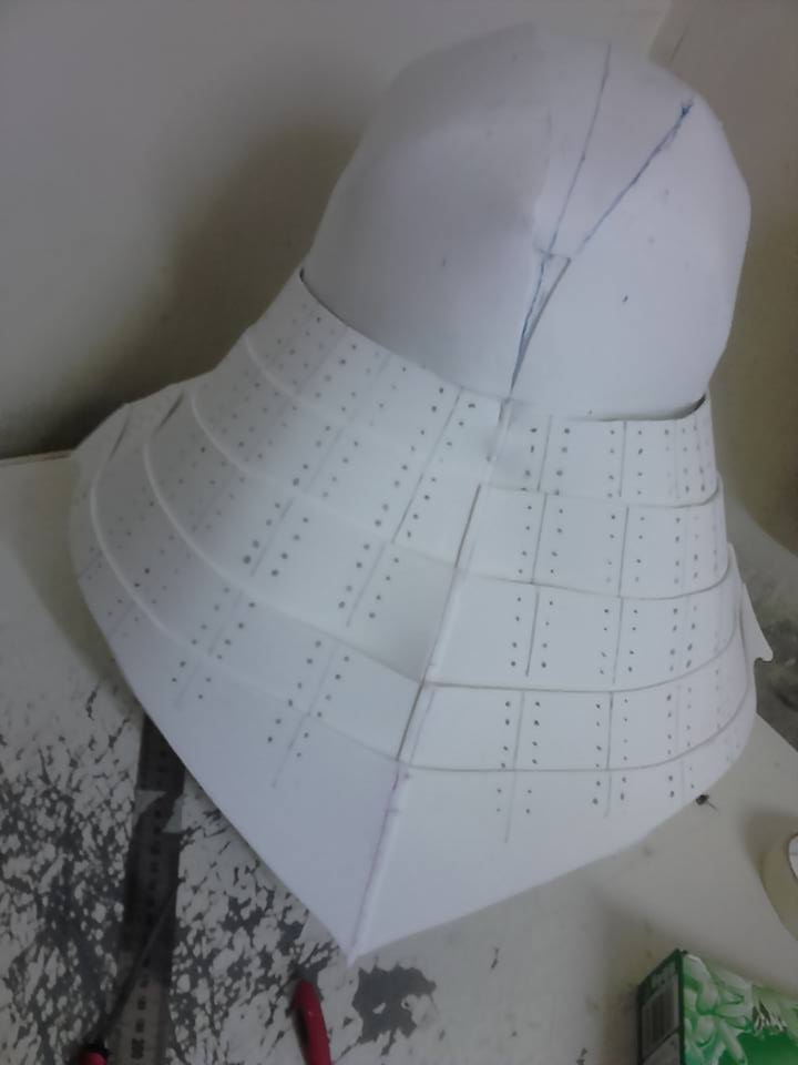

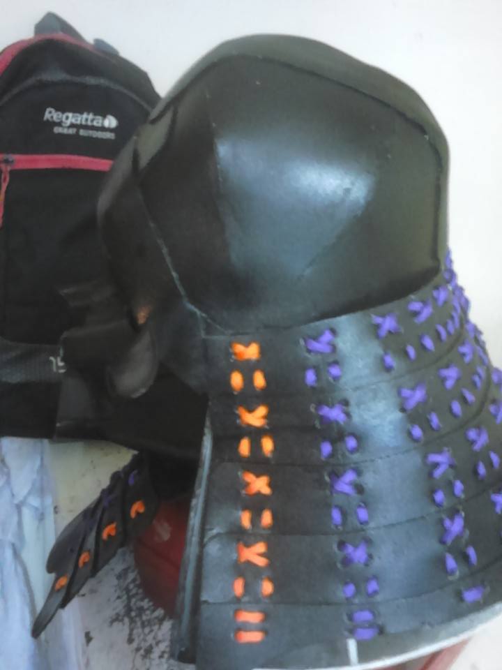

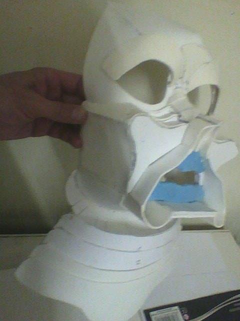

Built version 1 out of foam, once i`m happy that I`ve done Takeya`s design something approaching Justice planning on using Leather but heres some in progress shots:-
11265416_10153272190450482_2454826005710896836_n.jpgfirst test fit of mask and throat Guard

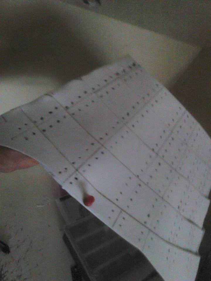

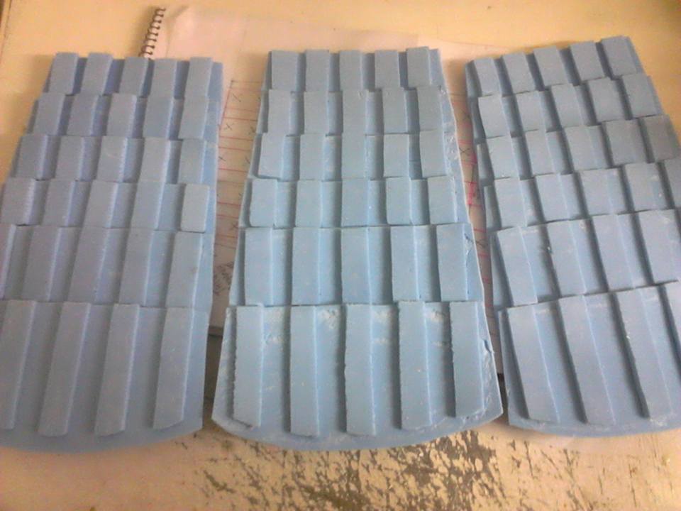

10177983_10153361281660482_52301669194056698_n.jpg10385562_10153355358850482_5040046460205102231_n.jpg10390020_10153358569135482_1989957144905045487_n.jpg11391179_10153363892010482_2777792207740233625_n.jpgPlanning out neck-guard, punching the holes (used 550 type Paracord for lacing)

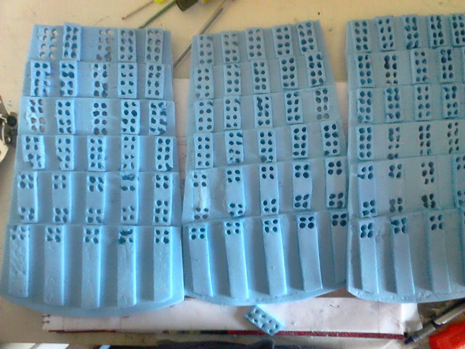

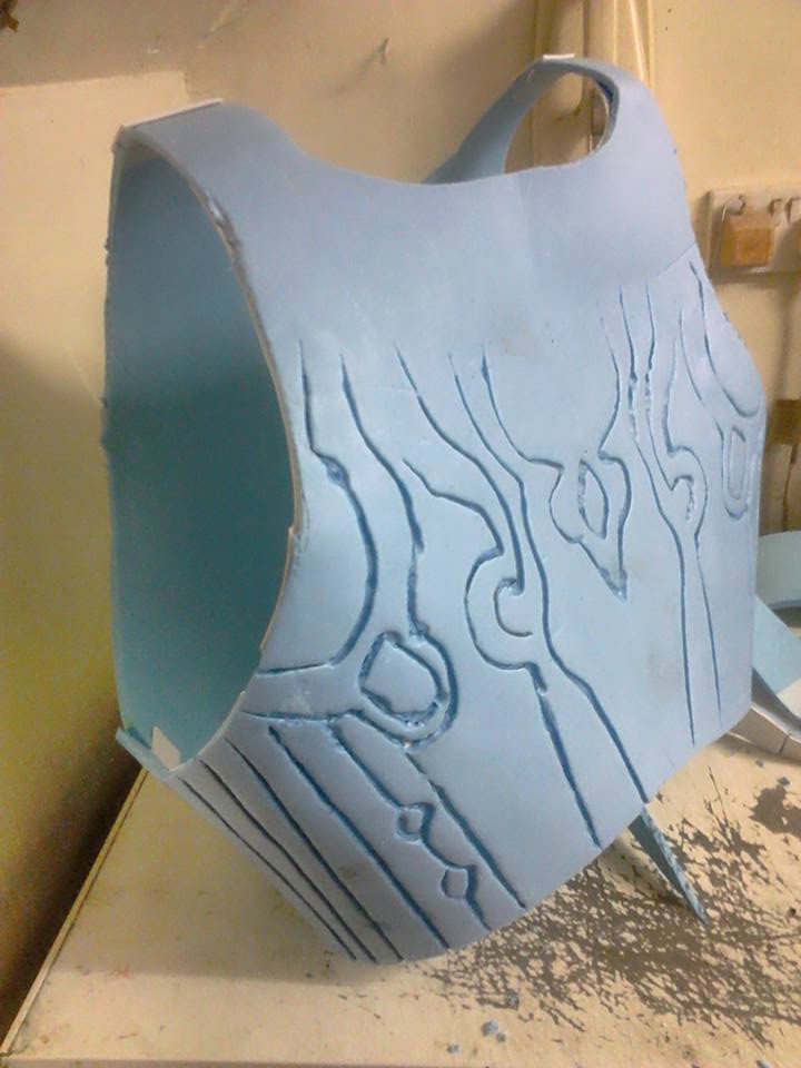

11828712_10153471510120482_331857176488021811_n.jpg11822309_10153467331765482_1347672193406117609_n.jpg11742851_10153422561365482_2662563961688386228_n.jpg Chest and thigh Armour (used Dremel and lost plot slightly so replaced parts with Foamboard, now using a Brass pipe to make holes in future...

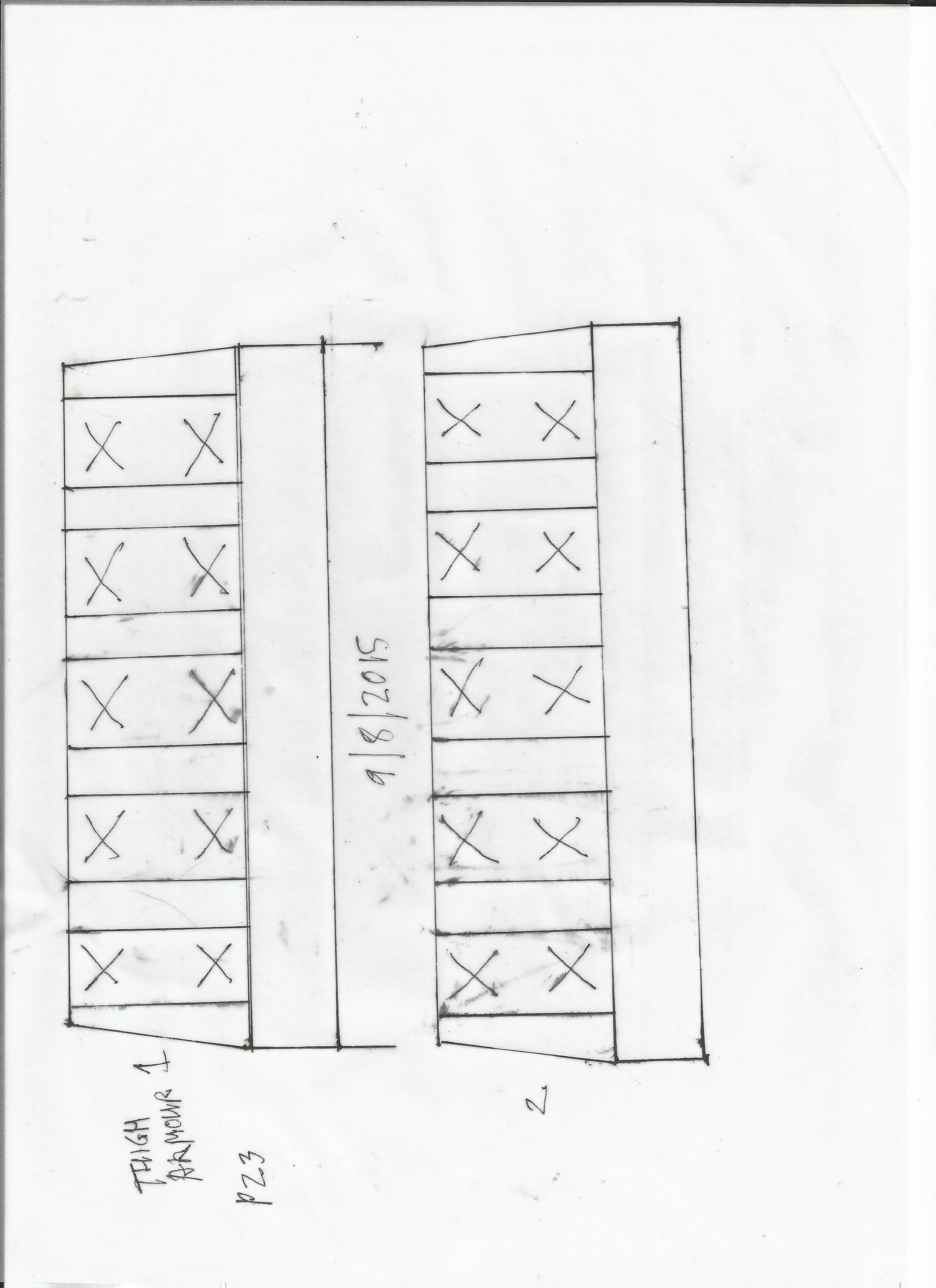

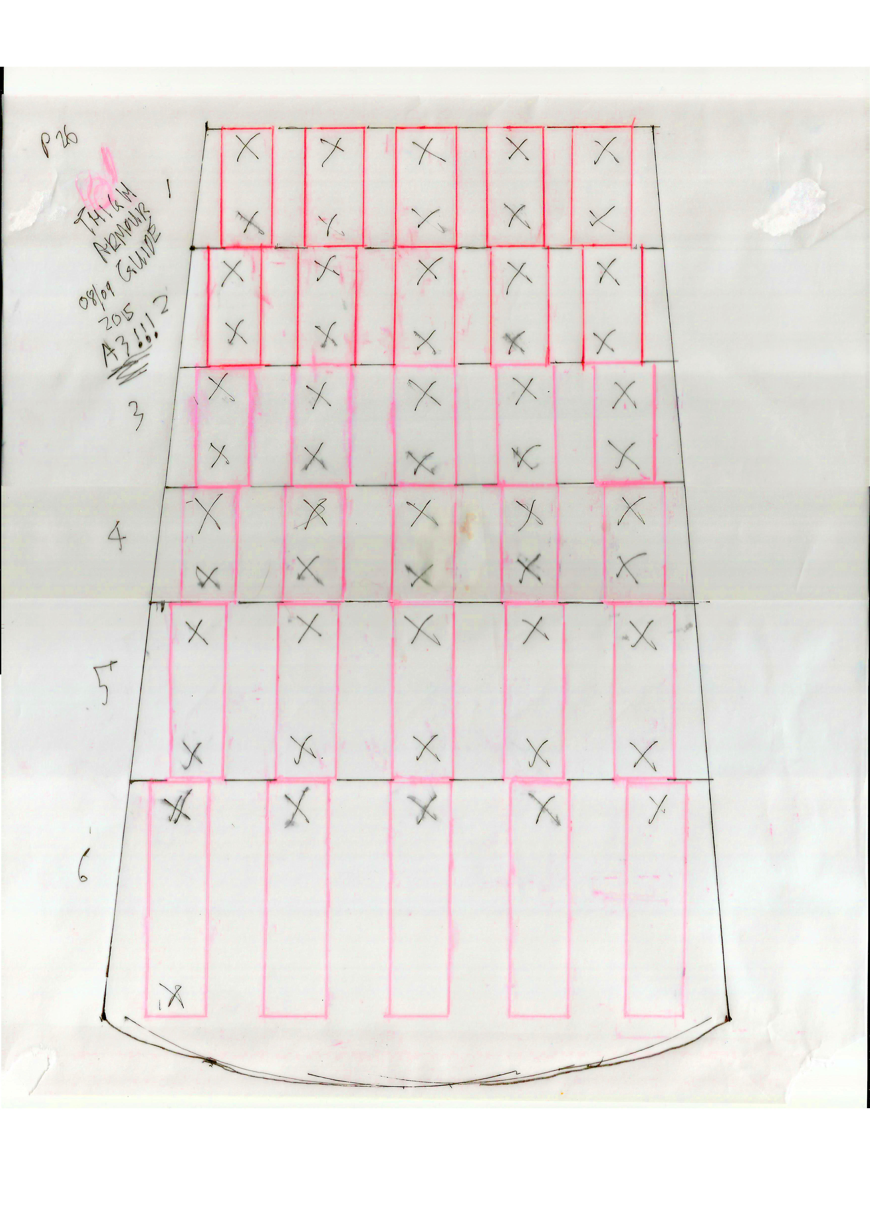

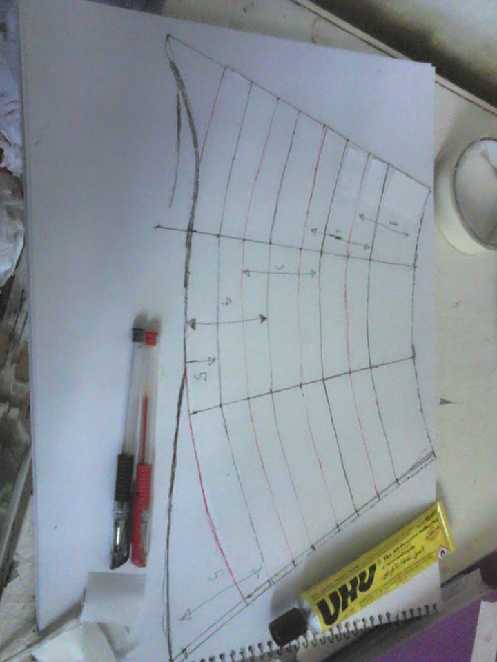

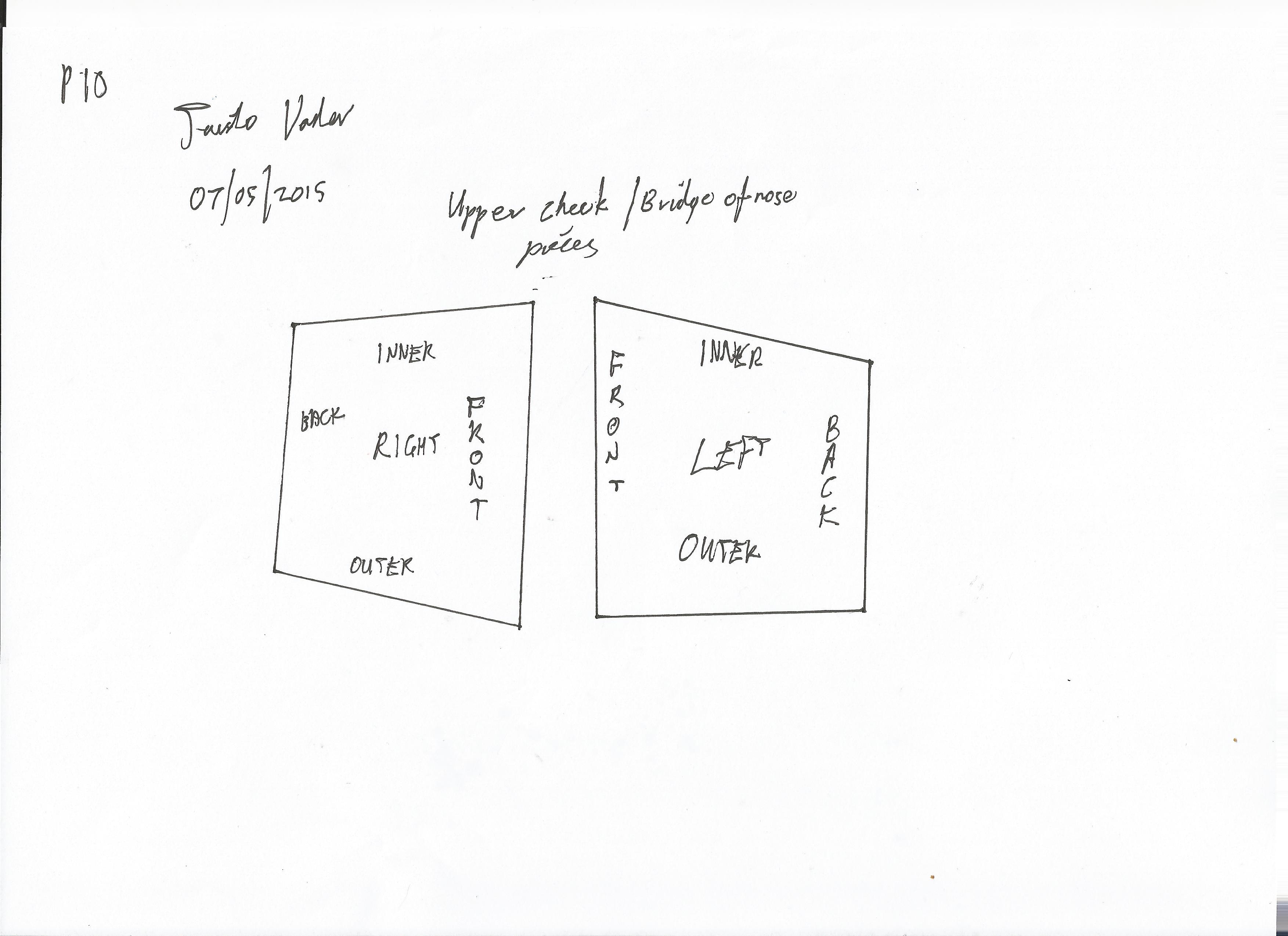

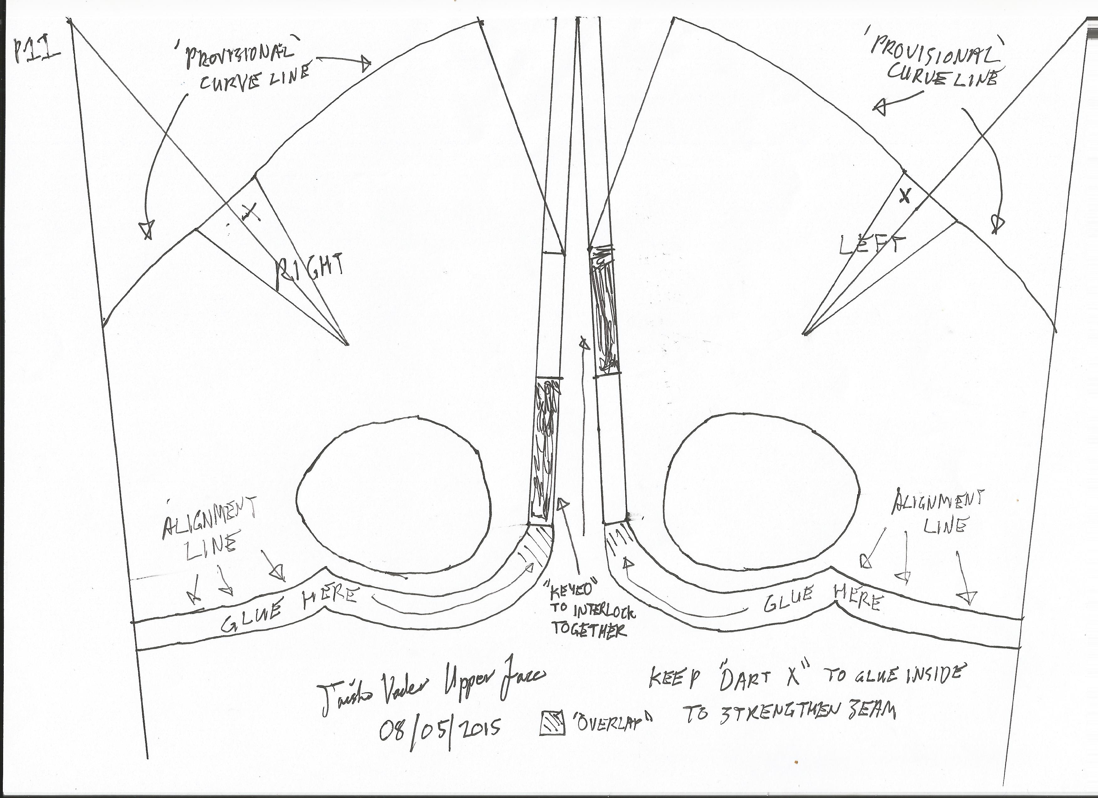

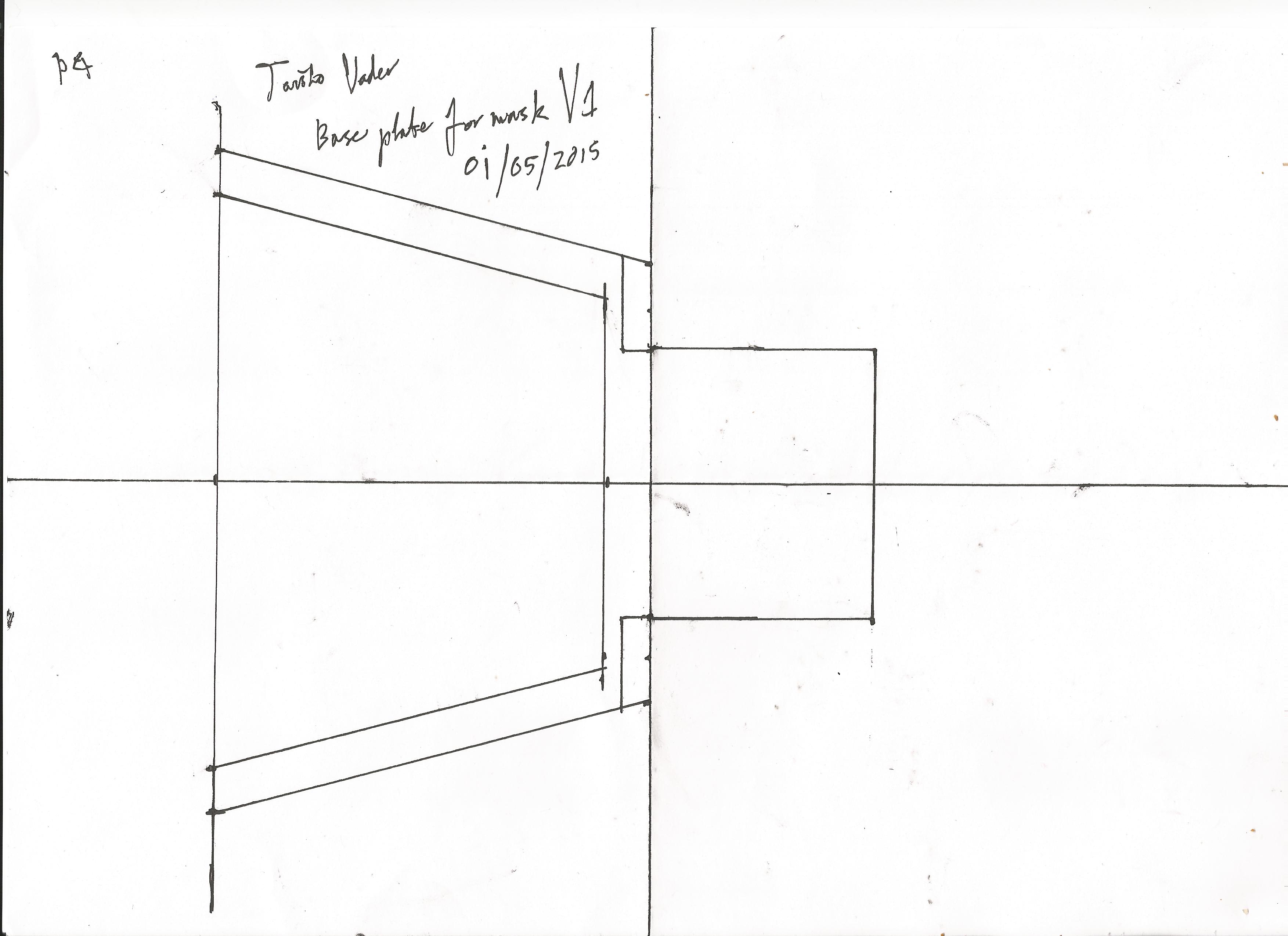

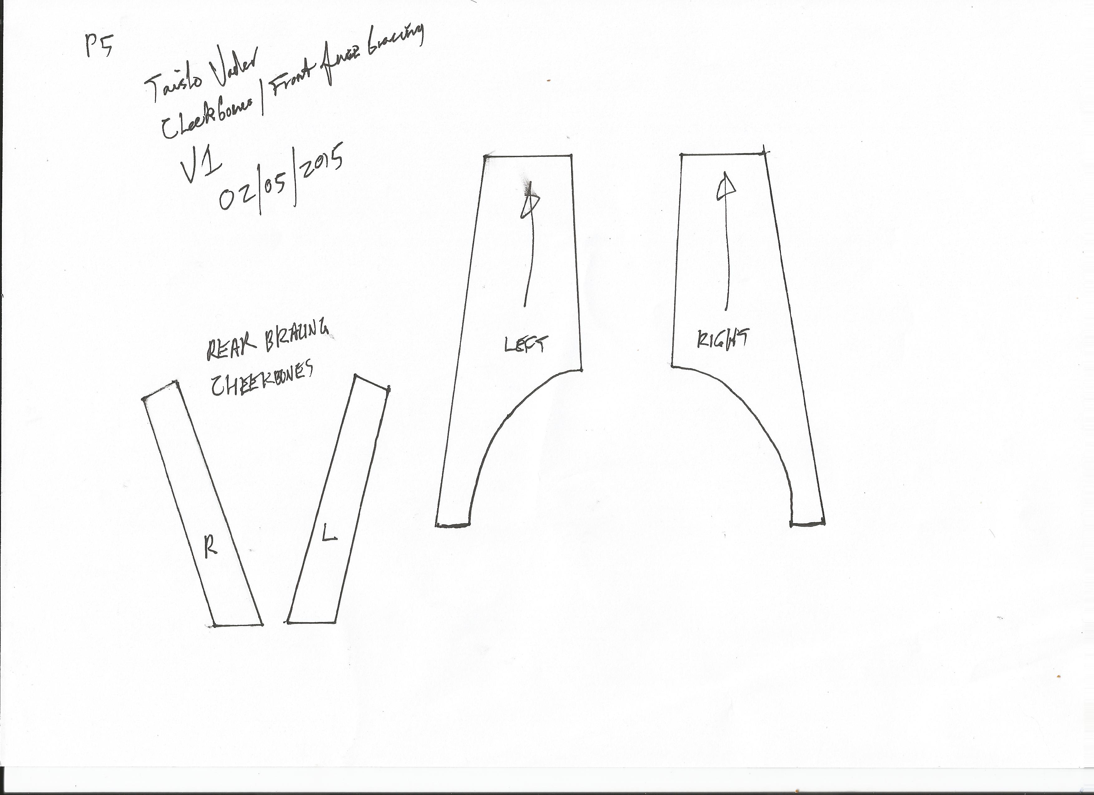

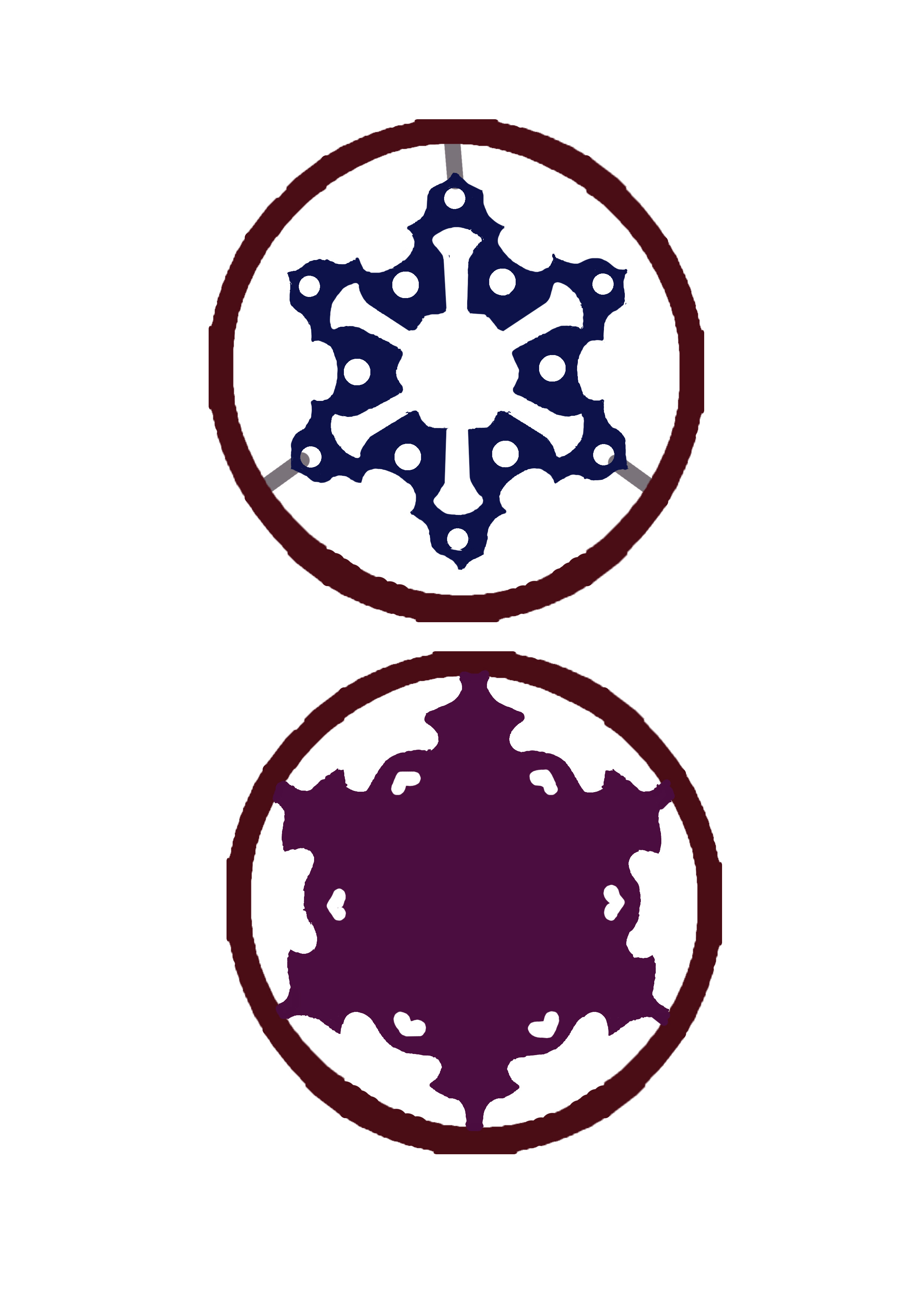

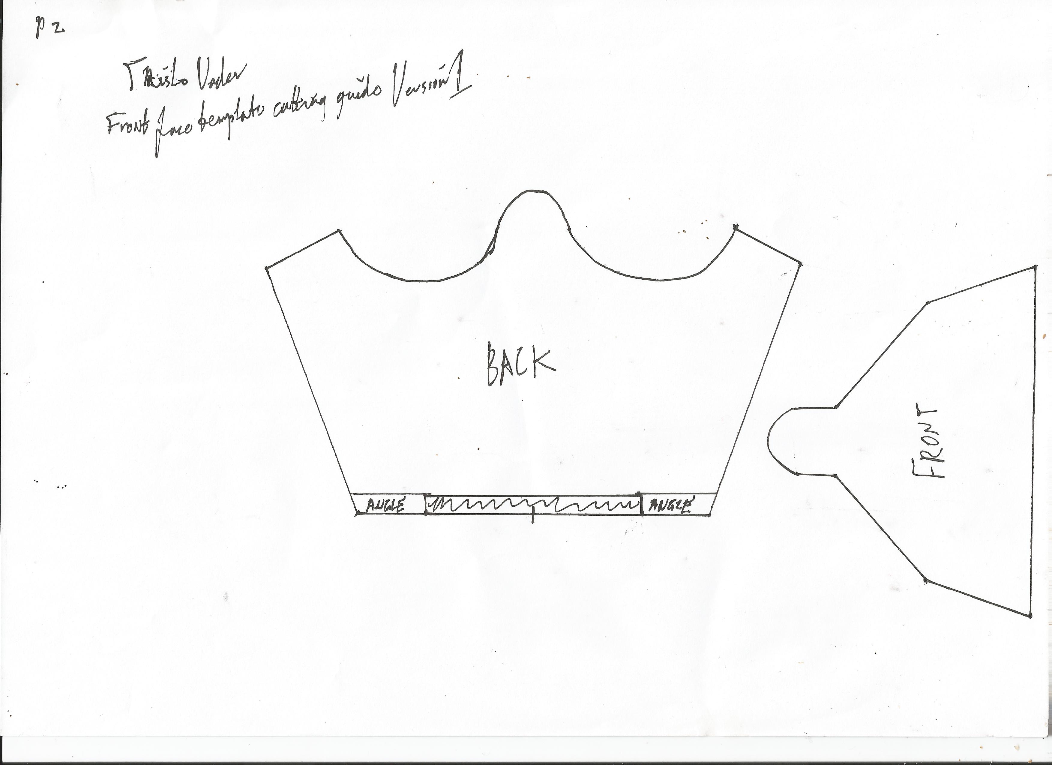

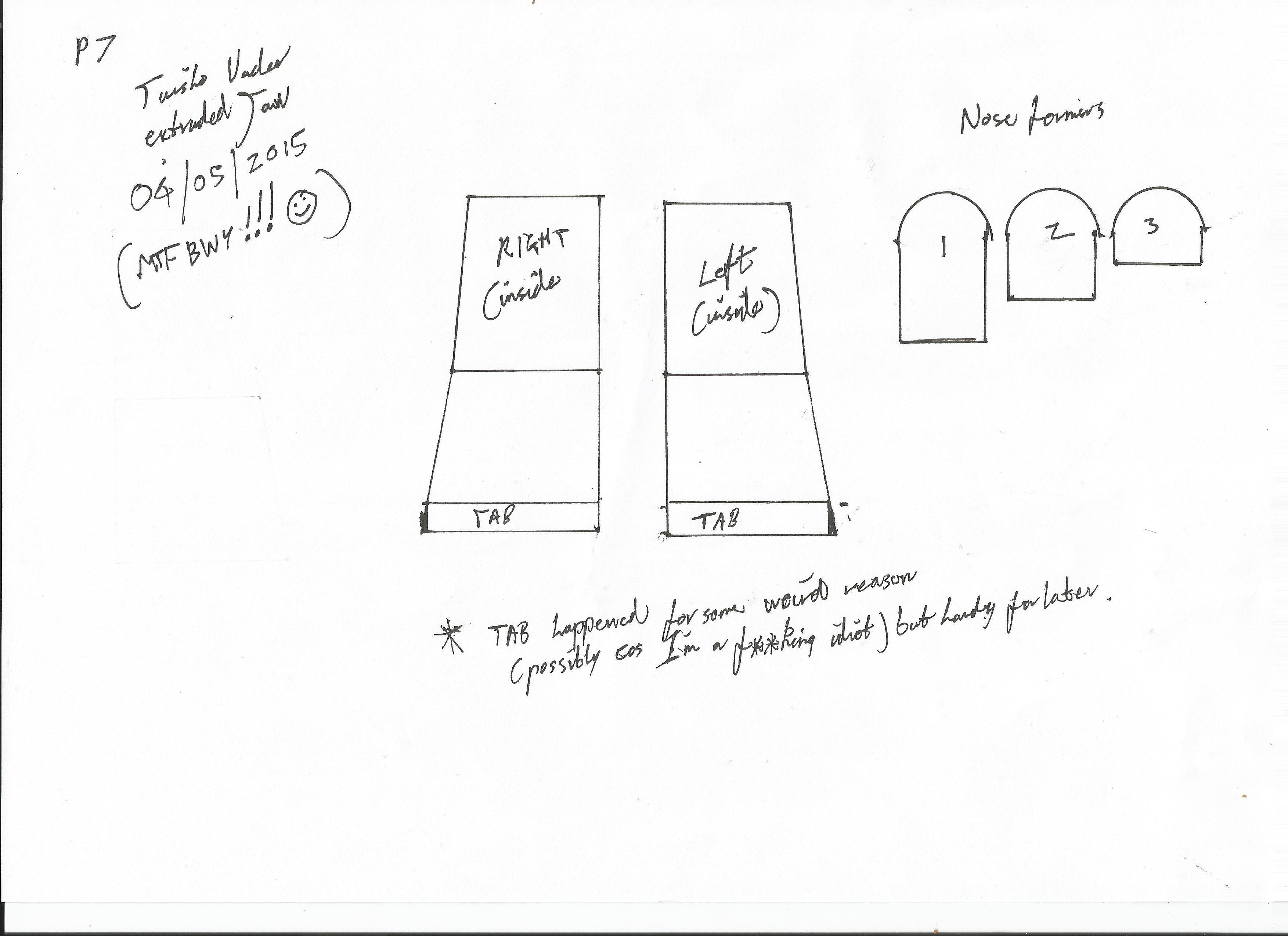

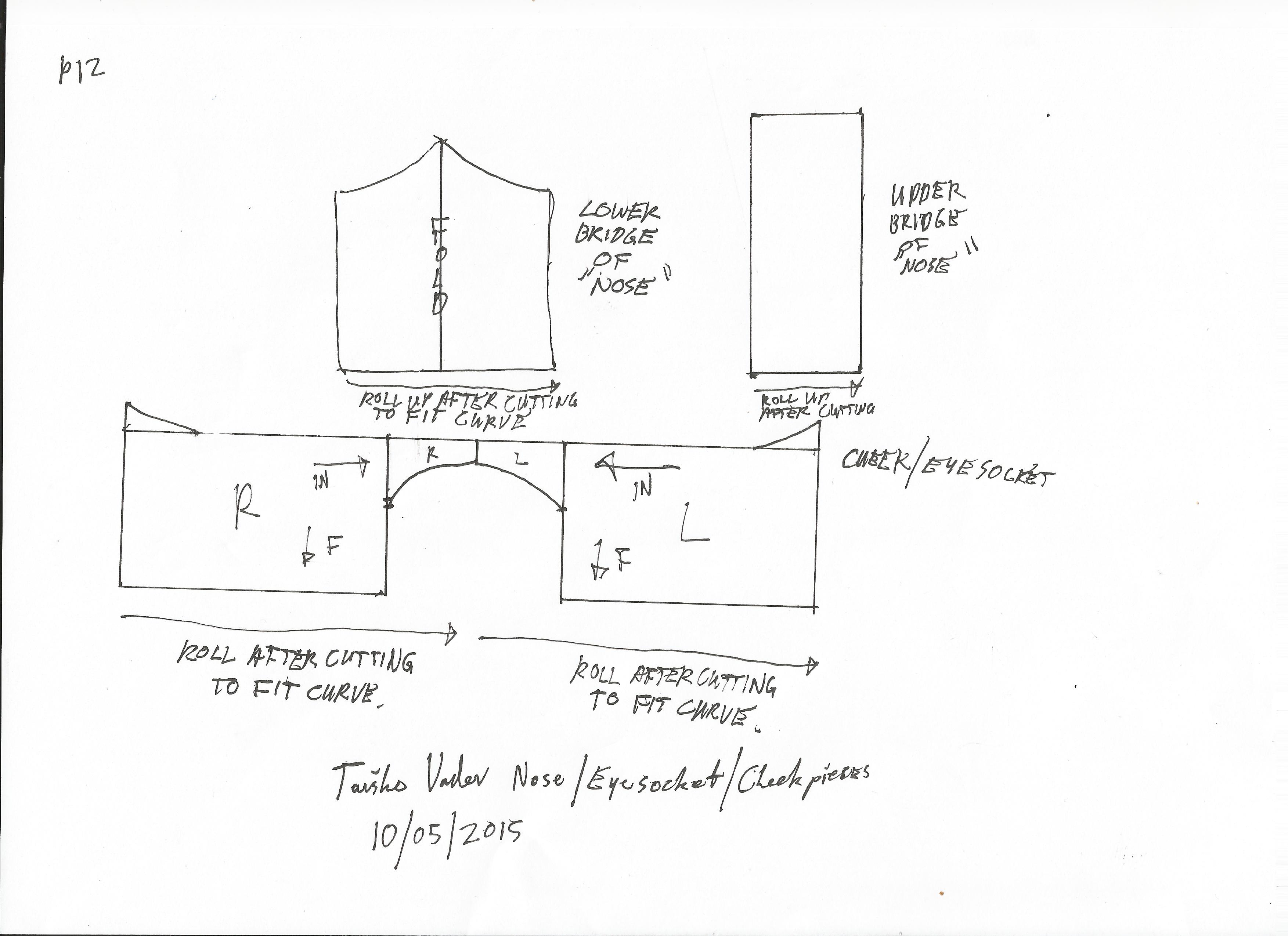

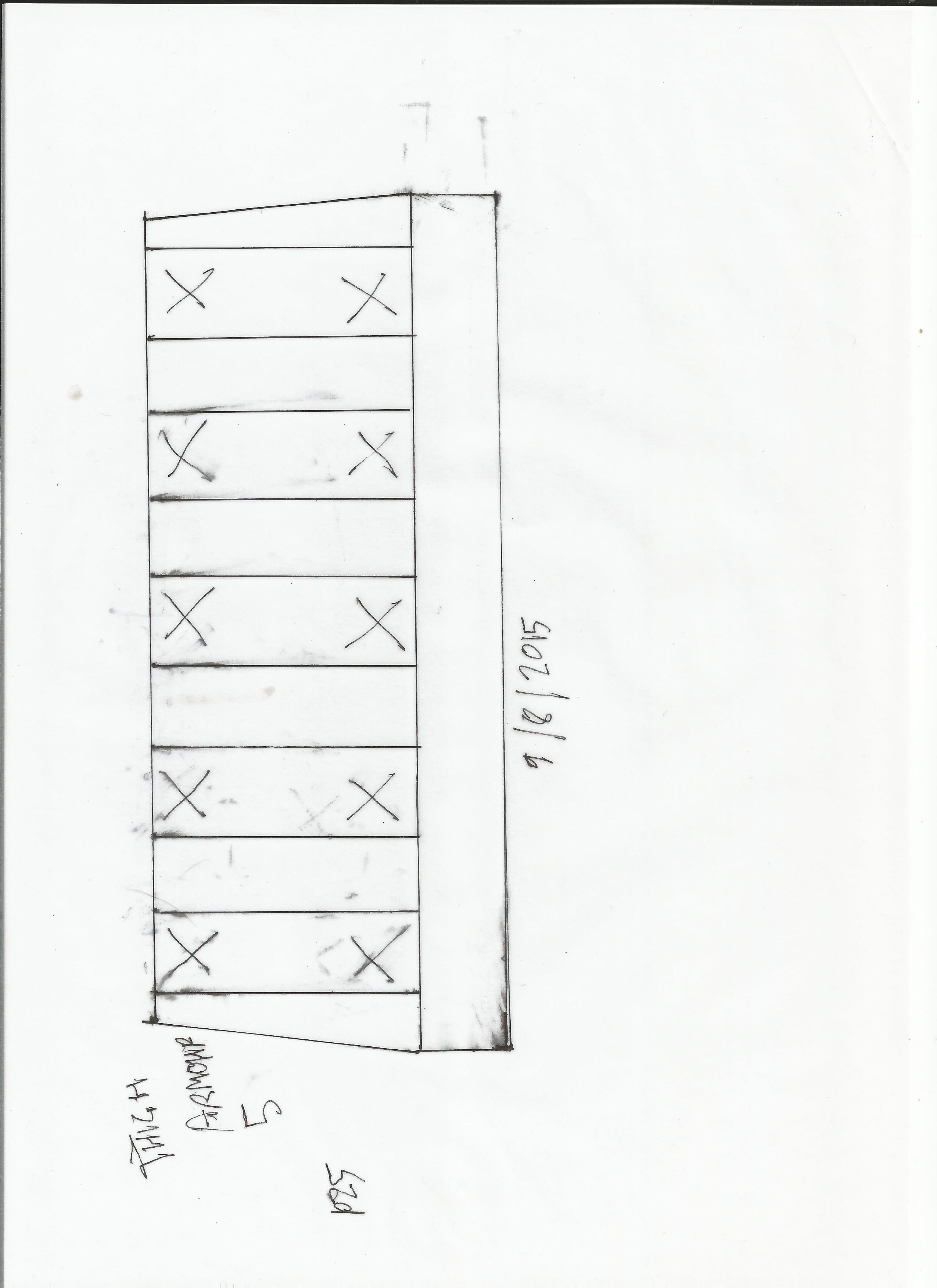

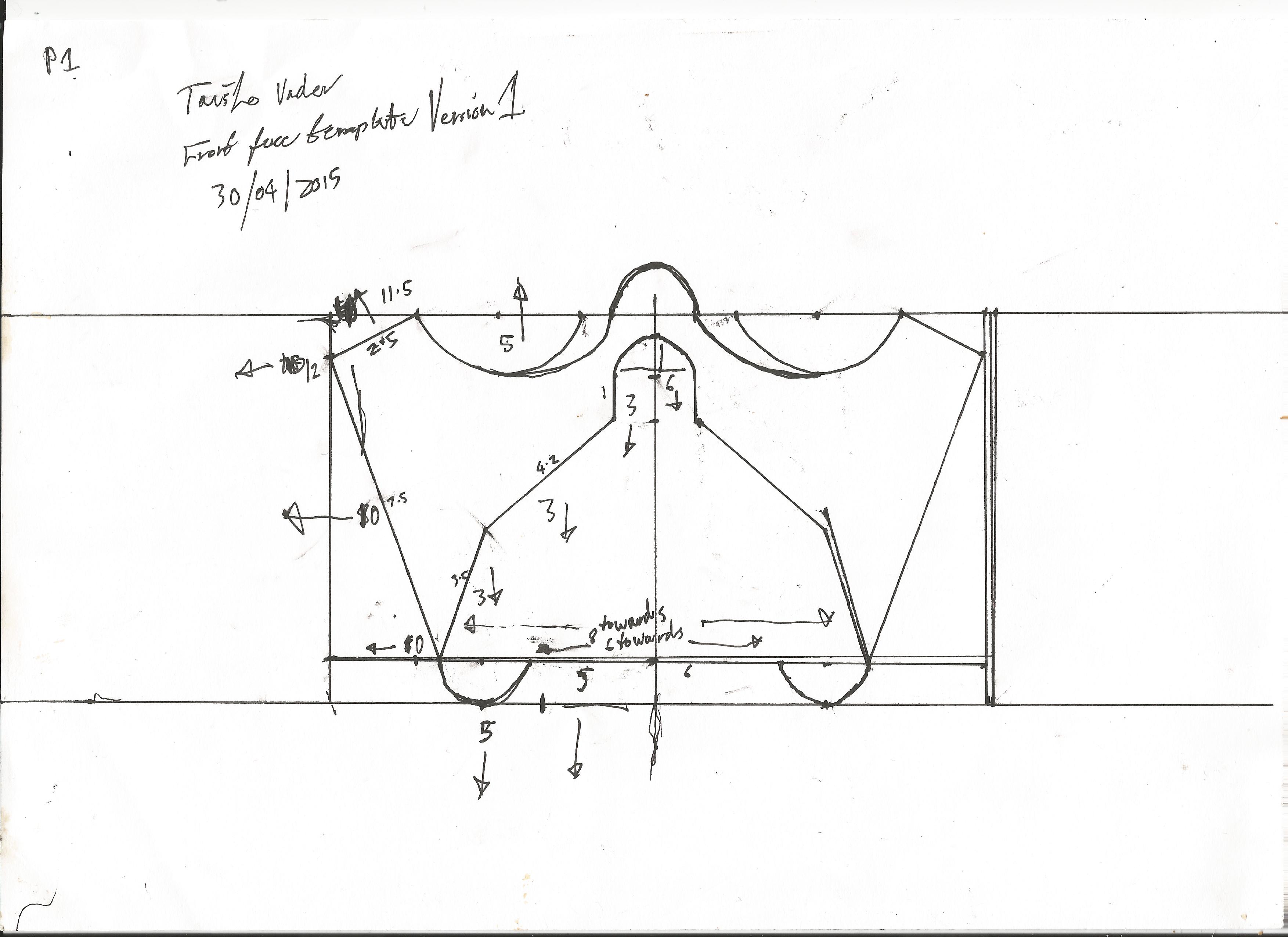

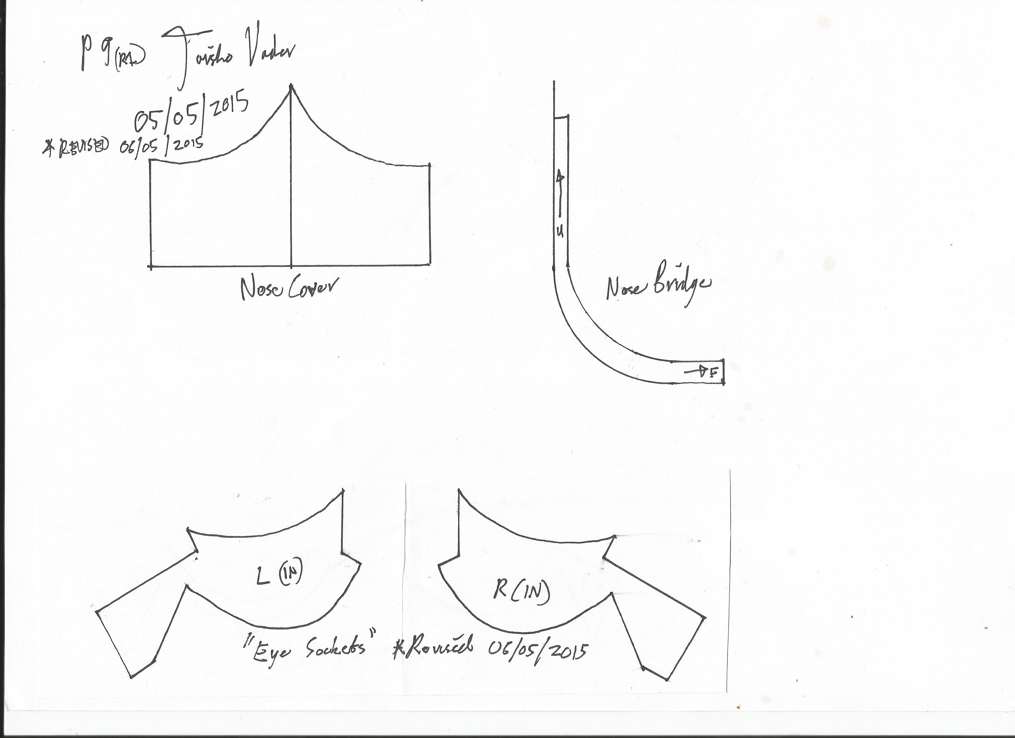

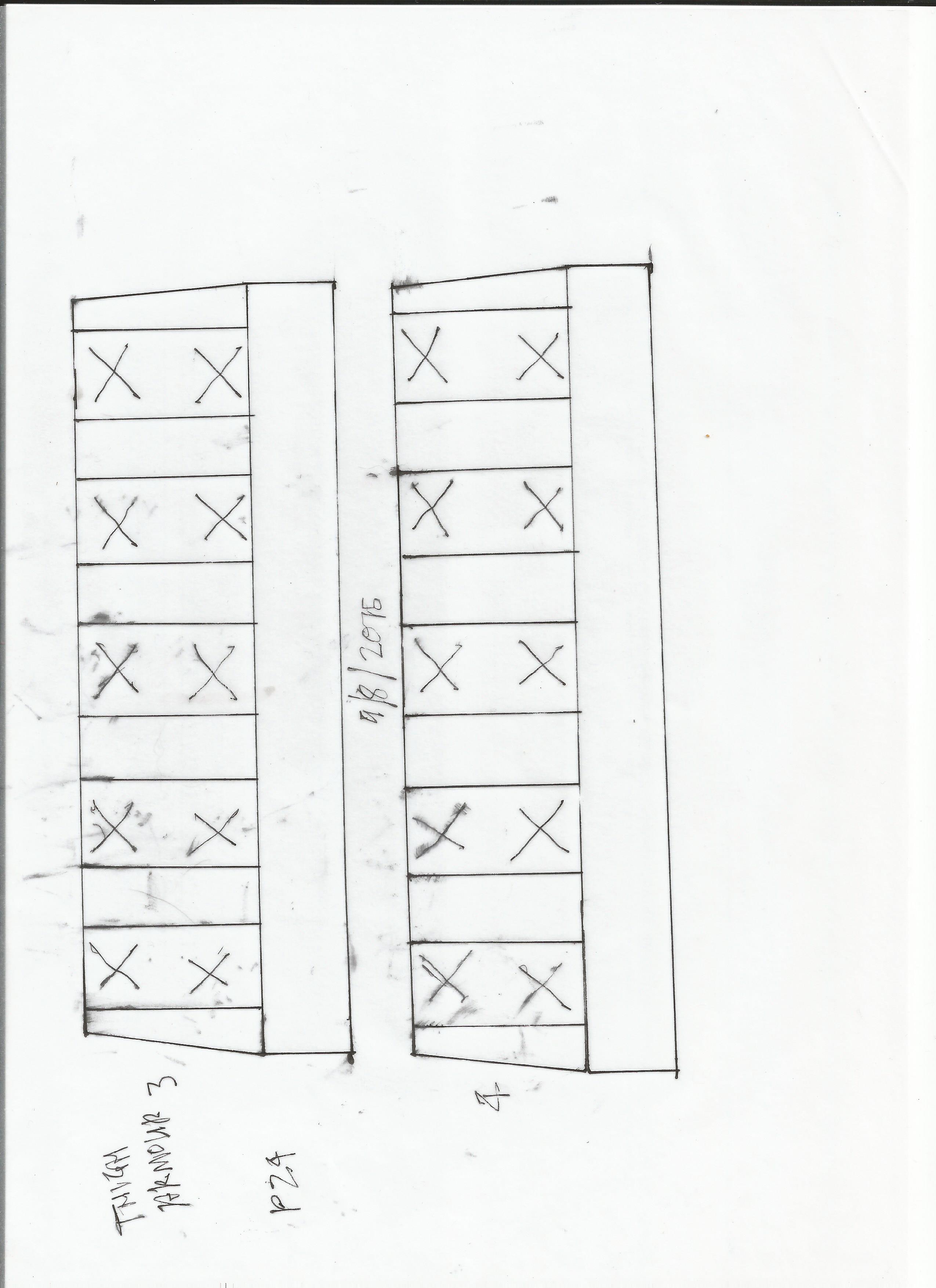

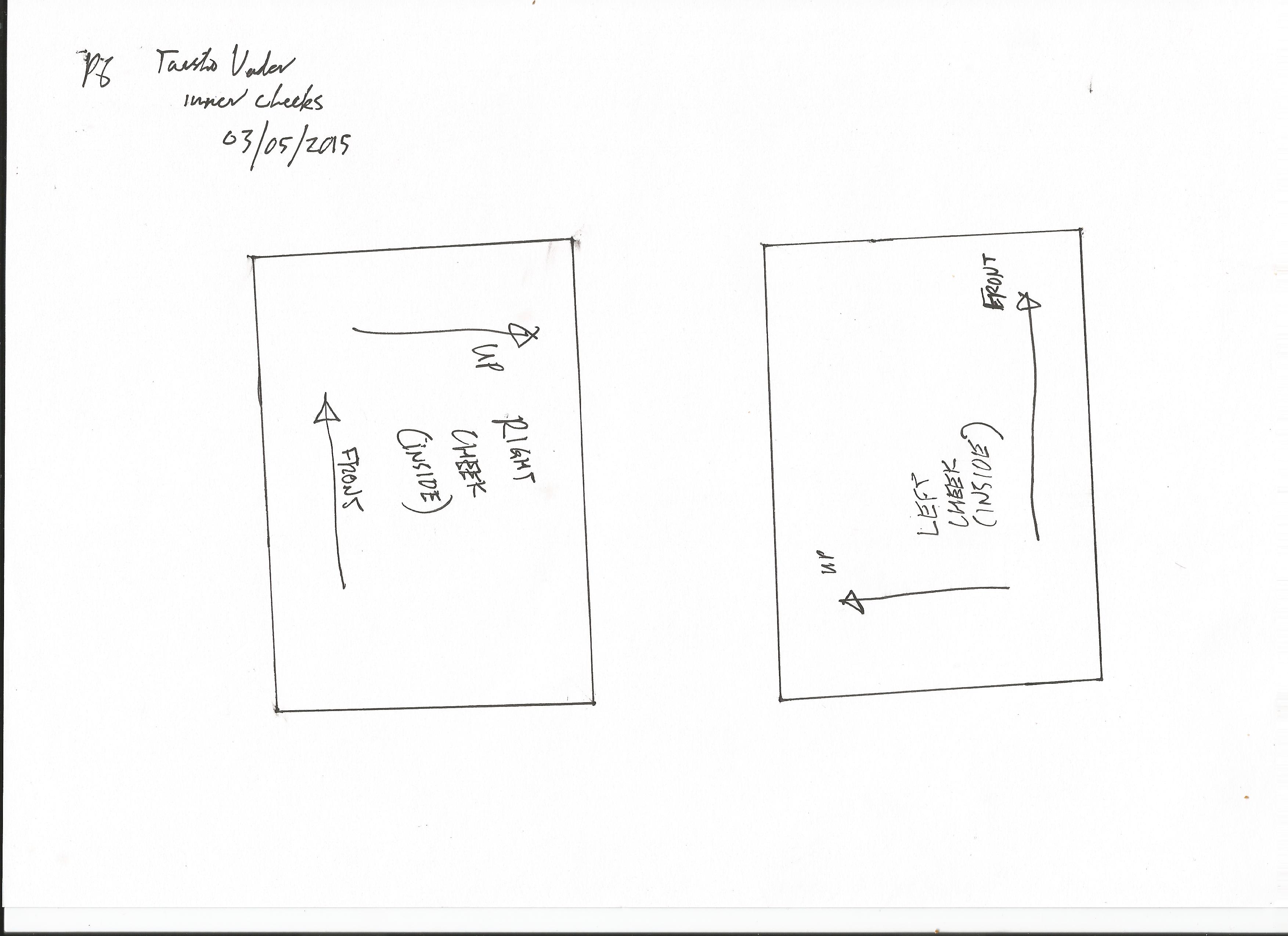

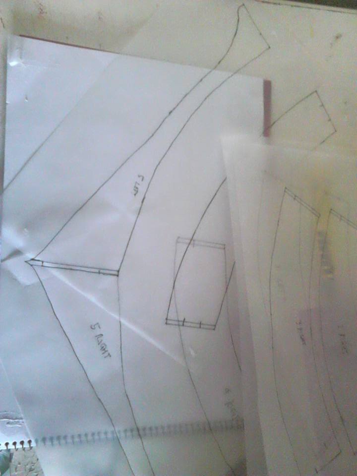

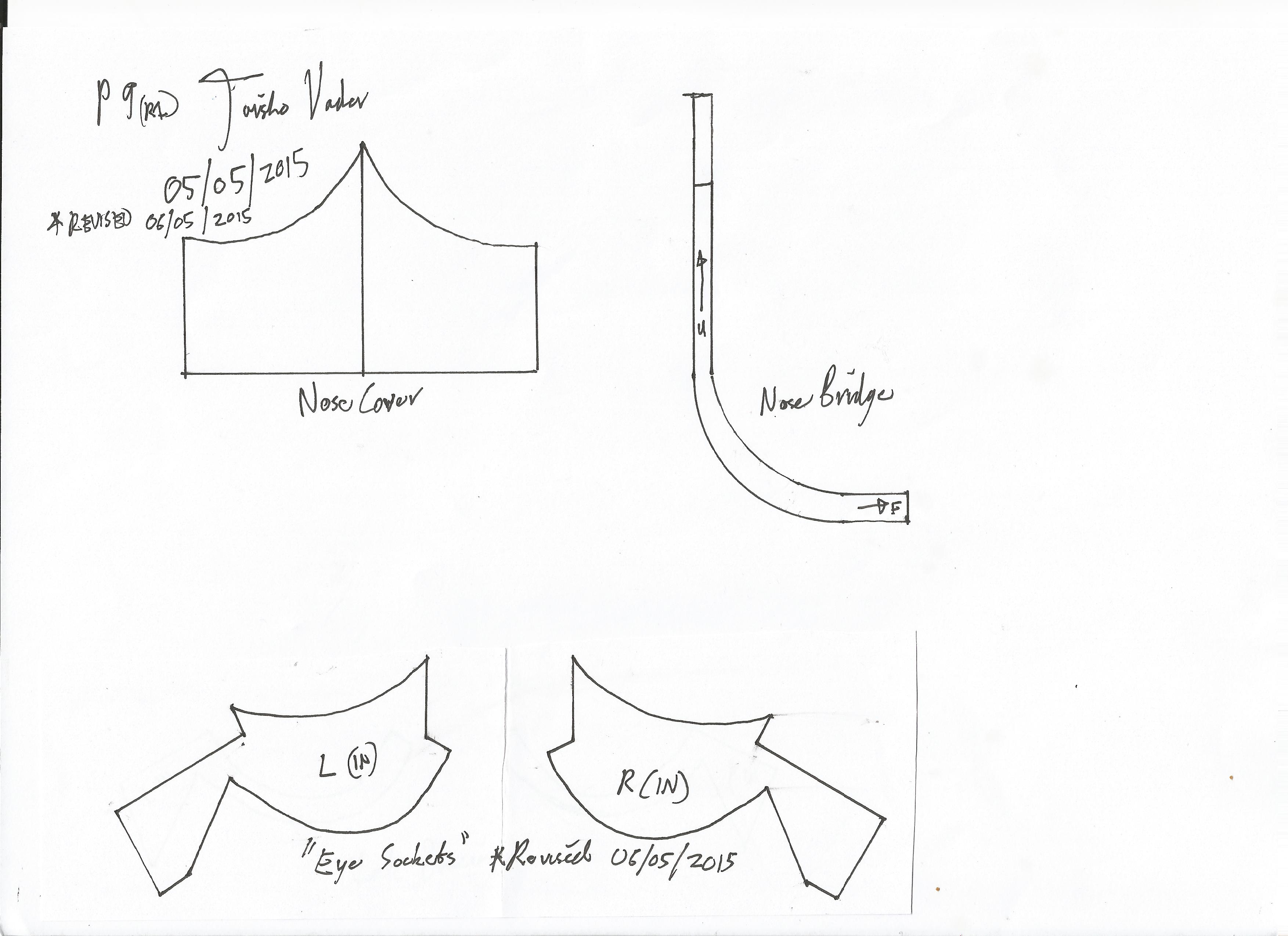

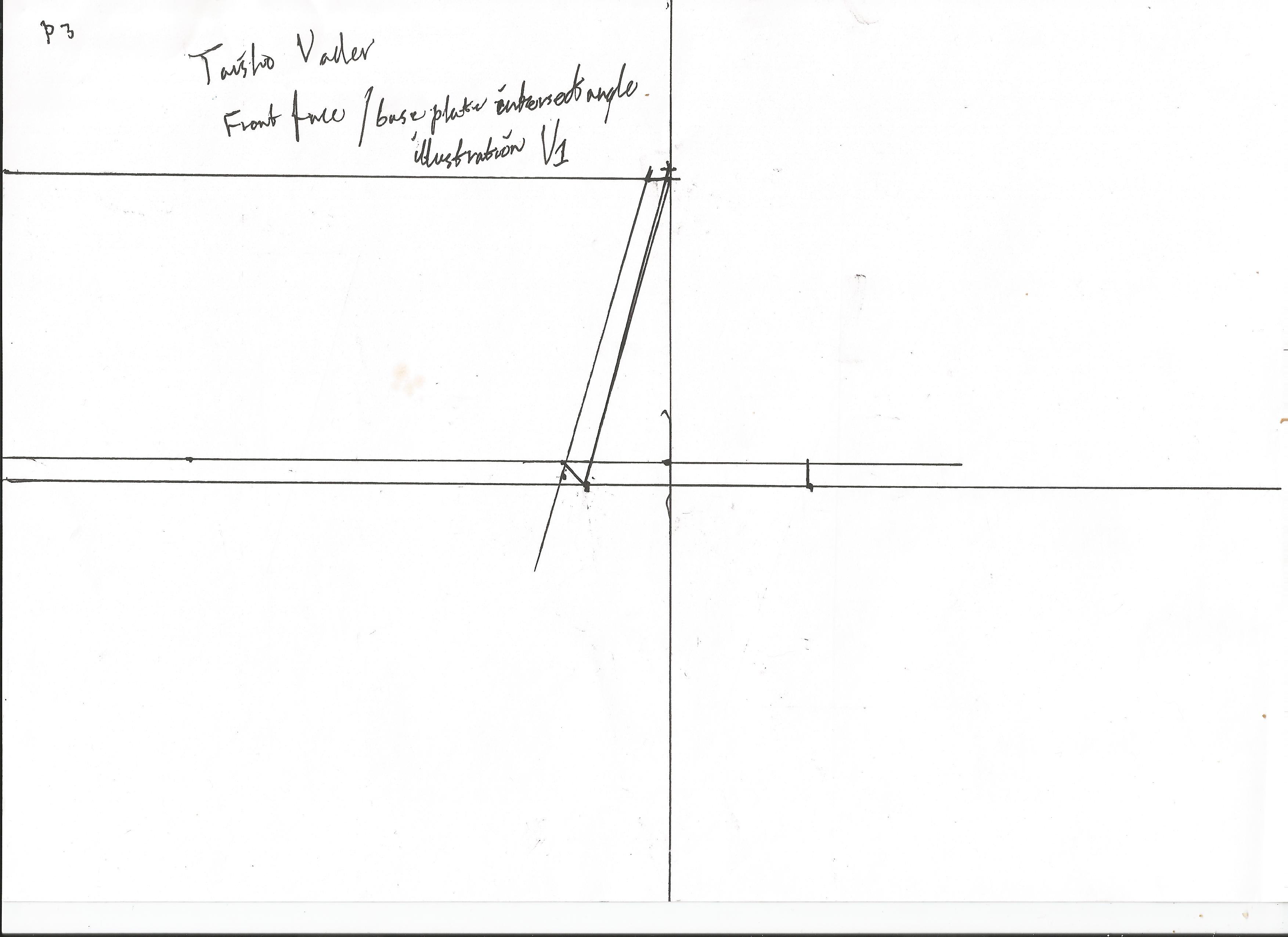

Heres the sketches of all the parts I worked from (unless stated these are A4 at 100%)
vaderplan1.jpgvaderplan2.jpgvaderplan3.jpgvaderplan4.jpgvaderplan5.jpgvaderplan6.jpgvaderplan7.jpgvaderplan8r1.jpgvaderplan9.jpgvaderplan10.jpg Continues after the break ;)

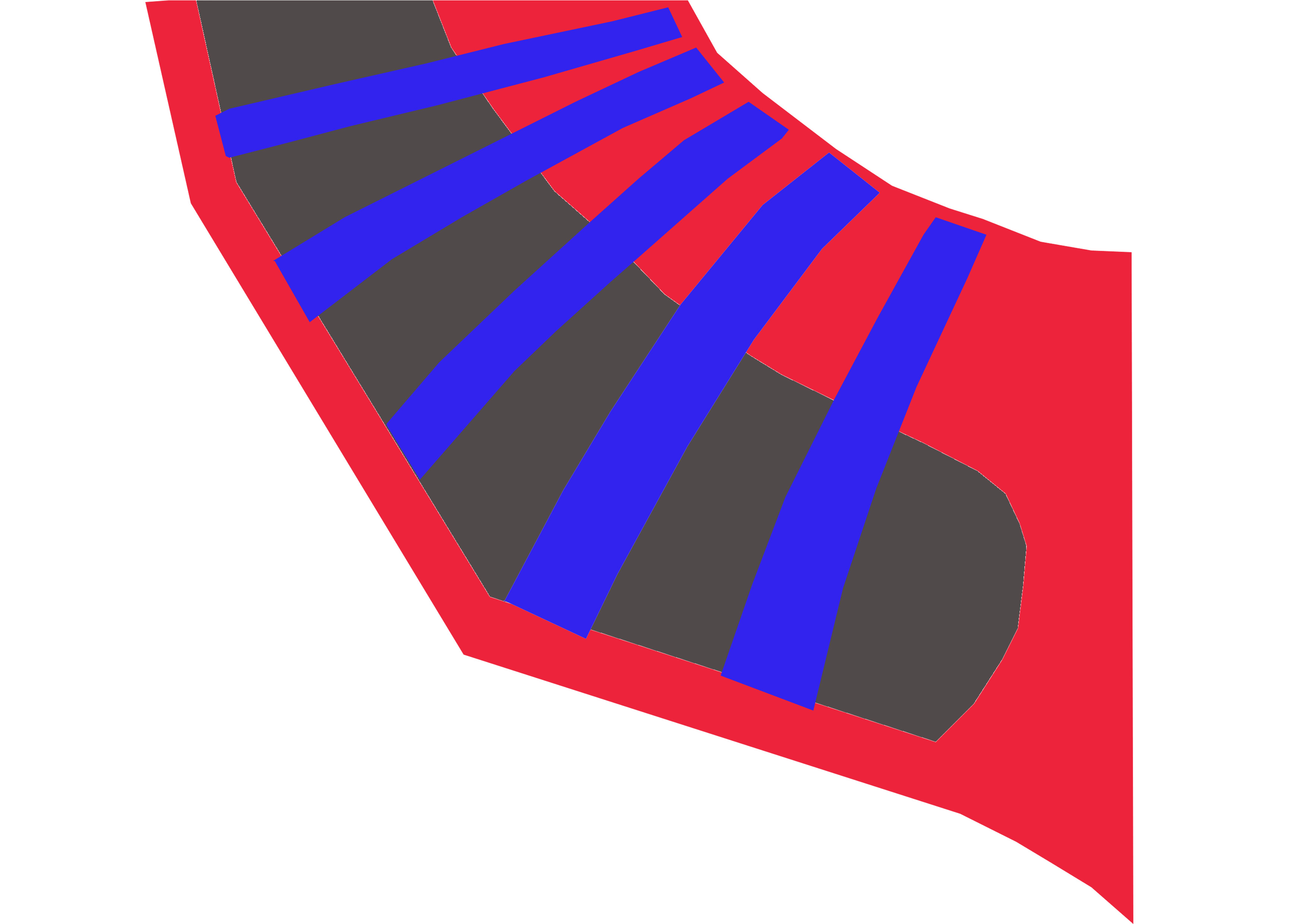

Part2 of the thread:-
Vaderplan23.jpegvaderplan12.jpgvaderplan11.jpgVaderplan24.jpegVaderplan25.jpegvaderplan26a.jpgI seem to be missing some bits, i`ll scan them in later.

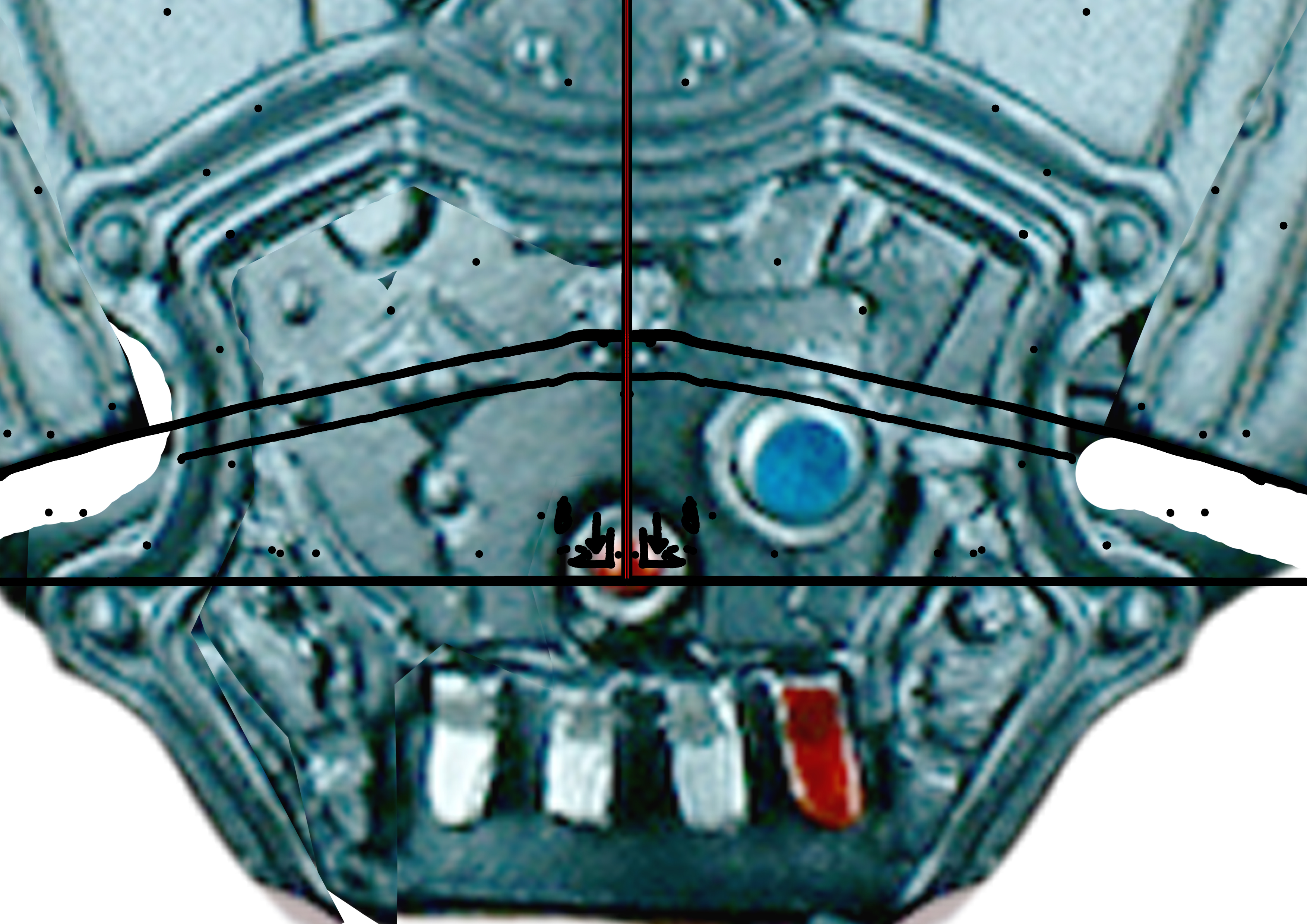

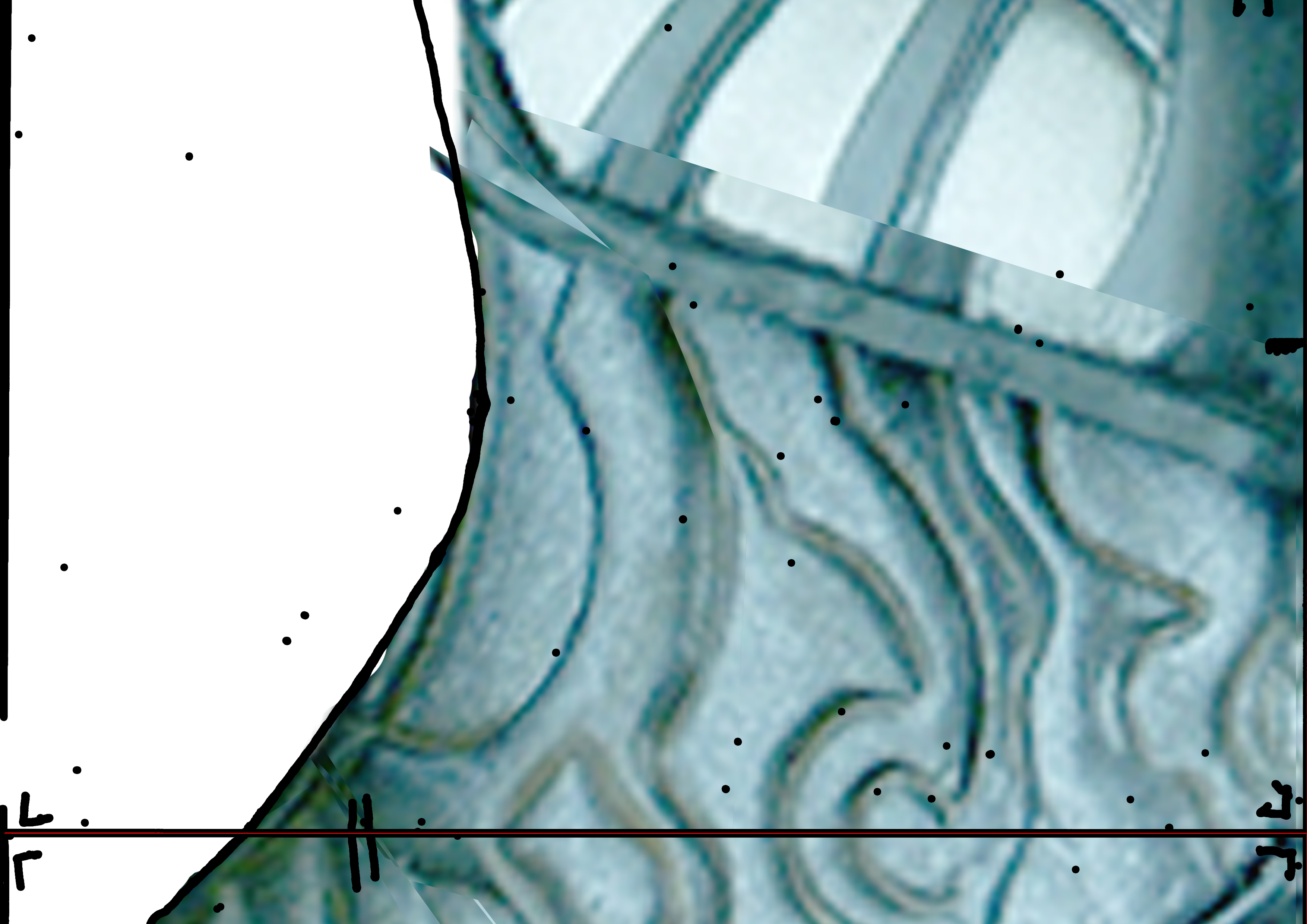

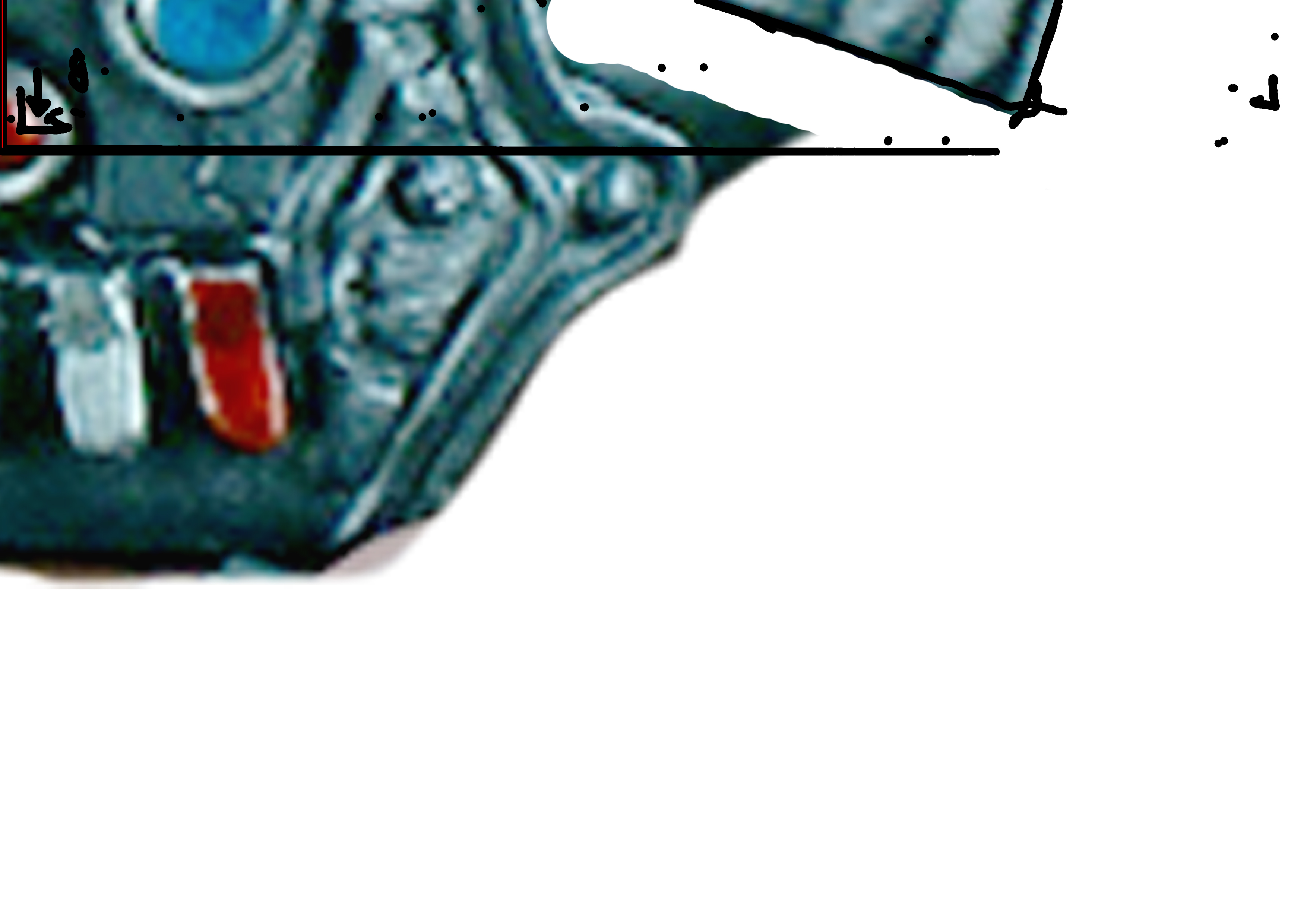

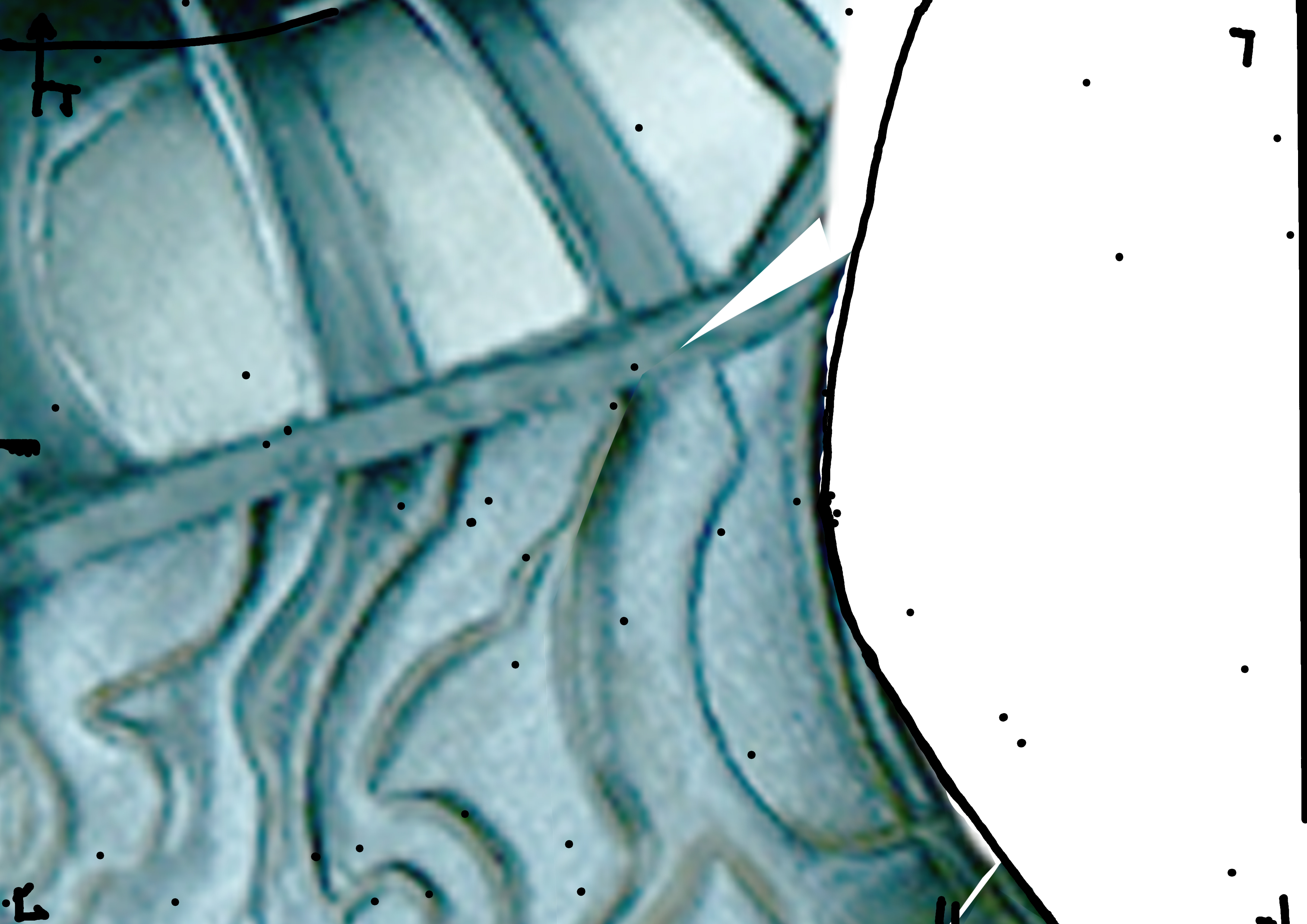

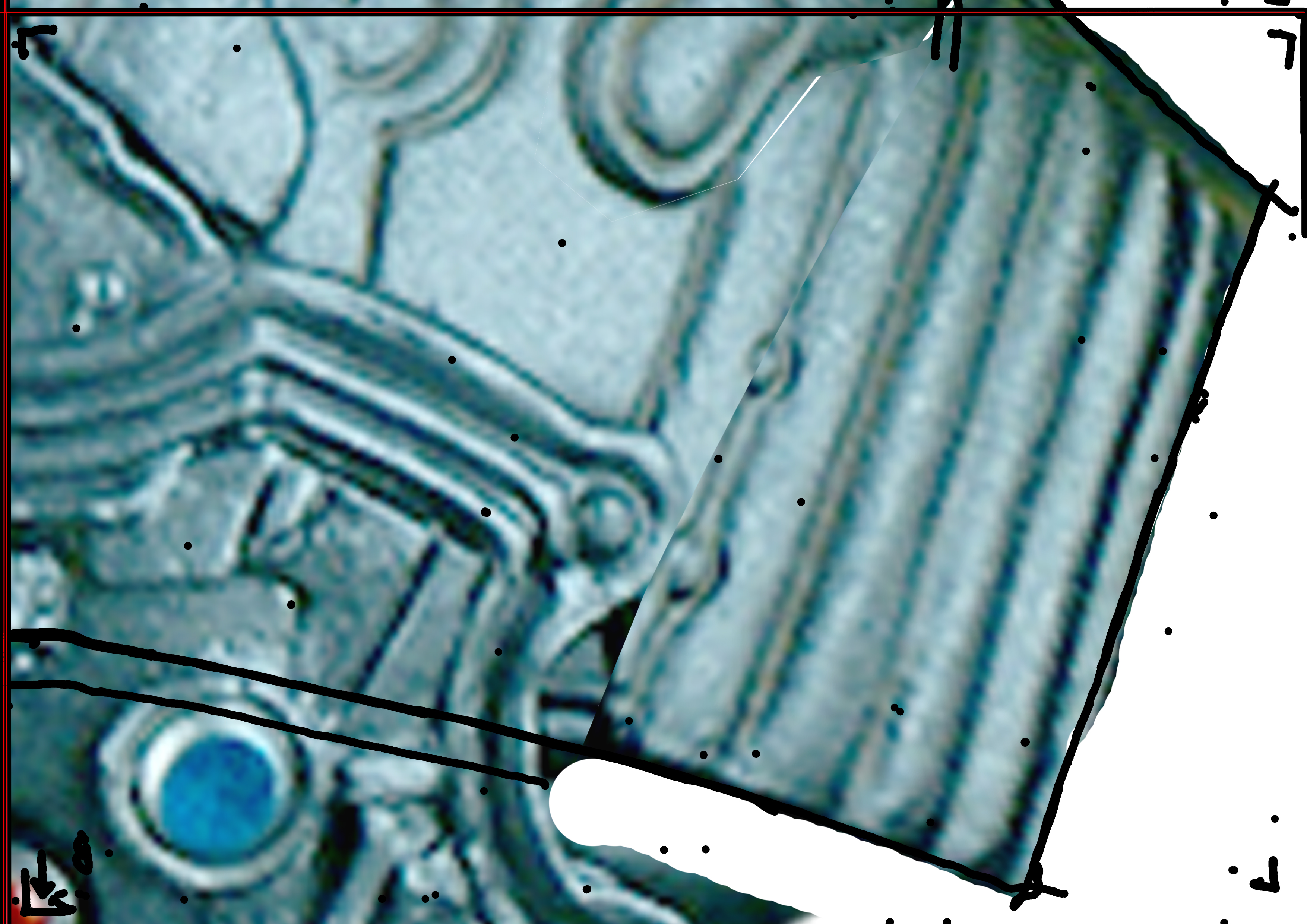

Managed to get a reasonably clear shot of the chest so made a paper template scanned it in then scaled /warped the photo to fit in photoshop 5.1
vaderchest6.jpgvaderchest5.jpgvaderchest4.jpgvaderchest3.jpgvaderchest2.jpgvaderchest1.jpgvaderchest7.jpg
Dremelled the details through the paper onto the foam then went over it with my Heat gun and the rounded end of a Teaspoon, for the Blue and Red "Buttons" on the chestplate used clear rubber balls. One was already a translucent blue, the globe one I used a clear ball halved it and hollowed out then sprayed Red Plastikote into it.

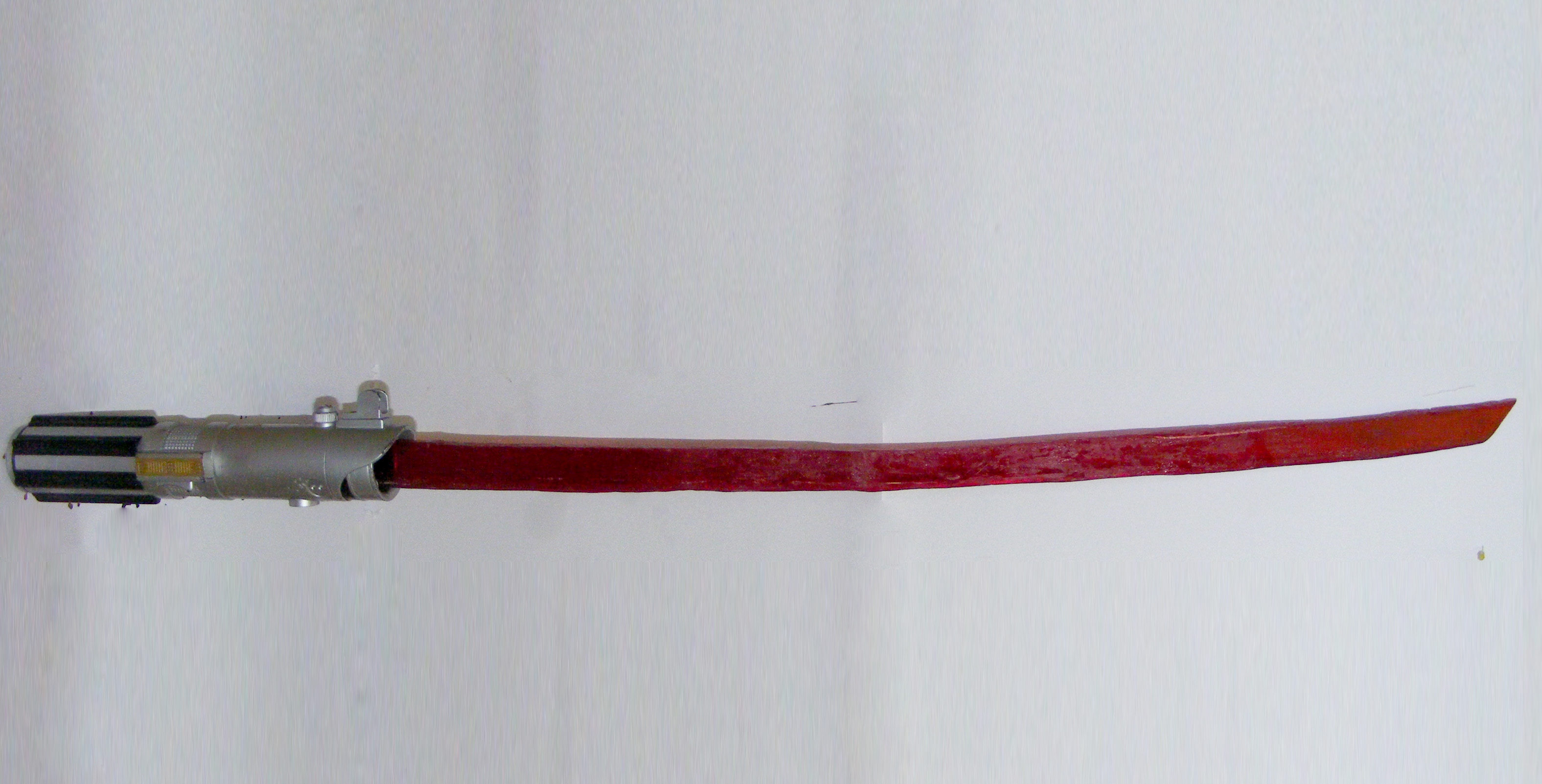

DSCF1117.jpgThe Saber was a sheet of A3 5mm thick Acrylic, made template using my own Metal Katana. Scavenged an old Hasbro hilt (will be making a proper hilt later), was running out of time because I was also doing Naruto in Sage Mode, Edward Elric (both for my son) and Also The Keeper from The Evil Within(for myself for day 2 of the con.
