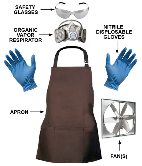

EQUIPMENT
Safety Glasses/ Goggles
These will prevent liquid materials as well as solid ones from hitting your eyes, causing damage as well as blindness. Aside from liquid resin causing permanent damage to your eyesight, spinning projectiles derived from working with your Dremel tool will be deflected.
Respirator
Undoubtedly the most important piece of safety equipment. It will not only protect you from vapors, but particles as well.
It is important to get a NIOSH rated respirator, such as the 3M 5000 series. Model numbers are 5101, 5201, and 5301. These respirators also feature detachable particle filters that attach to the main vapor ones.
Disposable Gloves
Nitrile gloves work better than latex gloves because they are less prone to tearing. Vinyl gloves are also better than the latex ones for the same reason, but do not hold up as well as the Nitrile ones.
Protective clothing - apron or Tyvek suit
If you've worked with the aforementioned materials above, you know what happens to your clothing and shoes when this stuff gets spilled on them.
An apron is easy to put on, and will protect against most spills. A long sleeve shirt should be worn to avoid exposing your arms to these materials. The best protection can be had by wearing a Tyvek suit which is a head-to-toe lightweight white material.
Adequate Ventilation
Depending on the size of your work area, you will need to have a fan, or series of fans positioned in the wall or in windows to suck harmful vapors and particles out of the room.
A simple way to judge if you have enough suction in your ventilation set up, is to turn on your fan(s) and close the door to your work room. take a small amount of baby powder and sprinkle it where the gap is between the bottom of the door and the floor. If the powder is drawn in, you have enough suction.
