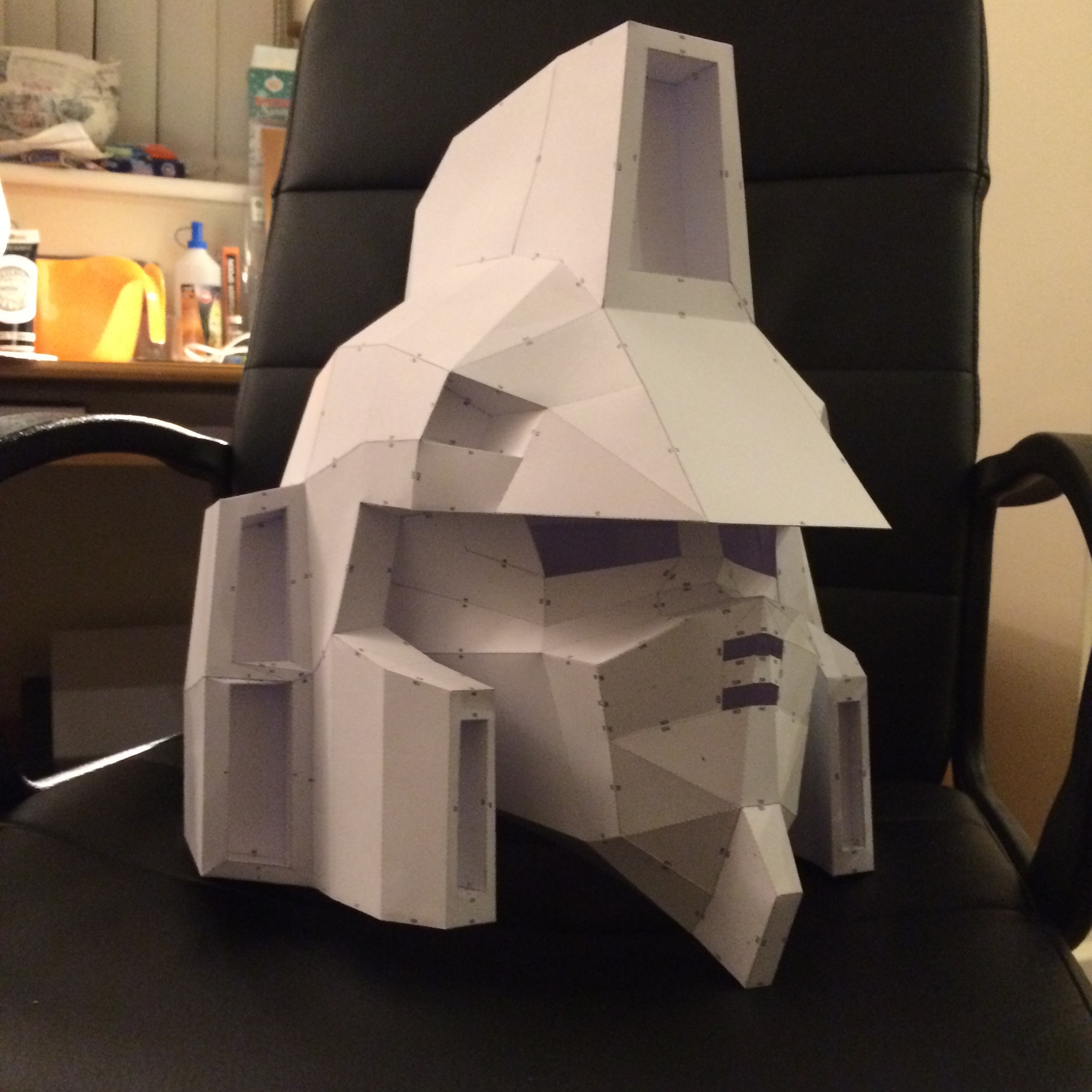

Its been some time since I updated this thread.
Have finished the resize of the helmet
The size is now perfect but there are quite a few problems that I have noticed that need to be fixed.
1. The front peak should be curved and not flat.
2. The large vents at the side have the wrong details.
3. Smaller vents have are not angled correctly.
4. The very top is the wrong shape from front to back.
5. The front mask is the wrong shape.
6. The indents in the front of the peak are the wrong shape.
7. The indent in the back is the wrong side.
Just a small list lol.

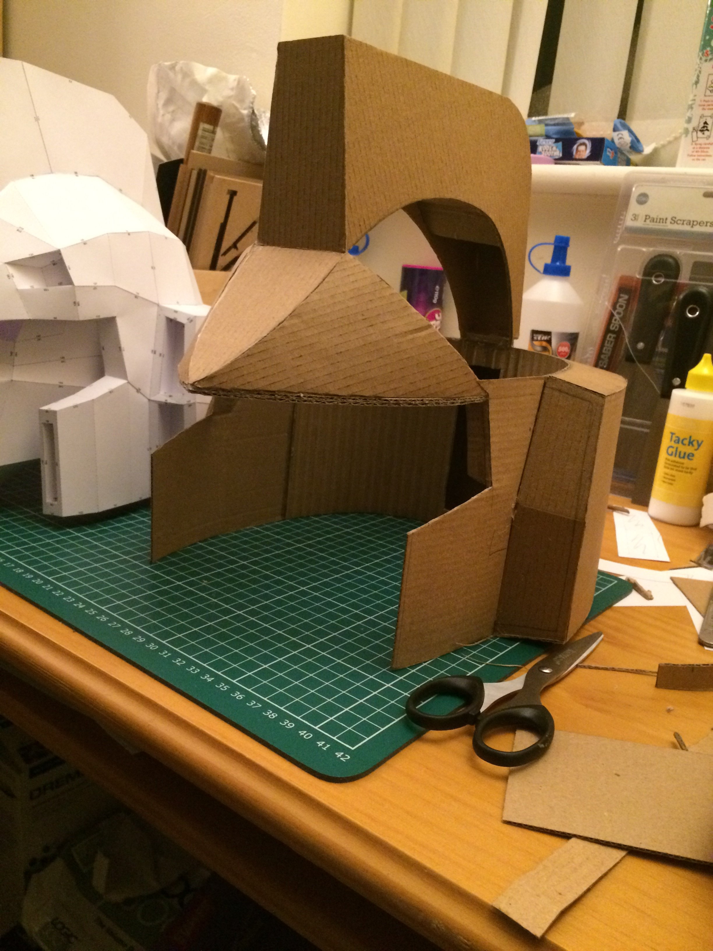

I have now decided to completely redo the helmet from the ground up from cardboard. I will be using the pep'd helmet for my measurements and will see where it takes me.
It may take a while as I can be a bit of a perfectionist sometimes and tend to redo a lot of parts multiple times.
Thanks for looking and will update when I have some more progress.
Not had much time to work on this but I have got a little way in making the helmet again
Just trying to work out the best way to do the dome on the top and will be putting all the detail in at a later date.
Let me know what you think.
Any criticism is welcome as it helps in the long run and the more help the better :D
There's something about the eyes - they look like they're on the same plane as opposed to wrapping around the inner head (head curve, so to speak). I think the key of Gundam's structure is that it follows the Samurai helmet. You have the outer helmet, but the mask over the wearer.
The one in the right of this image might be wrapping too much, but you get the idea:
https://i.ytimg.com/vi/nFlXMUsco0U/maxresdefault.jpg
Thanks for the reply, was kinda wondering if anyone was interested lol.
I think I get what you mean lol, the white helmet on the left in my pic was just for a reference and I noticed a lot that wasn't right with it. I using a MG 1/00 kit and hopefully it will look right. The eyes and front mask will wrap around. The cardboard helmet that I'm making now still needs a few tweaks as with the sides it needs to come in a bit more, but that will be fixed ;).
Also, stand back at least 6 feet when photographing. Up close, there is perspective distortion, and that may be throwing off some of the proportions, such as the big vent on the center crown and forehead really large.
I'm glad you captured the double "^" shapes for the mouth. It's subtle but it makes such a difference.
