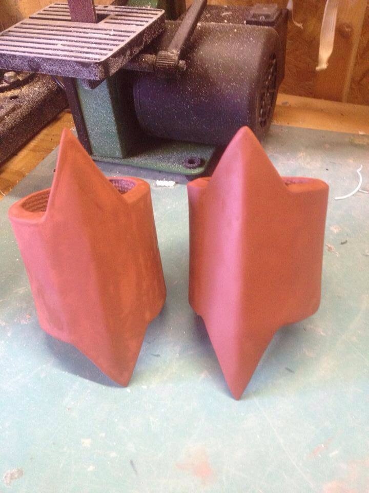

Now time for the plastic coating part! I coated the gauntlets with a thick coat of PVA glue and then i coated three coats of smooth cast ONYX. In between coates i sanded the high spots from the resin.
Now time for the sanding filling. I gave the gauntlets a first thin pass of spott putty and then some primer and rinse and repeat
So far one gauntlet is close to being finish. Tomorrow ill be doing the sand and filling process. And hopefully the day after ill be able to paint them.

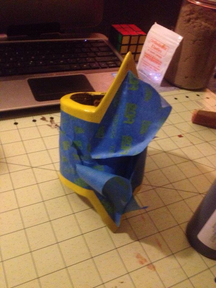

Now its time for paint! I coated a base coat of yellow adding the black outline with acryilic paint

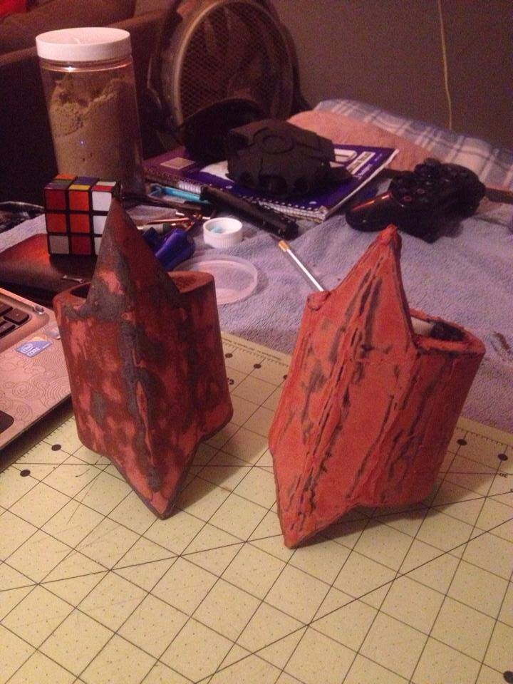

And then added some weathering with some black and brown paint and the clear coated the gauntlets.

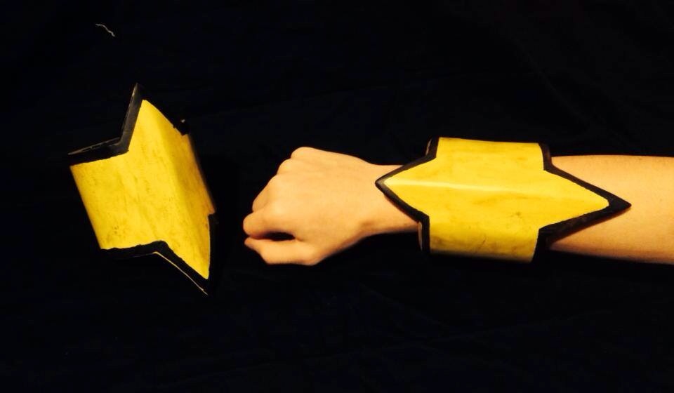

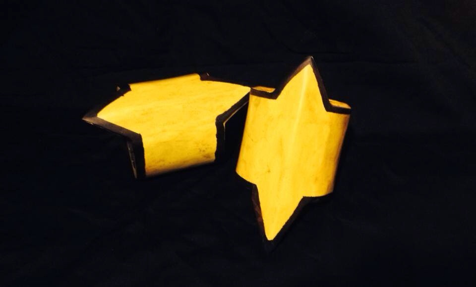

RWBY yellows gauntlets final
