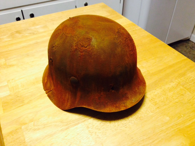

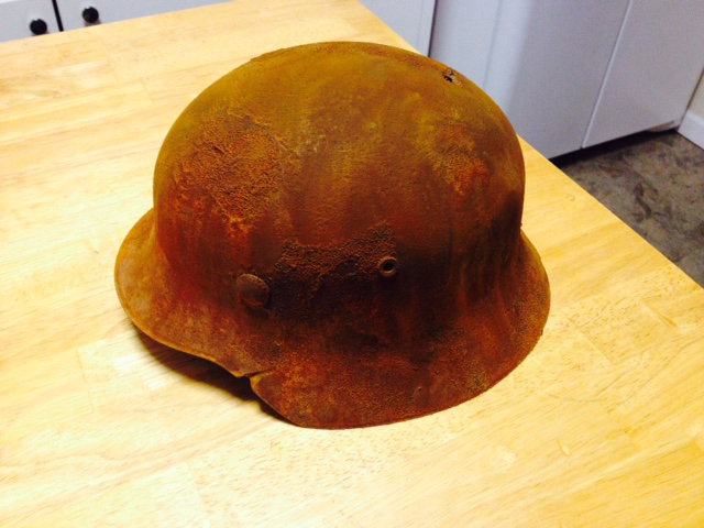

Here is the first actual project test with this paint system.
I forgot to take any before pics, but it was perfectly smooth plastic German costume helmet painted a greenish/grey color.
The first 3 pics are after distressing with various tools, spray painting with numerous colors of paint and spray gluing sand in random areas.
The next pic is with the first coat of the 3 part paint (primer) applied with a sponge, to achieve random effect.
The next 2 are after the iron oxide paint was applied, the 2nd one after drying
The last 3 show the finished helmet about 10 hours after applying oxidizer. It probably didn't take that long, but I was at work.
So I know this is a very simple project, but I wanted a quick way to test this before trying it on a few larger projects I have in mind.
