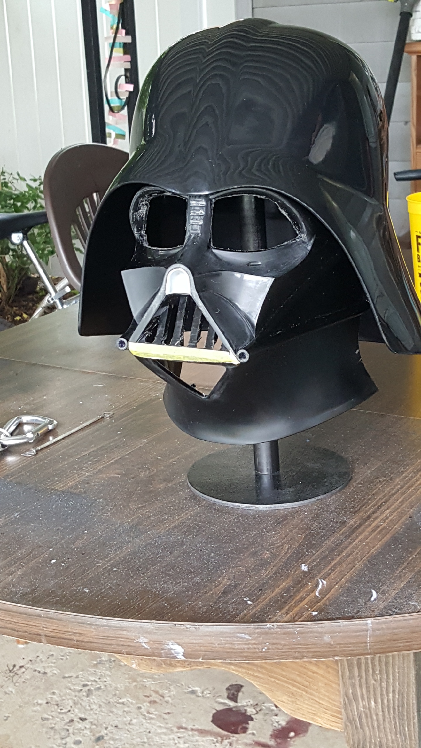

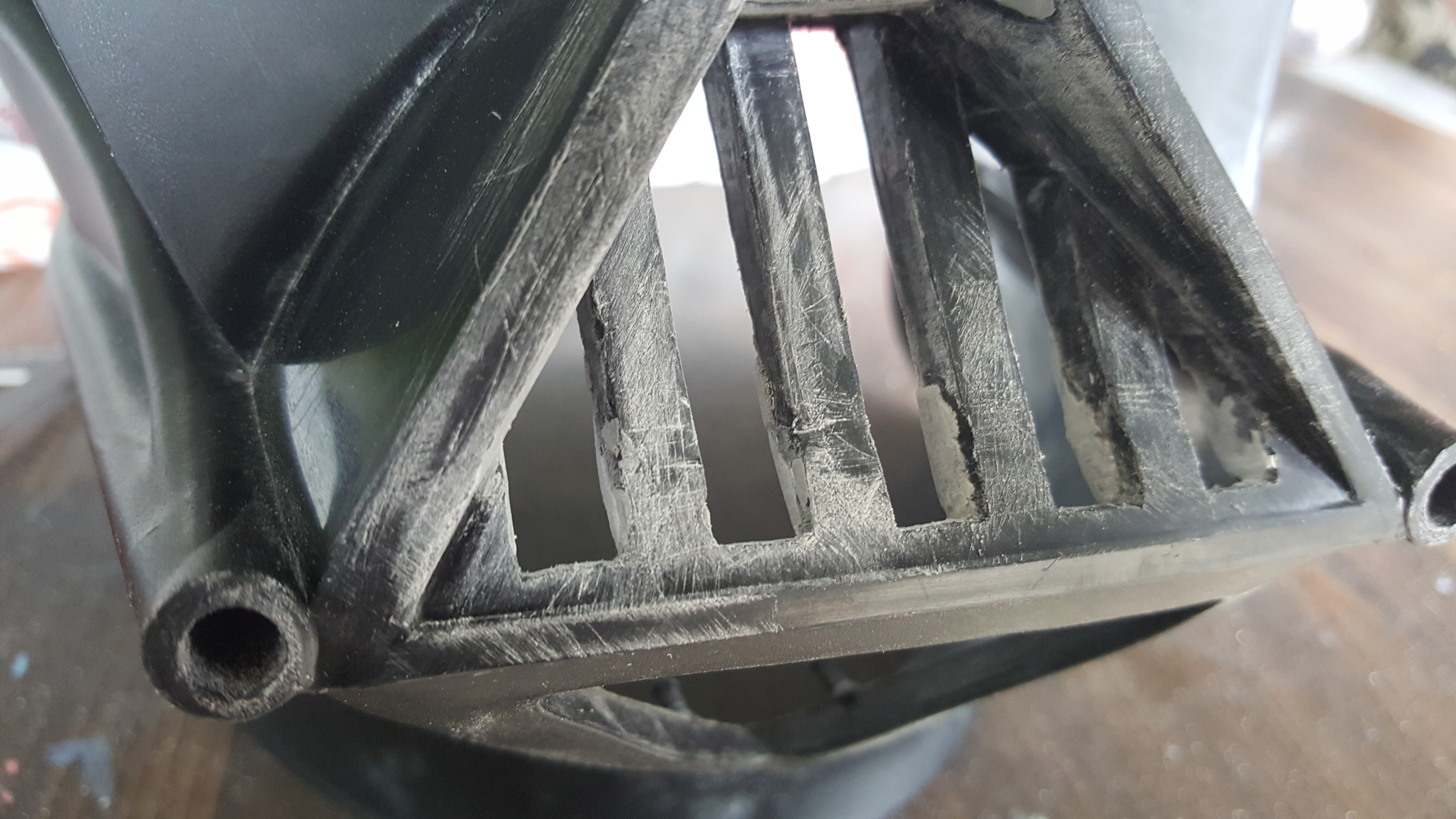

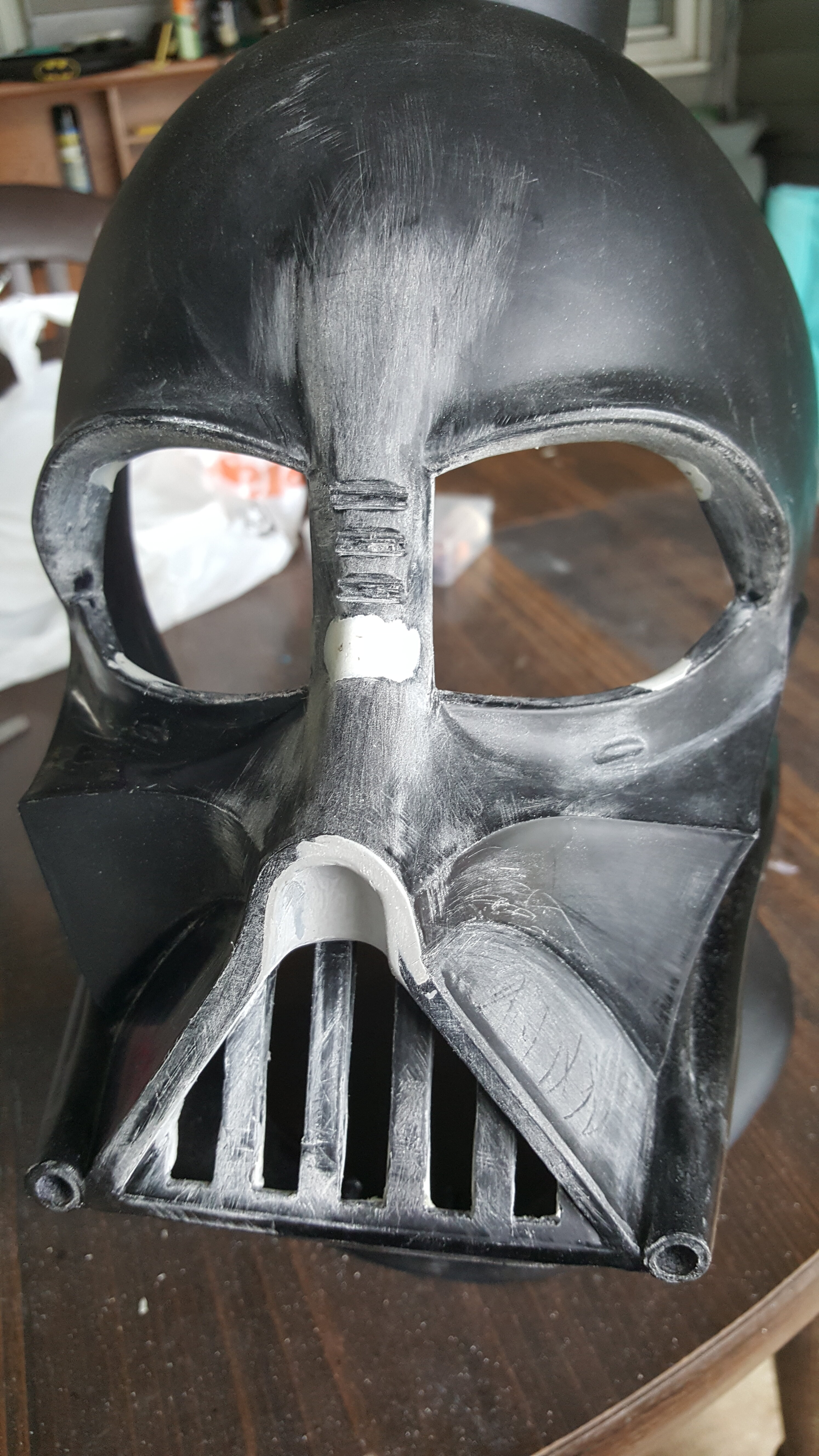

Against my better judgement, I've decided to attempt the dreaded, and according to some, pointless Rubies Supreme Vader restoration.
I say, why not! :)
Some pics to start.
Already removed the eyes, and the grill.

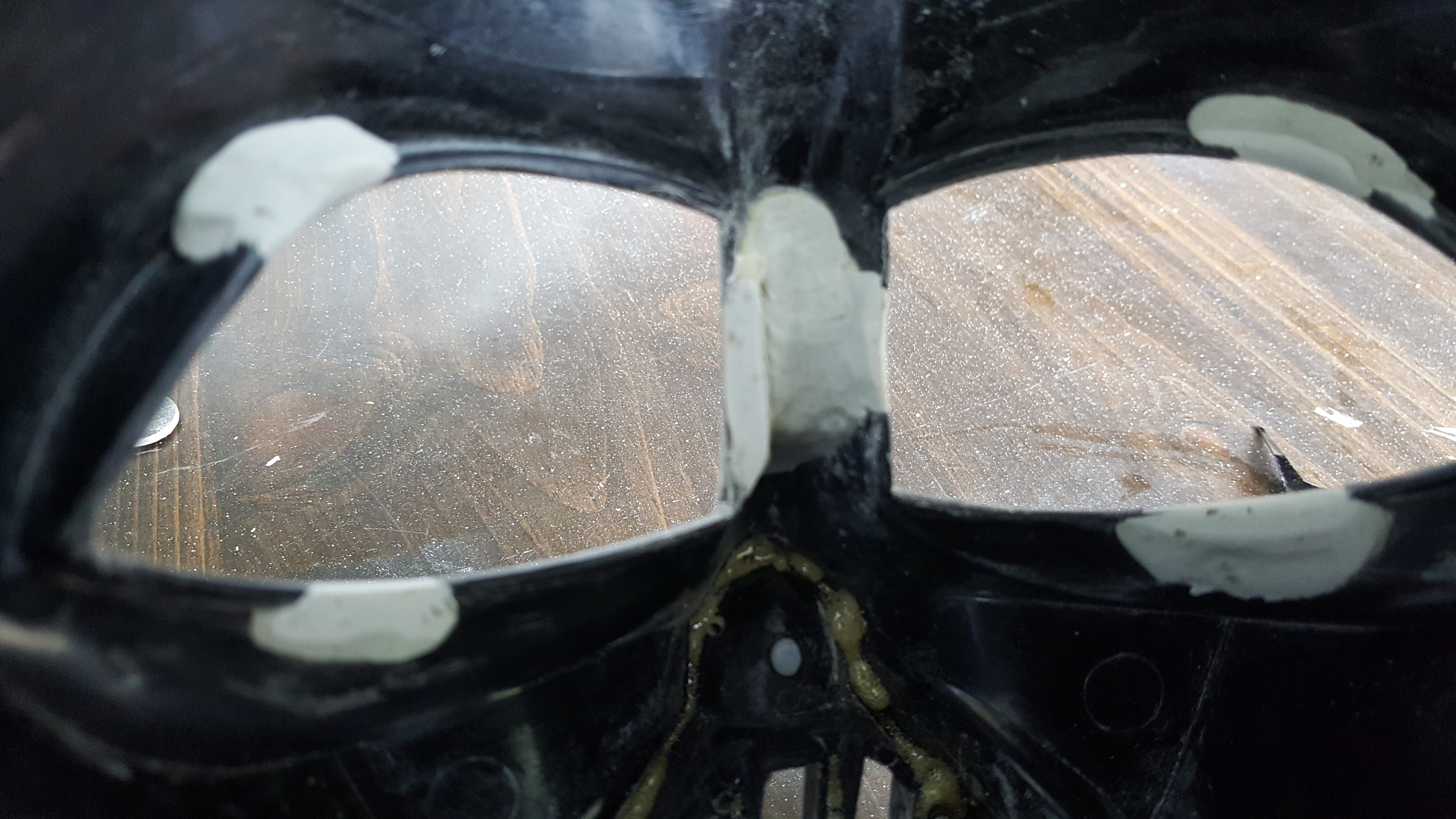

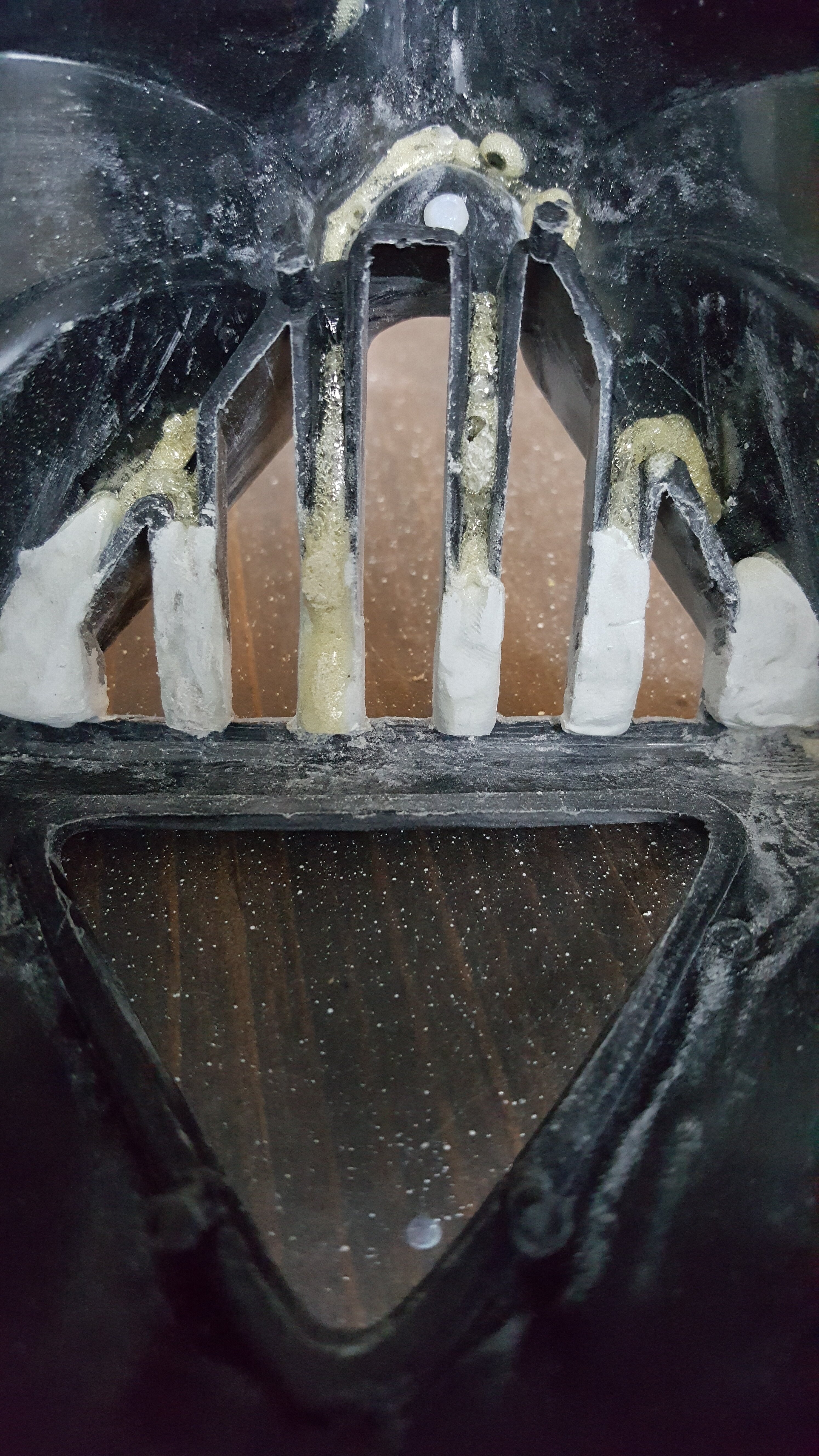

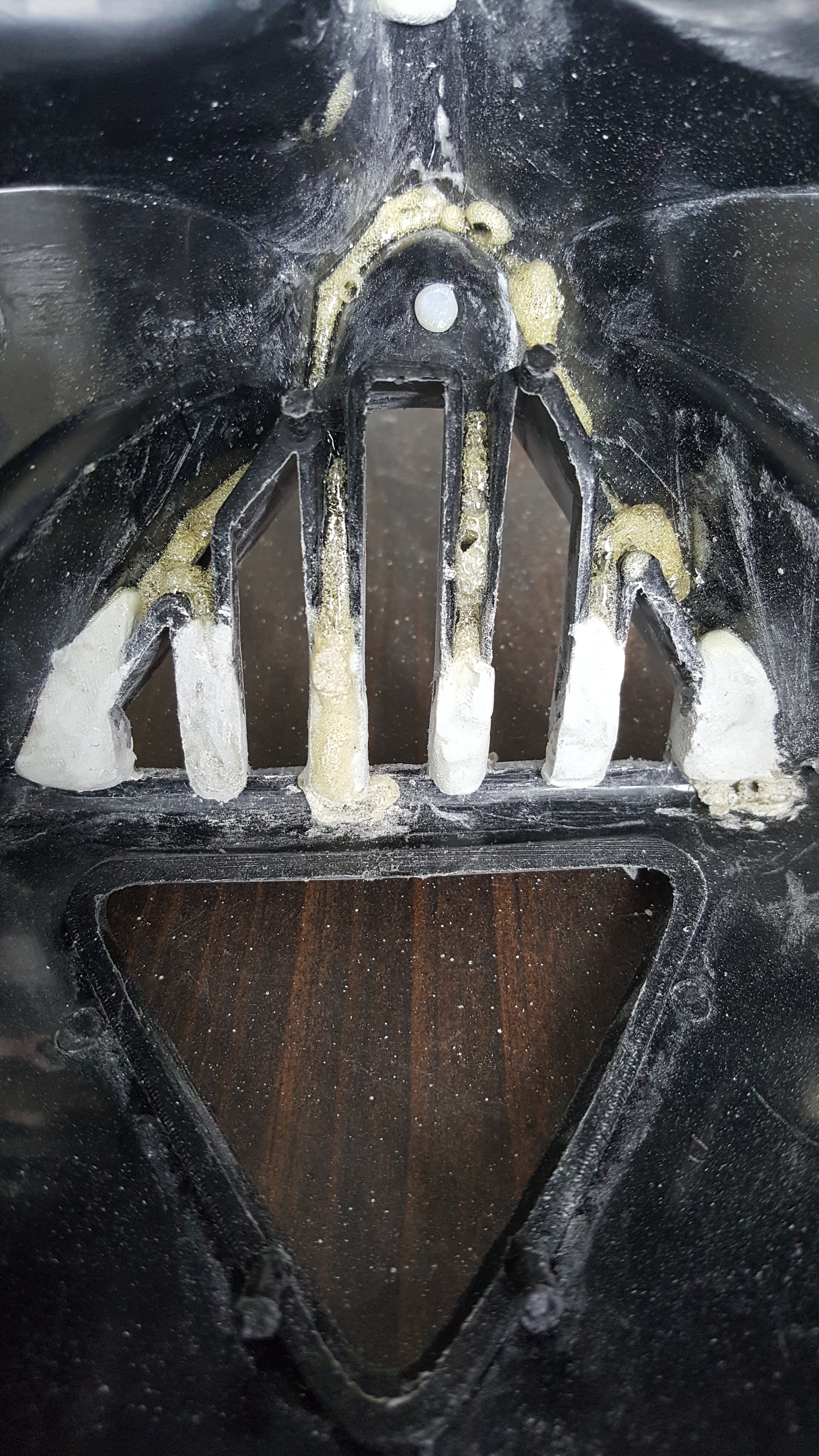

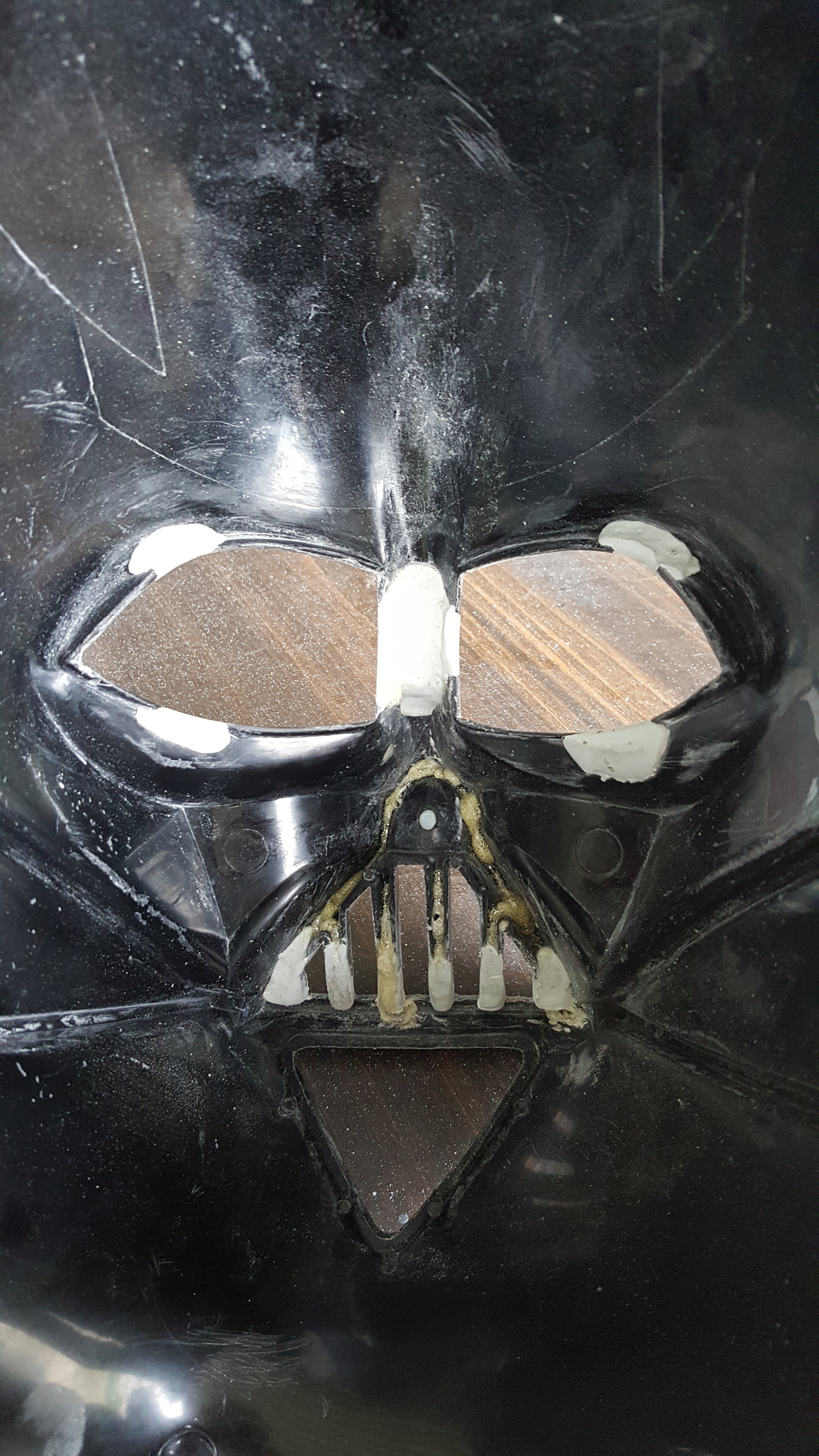

Dremelled out the eyes , and the lengths of the grill.

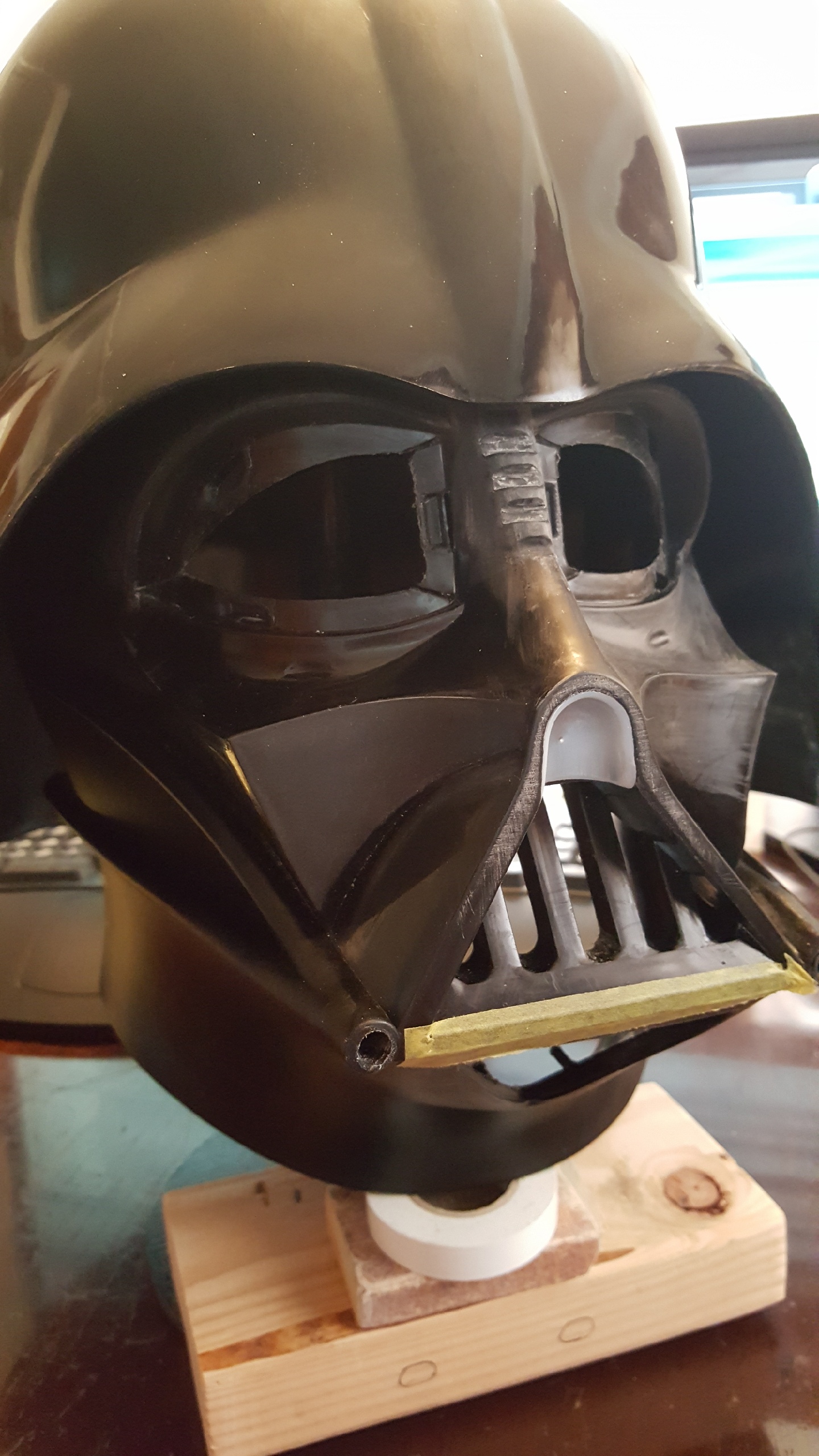

Bondo'd in the notches in the eye sockets, added the remaining lengths to the backs of the grill slots, and filled in the 4th nose slot, and the front of the nose cap.
Also filled in the nip on the top of the dome (not shown).

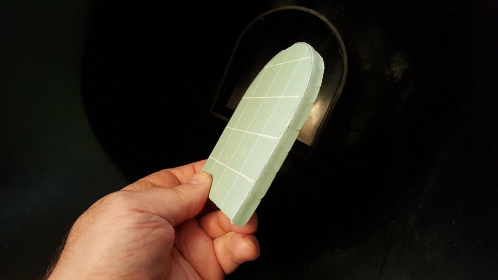

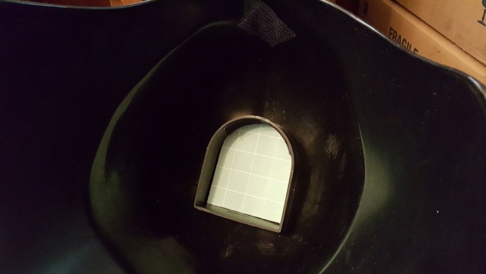

Installed a temporary sized insert to correct dome placement. A permanent plastic one will be hot glued in here soon, and after painting, will be applying industrial strength Velcro to the insert, and on top of the horseshoe on the mask.
Will be correcting the neck flange, and then finishing final sanding everything smooth, to be ready for the auto body shop to paint.
Waiting on the complete Vader insert and parts kit from Fenixprops.
More to come.
Sorry if the pics aren't in correct order.

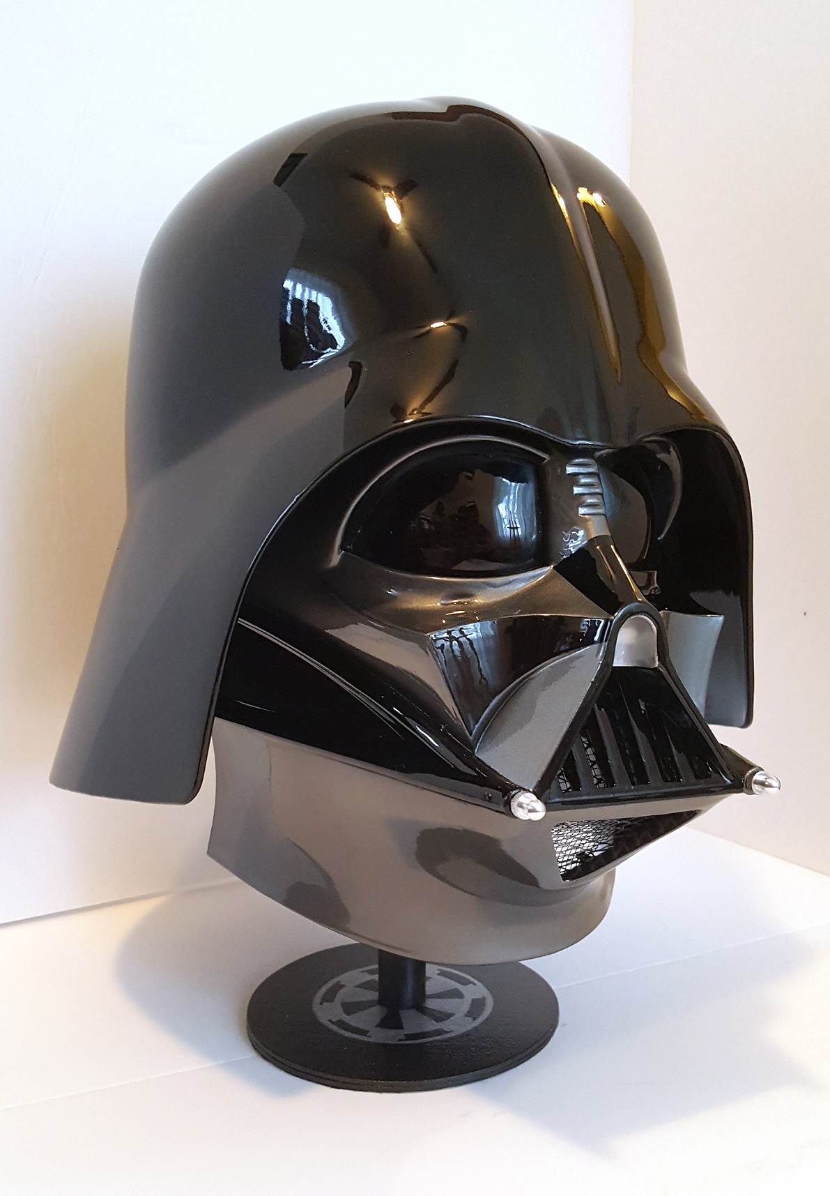

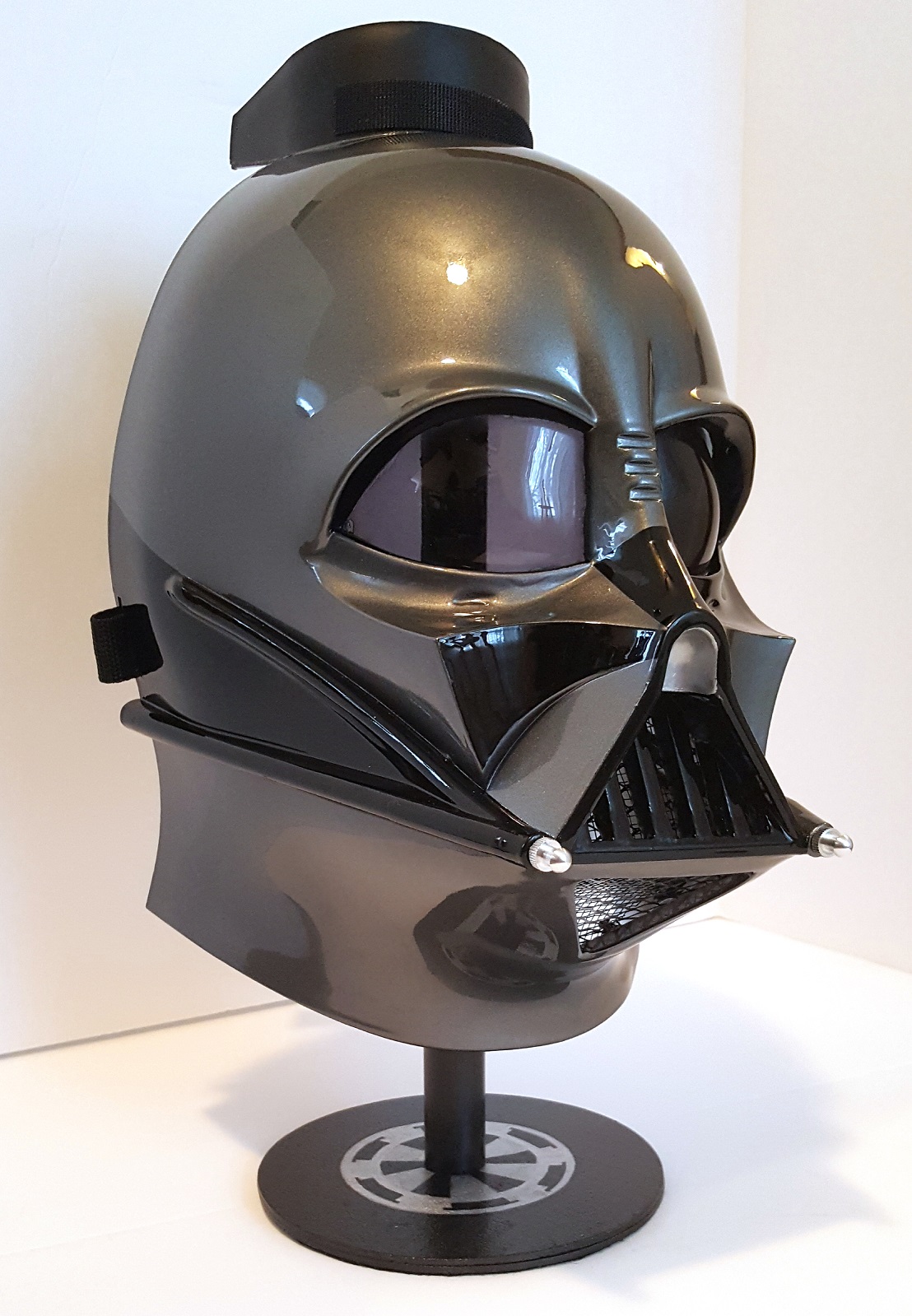

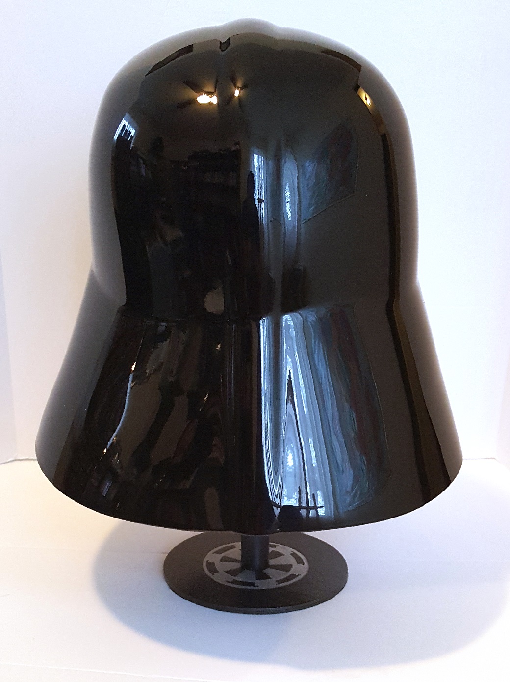

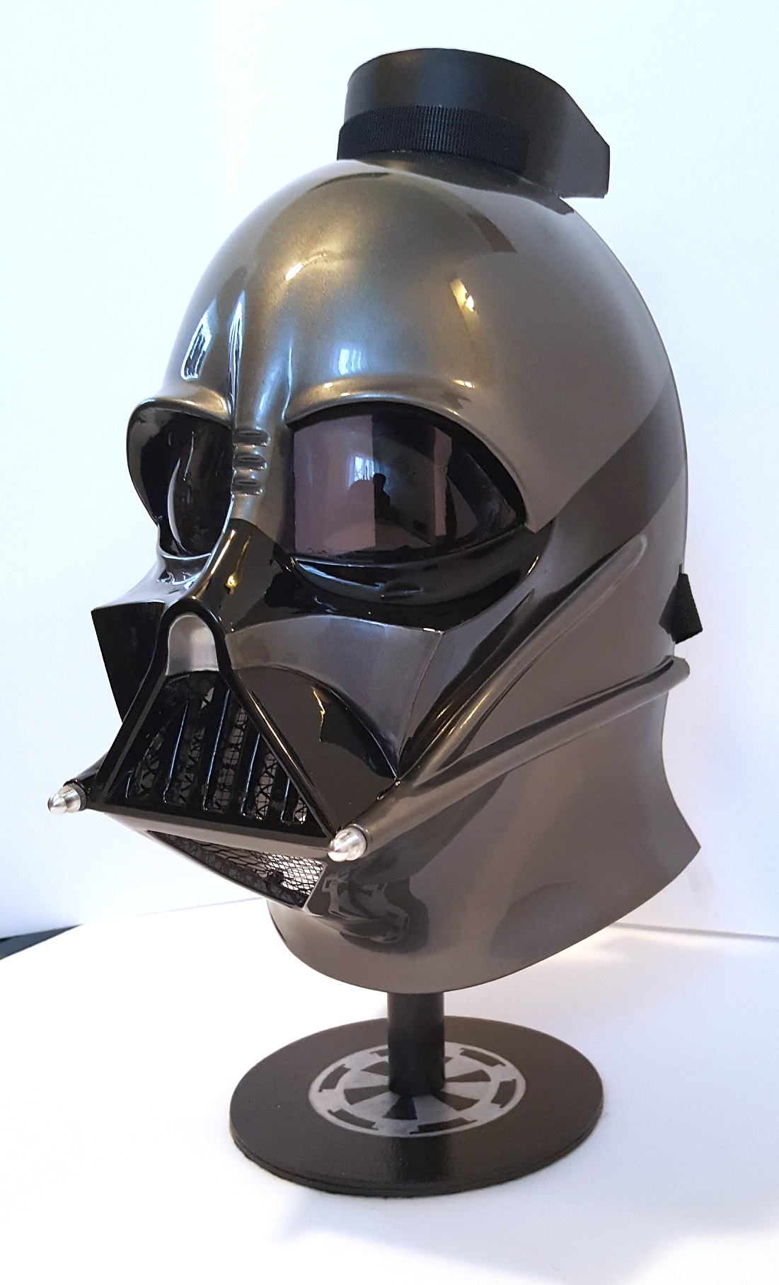

All is done.
Enjoy!

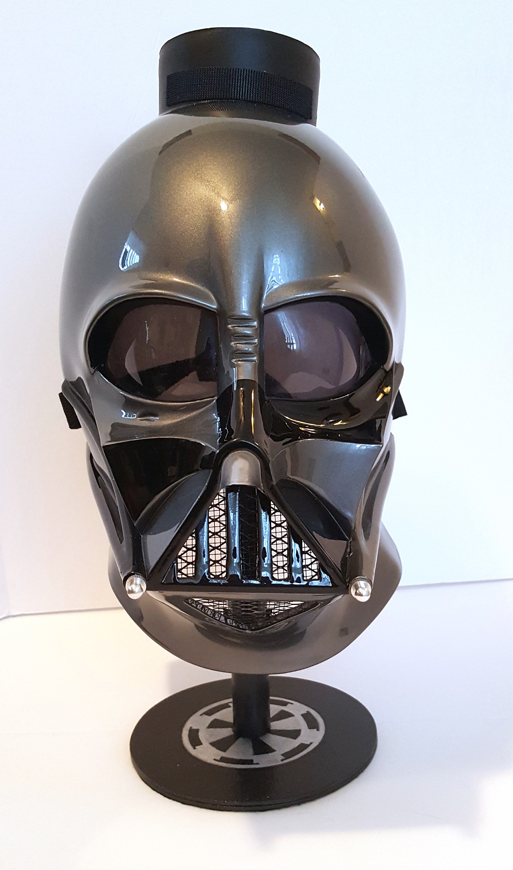

Here is the whole thing done, after the paint job I had done at local auto body shop.
Standard gloss black, and an Audi gunmetal ( i forget the actual paint code right now...lol )
I had to tape out the face where the gunmetal had to be sprayed over the black.

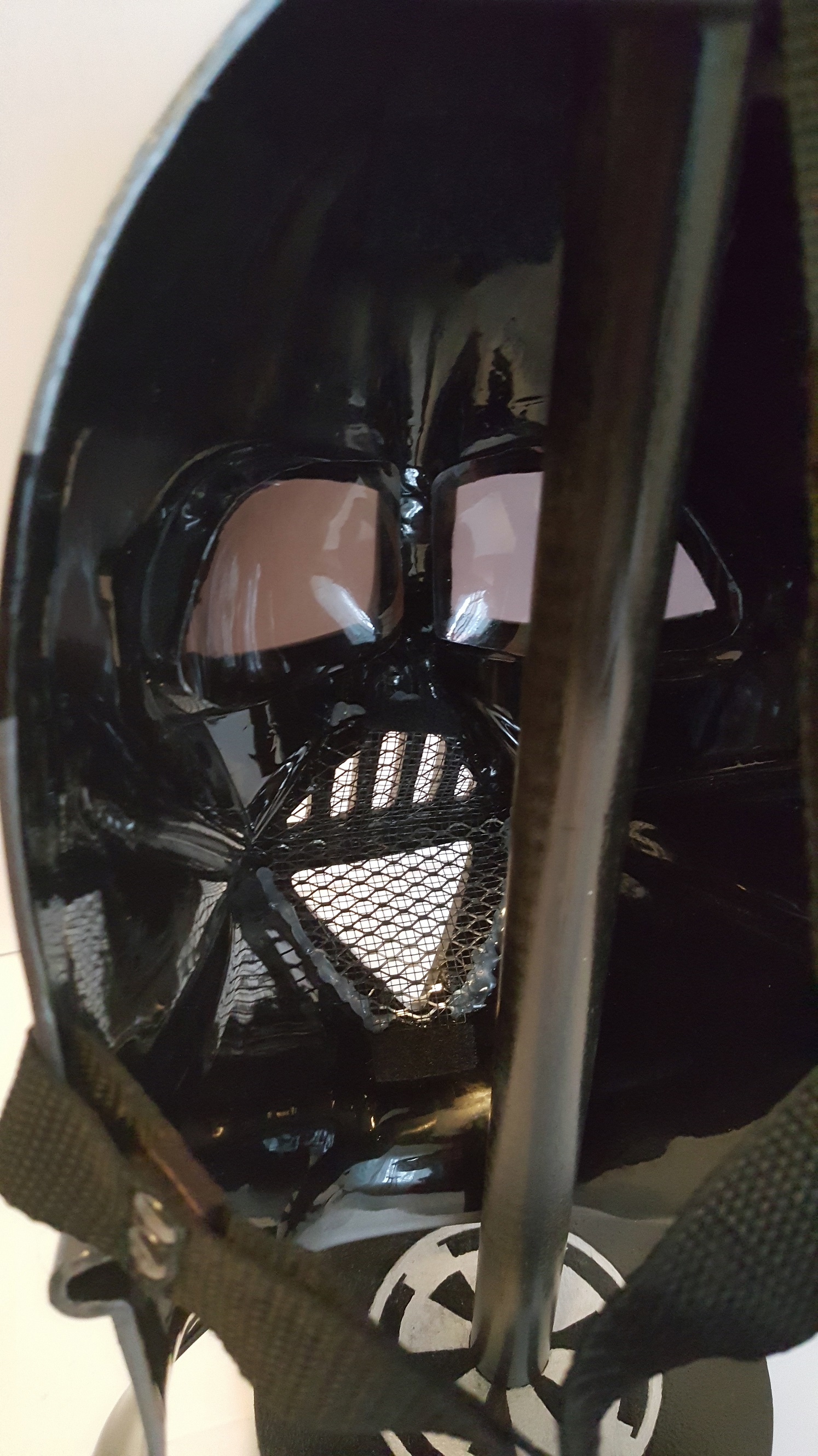

Lenses from OLEProps in Germany and metal tusks from Fenix Props in Argentina.
The lenses took some careful dremelling, as they come WAY over sized ,but the actual bubble to them is perfect, and see through them clearly, but they don't reveal you inside.
Mouth grill from a regular STP auto air filter, and cut the mesh out to fit.
Top grill mesh painted black. and bottom half left original metal.
Hot glued them in place and placed a black plastic window screen mesh over both of them and glued in place.
Added a new small strip of the hook velcro to the horseshoe on top of the face, and another hook piece inside the cup of the dome.
Didn't want TOO much attachment.
It made it WAY too hard to get the thing positioned, or off, for that matter.
The two hooks create just enough friction and close the space enough, without too much problem.
Reattached the original head band, but used leather spacers with better pop rivets to hold in place.
Custom stand by me. : )
This was given by me to my brother in law for a Christmas present, so I no longer own it. FYI
