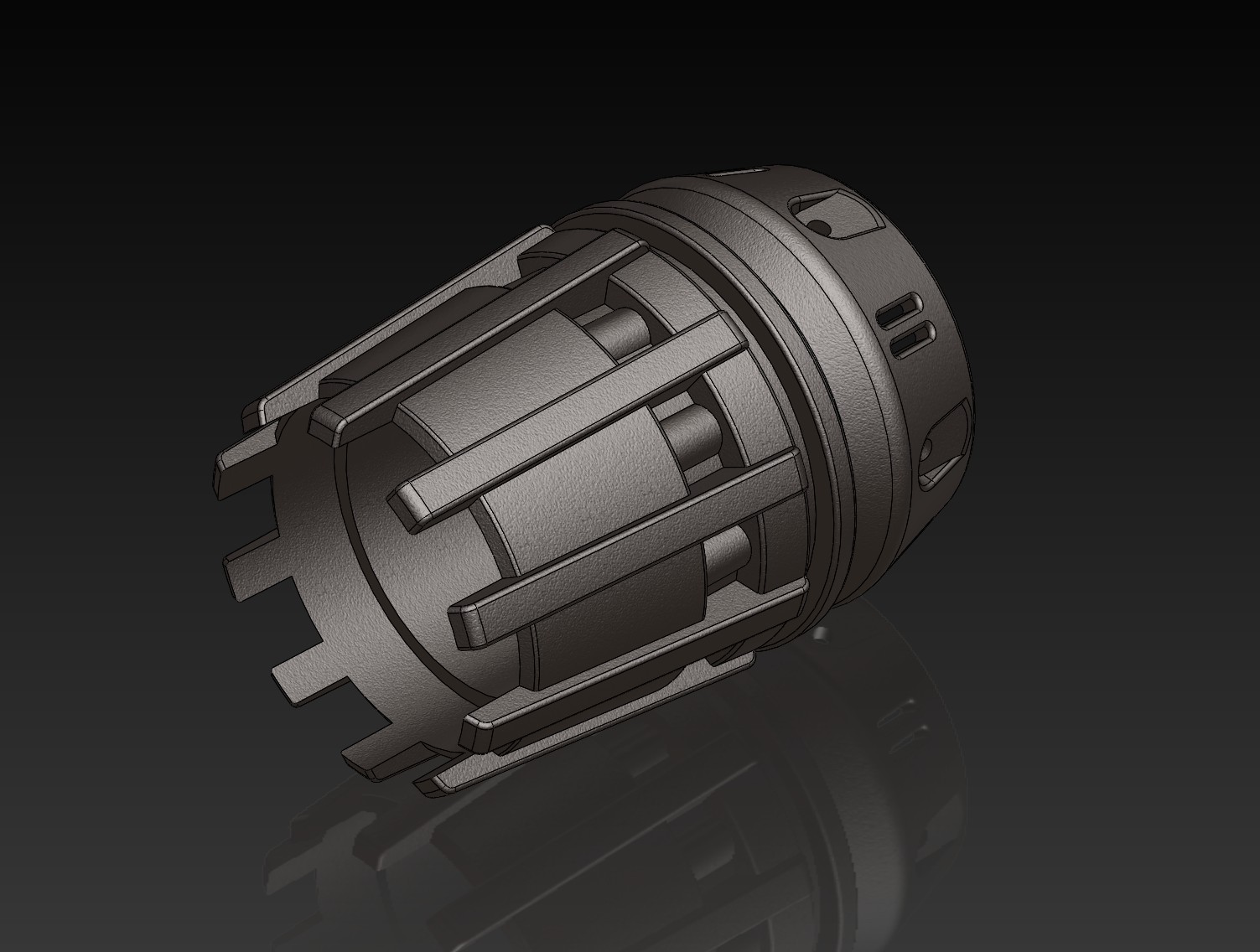

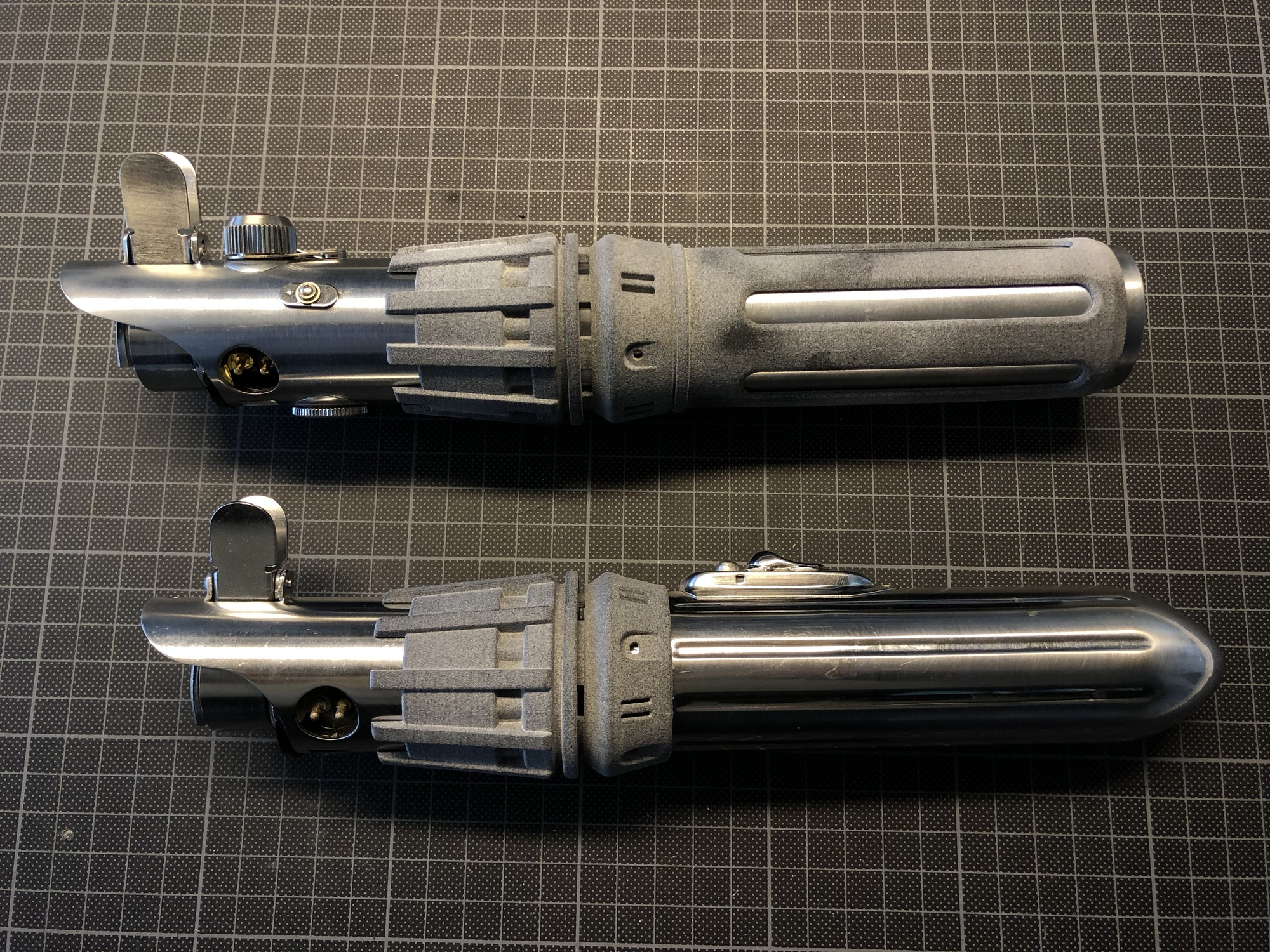

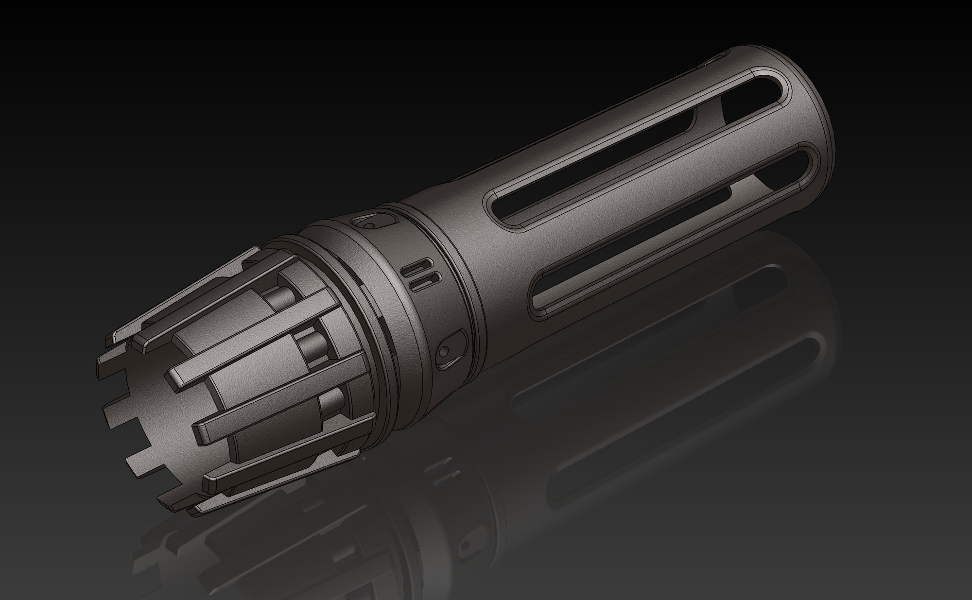

Based on my sketch, I then started to 3D model the connector element. I couldn’t decide if I wanted to re-use the lower Graflex halve or the beautiful Ray-O-vac as a handle, so I designed a connector for both and had these 3D printed.
I chose to 3D print these with the amazingly detailed, strong and affordable HP Multi Jet (in Belgium, with Materialise) in PA (nylon). The parts came in after a few days and were very nice indeed. Here’s one part, the flashlight a small satellite Graflex.

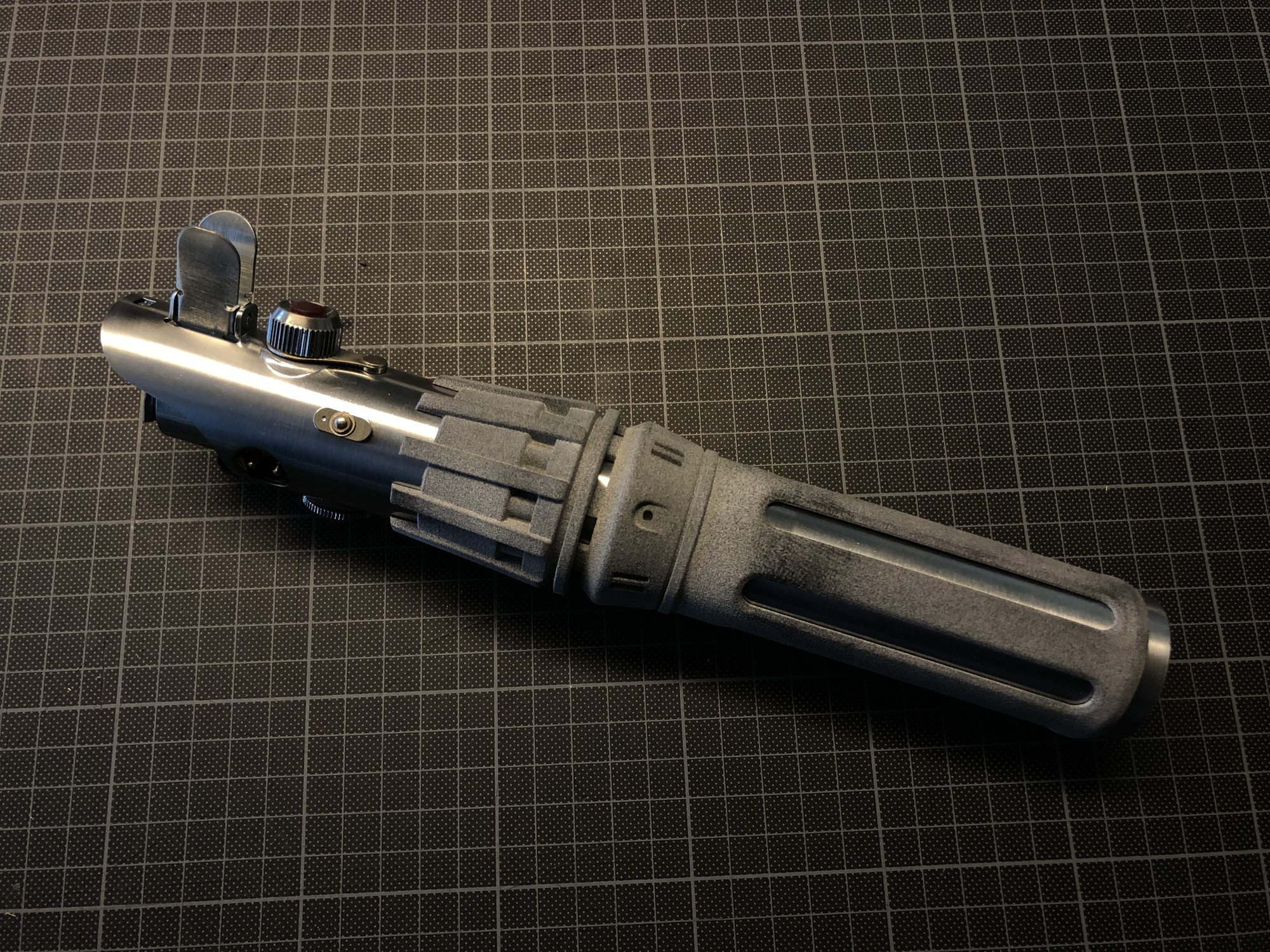

I started with the Ray-O-vac – 3D printed connector part combination, but I later did the same with the other connector part that I used in the final saber. After a first layer of primer, I spray painted it with Rust-oleum textured Desert Bisque and let it cure overnight. This stuff is amazing. It took away all the visible 3D print layers and didn’t require any sanding before or after.

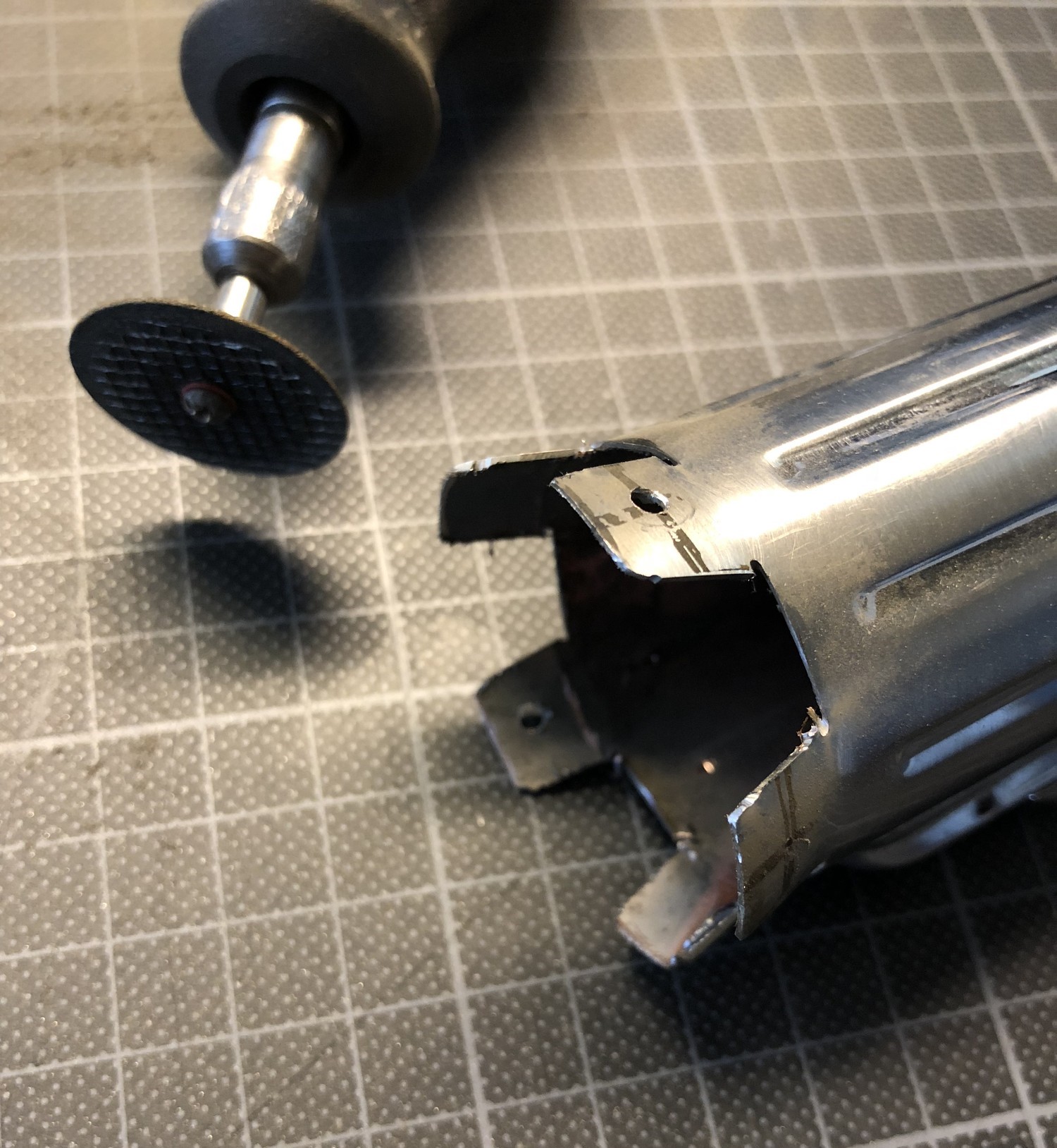

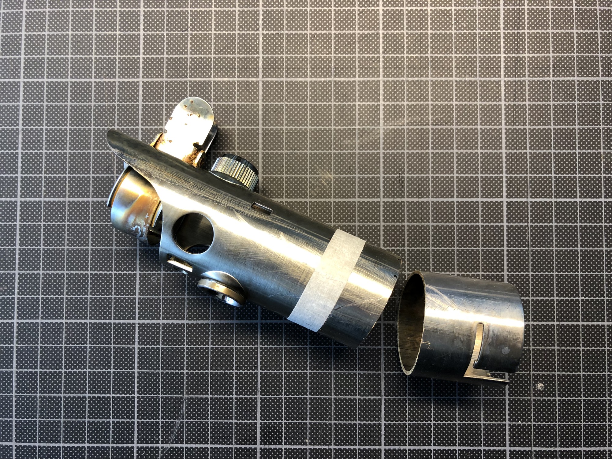

After that, I chopped off a piece from the Graflex top and later I sanded, scratched and did a lot, to expose some brass here and there to get the patina I wanted. That took some time.
I didn’t have an 89sabers lower halve left, so I used an Roman’s Graflex lower halve for that. I didn’t scratch or destroyed it with the chloride, I merely glued the weathered bottom plate, Kobold D-ring and rivet heads to it. I thought I would just dry brush some acrylic paint to it.

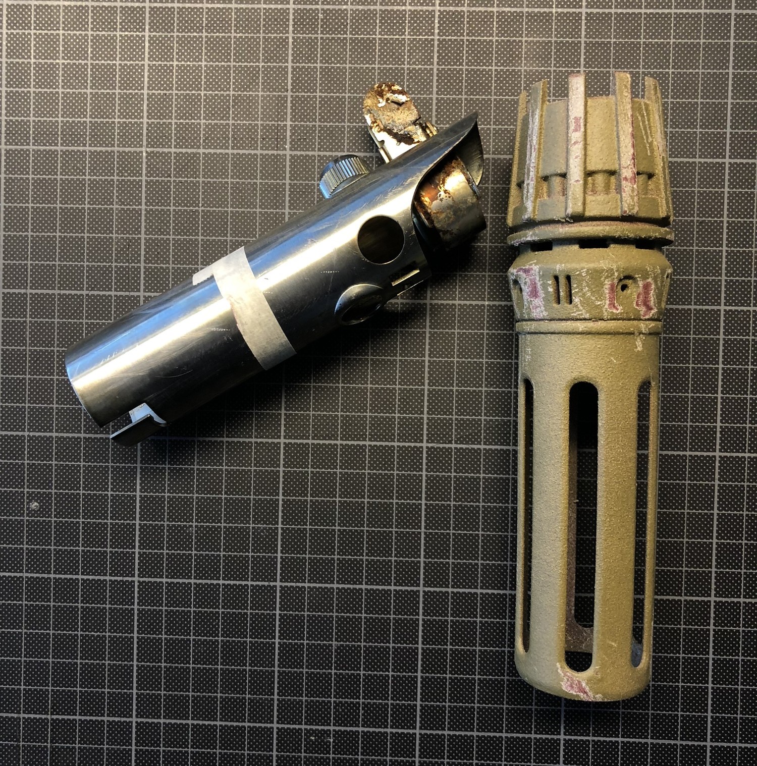

I started doing some tests on the printed parts to mimic old cast iron staff parts, using acrylic paints and that came out nicely. Maybe a bit too much and too strange at first, but when it dried up it looked alright. I added some rust colored pastel powders to add some ore rusty effects inside the cavities.
With the Ray-O-vac handle I tried it differently with some Humbrol metalcoat steel spray paint and some pastel powders for rust as well. That was different. Nice too, but I still don’t know which one I prefer.

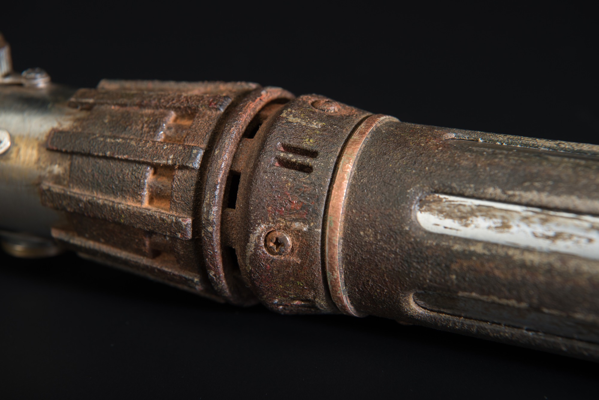

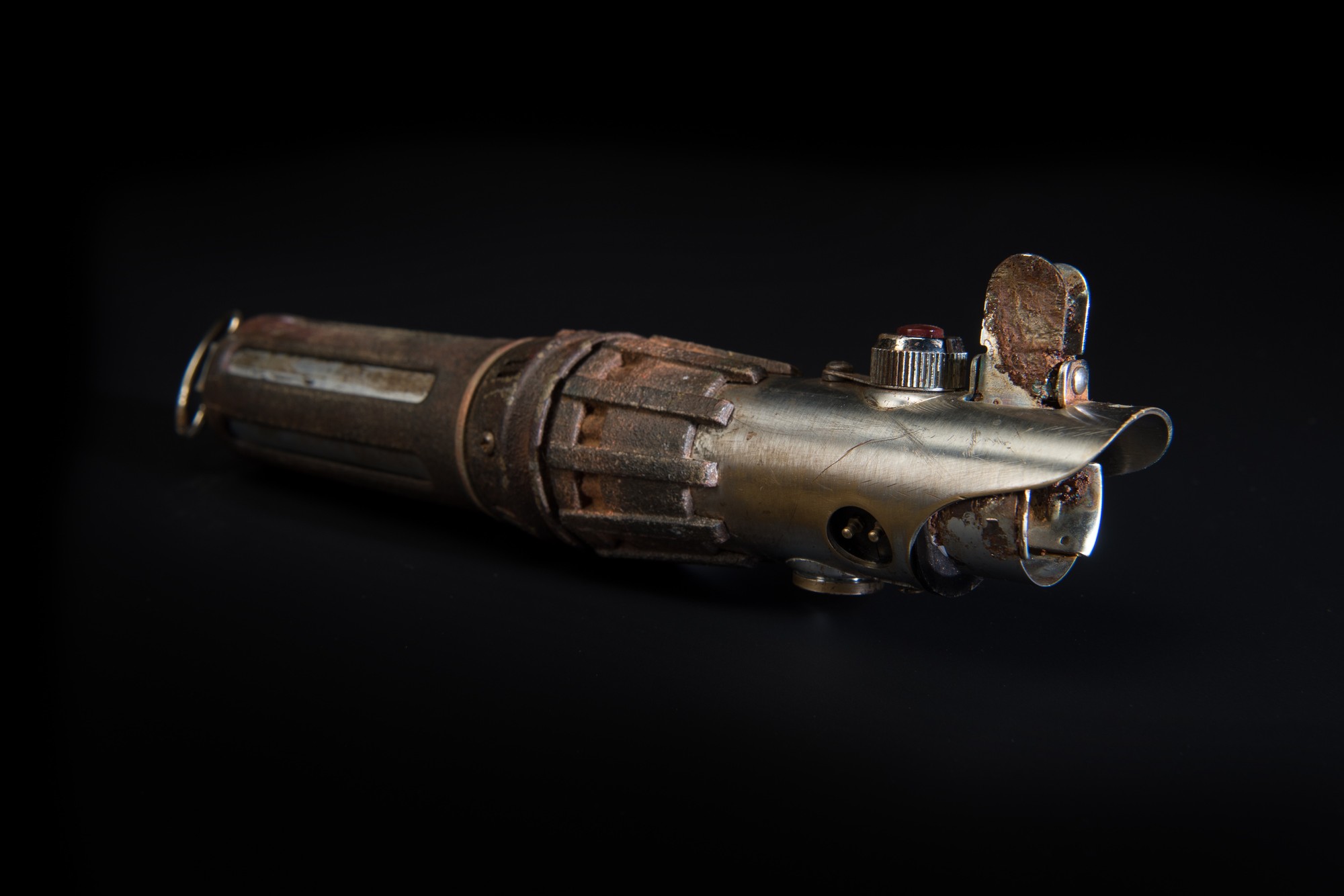

The cloth. In the first sketches I already added the cloth as a way to express the staff style better. I doubted till the end if I would include it or not, but even though it blocks the view, I thought it looked more Rey-ish. So, I stained a medical bandage with coffee, tea, paints, grease and dirt, until I was happy with it.

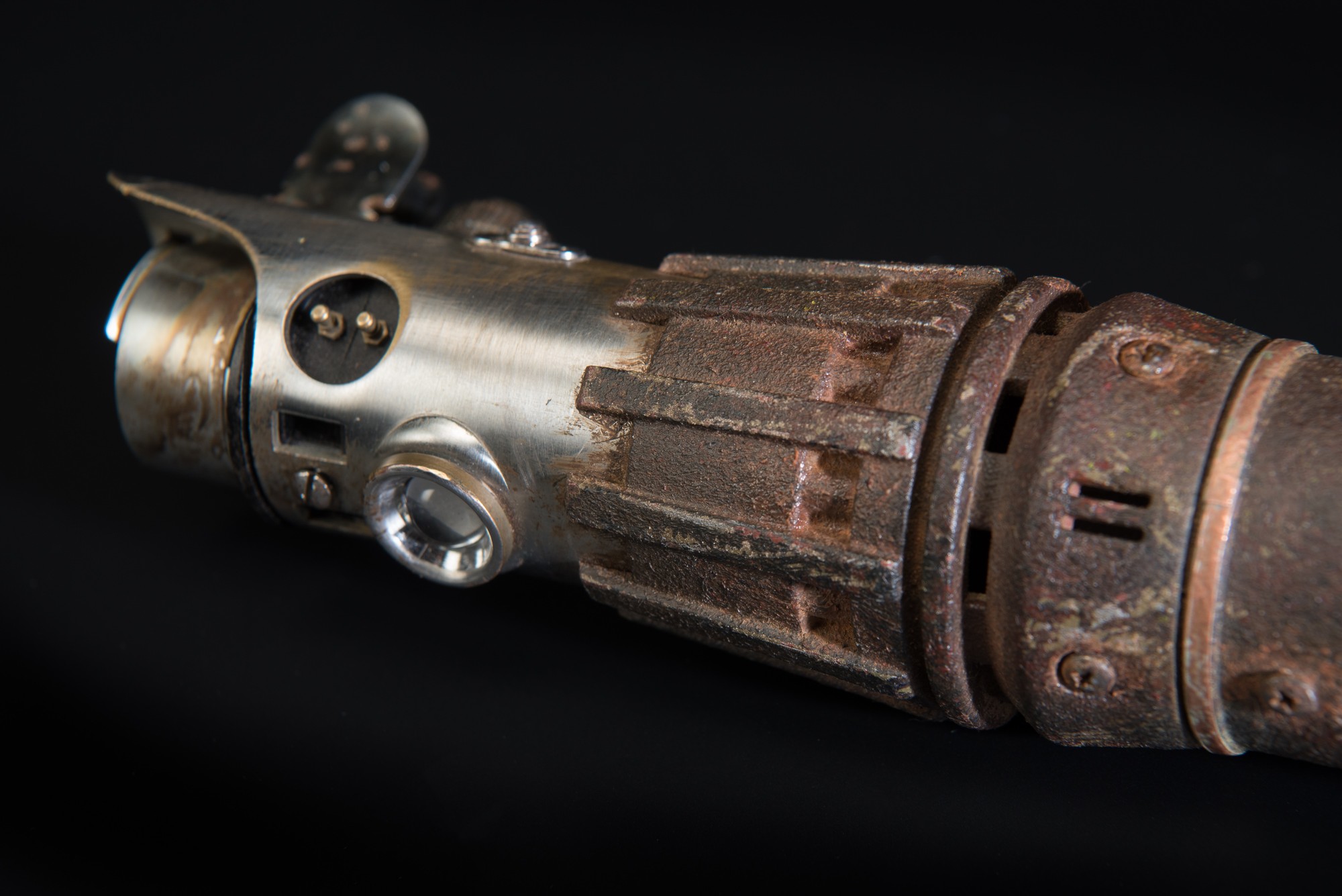

The install was easy. I added a blade holder from KR Sabers (thanks Khal!) and weathered the pins and glass eye in an ammonia vapor bath. I put everything together with some superglue and added some acrylic paints in the corners with a brush and the saber(s) were done.
I still felt something was still missing, so I added a small detail: a copper ring (made with just a thin strip of copper tape) and weathered using some ammonia.

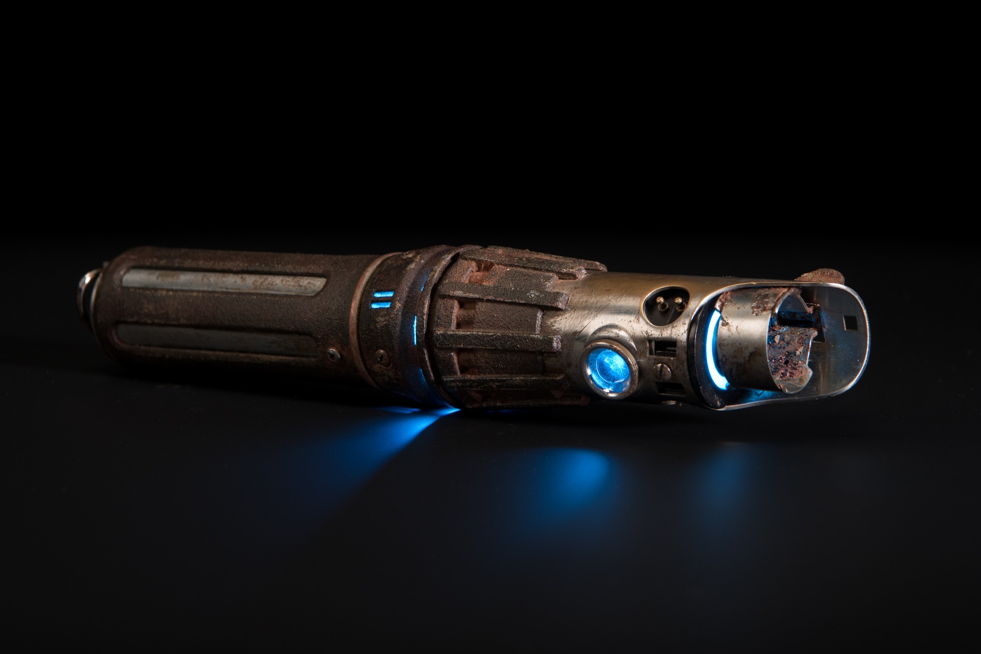

I realized I needed (and wanted) some professional pictures taken from the saber. I asked a photographer friend to help me out and together we had a really cool studio session with some amazing results. For effect I had a short flashlight with some light blue transparent foil wrapped around the lens to mimic a lit crystal inside.
Here are some more final pictures and details, with and some without the cloth.
