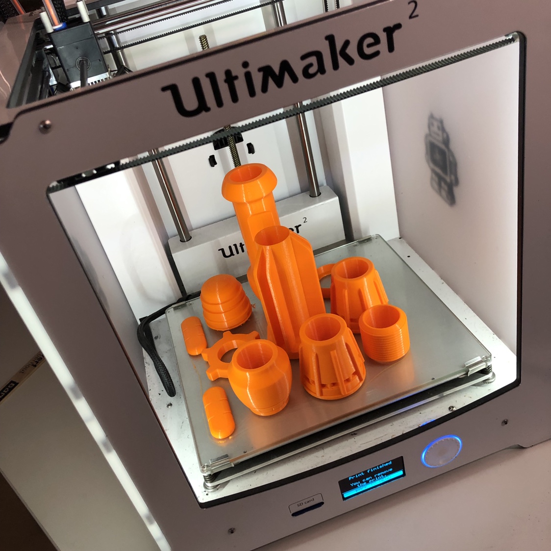

This is my version of Rey's staff from TFA. Finally I finished it and I thought I share my build here. I'm a little late to the party, but hey: that's the story of my life :)
So its just my personal project and not a project run. Maybe it helps some people who are still planning to build this. It was a lot of fun!
In short, this is what I did:
- 3D printed parts based on the great work done by Delphius. I remodeled some parts to make it a bit more accurate or easier to print.
- I used a wooden dowel as a base, cut in two parts with a screw connection in the middle.
- I bought two correct vintage British army Lee Enfield rifle slings on eBay.
- A got the buckles from some various shops
- I made some leather straps, complete with snaps and rivets. I used black full grain leather.
Finish and assembly:
- I finished the printed parts with a double layer of filler/primer.
- I then glued all the pieces in place. I might have made some errors in the correct spacing, but it was too late once I discovered that.
- Next a texture spray. I used rust-oleum pebble texture spray. This is a great way to cover the remaining visible print layers (I hardly did any sanding)
- Next a layer of Humbrol metalcote steel. When it's dry you can buff it and it's almost perfect! It looks amazing.
- I added a wash of sienna acrylic paint by airbrush
- I got some rust colored pigment powder and applied it in the corners and crevises. I used some water dimuted wood glue solution for bonding which I applied with a brush.
- I also added some graphite powders to bring back some metal luster on the faux metal parts.
The leather:
- I weathered the leather by rubbing it with alcohol and then with sandpaper. I then sprayed it with some olive color and a little bit of silver paint and used sandpaper again to make it look old and dirty.
The fabrics:
- I got some cheap brown fabric and some medical wraps for the white pieces on top
- I stained the textiles with coffee (espresso!) and some very diluted paints.
- I glued the pieces in place and tied some knots.
Here are some pictures during the build and of the result.

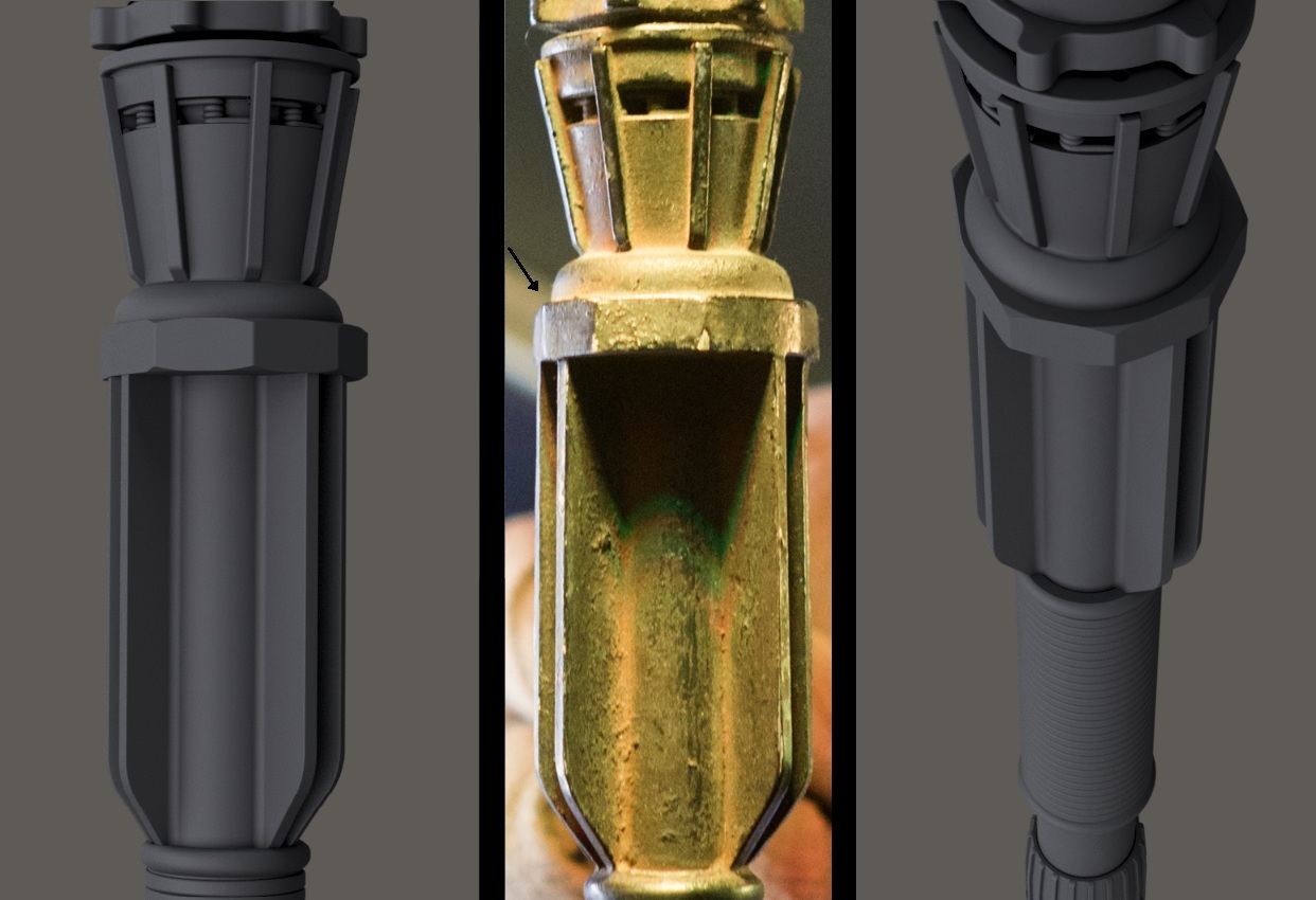

Something I've often wondered about that quarterstaff is about that big part with fins. It looks as though its asymmetrical, but I wonder if it's intentional, or if it might just be damage that occured during shooting, or even a defect that happened while this specific cast was made. If one of you guys know more about it, I'd be interested to hear it.

I'm not sure the part is asymmetrical. It rotational symmetrical in 3 equal parts. I don't think it's damage that you see but just a flat area. Having it in 3x 120 degree angles makes it look weird from almost every viewpoint. But who knows. I'm not absolutely sure either.
Yes, that would surprise me too if that part was indeed asymmetrical. I'm probably overthinking things a bit here. I just like that idea of purposely introducing asymmetry in a screen-used prop to make it harder to replicate!
