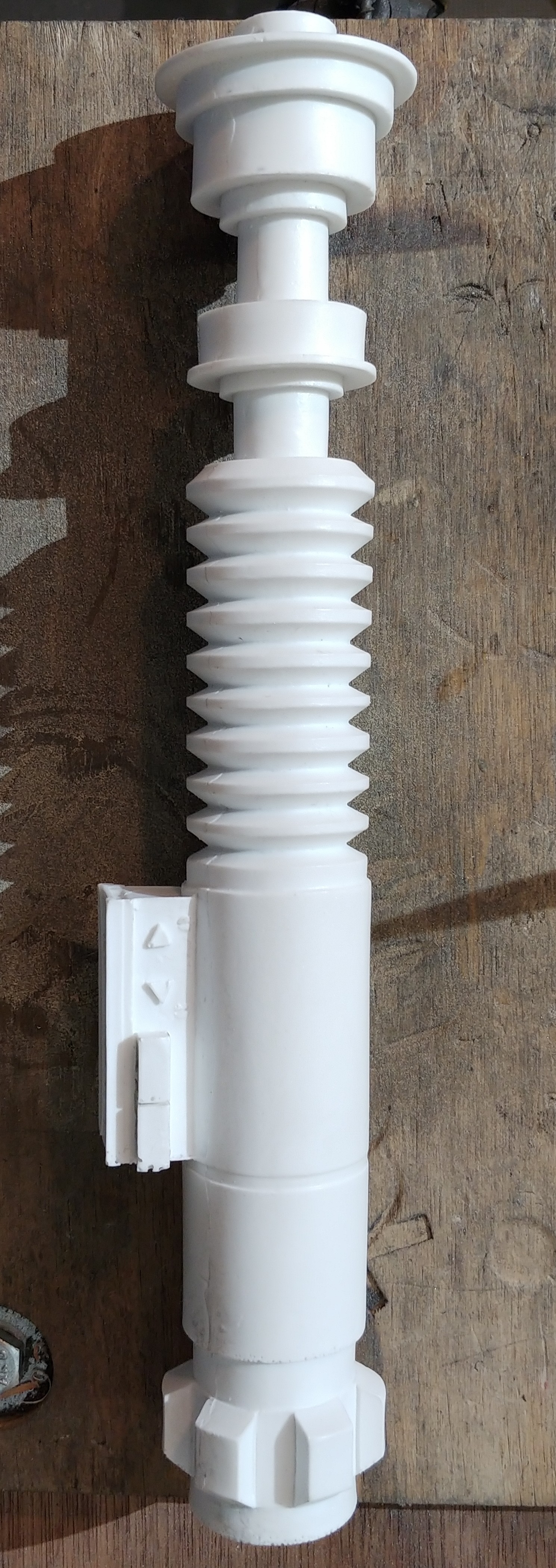

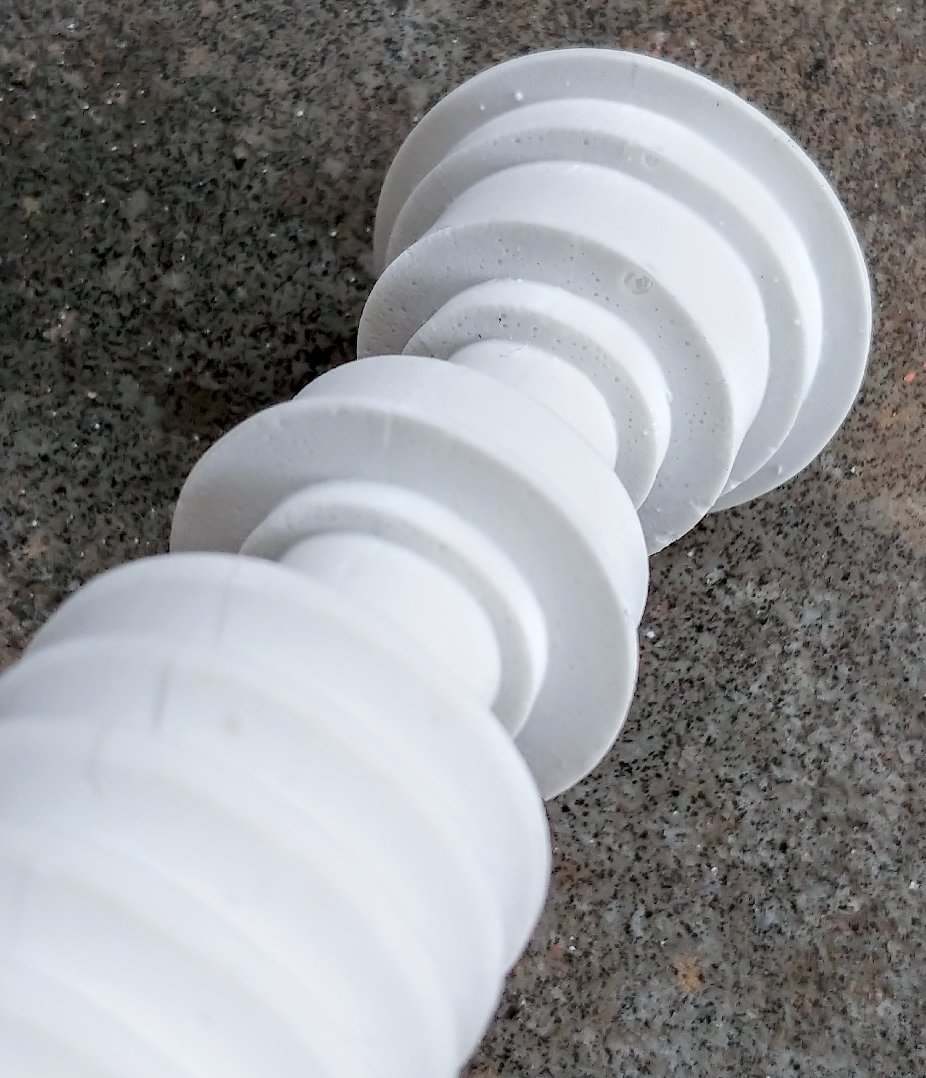

Do they all come out squished, like mine is? Like the two sides of the mold were held together with too much pressure while it was curing? Mine is definitely wonky. Are they all like this?

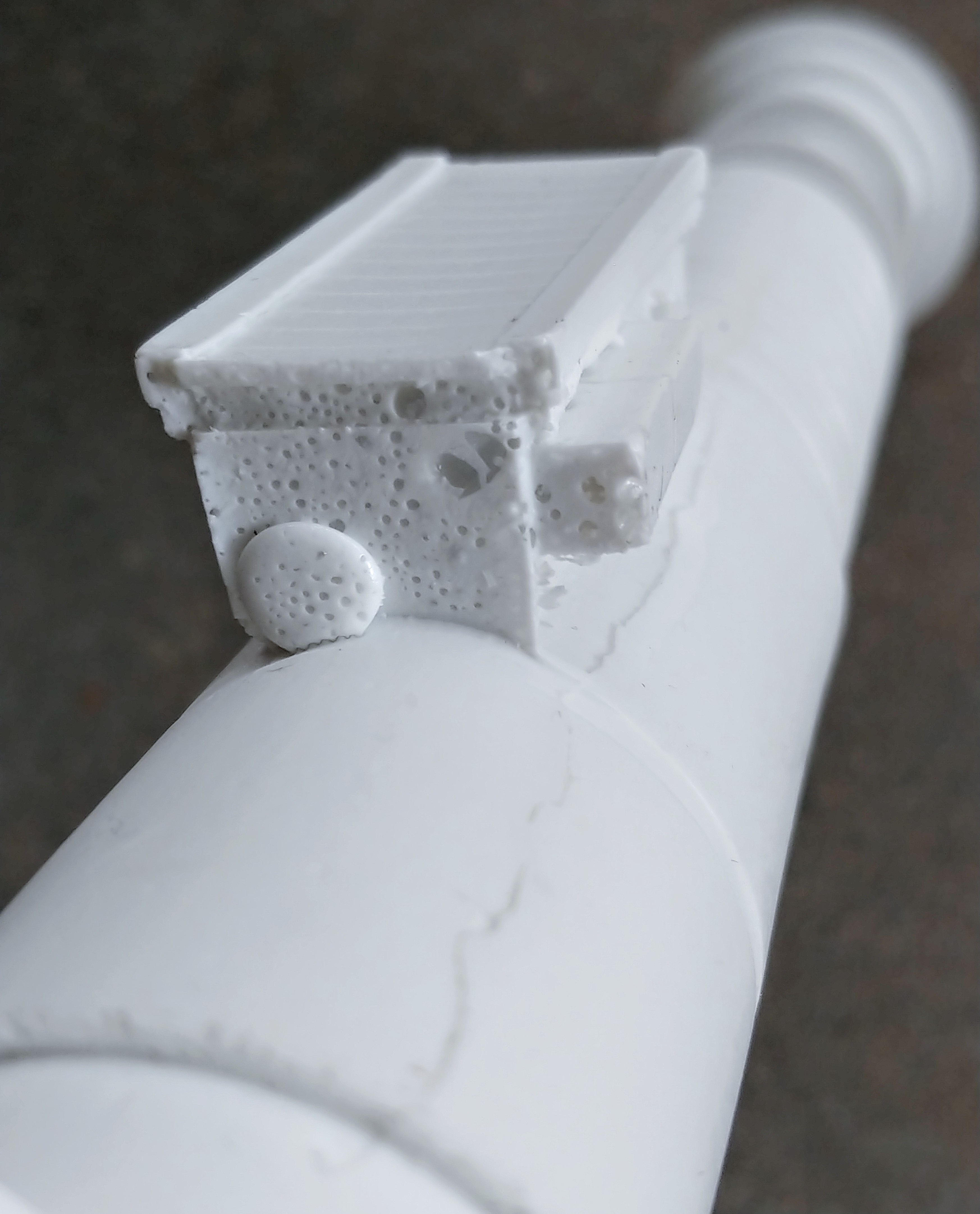

I’d love to know if that bubble on the back of the activation box was on the original too. I’ve seen it on all of them and just want to know if I should remove it or not.

I filled pinholes on a recast rotj saber with baking soda and then put drops of superglue on them, and they hardened up!

That bubble should be removed, it is an artifact on my end. When filling bubbles I use that superglue/talc method for things on edges and squadron signal or bondo putty on larger areas as it doesn't have much strength but feathers really well.

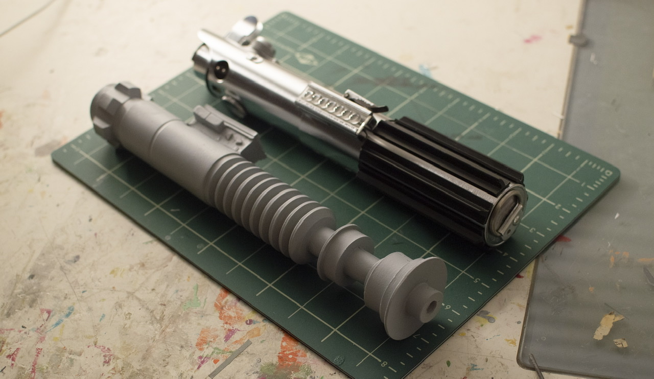

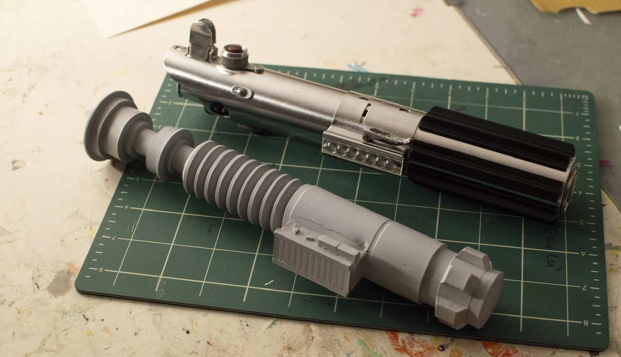

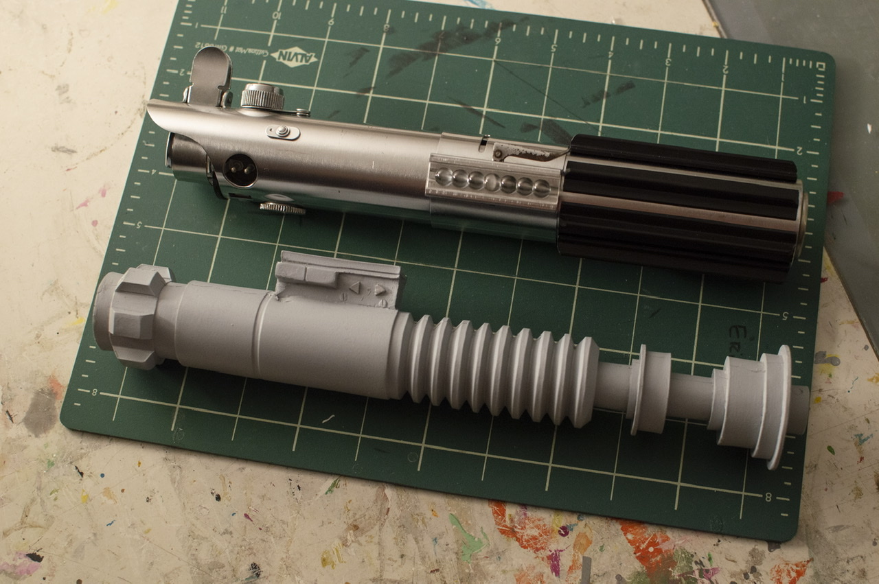

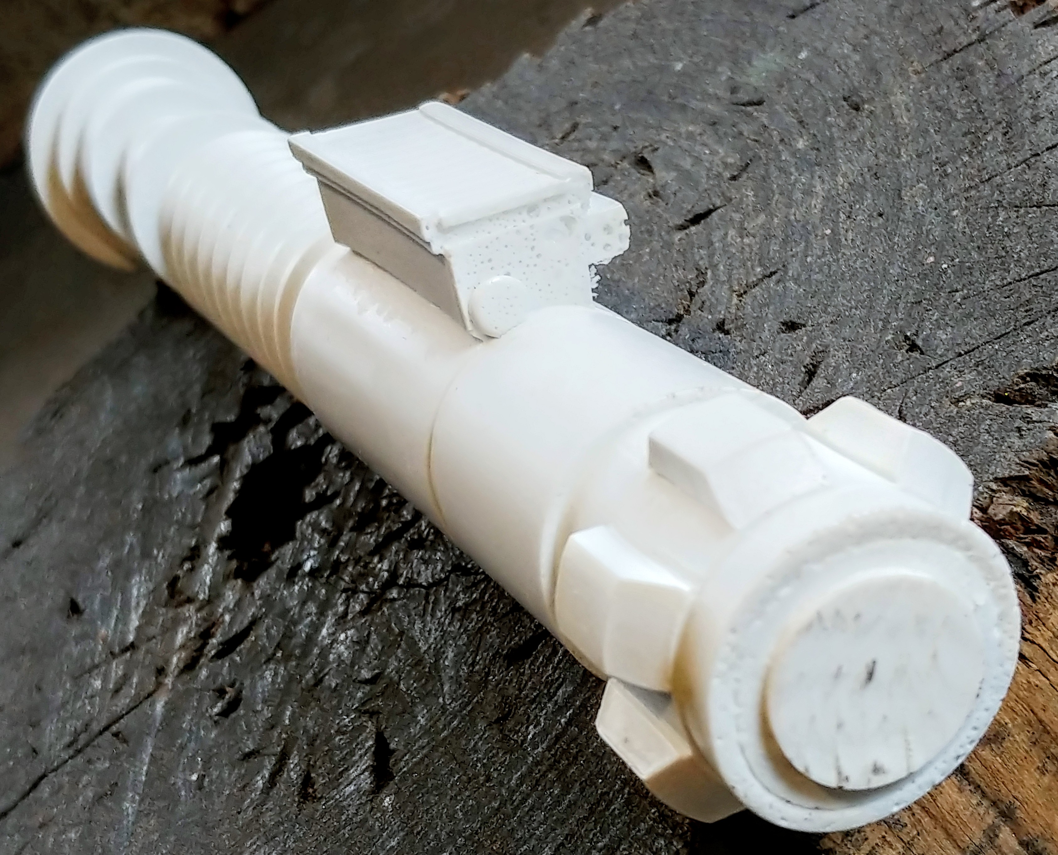

Cool, mine arrived today! It’s a really solid casting. I did a tiny bit of clean up (not much that needed to be done), and sprayed a layer of primer on it. I like the way it looks as is....not sure if I want to even paint it yet.
Thanks for making these available! What a cool piece :)

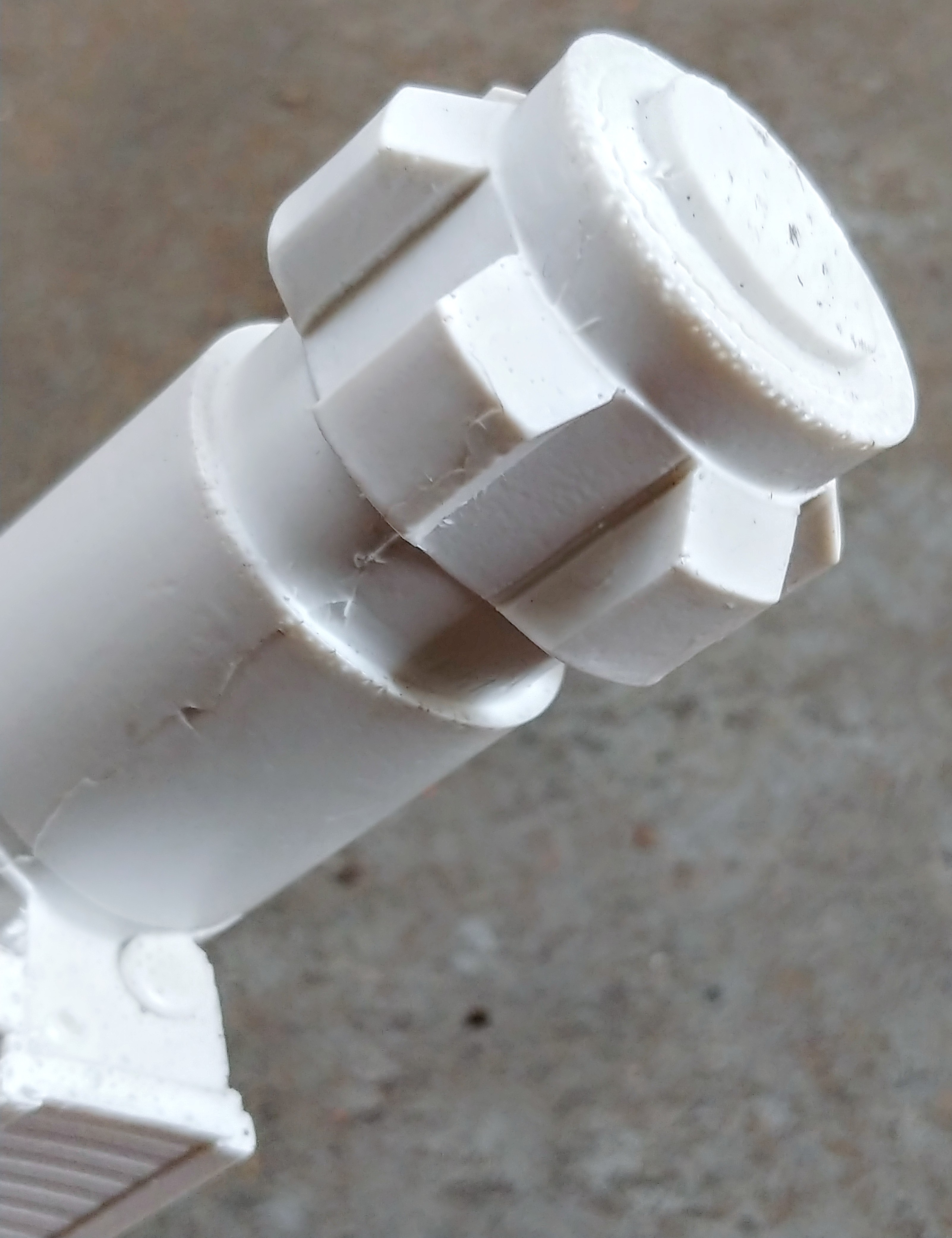

Guys - I know Dann mentioned that his saber looked a bit oval or squashed... and I AM curious if that's how the original was?
but I just noticed something else! The ever so slightly sunken rear of the control box is on the original in the archives. I almost see an oval emitter body too - looking at Seth's guide

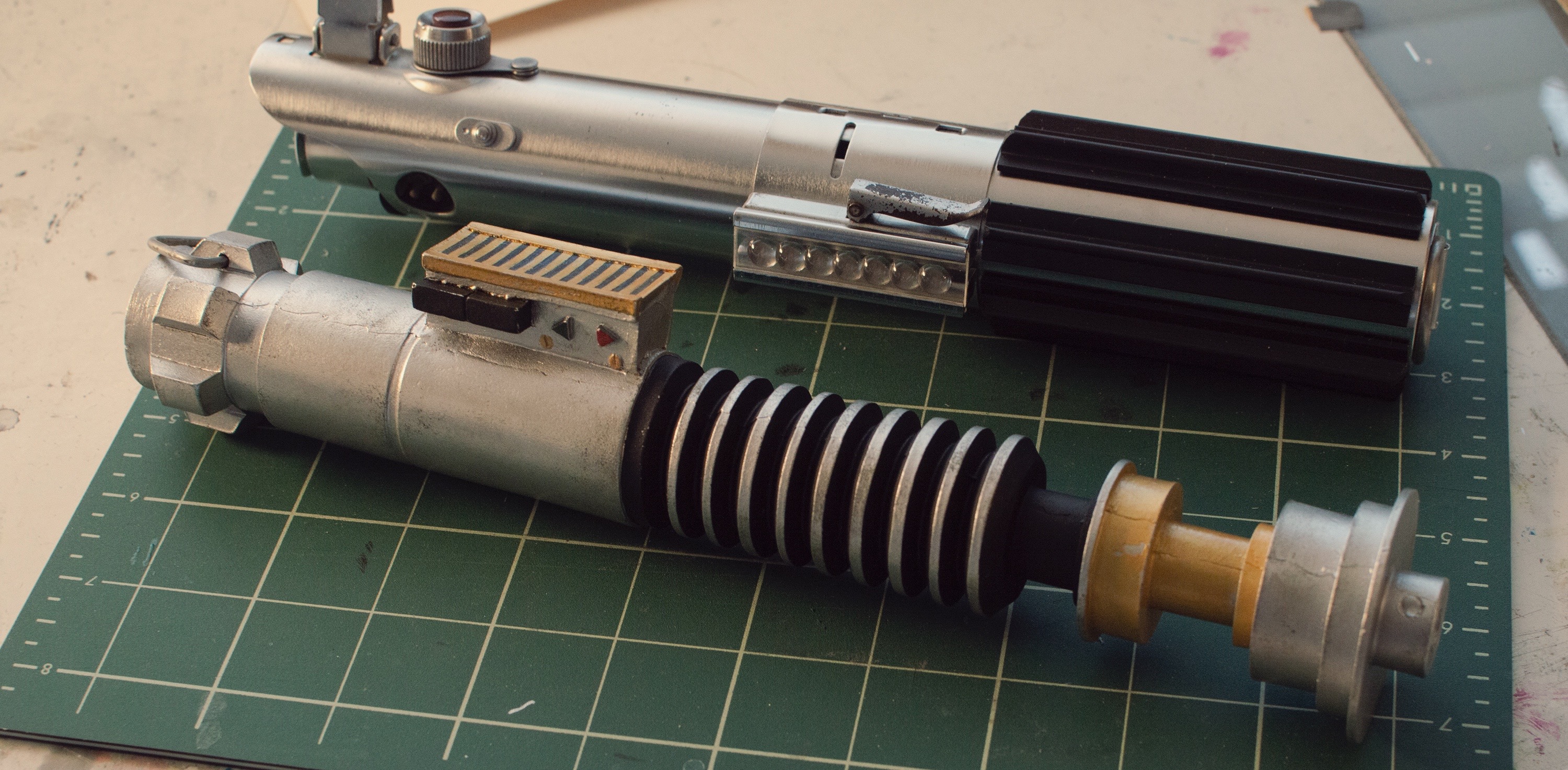

thanks for much for posting these! I‘m in the process of painting mine right now.

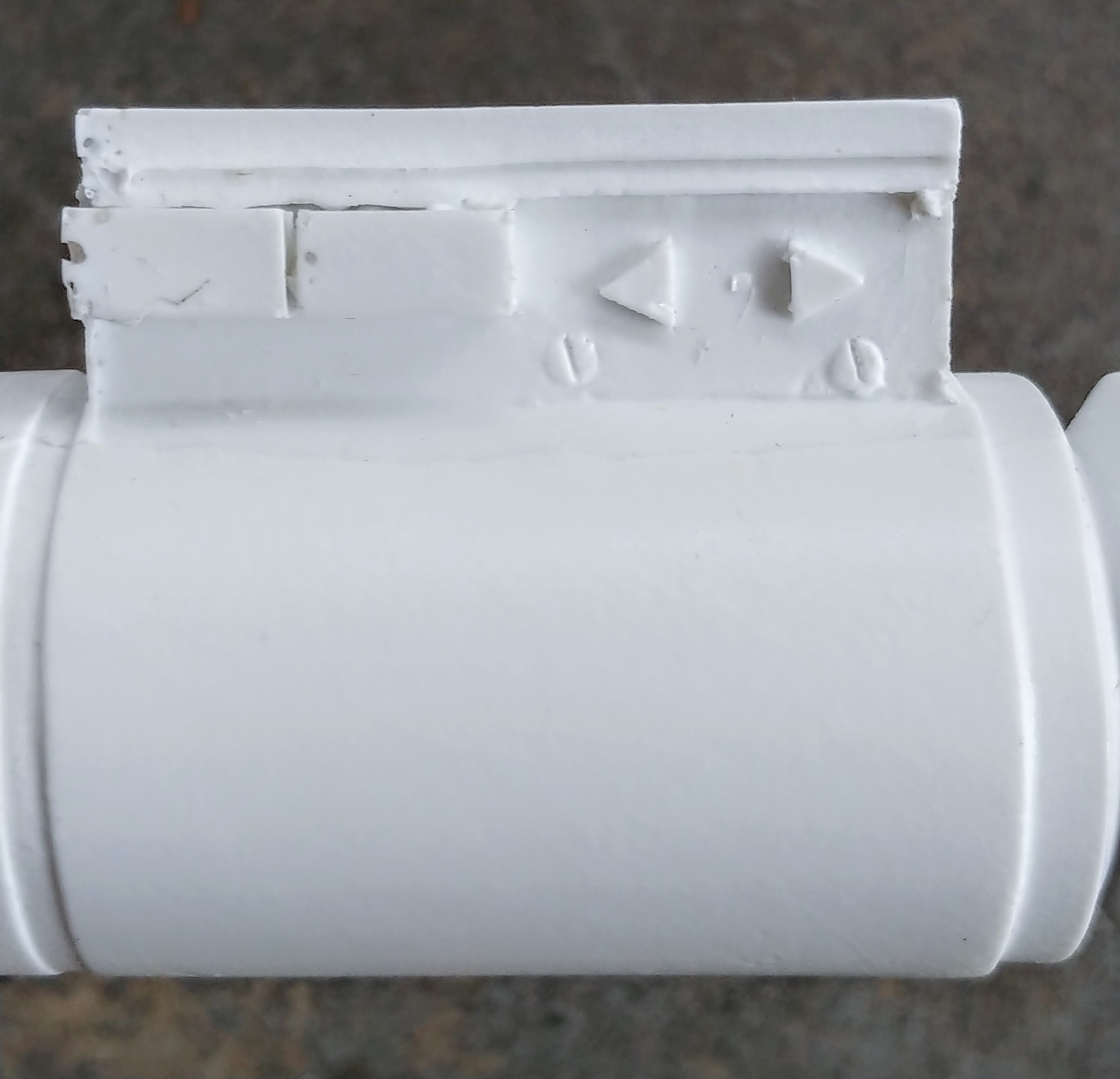

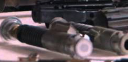

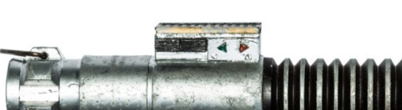

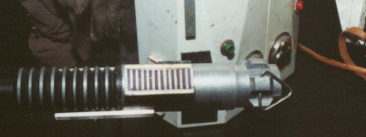

Here are some quick screenshots, for what it's worth. Box above the black buttons is a little sunken (and a little smaller), I've seen this on 2 recasts, this casting and the originals.
Looks like the emitter/windvane are a little oval or have a flattened side on the left in the last snap
check your casts!
