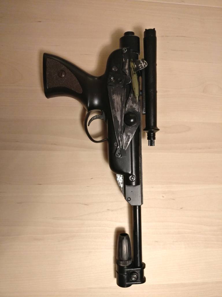

Don't mean to steal the thread but since I am using some of Vinces first batch of metal side pieces and it is my 3d printed scope used as reference in the thread I thought I'd share my WIP and first version of the DL-18, I have two more I'm working on. Ironically I dropped the scope and it cracked as well as broke off the tip, hopefully I'll have steady hands on the other two.
