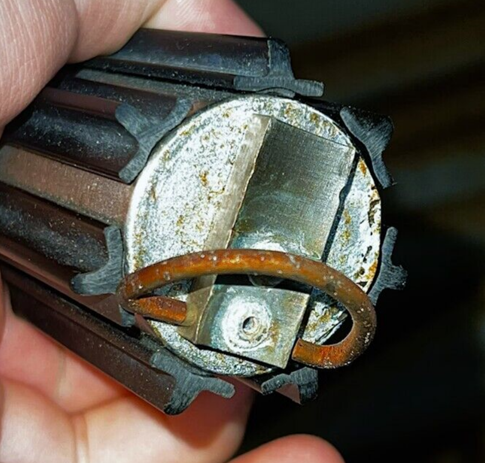

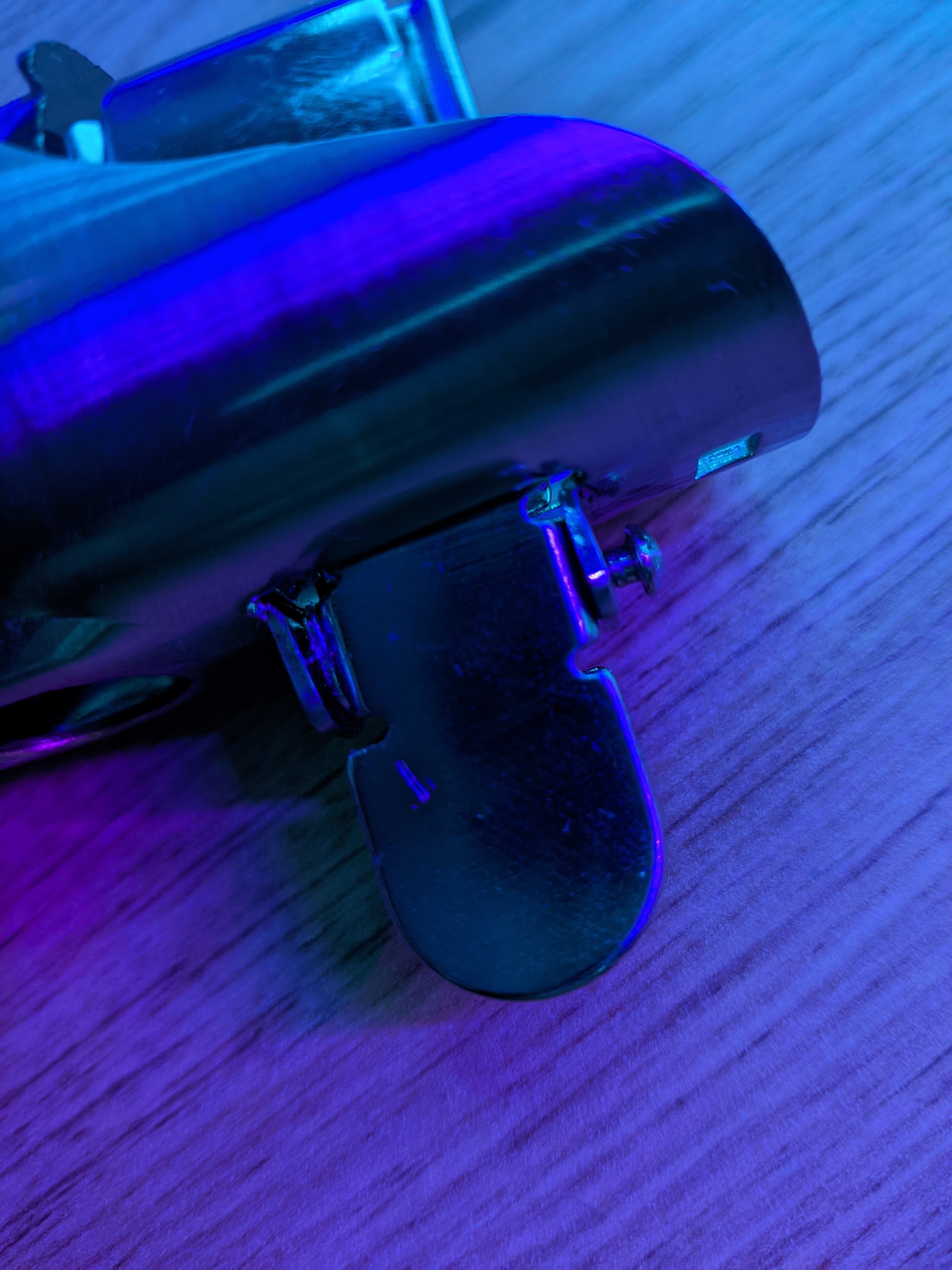

So I started salvaging the KR 3-Cell Flashgun. Any tips on how to remove the bunny ears?
I tried to unscrew them from the bottom but now the whole thing rotates when I continue,like the screw is stuck.
Worst case: cutting the screw with a hand Dremel should work?

Some tips that may help- many times with softer metals or screws they can get caught. Whether it’s a burr or whatever.. you never know. Find something to grip the threaded portion (the nut or whatever) and something to turn the head
If the sleeve is what’s threaded.. yea that’s tough I would use power tools lol

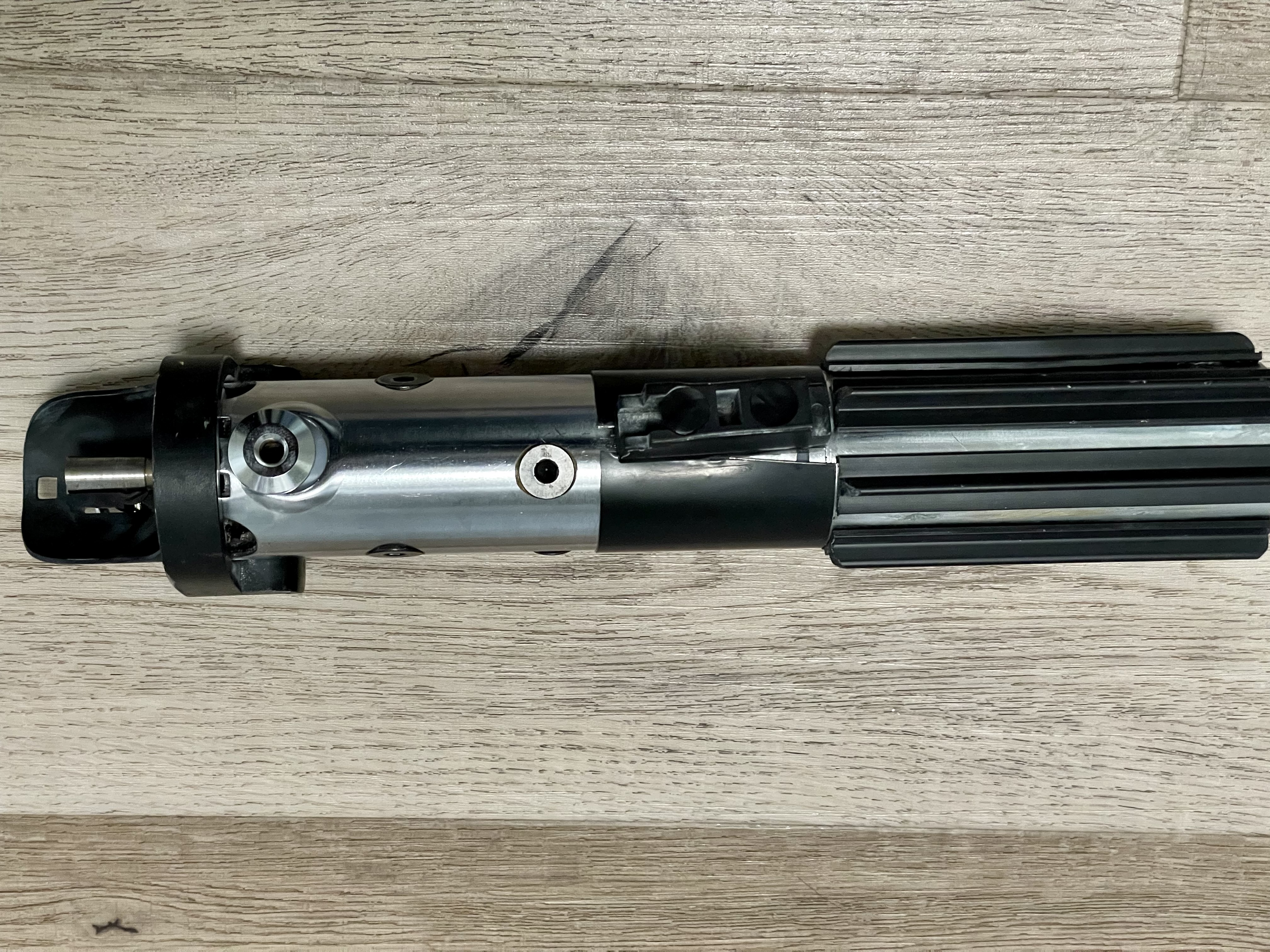

Has anyone in the states used a 1/2" 90 countersink to make their holes versus using a 13mm? I think the diameter on a 1/2" countersink is 12.7mm. So I wasn't sure if that small of a difference would make a huge difference in the holes.
Hunter120844 ... be very carefull when drilling the counter sunk hole ... best to go slow 1 mm steps ... take your black bolt and test-fit ... go a bit deeper if you have to but again just 1 mm ... test-fit with your black bolt again ... etcetera ... this is to avoid making the holes to big which will leave you with an oval shape damaging the chrome ... instead of a nice tight round fit around your bolt ... which at least should be your goal.

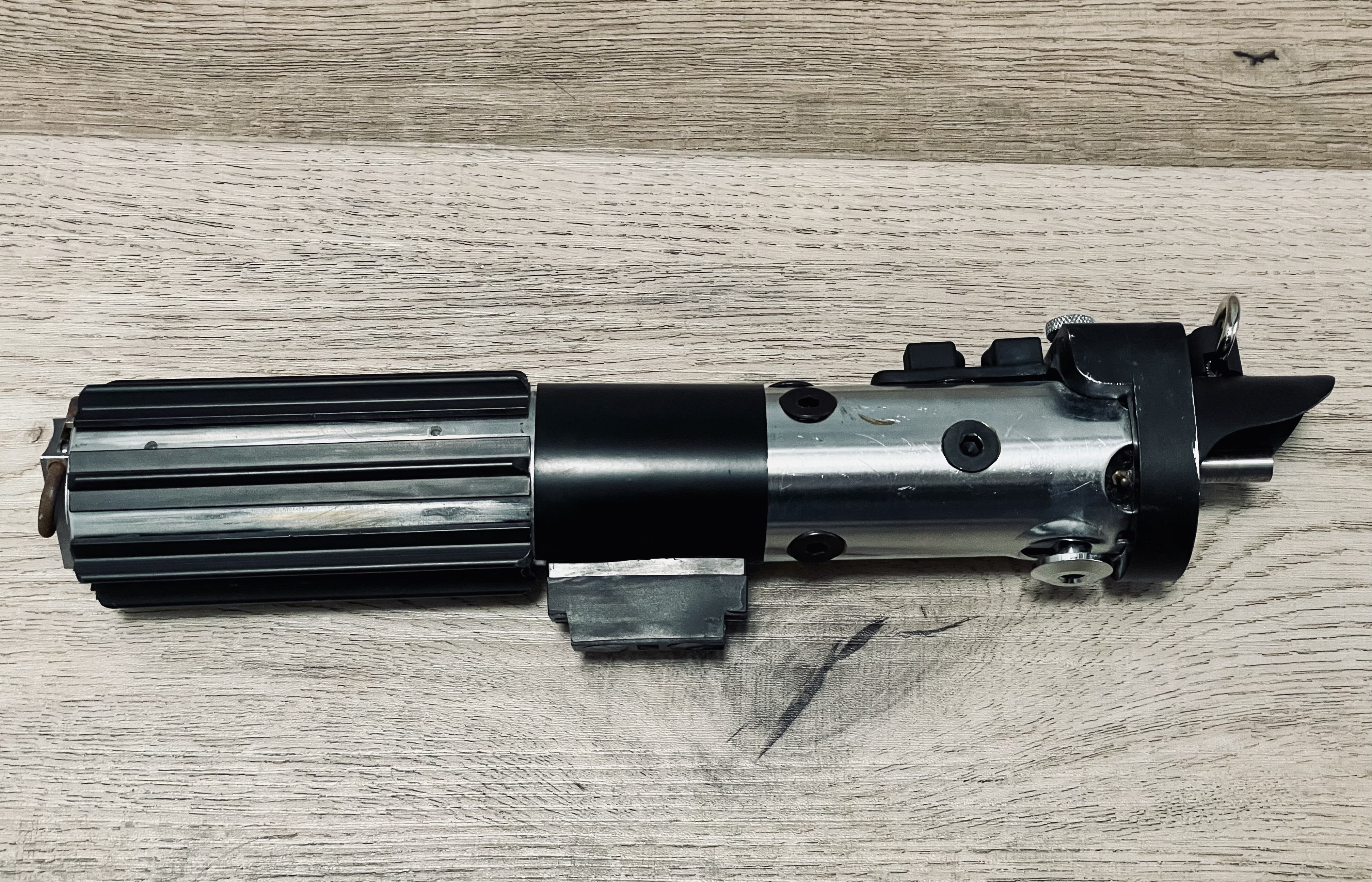

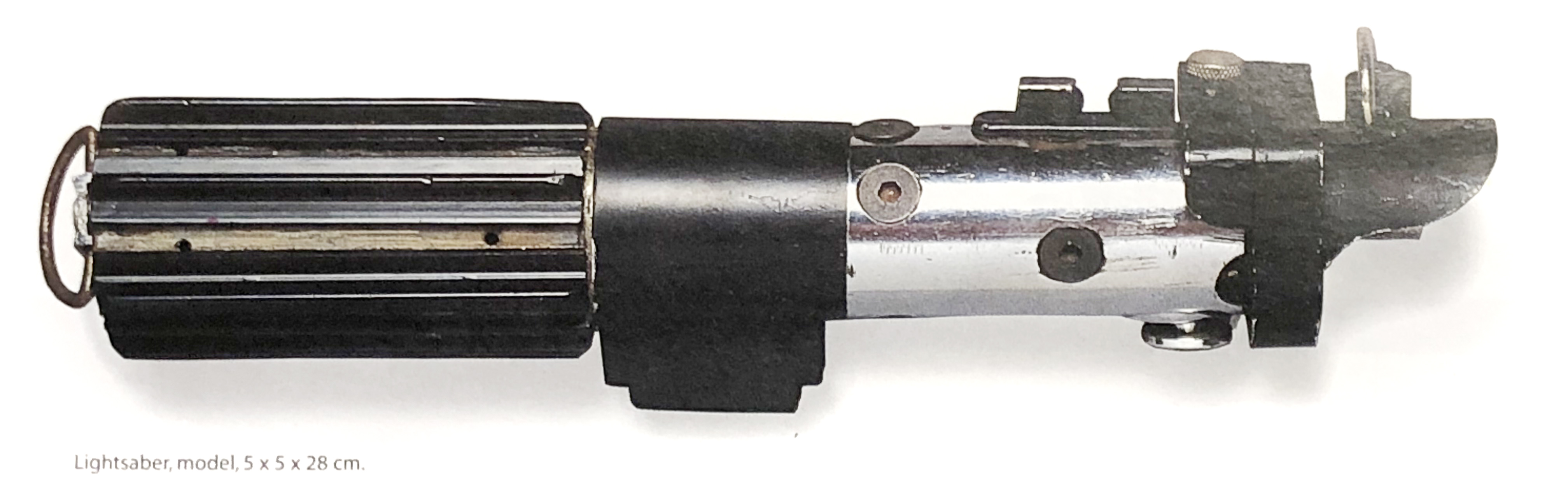

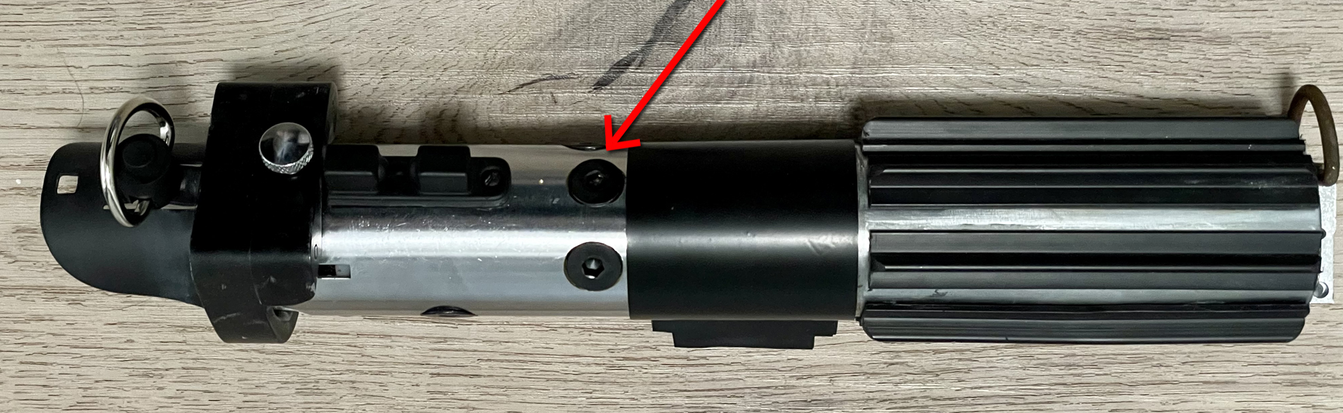

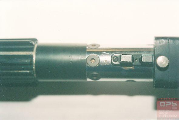

Excellent work 3251bimmer ... those drilled screw-holes are immaculate ... just one observation ... why is the distance between these 2 screws (see red arrow) made so small?
when it is clearly larger :

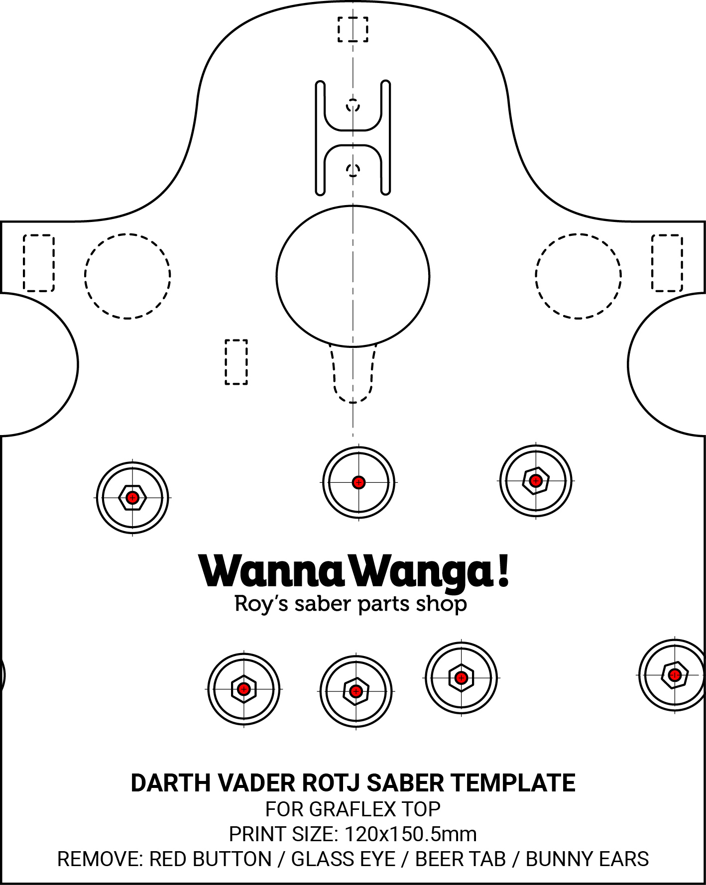

... and just one of the reasons I had Roy make a more accurate do-over* of the former template by Kal El which had been around since 2002 :
Chaïm
*For a template with all dimensions visit wannawanga : templates
Chaïm
Optical illusion of the picture. There would be no way for the holes to be off as it uses the WW inner core and the screws wouldn’t line up. I actually took this template and created a 3d guide out of it to ensure all my flexes are drilled uniformly
