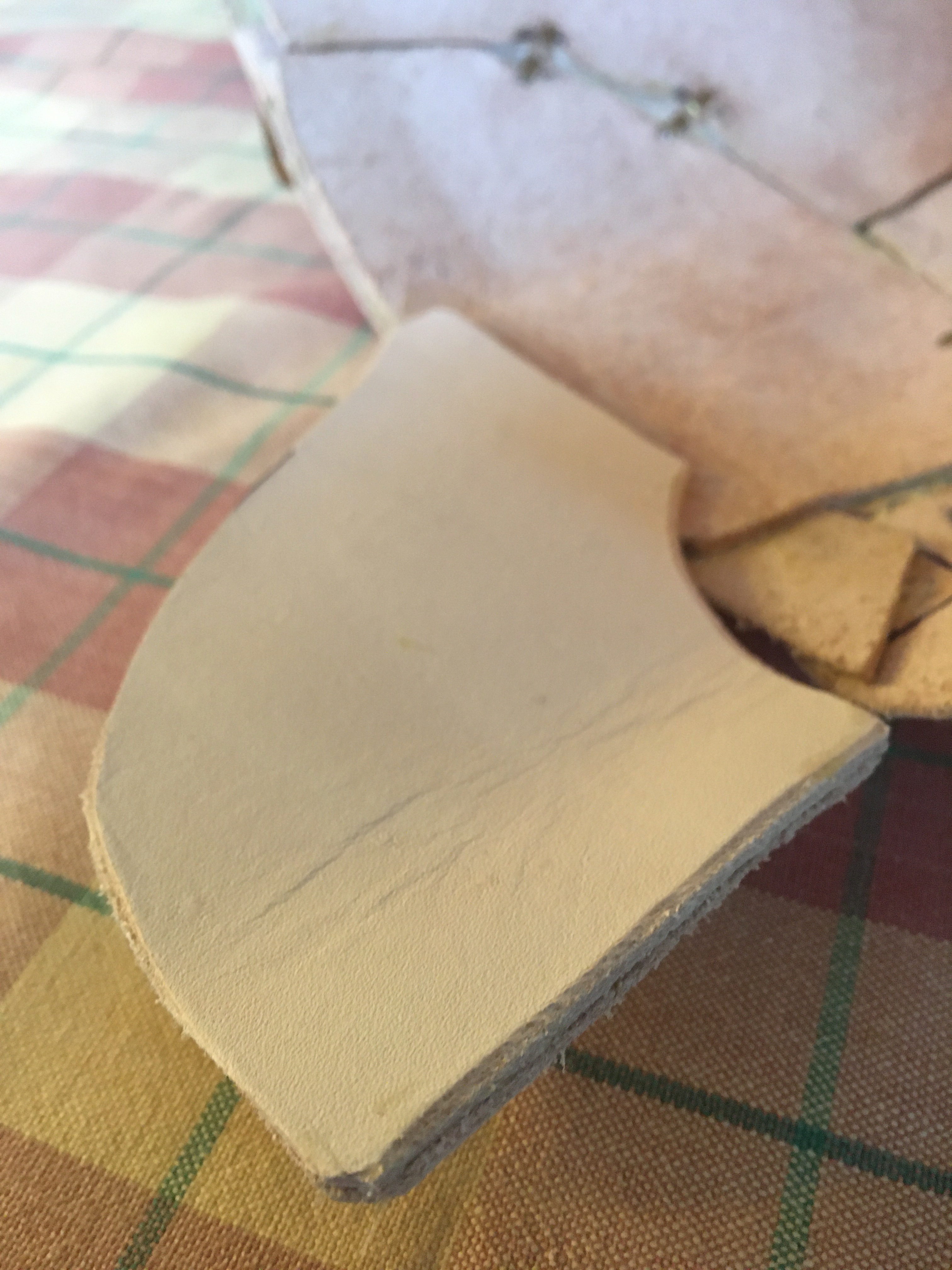

Then I patterned and glued in place the cheek guards. I slotted it in between the headband and the side panel. I then backed this with another layer, to make it double as thick. I had the smooth side out on the backing. The backing wasn't glued in between, but on the inside instead.

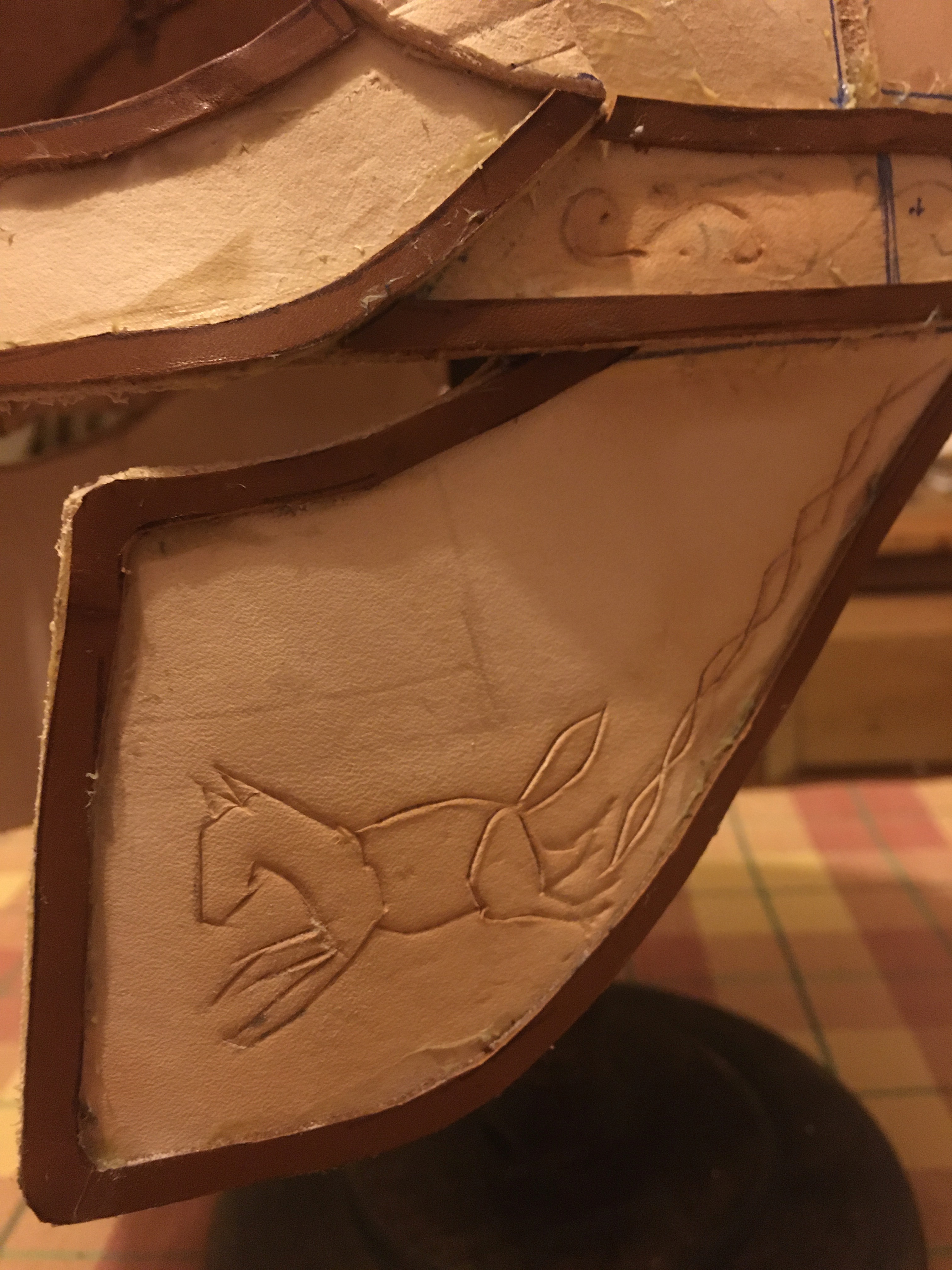

Wet Carving Details
I then set about adding some details to the leather to hopefully make it look like it was either cast or engraved that way. First I did the grooves on the brow. I got some hot water into a jug and used a paint brush to brush on the water onto the brow. I then used a blunt awl to carve in the lines. I then did a similar process for other little bits of detail. I just drew them on before hand. There was a little bit of guess work with the designs, but so long as it looks relatively right, I'm not too bothered.
I'm not sure if it really needs the leather to be wet. I actually got frustrated with the complicated designs and gave up on them. But once I saw how cool they looked once painted, I went back to them. Seemed to work even when dry/painted a little. I think it I had the right tools and know-how this could be really good. But I was happy with what I managed to do. The issue is doing curves. Straight lines isn't too difficult.

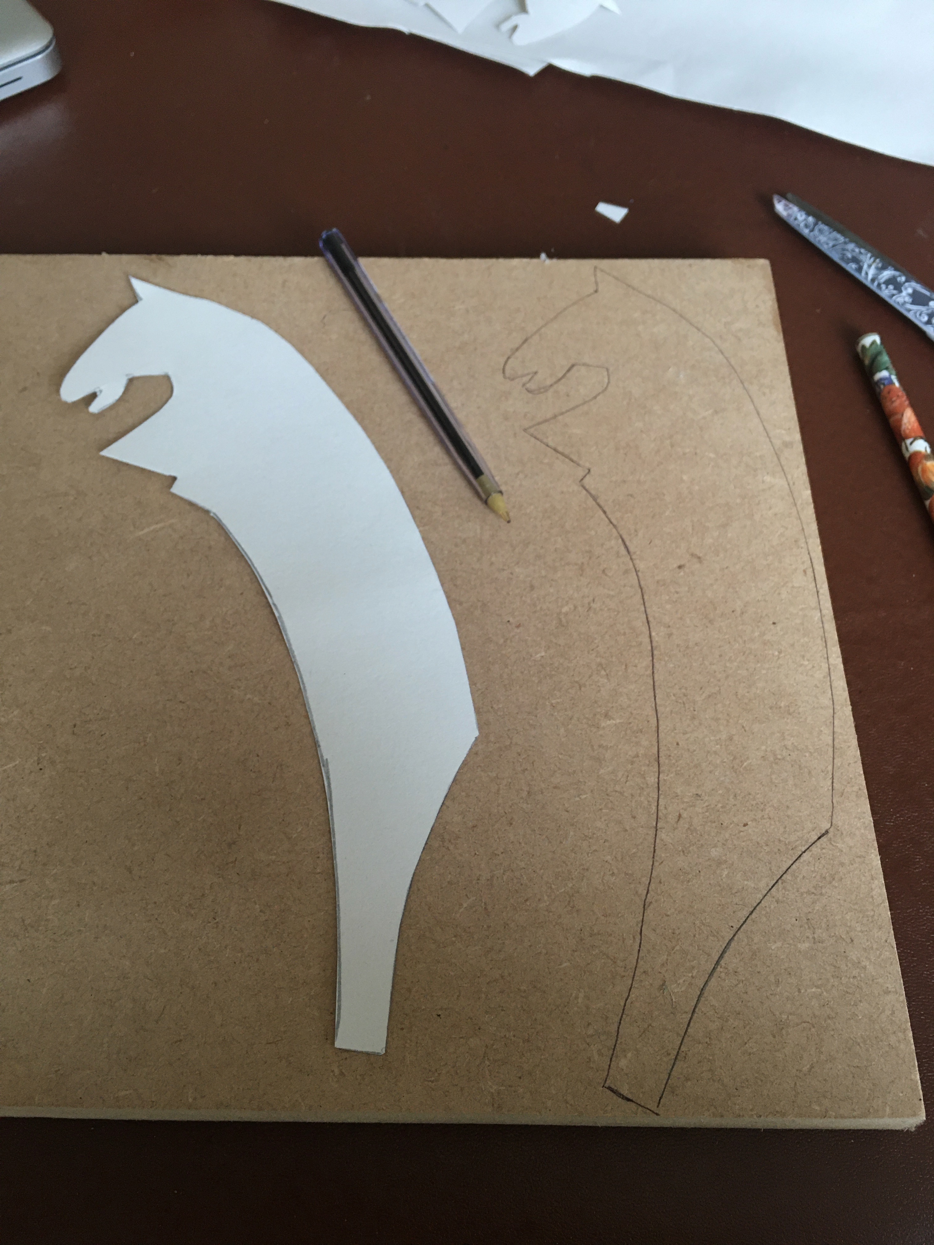

I then moved onto the helmets crest. This looked to be made of wood and horsehair. But firstly, I turned to patterning. I laid the helmet down on some paper, and drew along the back to get the general shape of the arch at the back. I then drew the crest from that as I felt it should look. Once cut out I could see how it looked. I altered this a couple times until happy.
I then cut this shape out of some 3/4" MDF I had with a jigsaw. Having done so, I decided this was too chunky looking. The screen used ones look pretty narrow actually. I found a bit of scrape fence (taken out by Storm Arwen funnily enough) that was around 1/2" thick. and cut it out of that.
Once this new piece was cut out, and place it on the helmet and took a picture. When compared to reference material, I realised it still wasn't quite the right shape, and so redid it. This was a blessing in disguise as will come apparent later.
