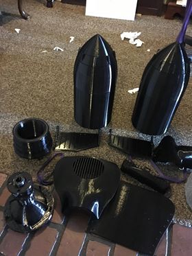

Here is how it showed up. Just look at that box! (my dog was very curious)
Here are the pieces roughly laid out + some paper towels my dog had just shredded.

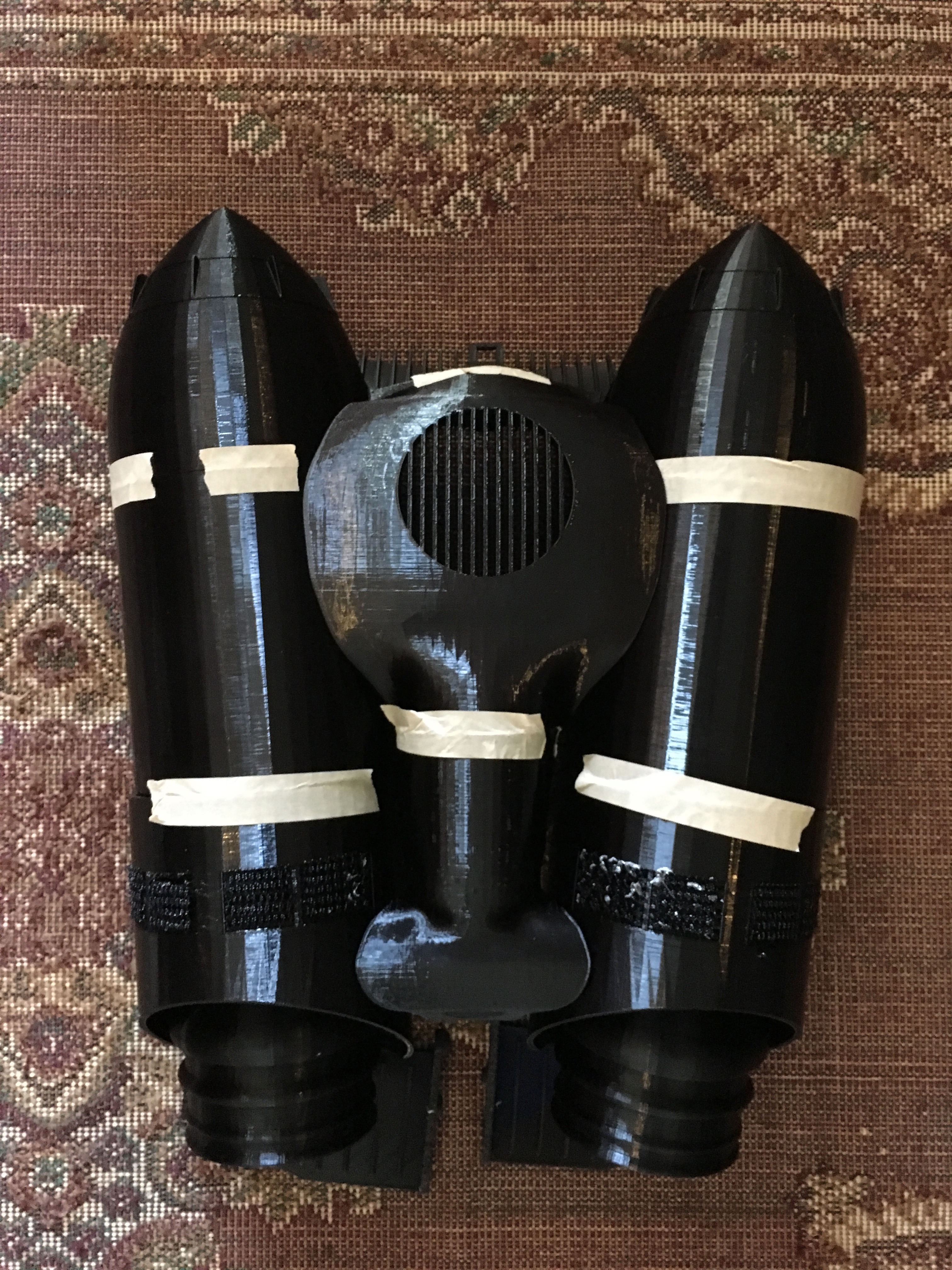

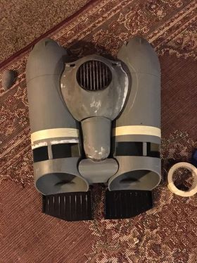

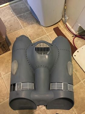

Here it is roughly taped together

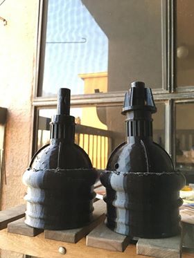

Here are the Rocket / plunger things - they were broken up in a weird way, but I realized if I sawed them in half and fit them together I could get something more or less close to screen accurate.

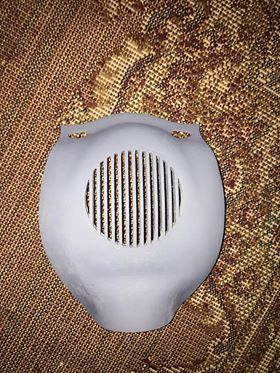

Here is the original fan housing, it wasn't super accurate so I tried re-sculpting it, but after seeing what i was going through Aaron printed me a brand new one that he designed that was SO much more accurate and fit like a glove!

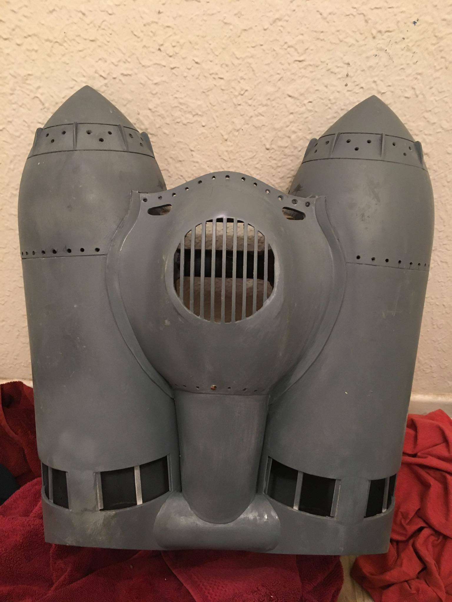

After regularly sanding for over a month I started to assemble & prime the crap out of this thing to get rid the 3-D print texture. I also dremled out the grills at the bottom of the rocket tubes and re-sculpted the opening a bit to match the proportions of the film version more. I wound up entirely remaking the part that connects the top fan housing to the bottom with some heated styrene and pipe.
The one thing I hadn't anticipated is this was so hard to assemble and get all the pieces to match up right. It took weeks to get the measurements right and make sure everything fit together correctly. I'm also doing this with very basic hand tools in a one-bedroom apartment so there is little space to do this "right."

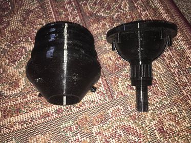

I made "eggs" using heat-form plastic molded over a wooden egg I found at Michaels.

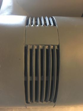

I remade the bottom grills out of triangular strips of white styrene I got from a hobby store.

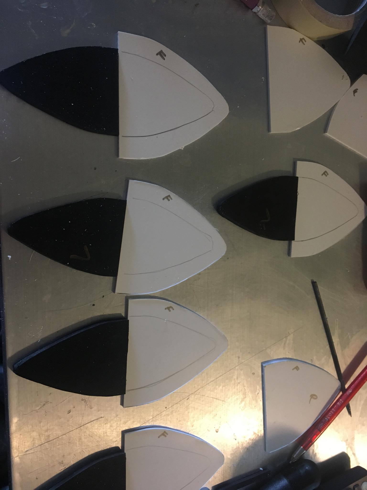

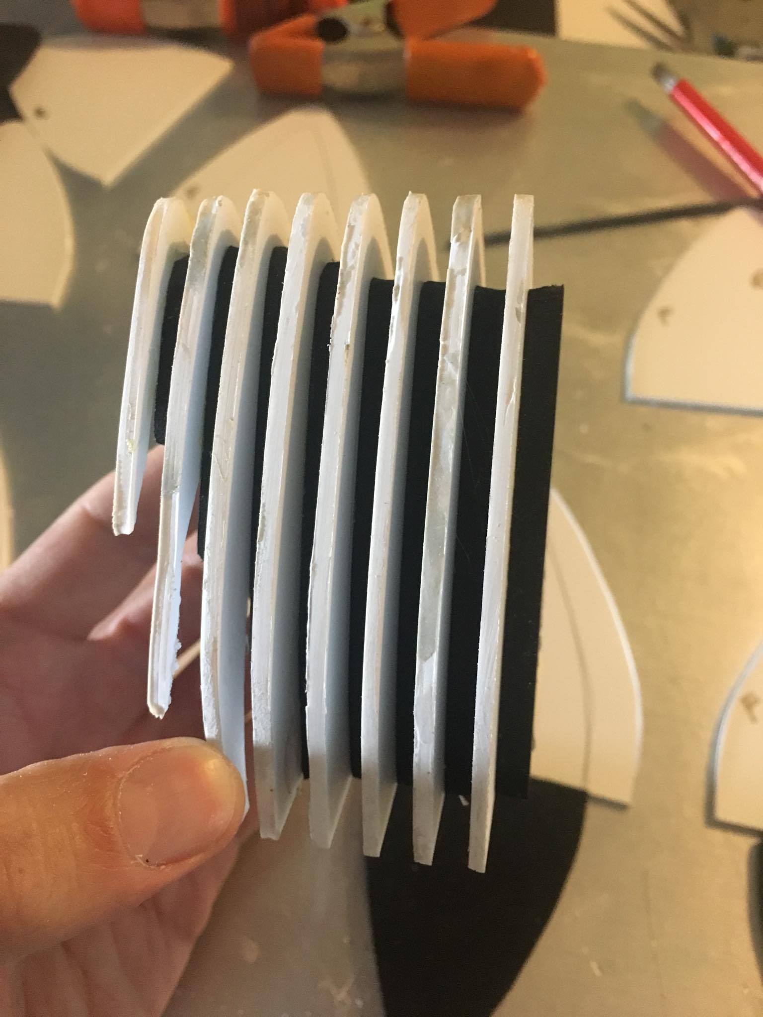

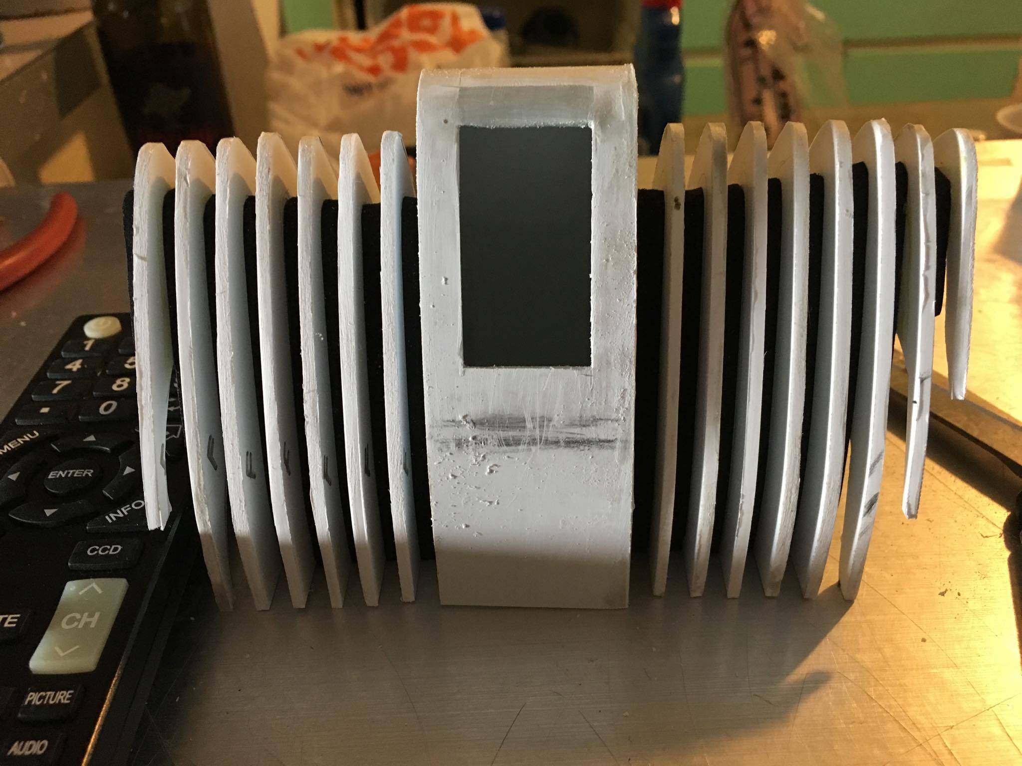

One thing I found challenging was how to make the grill at the top of this thing from scratch. What I settled in was some thick styrene sandwiched with black foam. This was quite a challenge to sort out!

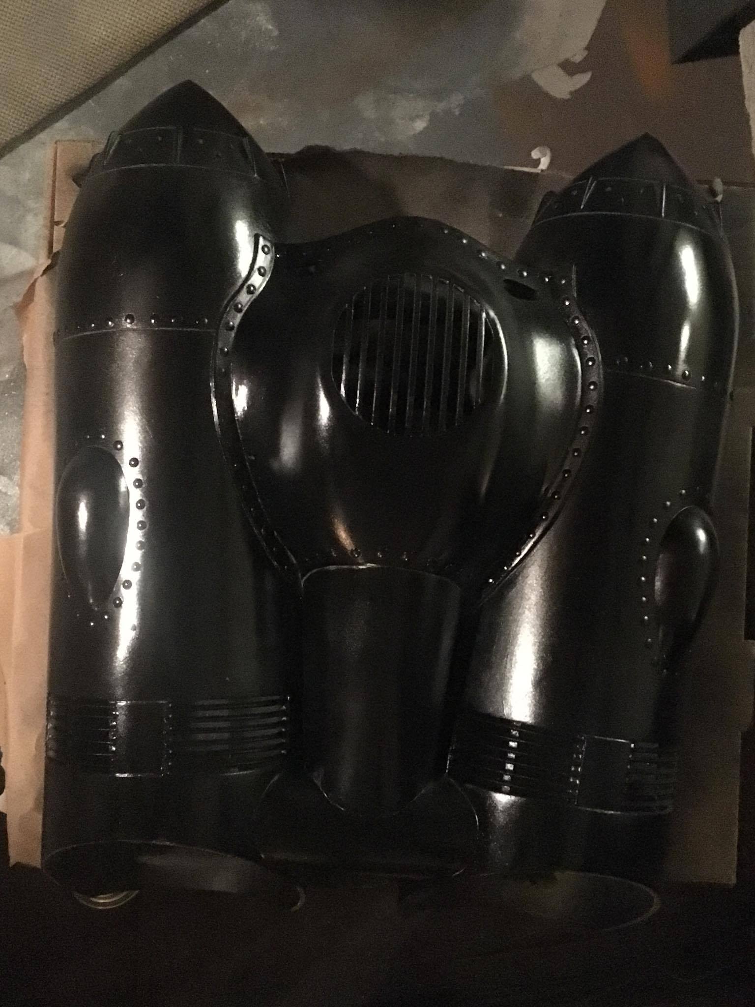

Here I started drilling all those damn little holes for the rivets and on the cone nose. What a nightmare! I also sculpted the wings on wither side of the fan housing using magic sculpt.
Priming!!!
And here is is painted! Just a few days before halloween!

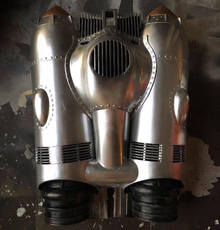

Here is the final thing!!!!! Thank you again to Aaron! I really owe him - I'm so happy with everything he made me!

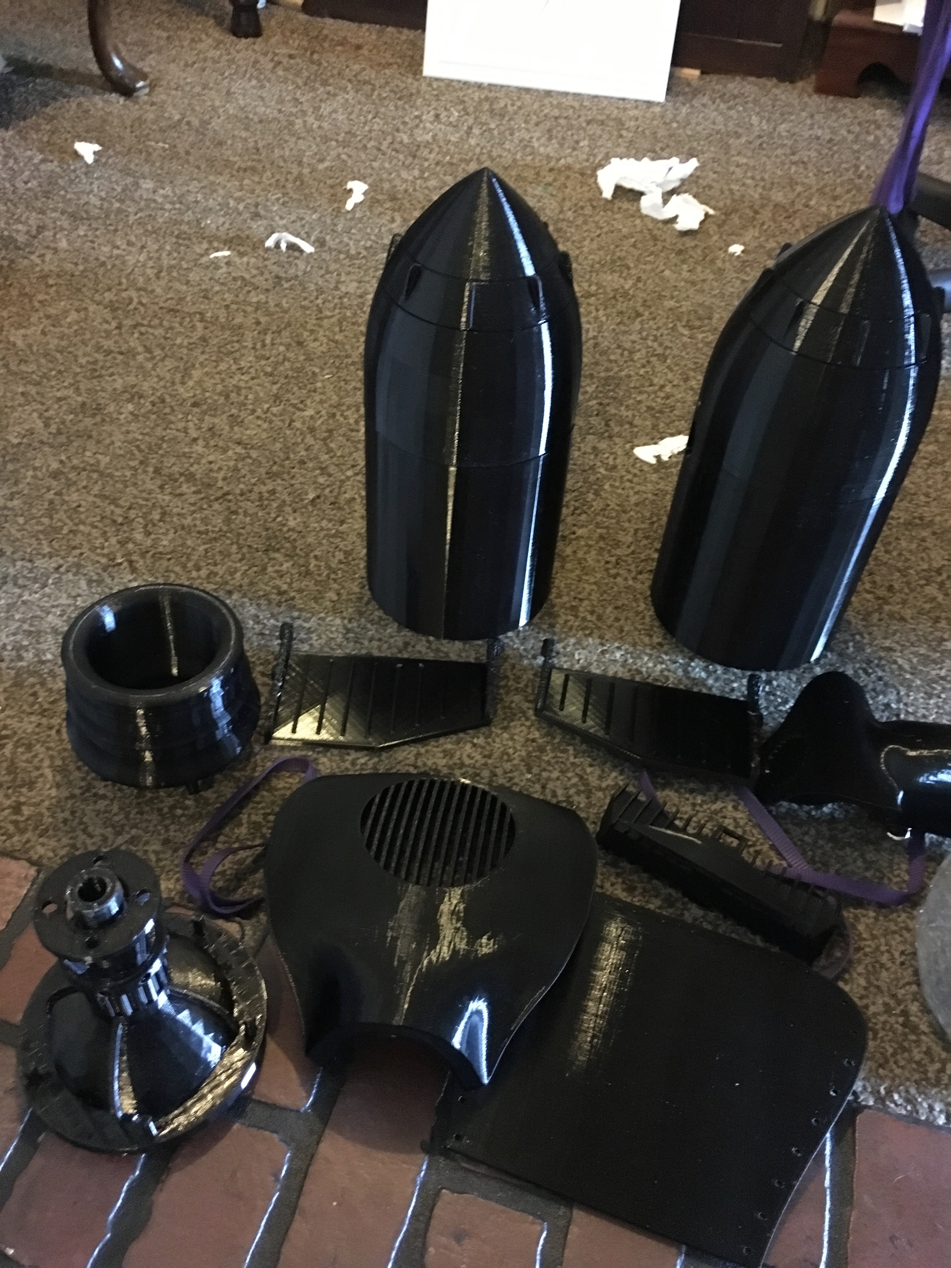

Here are some more pics of the fan housing that Aaron sent me:
