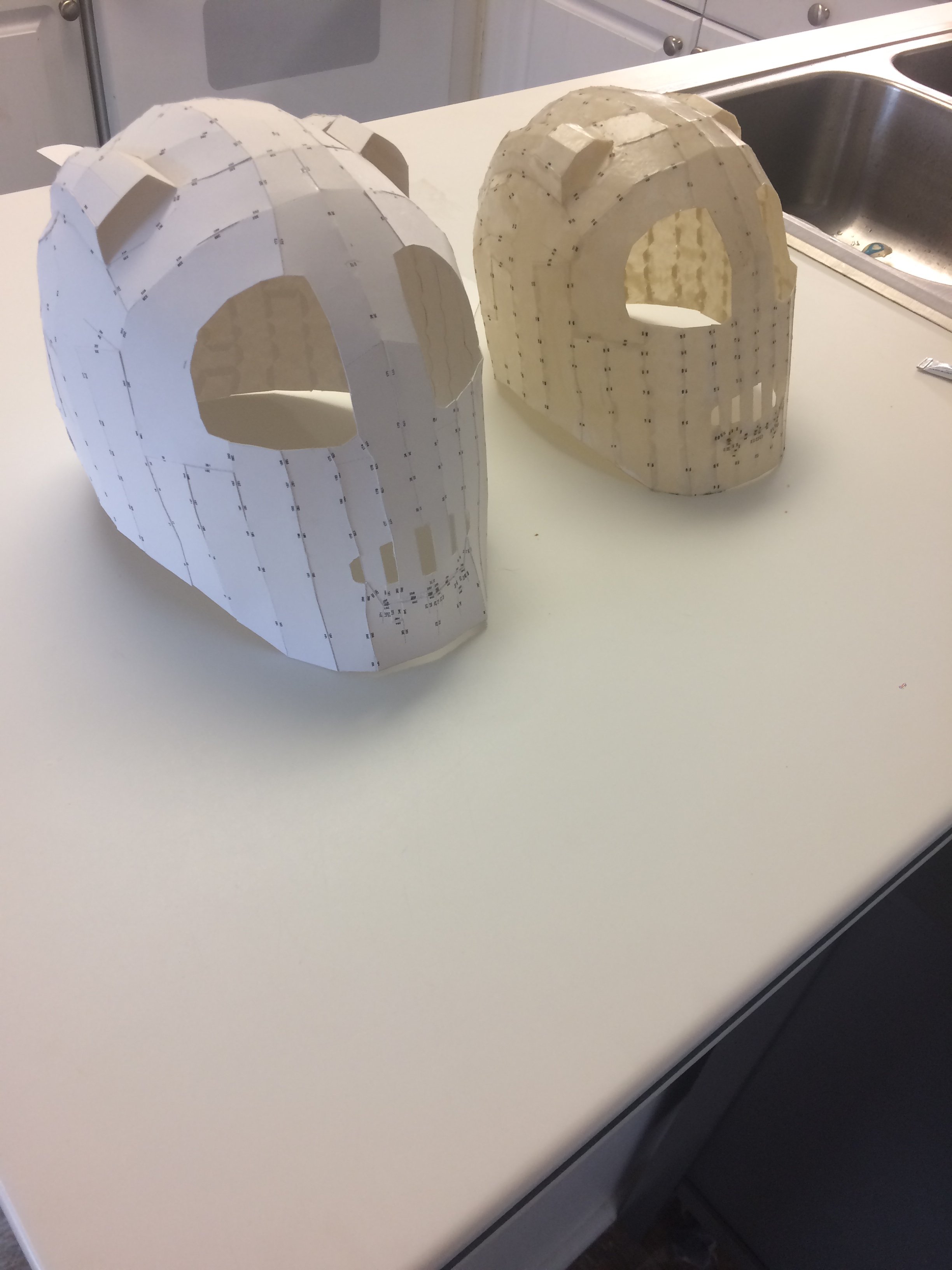

after putting it all together I noticed I scaled it WAY to small so I made one for my son as well.. what kid doesn't want to be the Rocketeer. Also sorry the pics are not right side up. I dont know how to fix that

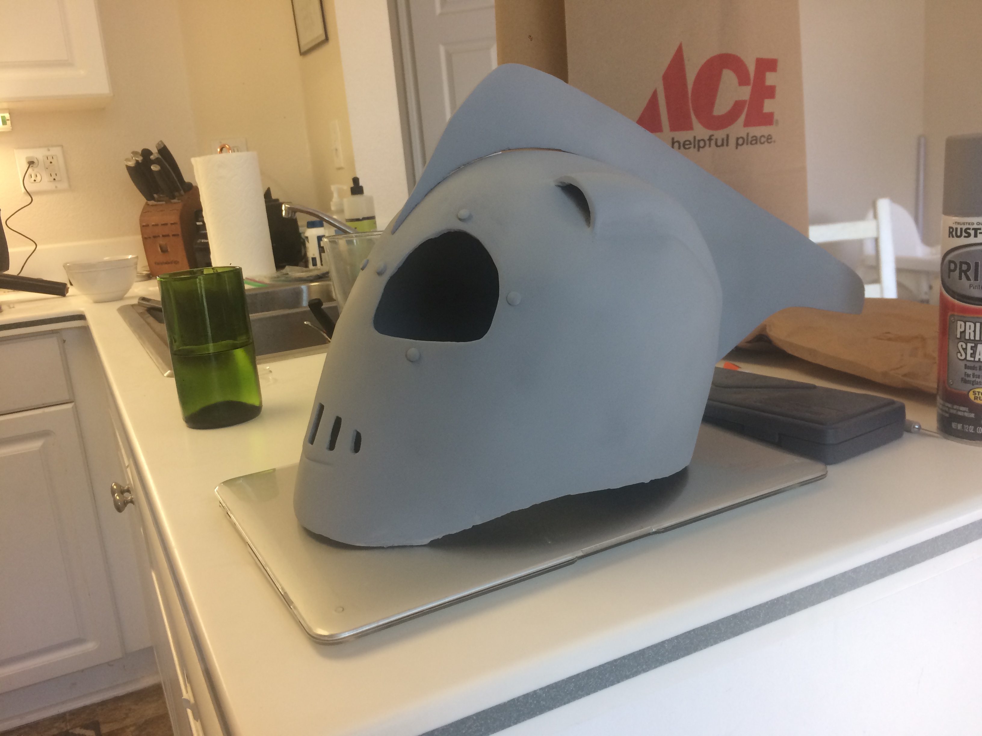

primed up!

primed up!
